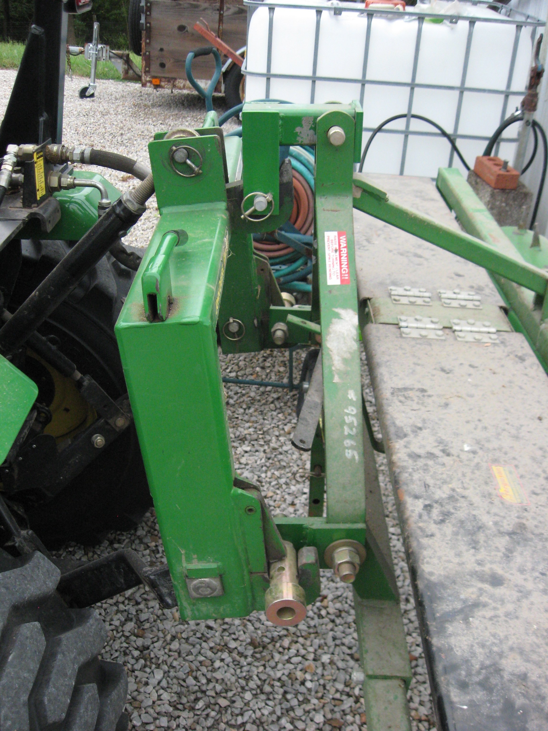

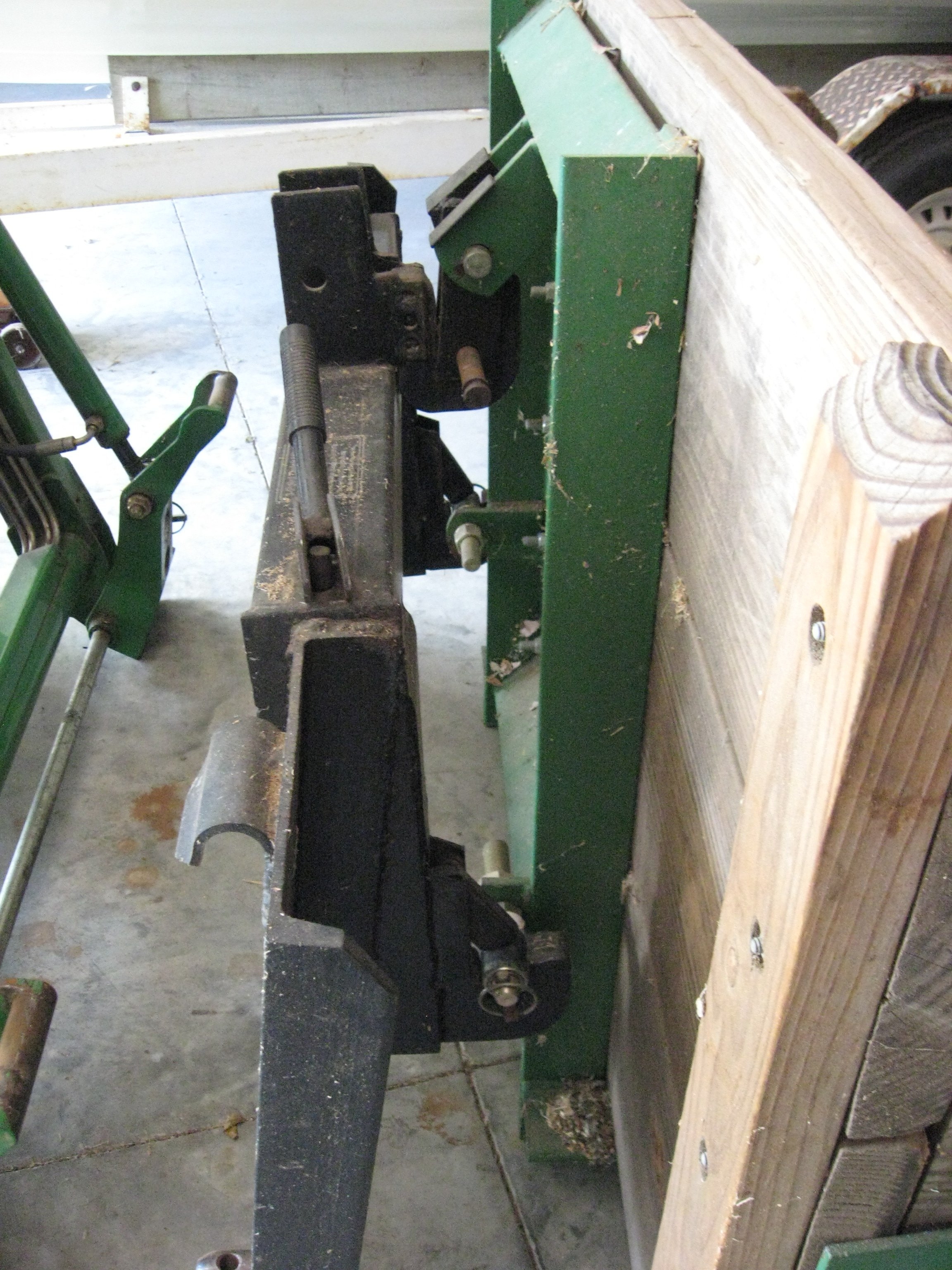

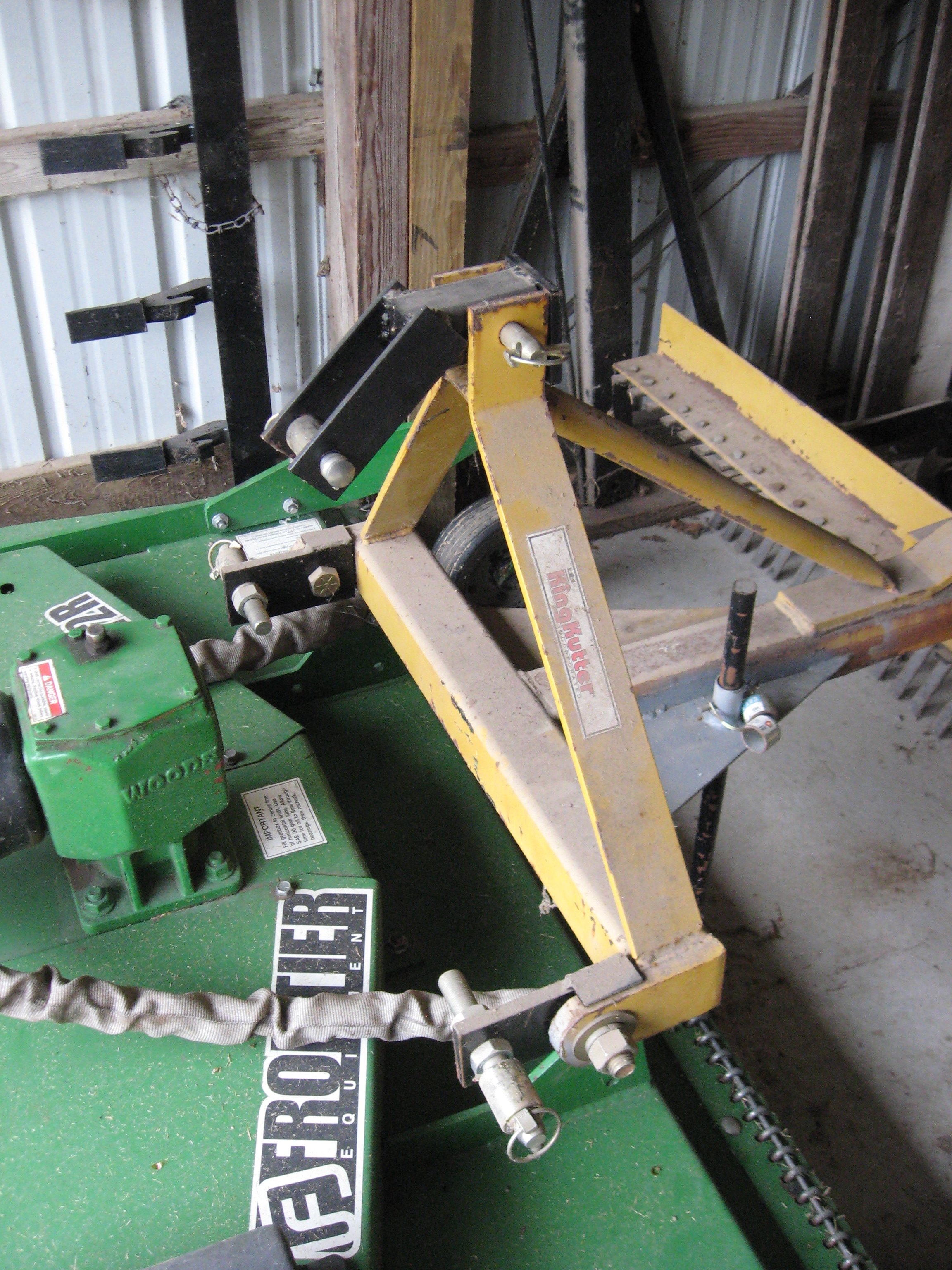

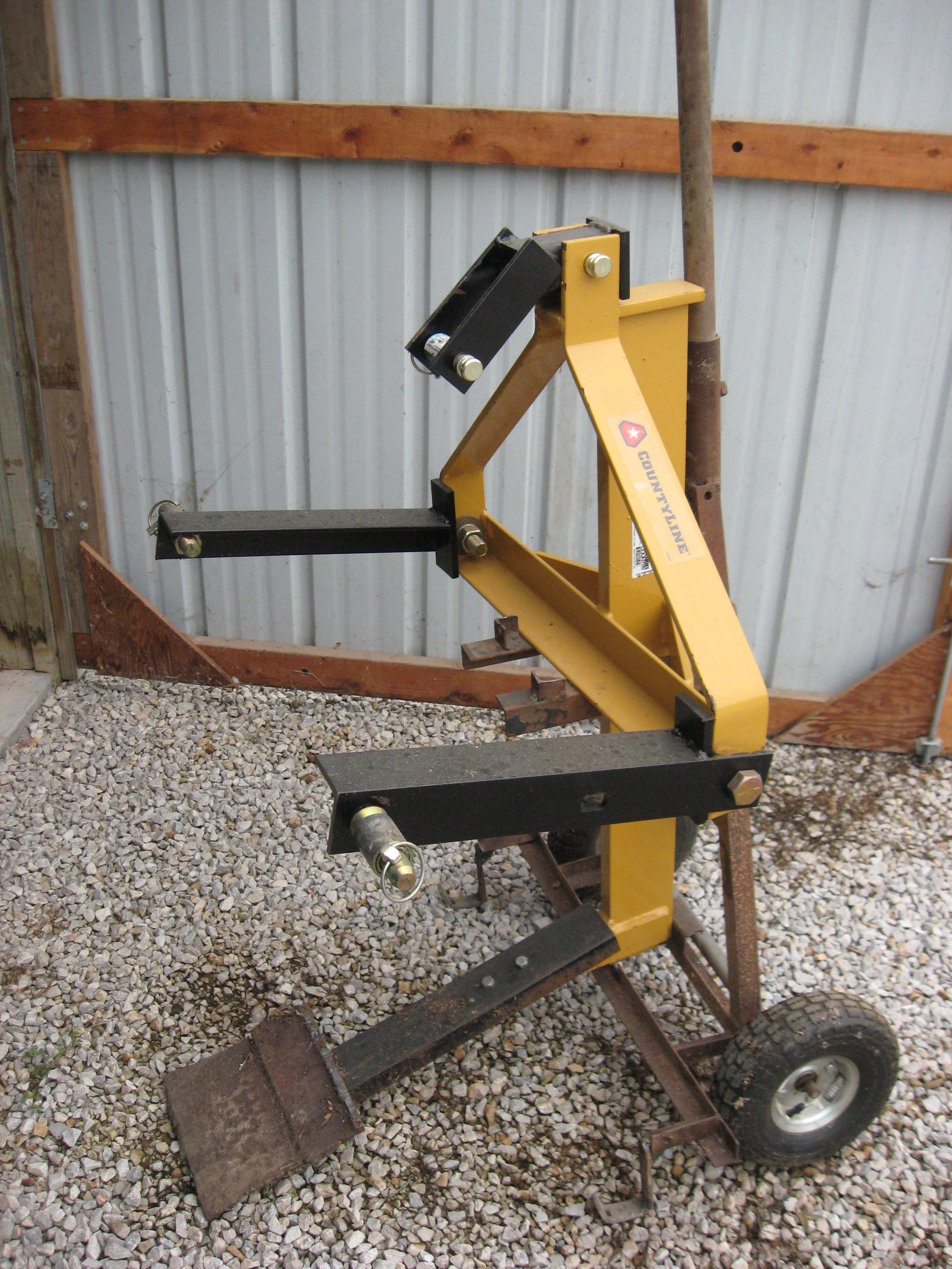

Thought I would post up some of the adapters I've made for attachments I have that are not quick hitch compatible out of the box just in case anyone is looking for ideas on how to build one. Lots of ways to do it and most people probably just modify the attachment, but I wanted to leave the attachments stock so they could be returned to original condition if desired. This method does result in moving the attachment back 4" or so, but I haven't found this to be a problem.
Subsoiler (Note: I made two kinds, shown are the extended bottom link adapters for when I use this on the loader with the front quick hitch to turn the compost pile. I also have a set of short ones as shown on the overseeder below for when I use it on the rear quick hitch)
Landscape Rake
Ferguson Yard Maker overseeder
Carryall
Most of these just use 2 x 2 tubing and 1 1/2 x 1/4 bar stock, plus some kind of backing plate on the tube to prevent rotation, like whatever thick scrap I have available.
The one on the carryall uses angles to prevent rotation.

I think it's a good idea, especially if it works. I have a question on your sub-soiler. I thought the lift pins and the top link were supposed to be in a vertical line with each other. Is that working ok? I have a sub-soiler, rototiller and finish mower to adapt.
/ Quick Hitch Adapters
RE: Subsoiler - right, the pins would normally be lined up vertically. The setup in the picture was made so I could mount it on my loader (with a quick hitch on the front, see last picture). The idea is that I can reach over my compost pile and "stir it" with the subsoiler.
The problem is, the front loader mount won't tilt back far enough for the subsoiler to "dig" properly, so I had to make make the the lower pin mounts longer to get the angle of the dangle right. I also have normal lower pin mounts for the subsoiler for using on the rear three point as it was intended.
Will try to get a piccy of the front-mounted subsoiler on the machine for reference.
