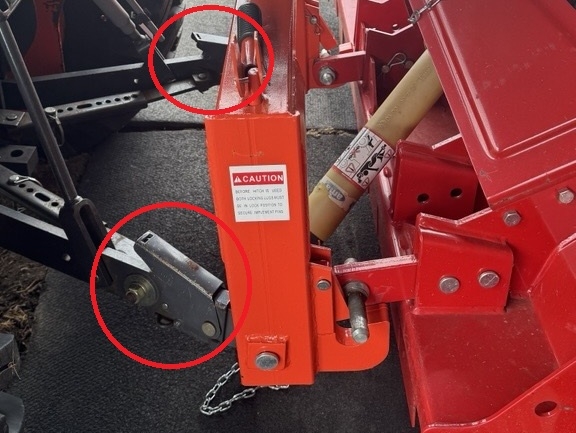

Okay, this is how the connection points on my QH looks.
I modified the upper portion, eliminating the holes for the hook, which allows more travel for the link when using the inner hole for the pin.

Nope. I had ordered one of those a couple years ago. My 3-pt has the extendable lower link bars and Pat's would not physically fit on.
Are you sure? I tried the quick hitch like you have a few years ago and, due to the variances in connecting pints in different implements, ended up getting Pat's Quick Hitch adapters for my Kubota 3830, which also has the extendable lower link bars. Haven't extended them since I got the Pat's adapters installed.
If yours does not extend far enough out by default, you could just remove the unlock levers since you'll probably never use them again.
Chris

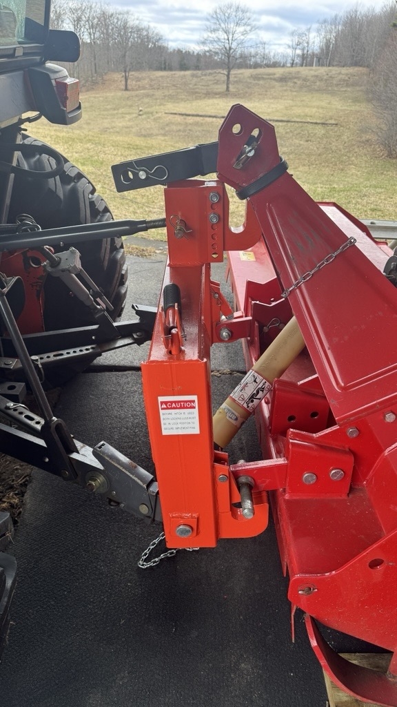

My son convinced me to get a quick hitch.
Problem #1 - my flail mower is not QH compatible. Not a big problem, I thought, and got an adapter.
Problem #2 - the adapter makes the top link waaaay too long. It's too long even retracted all the way, and when it's retracted all the way, the 3-point arms won't go down far enough anyway.
Am I missing something?
You don't need the adaptor with that implement. Just a pin in the top hole and it will sit on the hook. Put the pin in the round hole if you want it to ride solid and the slotted hole if you want some floating.
Chris
I hadn't considered extending them and leaving them there, because they don't lock in that position. I see that you put a U-Bolt on the extension, presumably to hold it in place. That may be an option - thanks.
Oh, so put the pin in AFTERwards. I can see that would work, except as has been pointed out to me, the hook is not near high enough. I'd need to fabricate an extension (which is possible).
That's what I thought it looked like, the arms are in extended position.
I also thought that that's a major no-no since they supposedly break somewhat easily if left extended instead of locked in the retracted position. After all, there's not much overlapping material to handle any forces when they're extended.
/ Quick Hitch woes #36
My arms are not extended, but I won't say that isn't a possibility. The u-bolt you see came with the adapter kit. It is to tighten the assembly to the arm once you have it adjusted where you want it.
Chris
Chris
The Pat's would not fit with them retracted. But I hadn't considered removing the cover/actuator. Maybe your's is Cat2?
