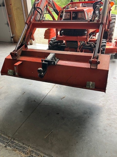

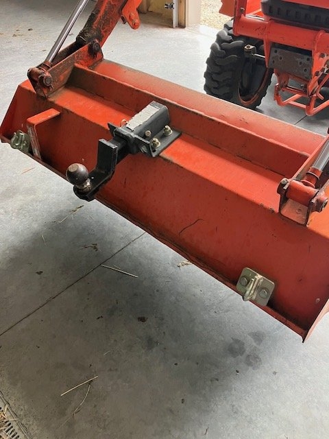

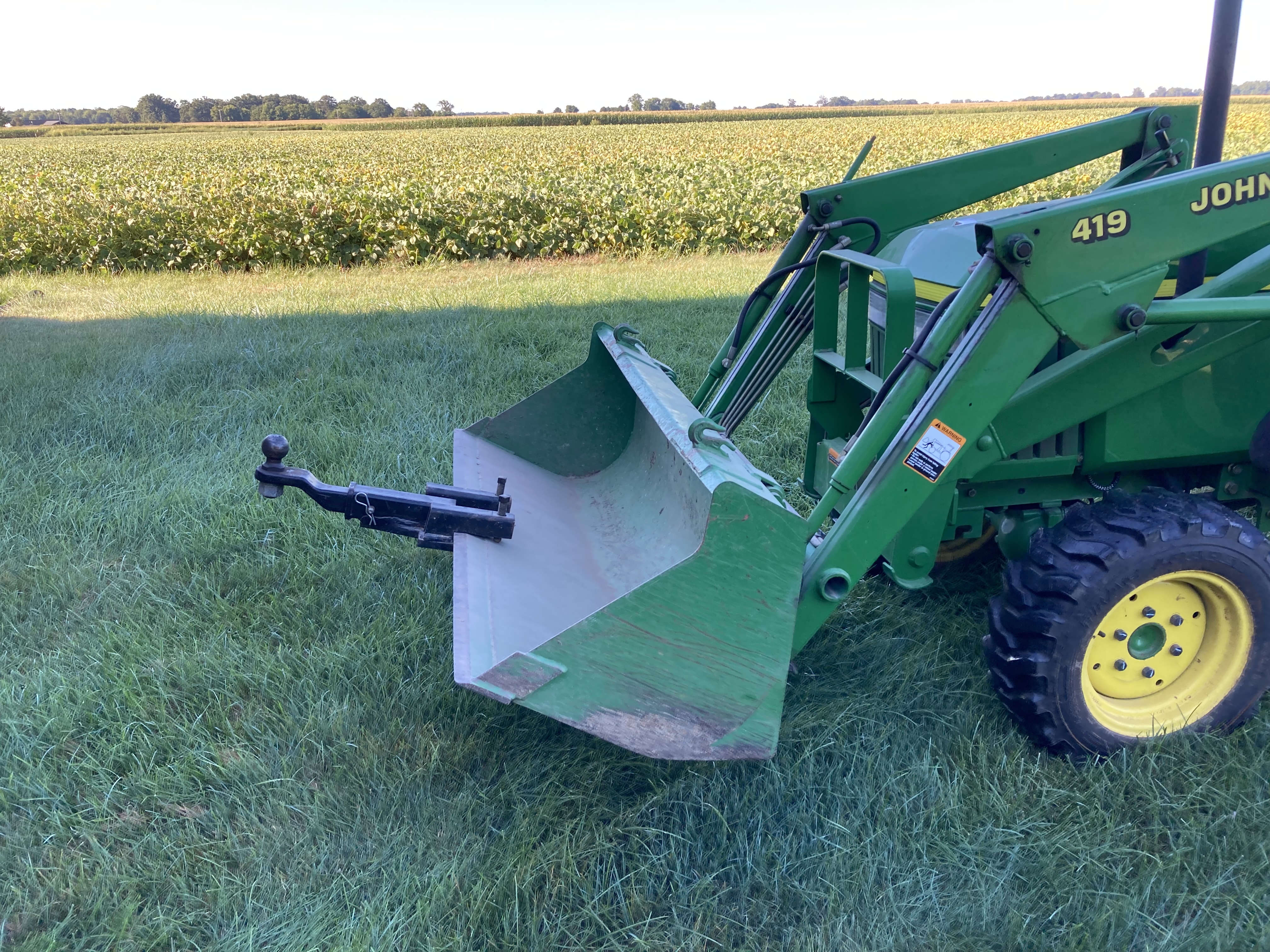

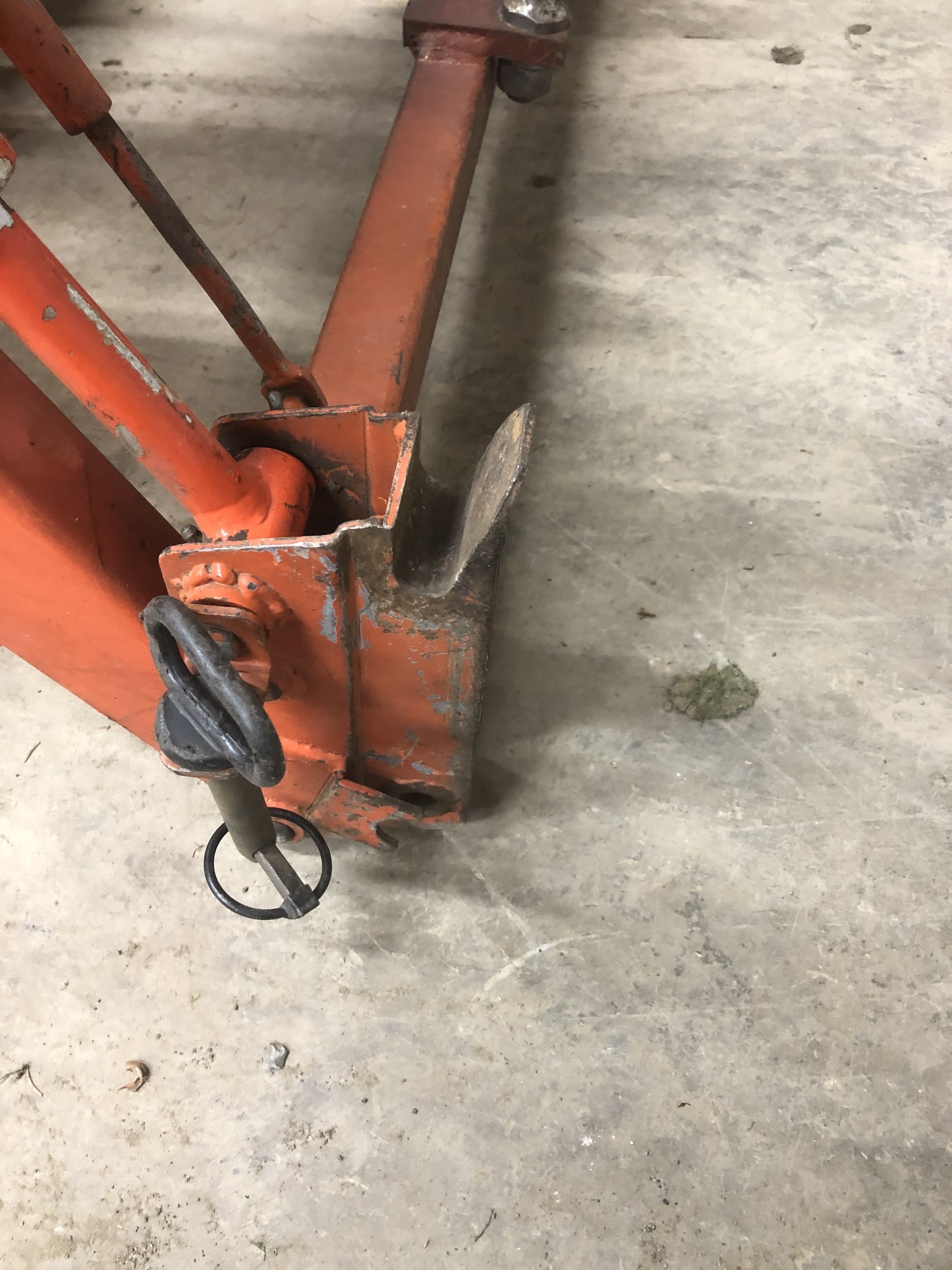

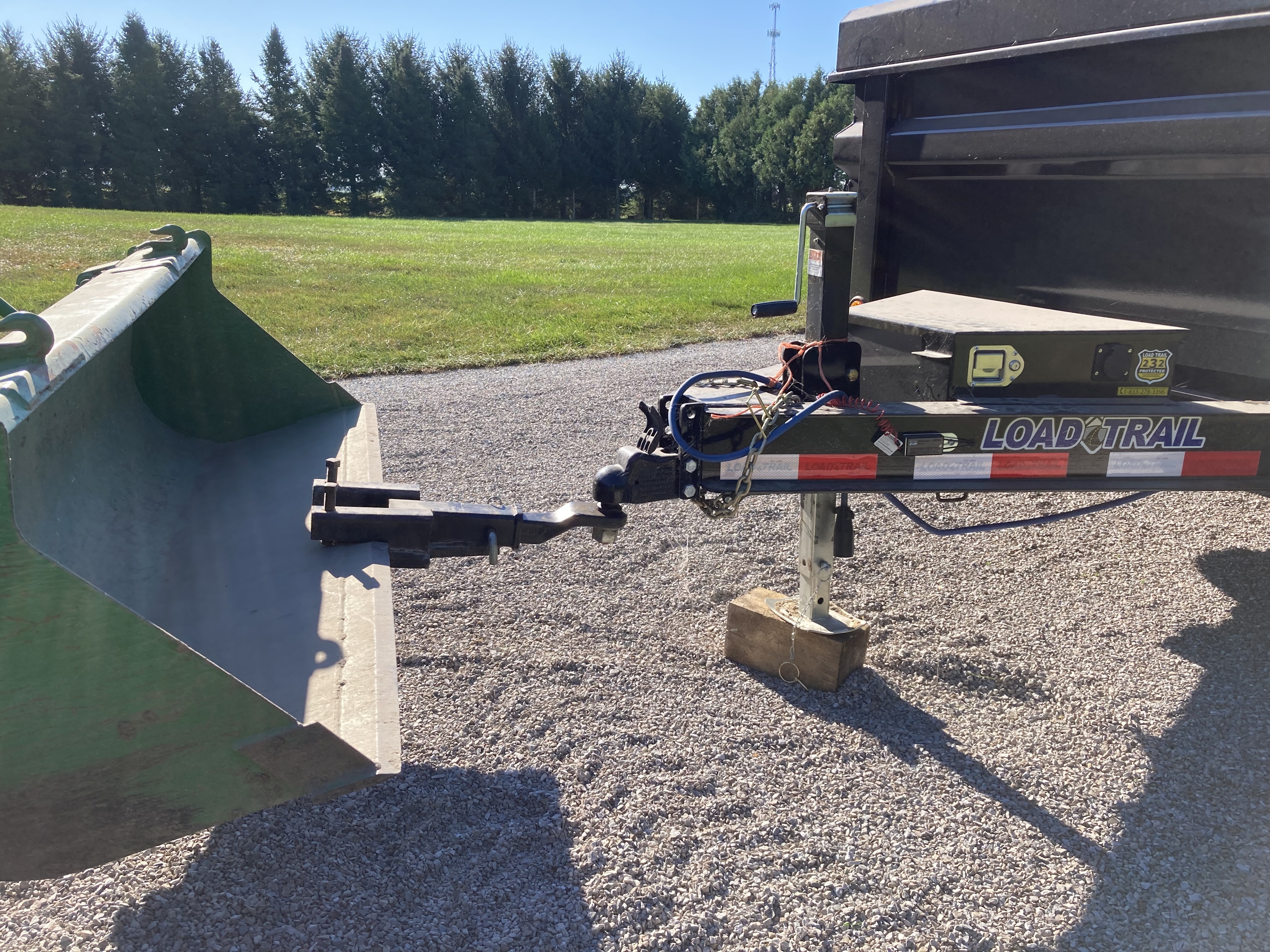

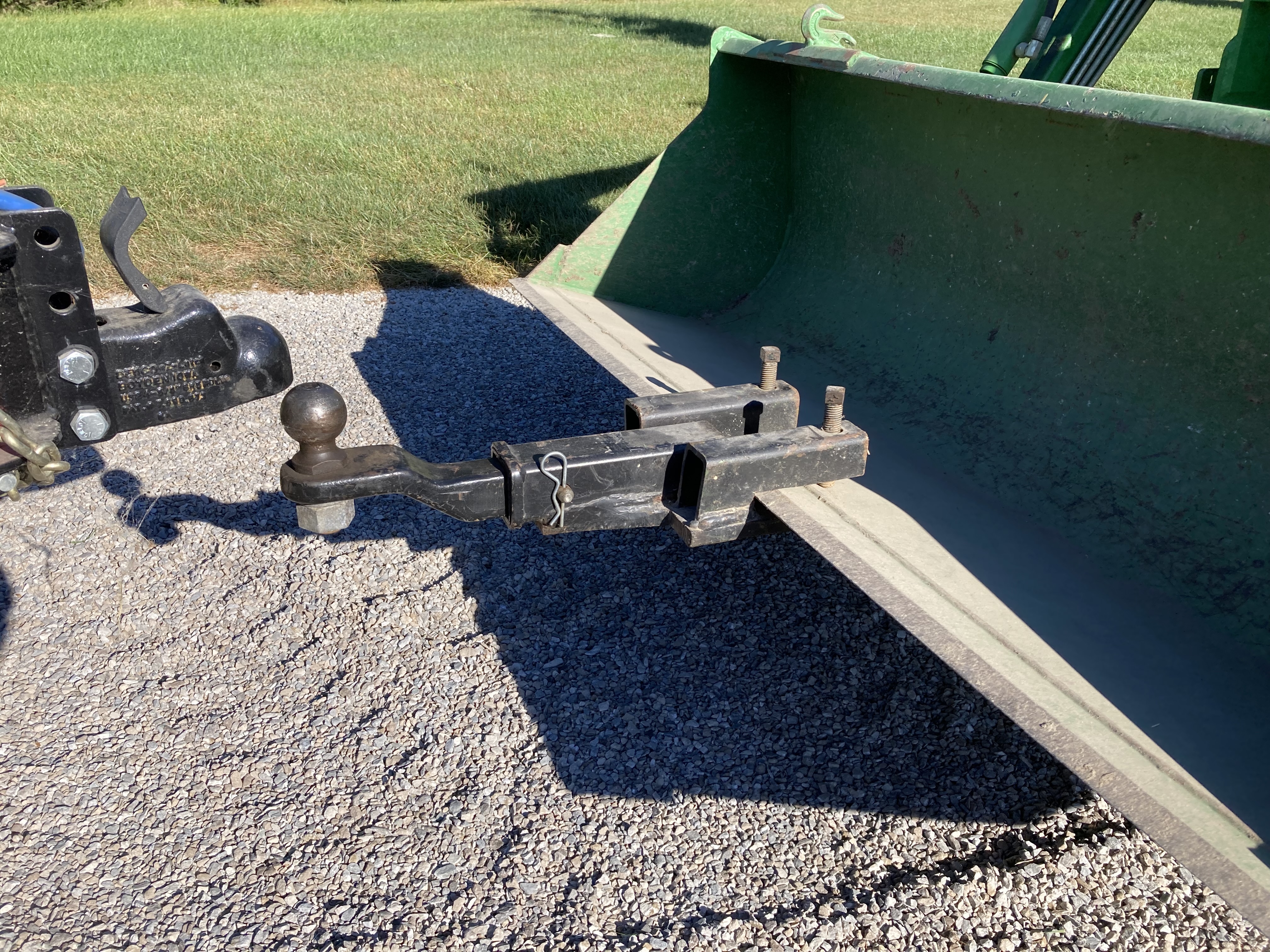

After reading of people unable to see the trailer ball while moving trailers, I thought to post these pictures. FYI. I don't have trouble moving trailers and by tilting the bucket can usually see the ball. Moving is quick and easy.
I didn't make this thing but did heavily reinforce it after it bent under heavy trailers. I got it in Kentucky with a trade and these are not my welds. It just an extra long bucket clamp arrangement welded to a long style receiver tube. By using the long style hitch and ball, the extra length makes it easier to see except when the trailer is real low to the ground. Then I have to crook my neck or lean forward.
The extra-long makes it work and I can usually hook up in seconds. Surely others have made better so if you have a pic, post it.
View attachment 4006749 .View attachment 4006752 .View attachment 4006750 View attachment 4006752

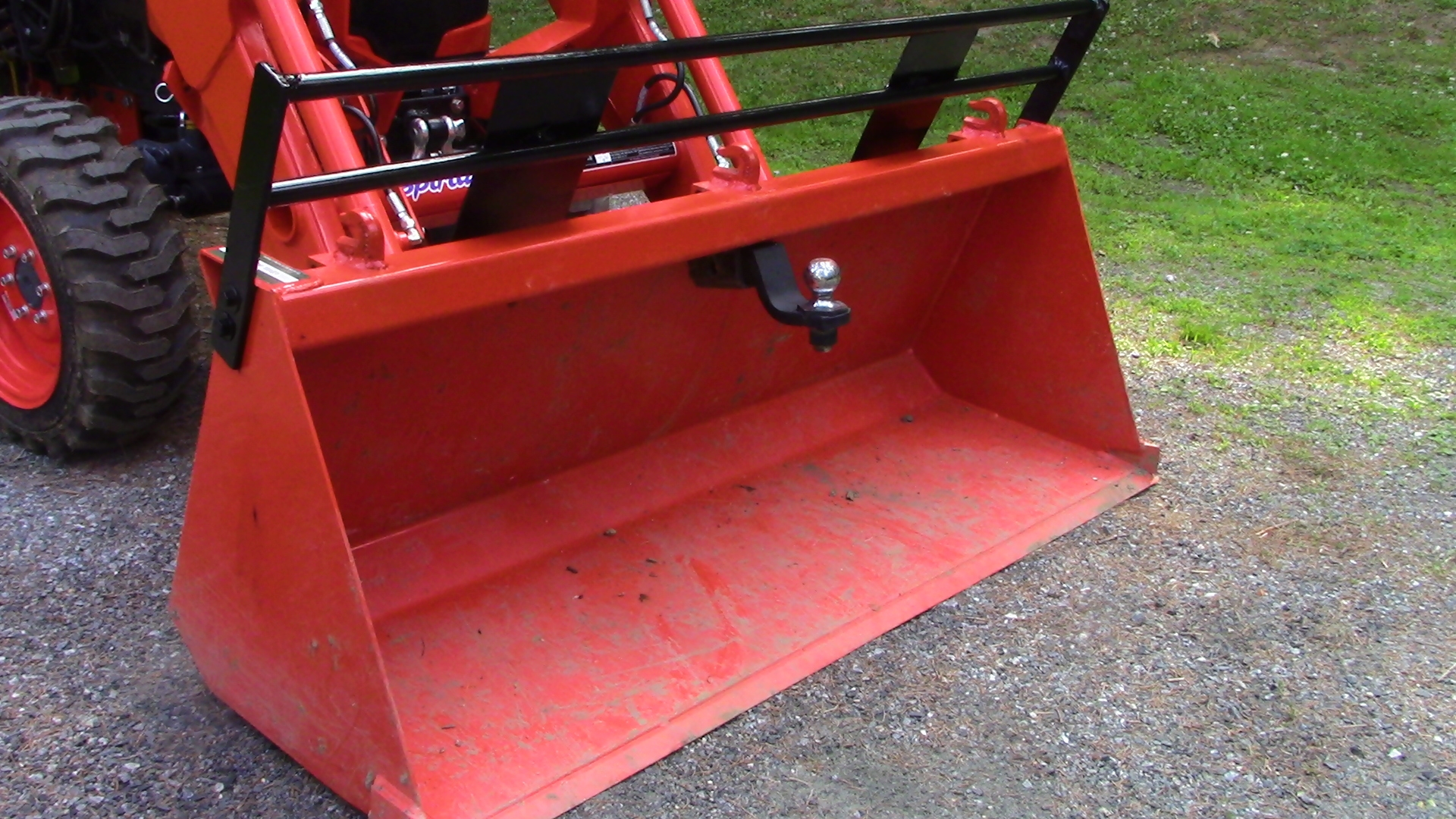

The point of my using a small tractor is that it won't lift enough to bend the bucket. I've had this arrangement for 20 years and lifted many trailers and no bend yet. Think stuff out, don't overload your equipment and it's all good.

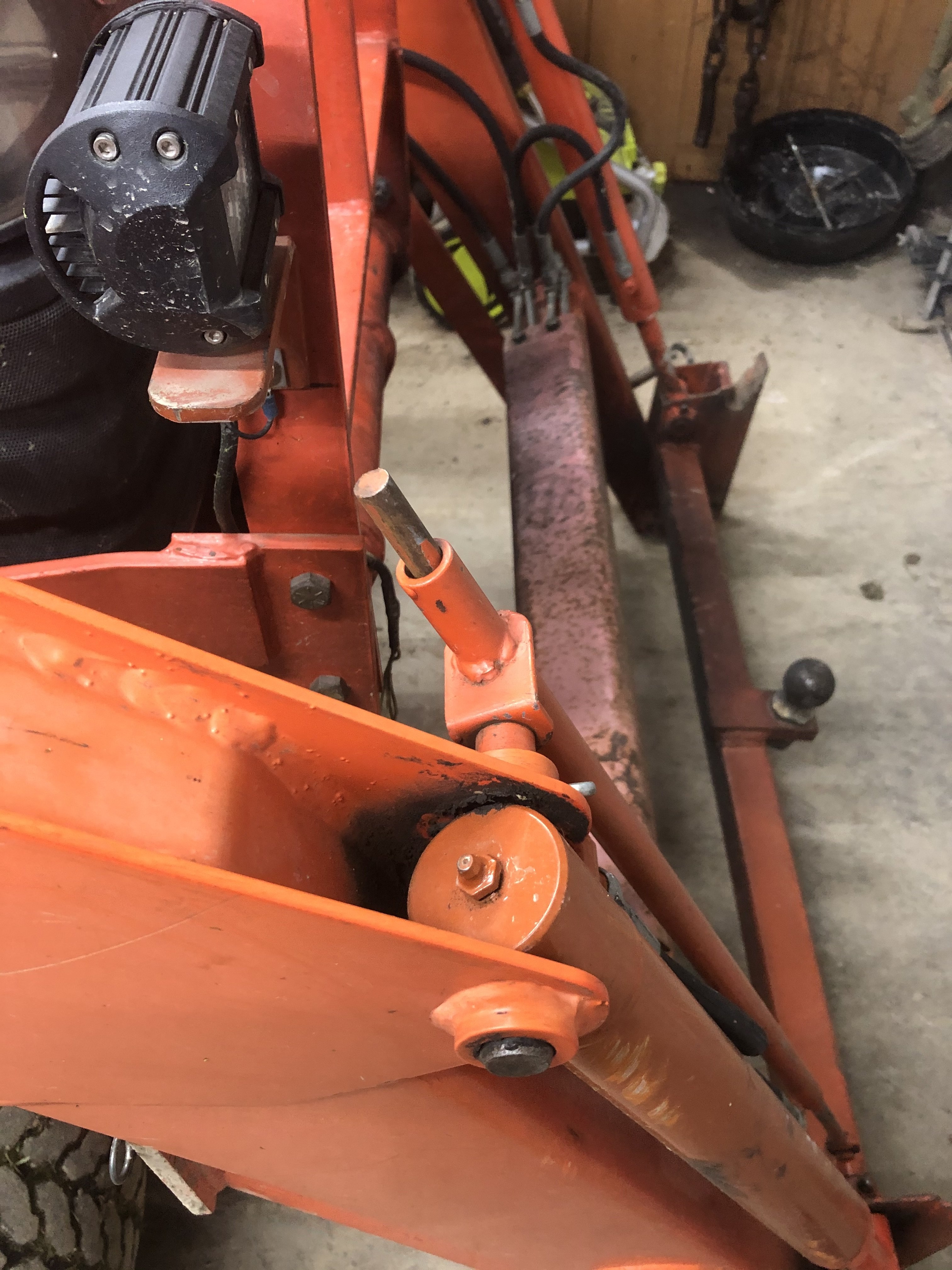

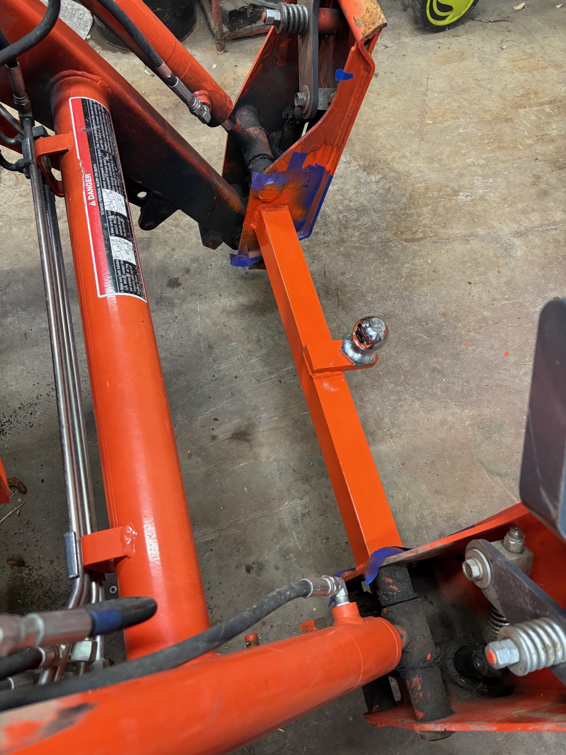

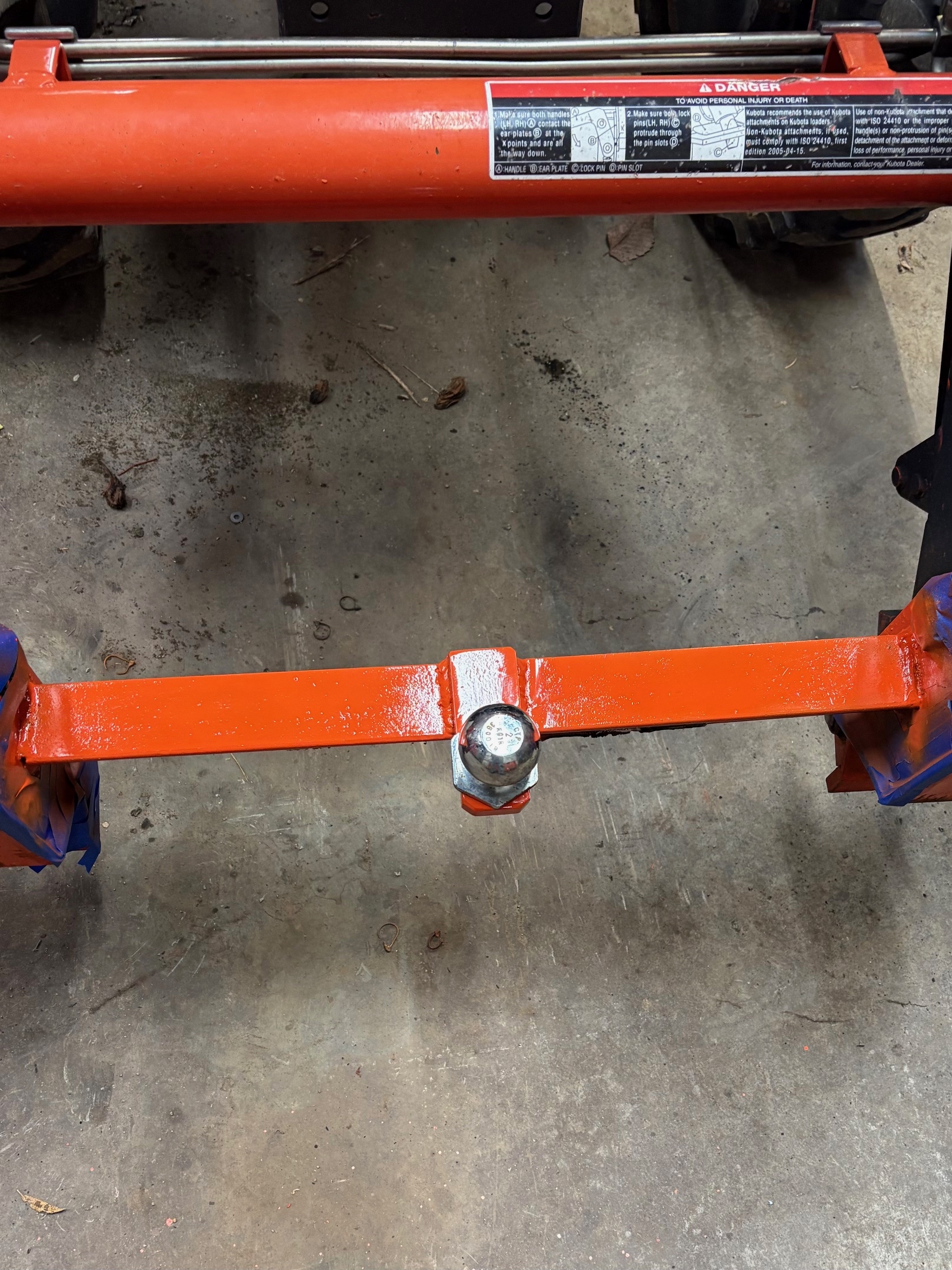

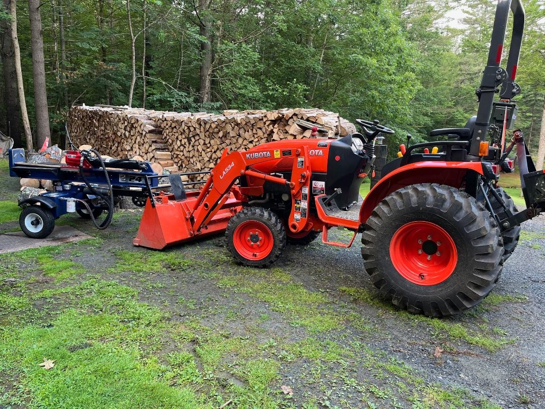

I just bought a new to me B2301 w/ LA434 loader to replace my B7510 w/LA302 loader. I welded a 2”x2”x3/8” angle between the loader arms with a lug for a ball. It fits behind the ssqa and doesn’t interfere at all. I had one on my B7510 as well (I made a kubota style qh for that bucket.) first two pics are the LA302 with the QH l built. Second two pics are the LA434 on the B2301

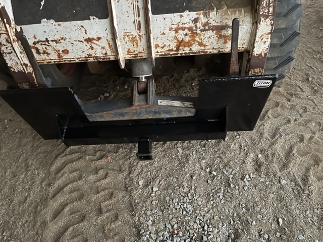

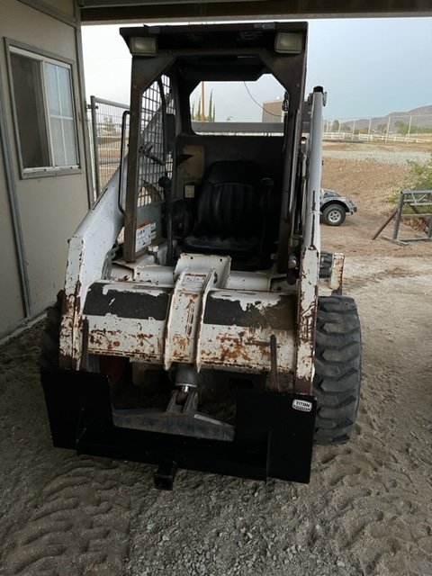

On topic. A front end loader may be easier than a bumper hitch but for the ultimate in trailer moving control get a hitch on a skid steer. That's the ultimate control.

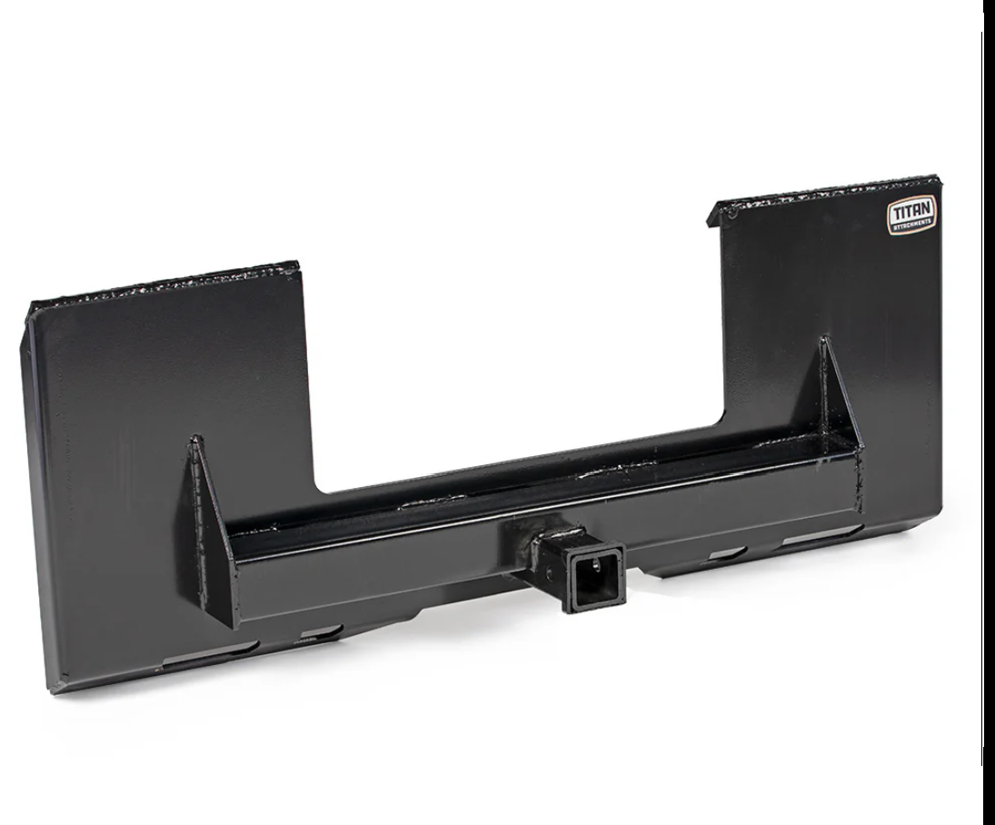

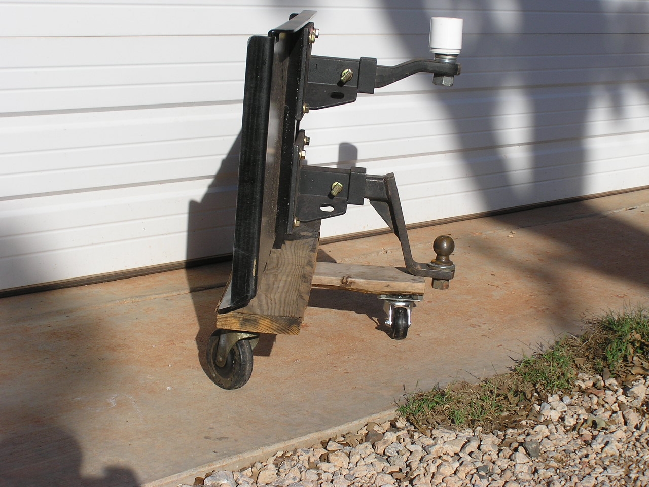

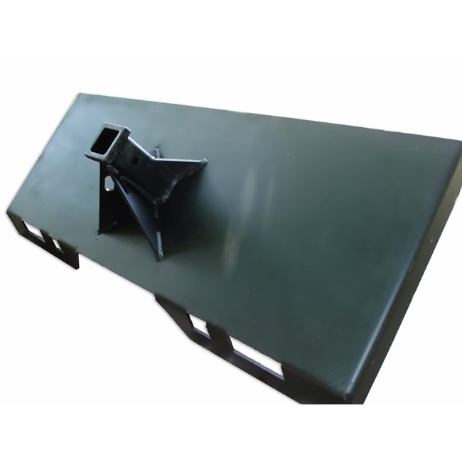

You can get them plates cheaper w/ a removable receiver. Not sure of the strength, but says 3/8" throughout ~$170:
I can't see what is behind the $170 one as far as the backing plate reinforcements, on amazon but I like the Titan a lot better due to the strength of it. I just don't like the price, lol.
If I used my tractor to back trailers in very much, I would buy a blank SSQA plate and get a receiver hitch from a auto recycling yard and weld it on the front, similar to what Titan did.
