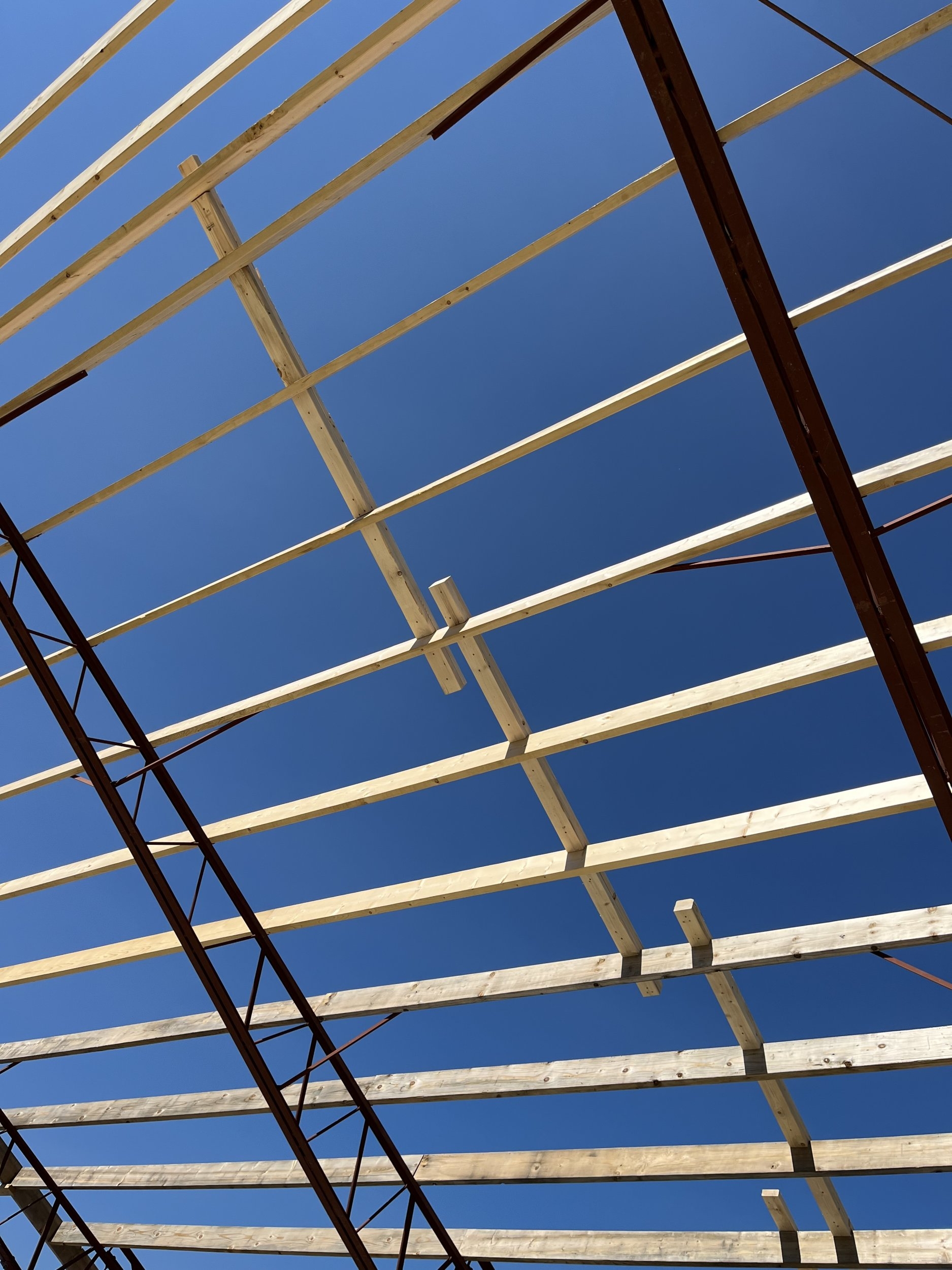

I understand the engineering on those purlins being on the flat with the ribbing of the metal siding providing the support for them once it's installed, but that sag in them is driving me crazy. If it was mine, I would install a single stud, or vertical blocking in the center of the span to support them.
/ Building my barn! #42
Typically, the shop drawings will call for a 2x4 temp brace, until siding installed. Basically just a block. The dunnage the metal came on works great for this. It can be removed once your metal is screwed off.

I’ve added vertical 2x4 braces on the inside of wall girts since those photos were taken. Looks a lot better with straight lines. Plus I can climb up the sides as needed. As mentioned, those will go away once I’ve screwed off the wall panels.

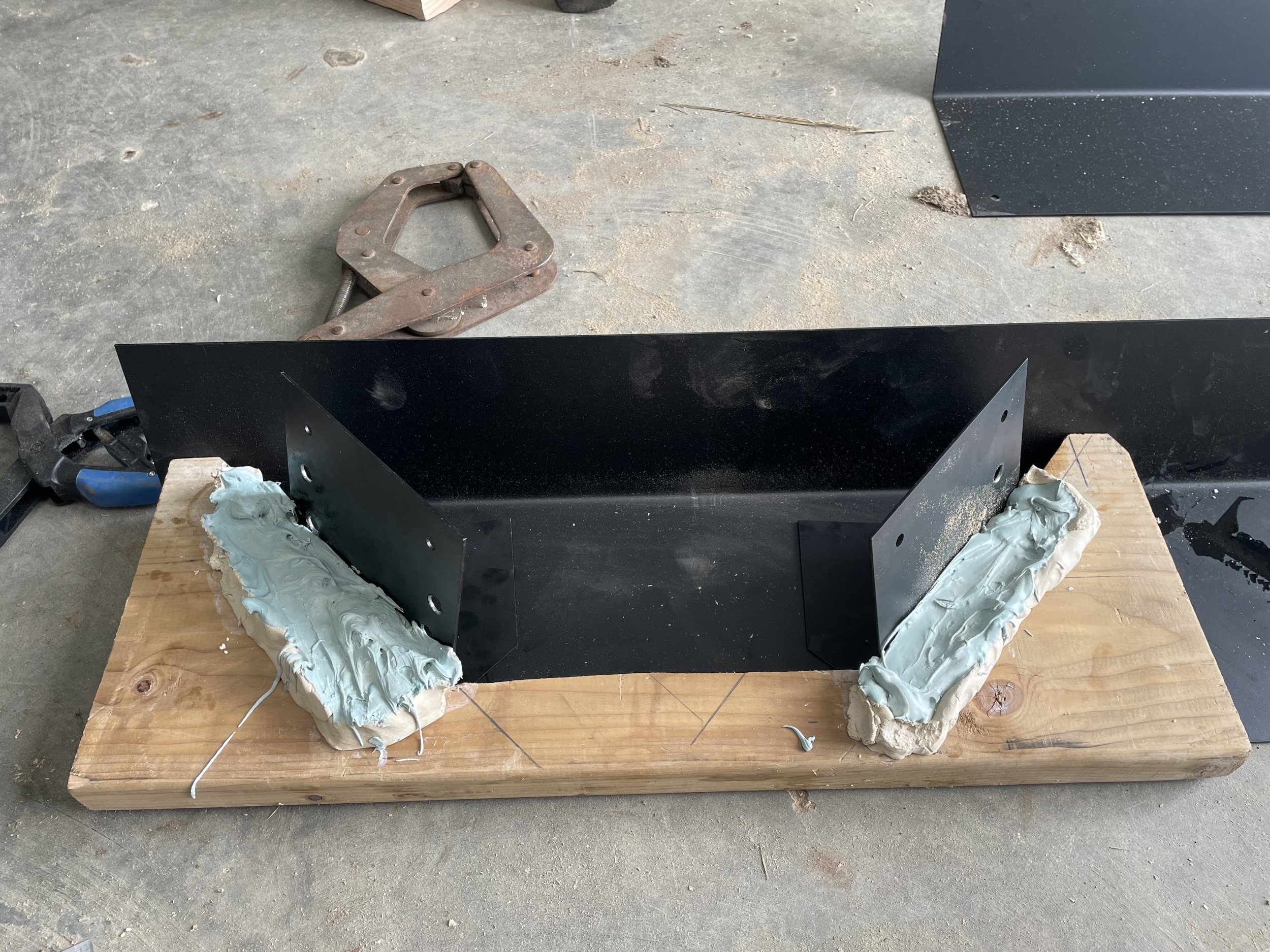

I’m hoping to finish the roof framing this weekend, weather permitting. Framing the sidewall overhangs has been a PITA to do solo - holding the fascia in place to attach is difficult, and the eave struts need to each be notched on each end to fit inside the steel brackets. Last weekend I managed to do 1/3 of them, when I’d hoped to do all of them.

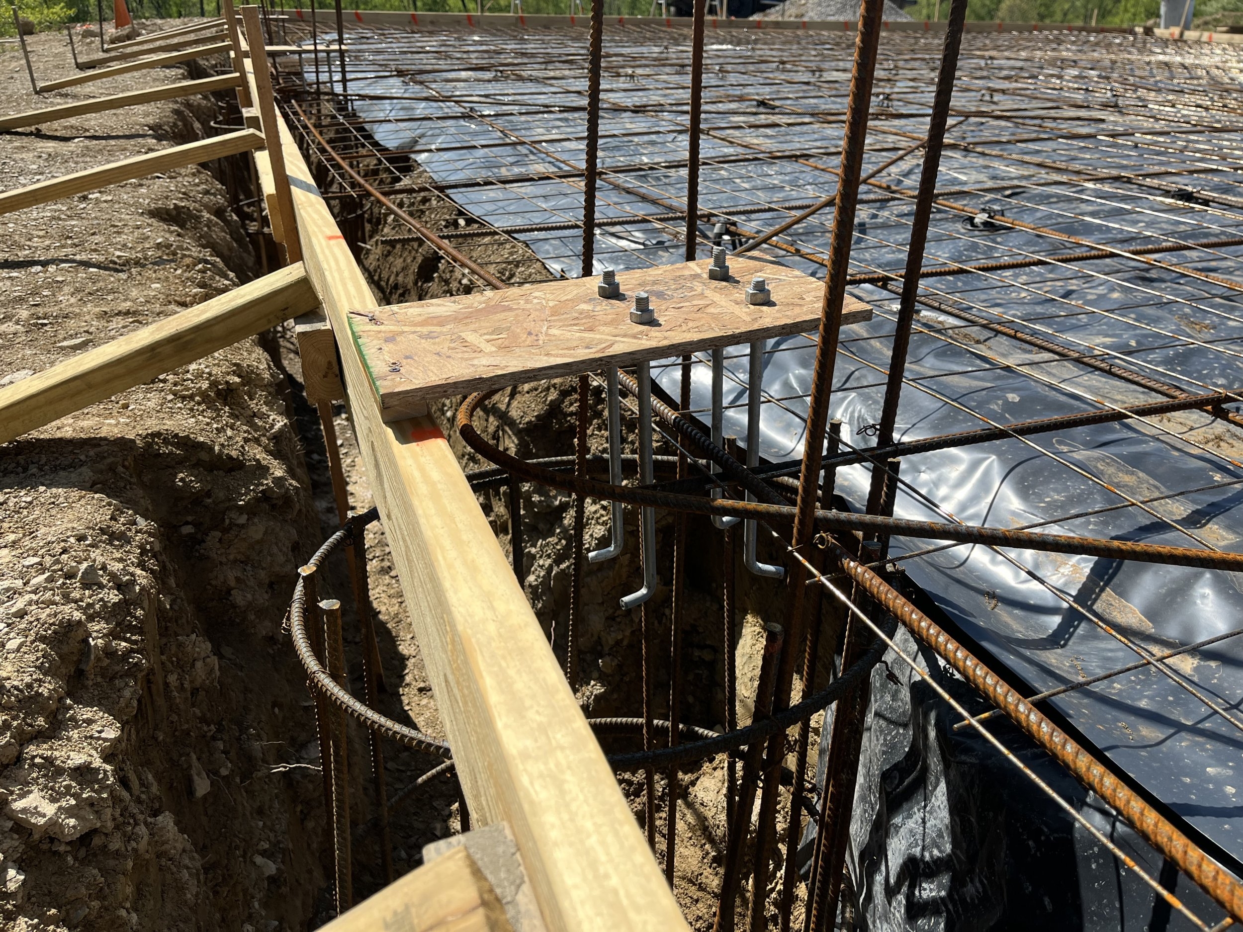

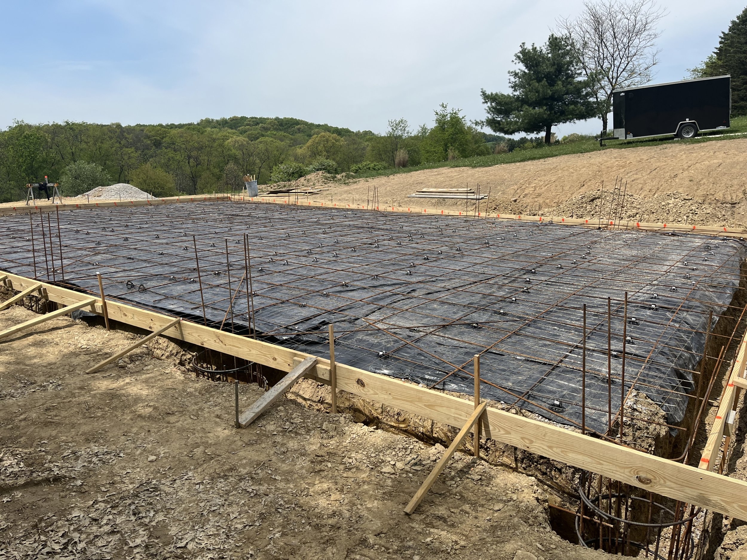

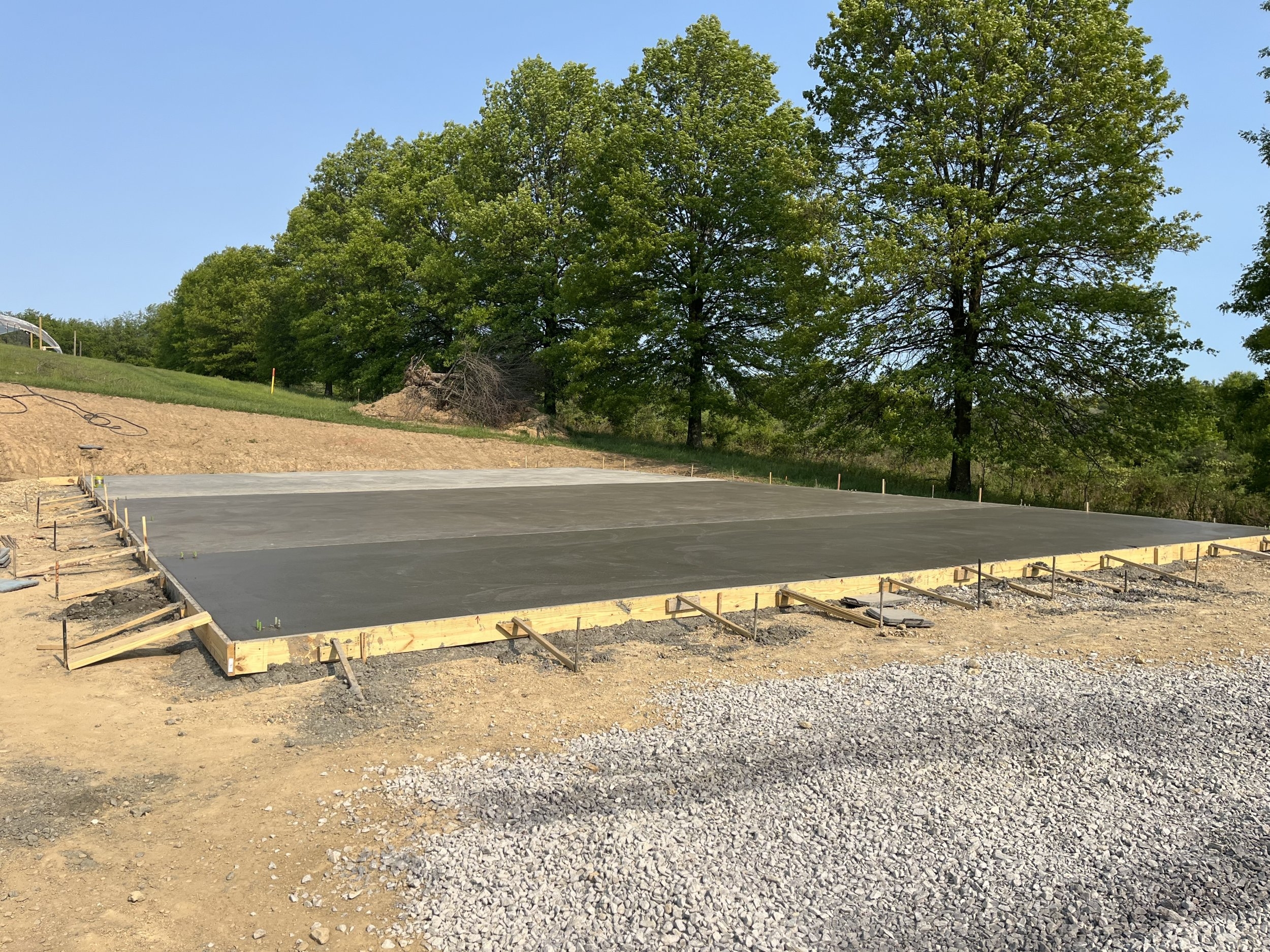

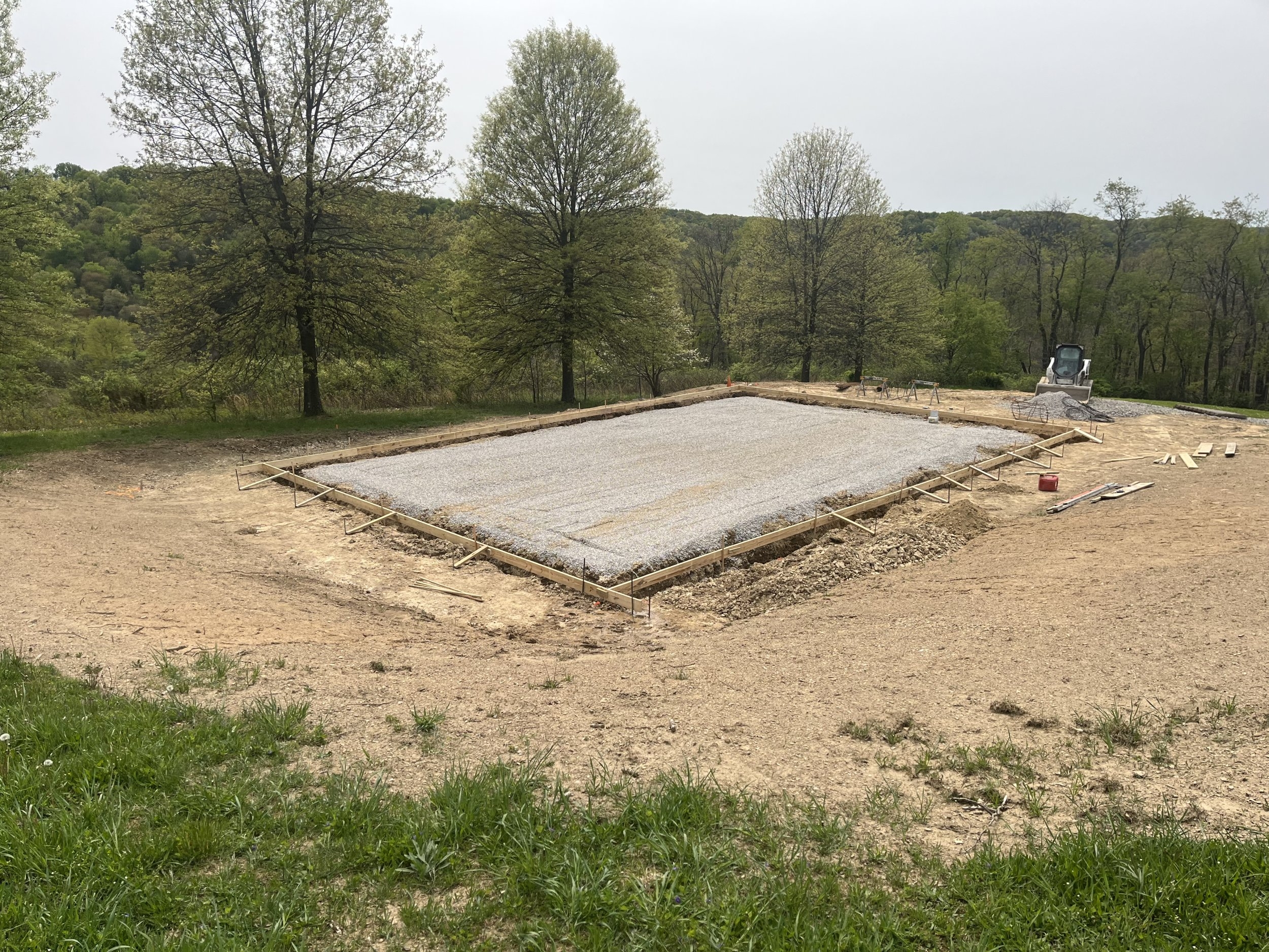

Over the past two weeks, my concrete guy has dug out the footers, rolled the sub base and stone, added a f***-load of rebar and wire, and finally poured the footers and floor. They pumped the footers in a day (38 yards!) and then did the floor over the next two days for a total of approximately 80 yards of concrete. Don’t ask what that cost me. But they did a great job and this thing ain’t goin nowhere.
Anchor bolts for the columns were cast in place. I build some little jigs to hold them in place against the slab forms. Now I’m just waiting for the concrete to harden up over the next week or two before I can start raising the steel!
I am doing a Quonset and found the cost of cement staggering. I paid $225 / yard in MI. That was a Saturday delivery so it was more. Getting a cement company is a good move. It was 90 and we were unable to finish the cement quick enough. We kept adding water and had visqueen under it but it was not quick to harden and too dry coming off the truck. We had 32 yards delivered of 4500 psi. I had a large stone base that is tiled and great drainage as spring is a mud hole on the clay. What is unsaid with Quonset buildings is the baseplate option. It would cost an additional 7k for a 30 X 48. I am building my own but it is a challenge. I am thinking 40k by the time I am done and that is doing all the work myself.

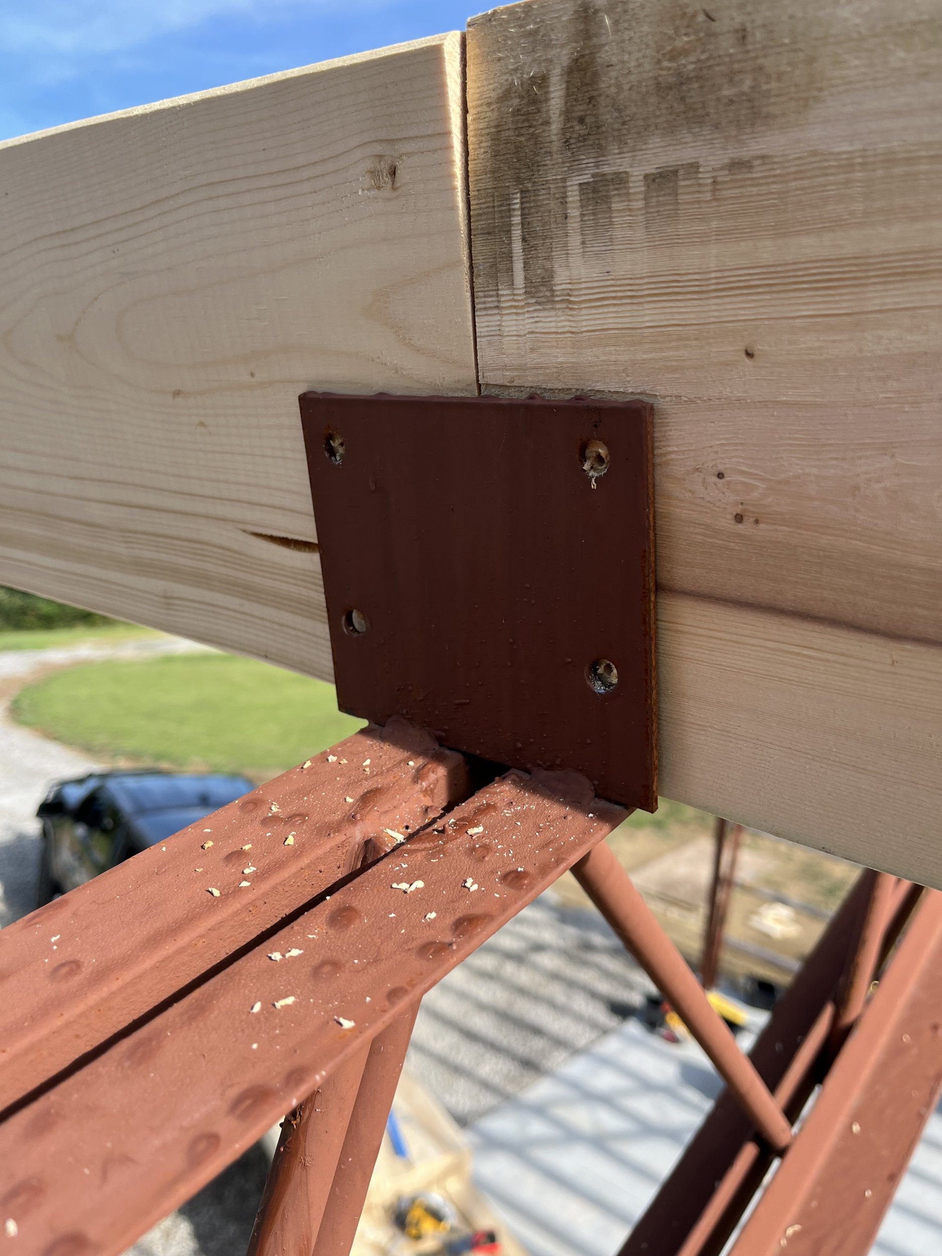

Yeah the columns and trusses have these “clips” that the wood framing attaches too. I’m using 1/4” lag screws … which means I have to drill pilot holes for each. Giant pain in the butt.

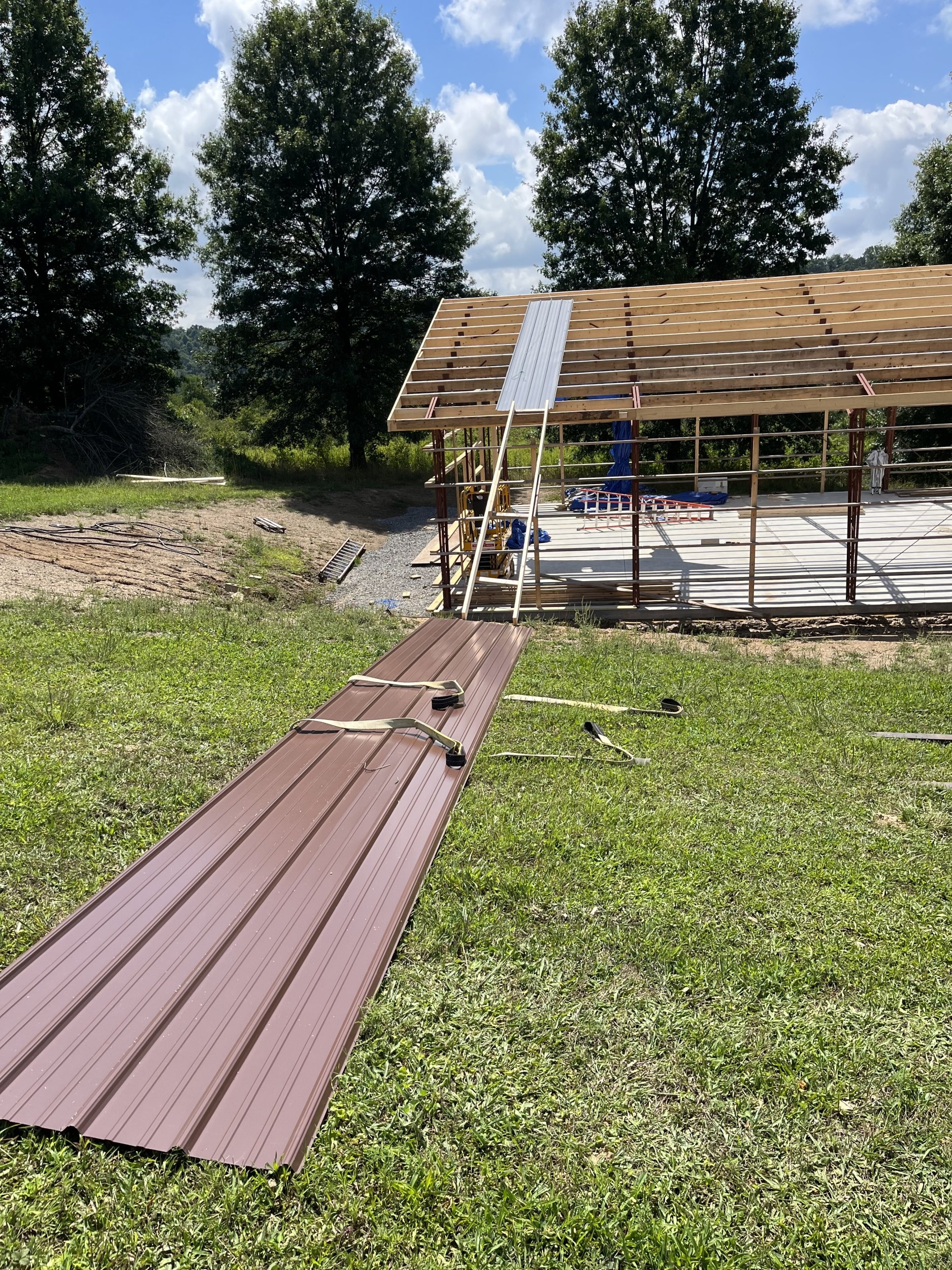

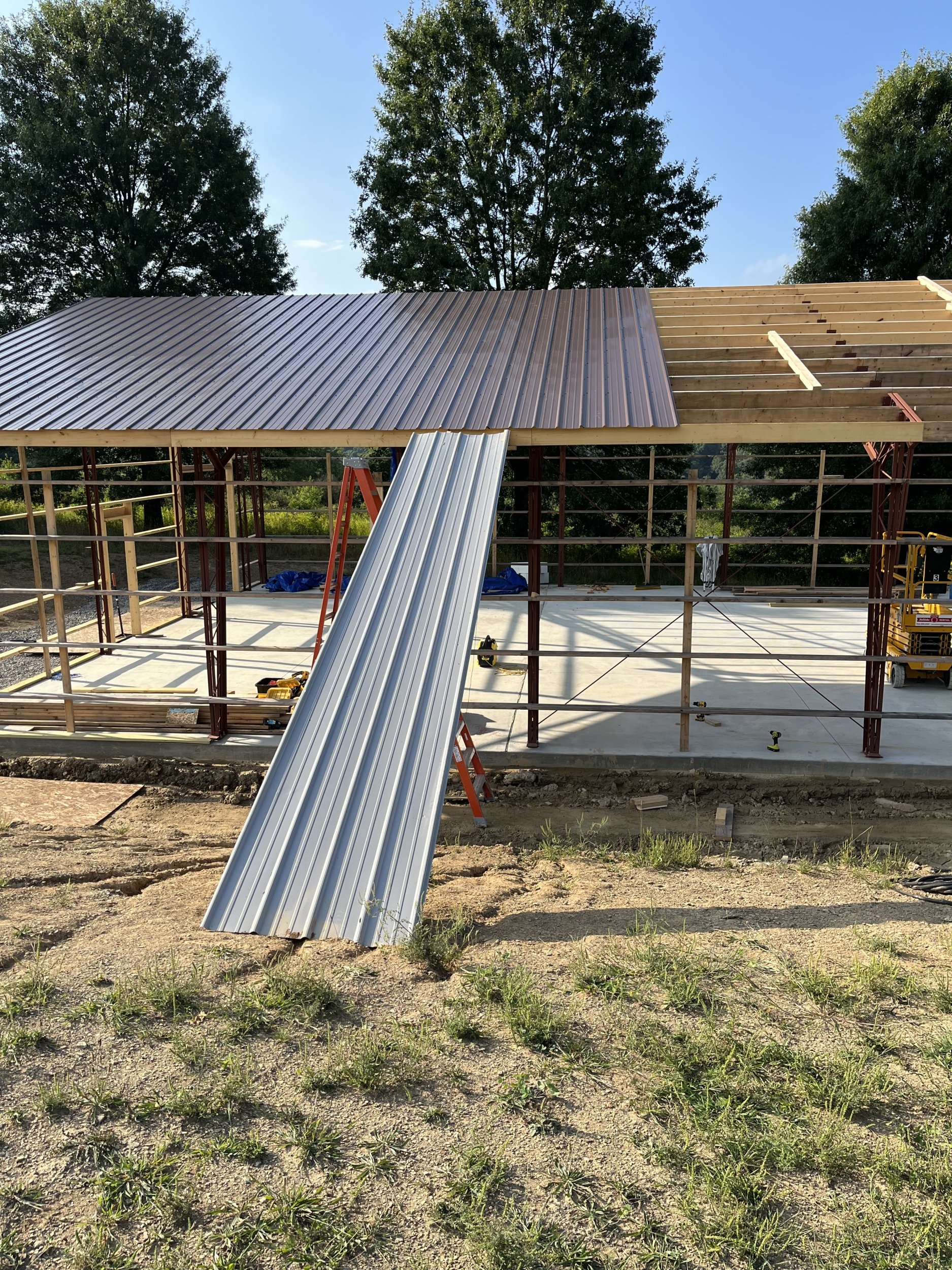

It’s been a while since I posted. I’ve been working on sheeting the roof the past couple weeks. It’s a slow process to do solo … getting sheets up there is hard and I’ve experimented with several methods.
I built this little ramp and put a scrap sheet on the roof. I dragged the panels up the ramp on to the scrap, and then scooted it over into position. I had some 2x6 cleats screwed to the overhang to hold the bottom of the sheet from sliding off. Then I screwed down the edge of the panel from my lift. Later panels I screwed off from the roof
Later I took the scrap piece and screwed it to my ramp. This made it a little easier to get up there, but the leading edge of the panel digs into the ramp. So final evolution - I screwed a small bit of 2x4 to the top edge of the panel like a slider - it also gave me a nice handle to pull it up with. Again I scooted it over to its position and screwed it down.
I had some issues getting holes to line up (I pre drilled the sheets on the ground). The purlins were a little saggy or not straight in some spots. So I build these notched braces. I use them to hold the spacing while attaching the roof steel, and then I slide them over far enough to make space for the next sheet. Really helped with screw misses.
Hoping to finish this side of roof this week (it’s so freakin hot) and I’ve got some guys coming to help on Saturday to do the other side.
