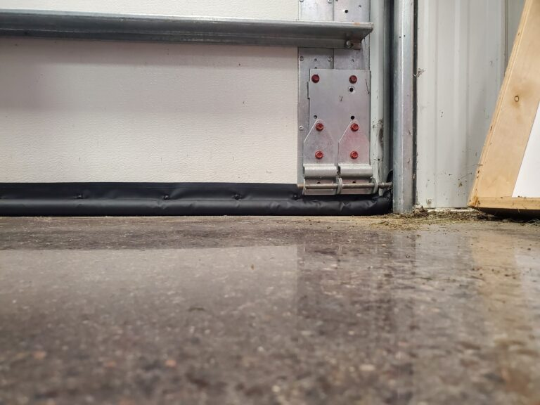

When I need skirting to touch the ground, I get a piece of conveyor belt from where they transport rocks or so. That belt mostly is 1/2 inch thick. The underside of the door leaves a gap of some 3-4 inches to the floor to allow the belt to flex. I cut it to strips of about 6-8 inches wide and fasten those to the bottom of the door so that it just scrapes a bit in the closed position.
/ Pole Barn Question
#37
Anyone try one of these to seal an overhead door to a gravel floor?
