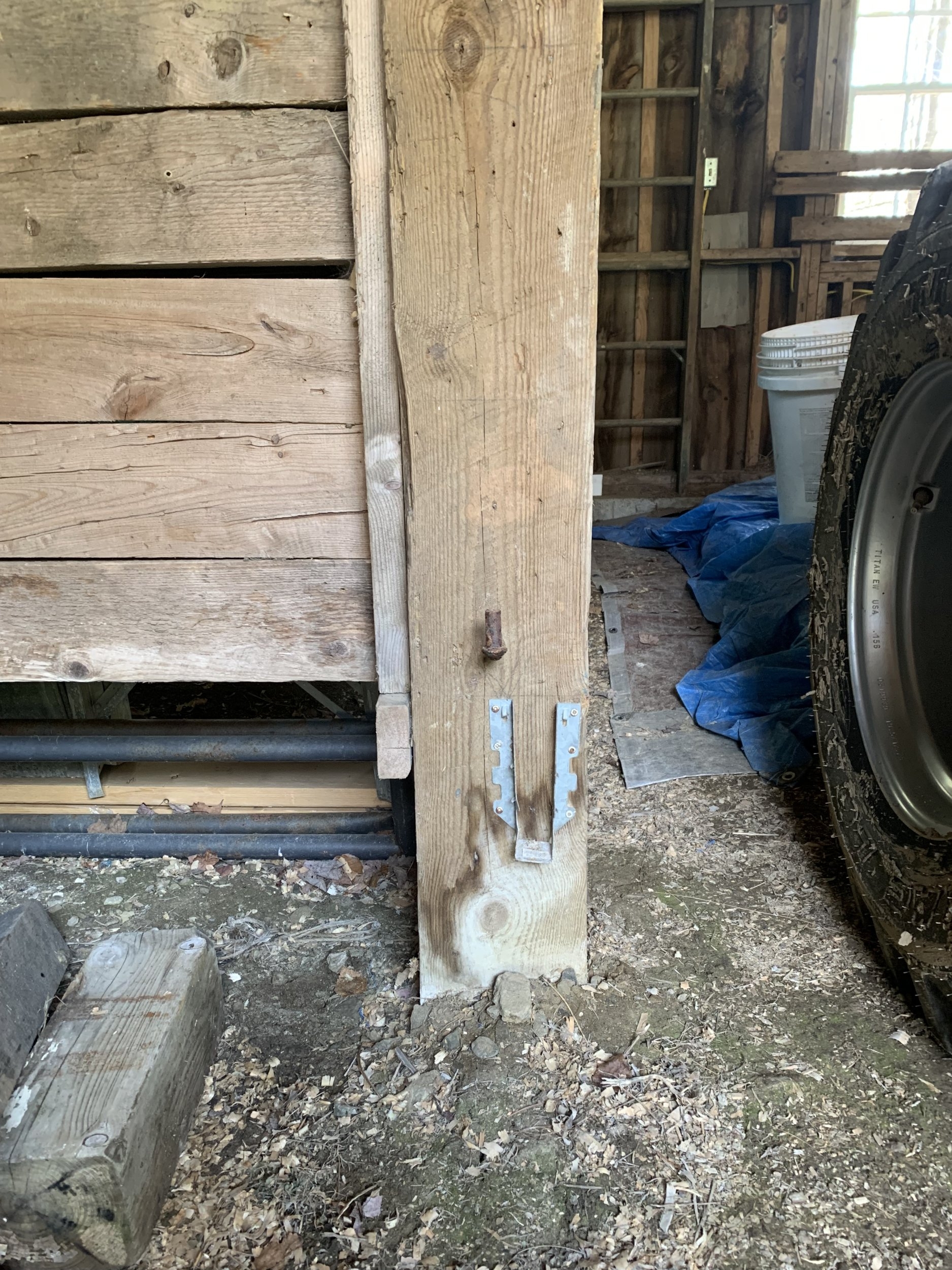

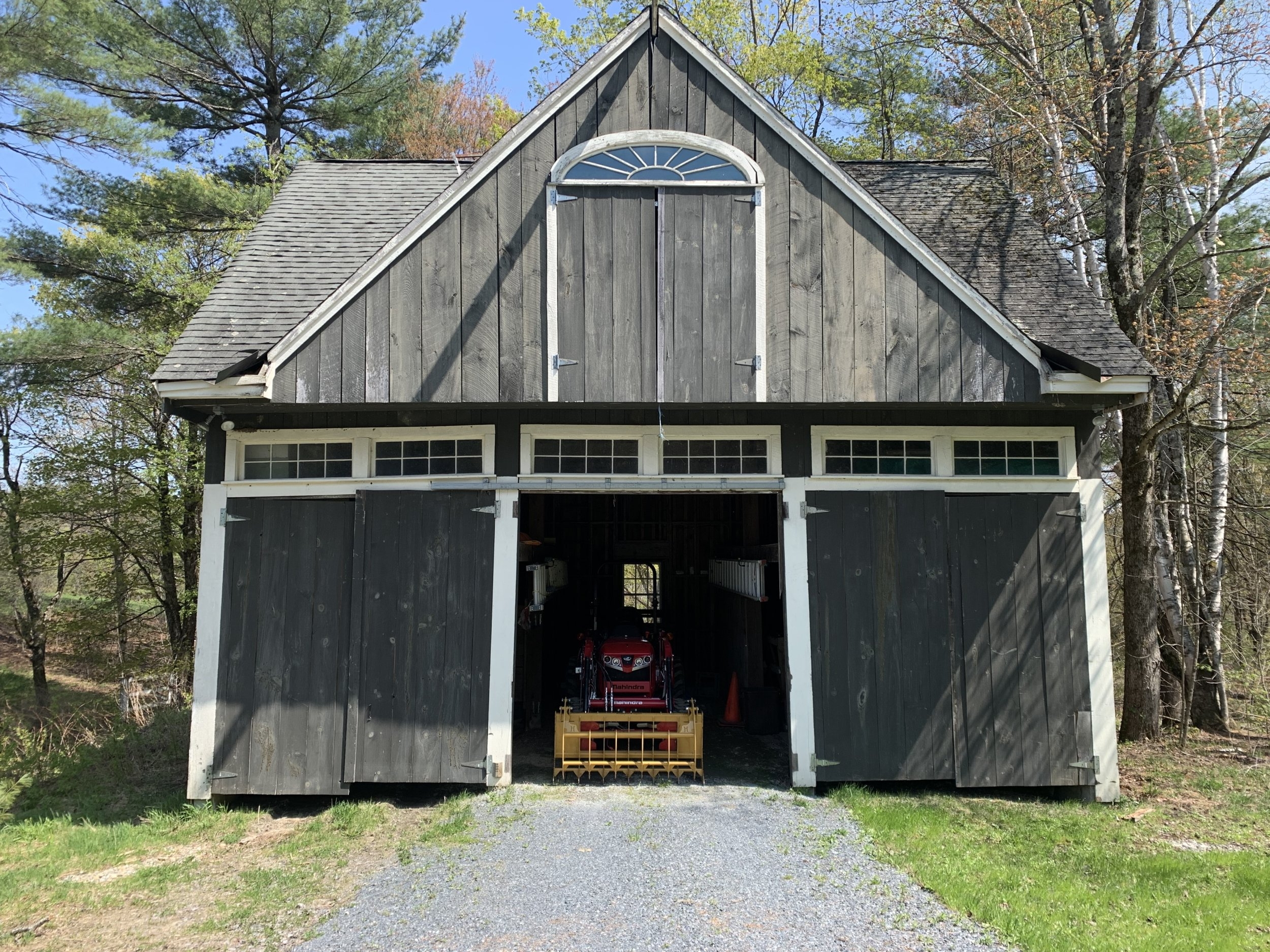

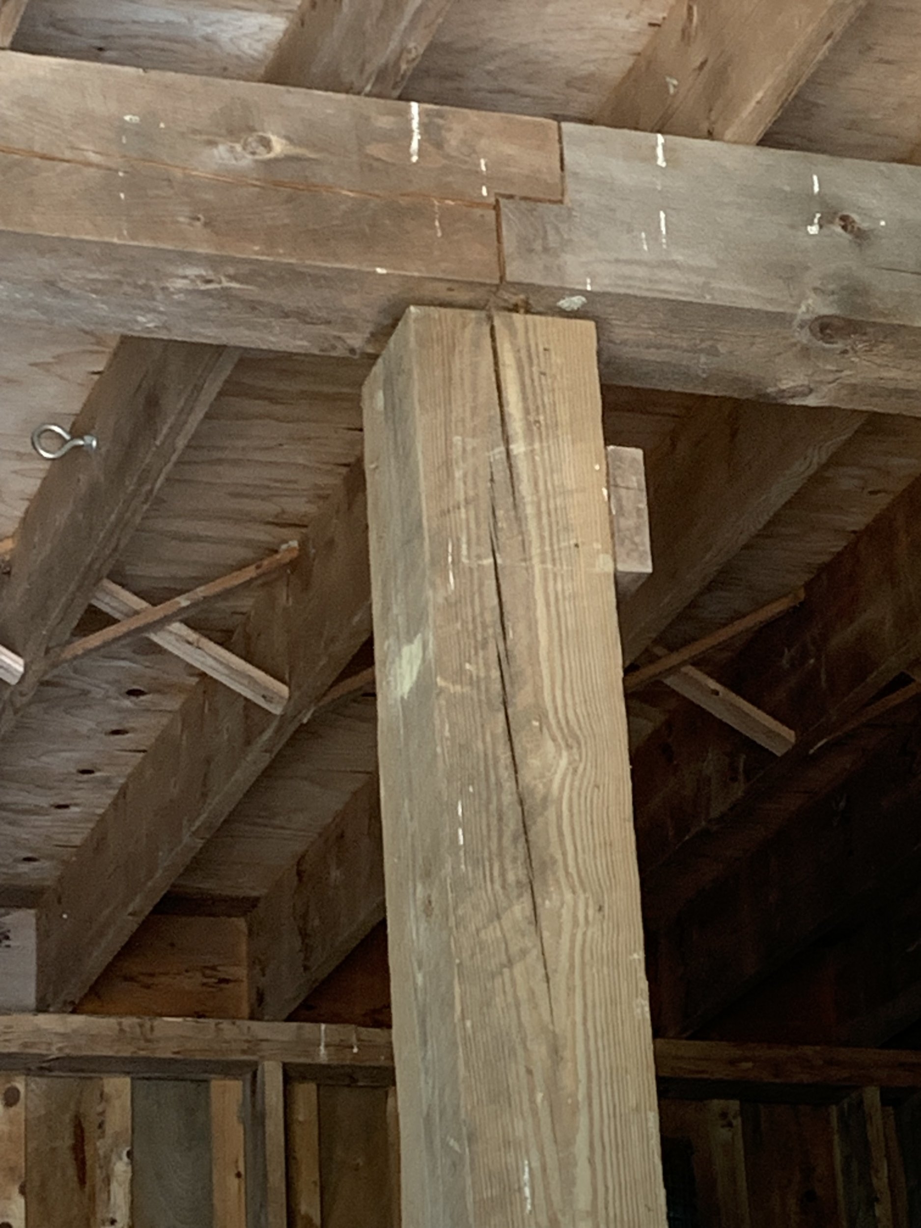

Thanks for all the great comments thus far. Keep them coming. Some of you asked for pictures. Note how doors no longer meet evenly. Barn sits on foundation wall on 3 sides; front and middle of barn supported by 8x8s sitting in/on
dirt floor. Note also separation of post/beam at top of 2nd level. Once I determine whether to raise sides or lower center of structure, I'll cut bottoms of posts and set footings into a poured concrete floor. Barn is only 20 years old. As we purchased property 2 years ago, not sure of how foundation was poured, what's under them, etc.

WOW! I wonder if this building was put up by a professional or Joe homeowner. It looks like you have your work cut out for you. I don't really know where to start.

Just me eyeballing it I’d say looking at the front the right corner and left corner have settled. I’m not sure a string line and one of those little level bubbles that hang on it aren’t good enough. They actually make string designed for this, you need to get it really tight.
I’d set something like a stake at each corner a few inches above the floor, you can use a rebar driven in the ground also. Do the same thing at the other corner. Wrap the string around one stake and leave it alone. Then move the string up and down at the other corner until it’s level. The level bubble I’m thinking of just hangs on the string. You want the string close to the front wall of the building but not touching it. Then you can measure down to the various points along the building. There is a little technique to learning how to get the string tight but where you can move it up and down a little but you’ll figure it out.
   / Determining how badly my barn has settled/heaved #33
Pictures of the sides and back? Is the front the worst?
