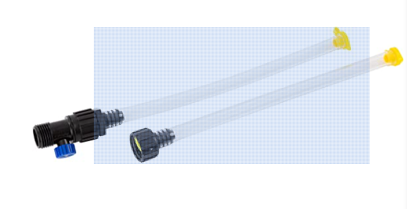

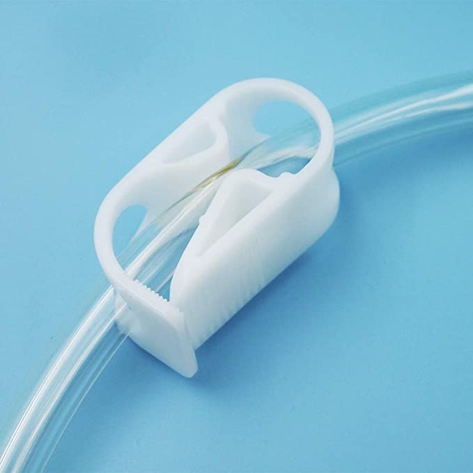

I think they used a water level on the pyramids. It will work on a barn.
   / Determining how badly my barn has settled/heaved #42
Who knows how level they are today? Does the ground freeze over there? Lots of variables.
   / Determining how badly my barn has settled/heaved #43
That was then. They had lots of cheap help too. I suppose they had plastic tubing from a big box store too!

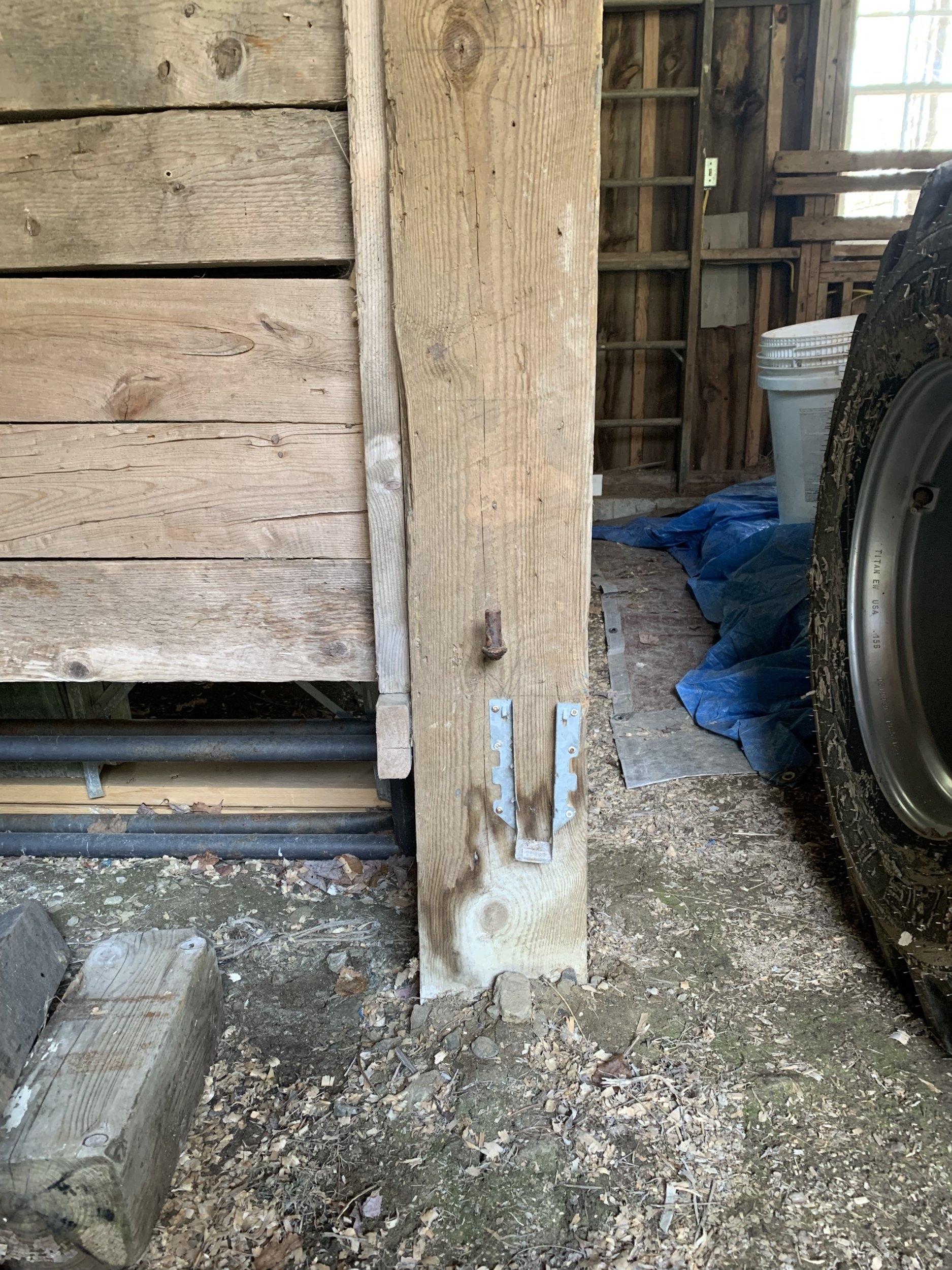

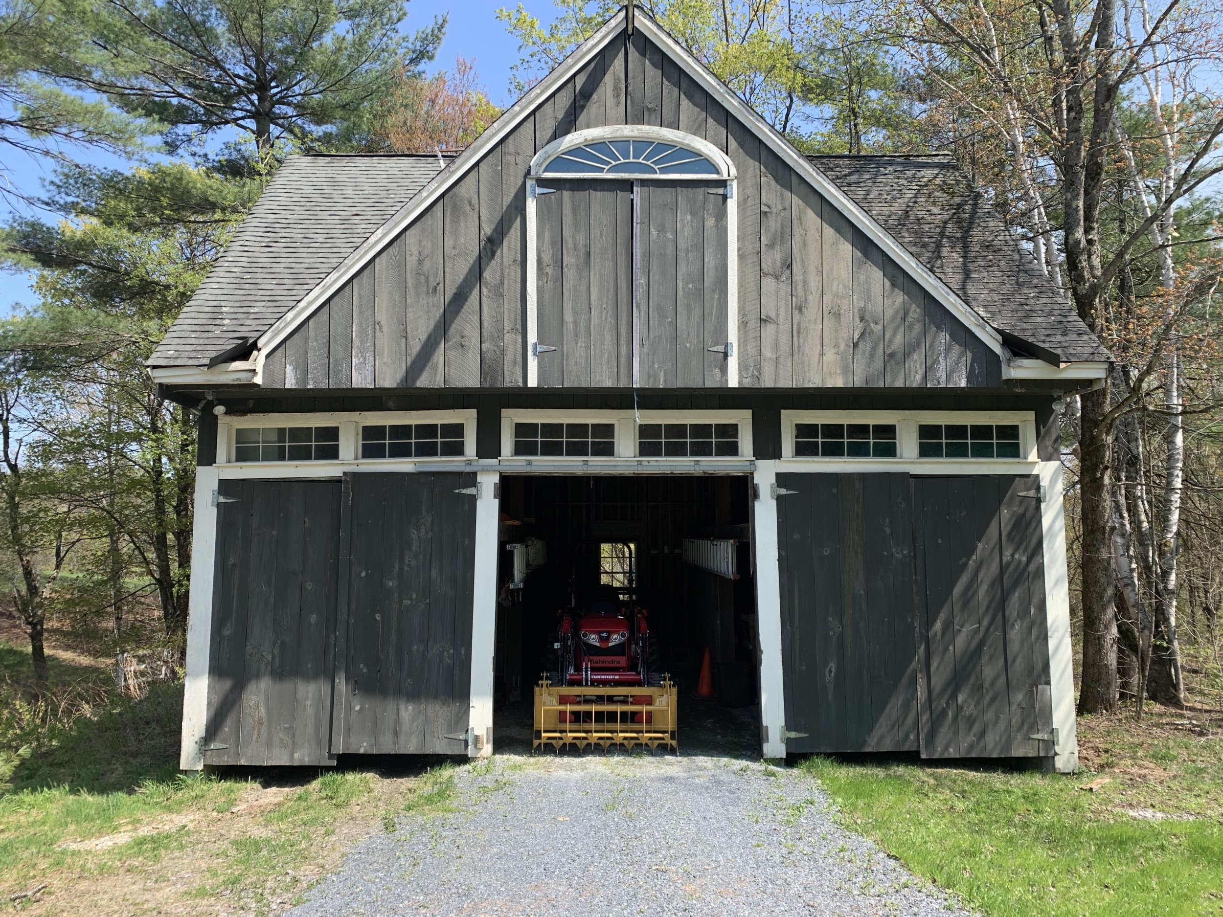

I've got a 30 x 25 dirt floor barn that sits on a concrete foundation on 3 sides. Framing is 2 x 6 construction. There are two sets of 8 x 8 posts rising from the front wall and midway back to carry the load across 3 door openings across the front. All 4 posts terminate in the dirt floor. I'm not sure how deep either the posts or the foundation walls go, yet. Looking at the front of the barn, it is obvious from door misalignment that the foundation has either settled or the posts have heaved. The center is higher than the two sides. Not sure about front to back yet. I will either need to jack up the barn walls along the foundation, or drop the center of the barn at the posts. To better understand the task ahead, I want to lay out elevations, at the 4 corners ground level, as well as above in the lofts and along the posts. Thus my question: how do you take accurate elevation readings? I don't own a ziplevel altimeter, or even a laser level. I'm happy to invest modestly in equipment (renting equipment nearby doesn't appear to be much of an option). Would love to hear how experienced "surveyors" would tackle this.
I have to install a driveway with a pipe and some fill. I got a used self-leveling level for $200, and I'll sell it when I'm done. You can get new for $250. Lazer levels start around $350, but you don't really need the small increase in accuracy. The best thing about a lazer level is one person can use it. That is the only way I would deal with a foundation. Set it up twice to double check your readings. You can use the rod (make sure to get one) to get the higher elevations by measuring from a known elevation below. I'm not a surveyor, but a Professional C. E..

Since you’re in New Hampshire, I’m going with the post have heaved from the frozen ground each winter. It may only come up a fraction of an inch but over the years it will show.
