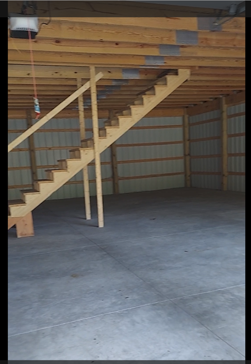

I'll ask the new contractor (To be determined) if the stairs can be relocated to the back and support poles used in the middle.

It looks like all the floor joists require additional support. With the "mending plates" all lined up it looks like you could have one failure easily cascade.
Are the mending plates nailed in or just dependent on their "teeth"? If the latter my first thing to do (and soon) would be to go around with nail gun and put some nails in each mending plate.

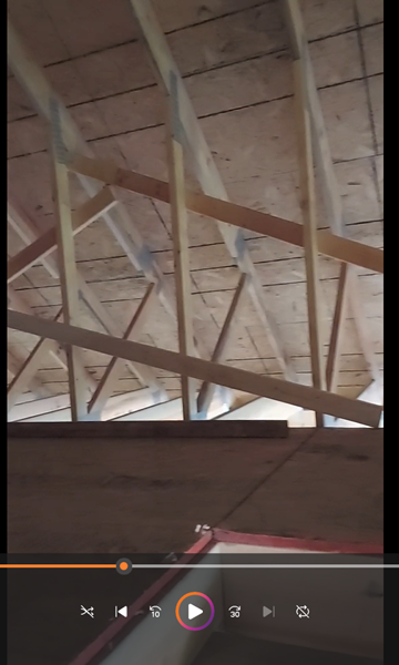

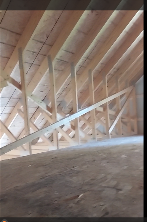

Your 'joists' appear to be the bottom chord of engineered attic style trusses. The plates are offset because a 14' + 16' board gives your 30' span, no problem. It would be nice to see the truss design document, so that the supports, spacing, etc. could be checked. Sometimes, intermediate supports along the truss are specified, sometimes not. Would the town inspector have them on file? Assuming they are properly supported, the design floor loading would probably be 20 psf or more.
I'd be more concerned about the stair opening. It appears one or more trusses were cut and altered, which would put additional stress on the adjacent trusses. I think you said this work was done after the inspector passed the installation, he/she wouldn't probably have accepted it.
/ Pole Barns Basics - what to do, what to avoid #25
The toothed "mending plates" hold the ends of the loft's floor joists (?) together. They are the only things connecting the long boards together across the 30 ft. width. And they are all (with a few exceptions) in a straight line from front to back. They aren't in the middle, they are offset by 1 or 2 feet. I was wondering if the two different board lengths were supposed to alternate each time, so the "mending plates" are offset from the adjoining ones and there wouldn't be one long straight weak point for the full depth of the building (40 ft.)?
You definitely have some things that need to be addressed, but those are not one of them. Those are not "mending plates", they're truss plates. Those trusses were designed that way. You do not need additional support underneath them, unless you intend to put some sort of extraordinarily heavy loads on the second floor.

Is there any tags on the trusses identifying manufacturer. You might chase that down for how the trusses were planned and maybe a design drawing. Drawing would have floor loading and additional on site bracing etc required. I have similar attic trusses in my building, but it is only a 16 ft wide attic. My bottom cord under the 16ft room is a 2x12, plated to 2x6 or 2x8 going to the eaves. Attic has 5ft knee walls. Roof slope is 7/12 pitch. Jon

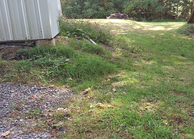

...But there is no clear path around the barn toward the back yard seen in the background. Maybe a second, lower, retaining wall is needed to cover the drainage pipes and to provide a level surface for small equipment (Kubota BX size) to access the back yard. The well is in the front yard, so back yard access would be for septic, tile field, etc.
Do you need access back there wider than a BX for a septic pumper truck or something?

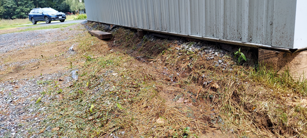

I would just add fill where ever you have erosion issues and add a gravel trench on the drip line to handle the soil erosion. If water drainage is an issue then you could easily add some drain tile to move the water to where it isn't an issue. As has already been mentioned, I would also pack some gravel under the slab where it needs it.
I like your desire to move the stairs to the rear of the building and to repair the cut truss/trusses.
I can't say for sure but to me it looks like the trusses were designed for a second floor. Maybe talk to a trusted engineer on that one. I'm pretty confidant that you will address the safety railing issues etc for the second floor.

I don't understand why many of you guys are freaking out about the presence of mending plates in an engineered attic-room truss. That is how every single truss is made, the pieces of 2-by are only coupled together with plates on each side of every joint. Of course the plates are all in the same spot on every truss, in a row - they are supposed to be. It's completely standard procedure and capable of handling the designed loading. In this case I would speculate (for upper NY) it's for a decent snow load and light storage load (IE don't fill the attic with file cabinets or pool tables and you'll be just fine)
Agree that the stairs were done poorly. Like buckeye said: with trusses 2-feet on center, you cannot just cut one apart to put in some stairs. You need doubled trusses on each side of the 4-foot gap, and then you still frame back in heavily. Since this is already done, I would buy matching 2-bys to basically build an extra truss on each side of the stair gap. Or move the stairs (because having them in them smack middle of a building is ridiculous) and repair the cut one fully, and add extra framing in the back when you move the stairs.
Stairs should definitely have a continuous stringer, at least 3 of them, from top to bottom. You need to bulk the stringers up with extra 2-bys running along side them also, I'd think. One thing you could consider if moving the stairs is to use the good continuous-stringer portion from a ~3' tall landing that you build, say with a 90° turn in the stair path.
The erosion outside can be fixed, just get a huge load of dirt delivered and build way up around the building as needed. Then gravel under the drip line for sure. Or better yet, gutters with downspouts. Erosion should never be allowed to get that bad in the first place, it is undermining your slab and you'd better fix it ASAP.
