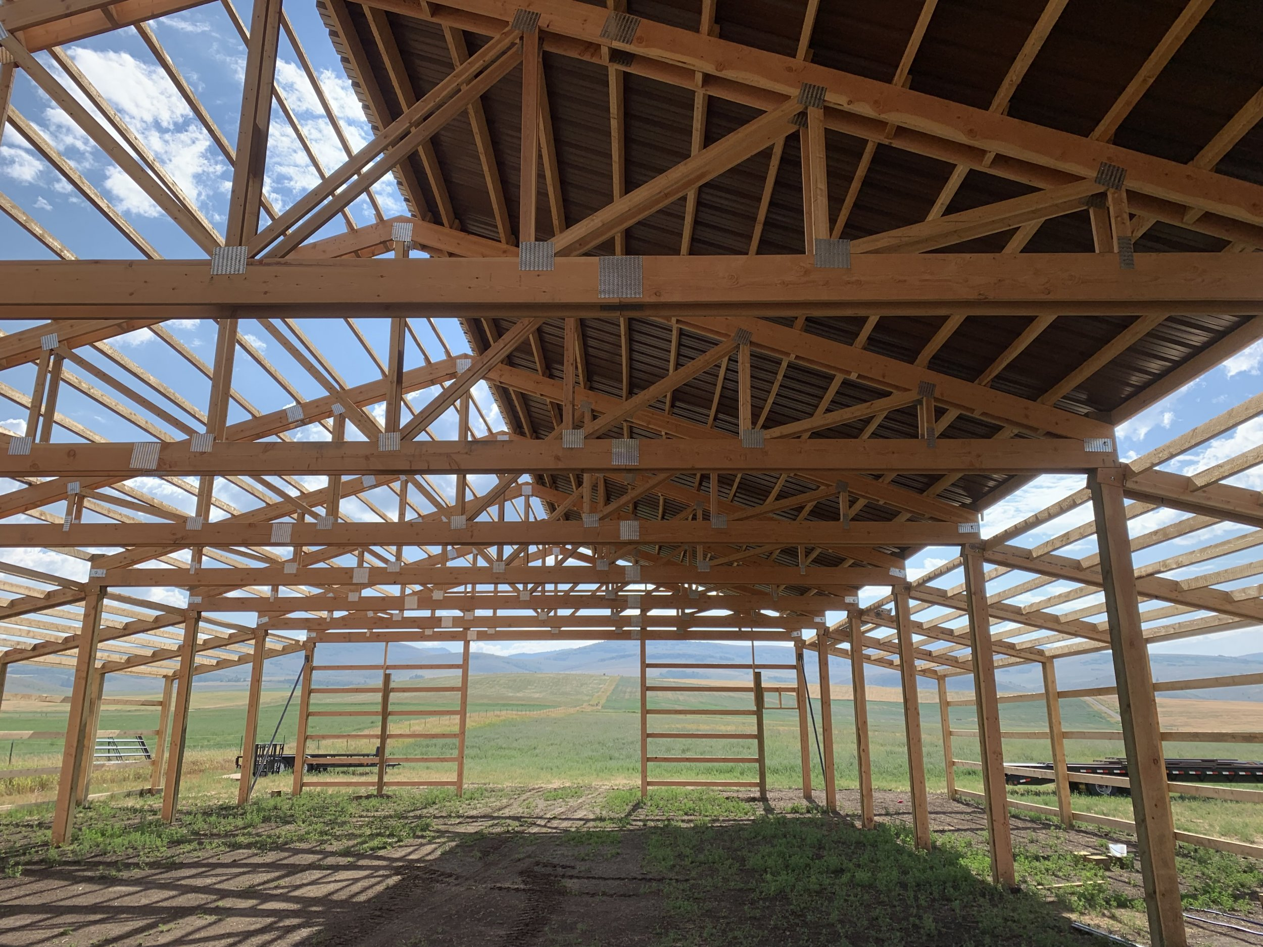

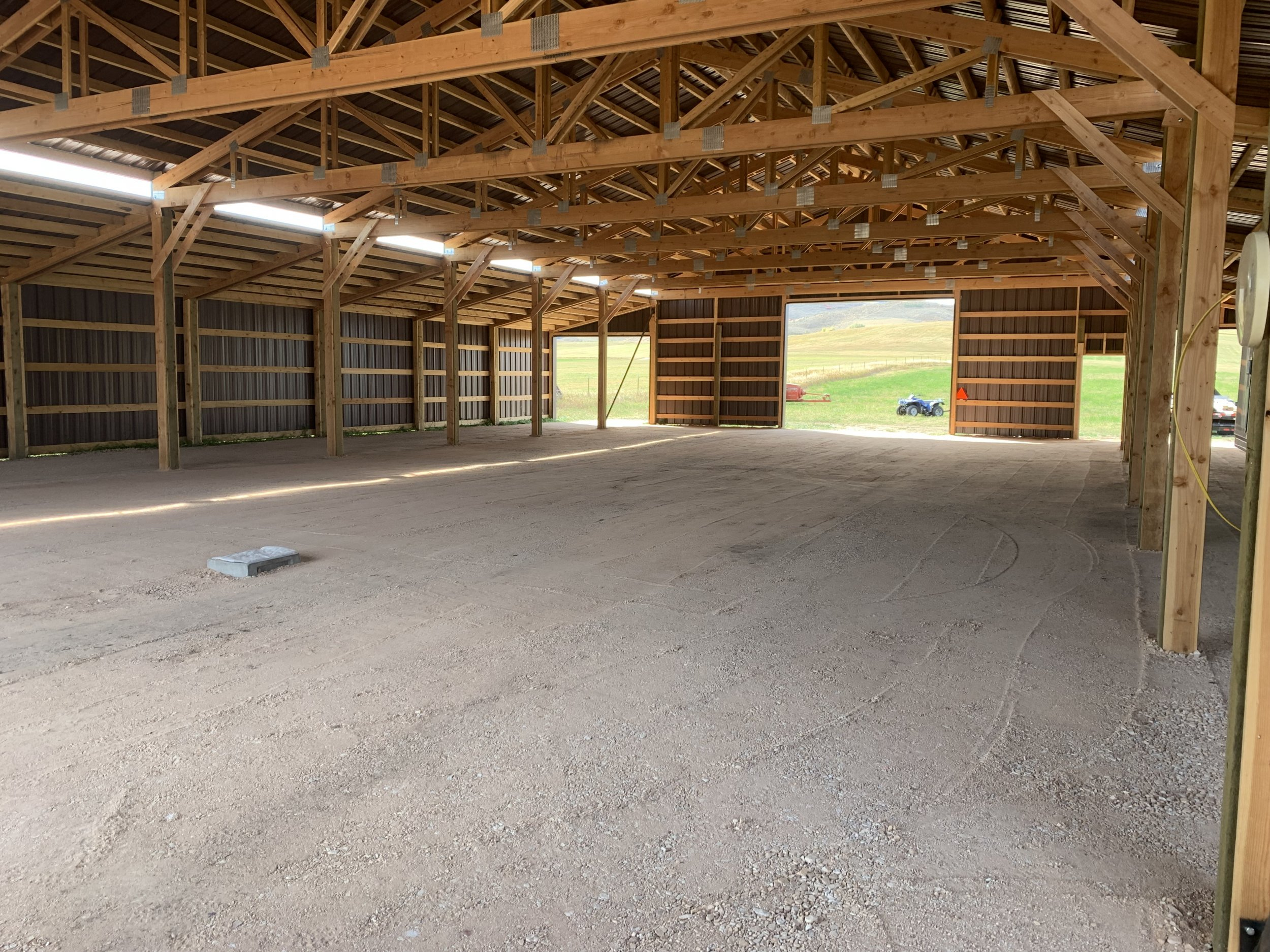

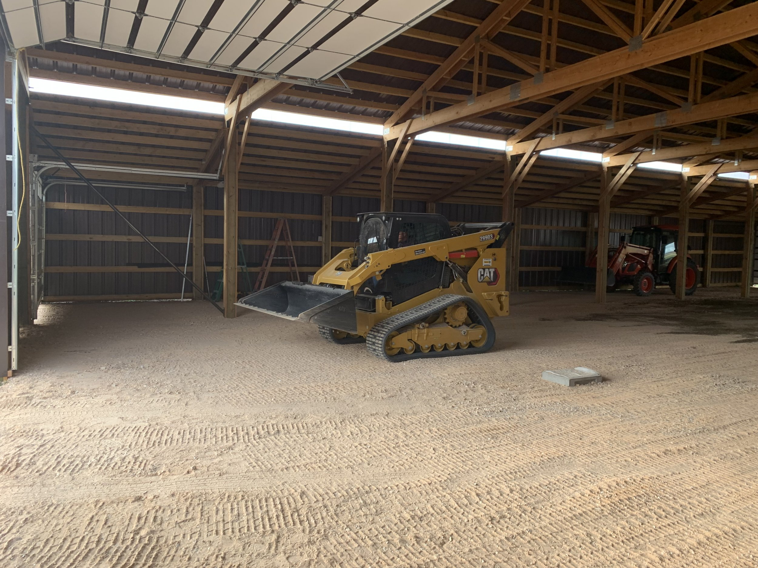

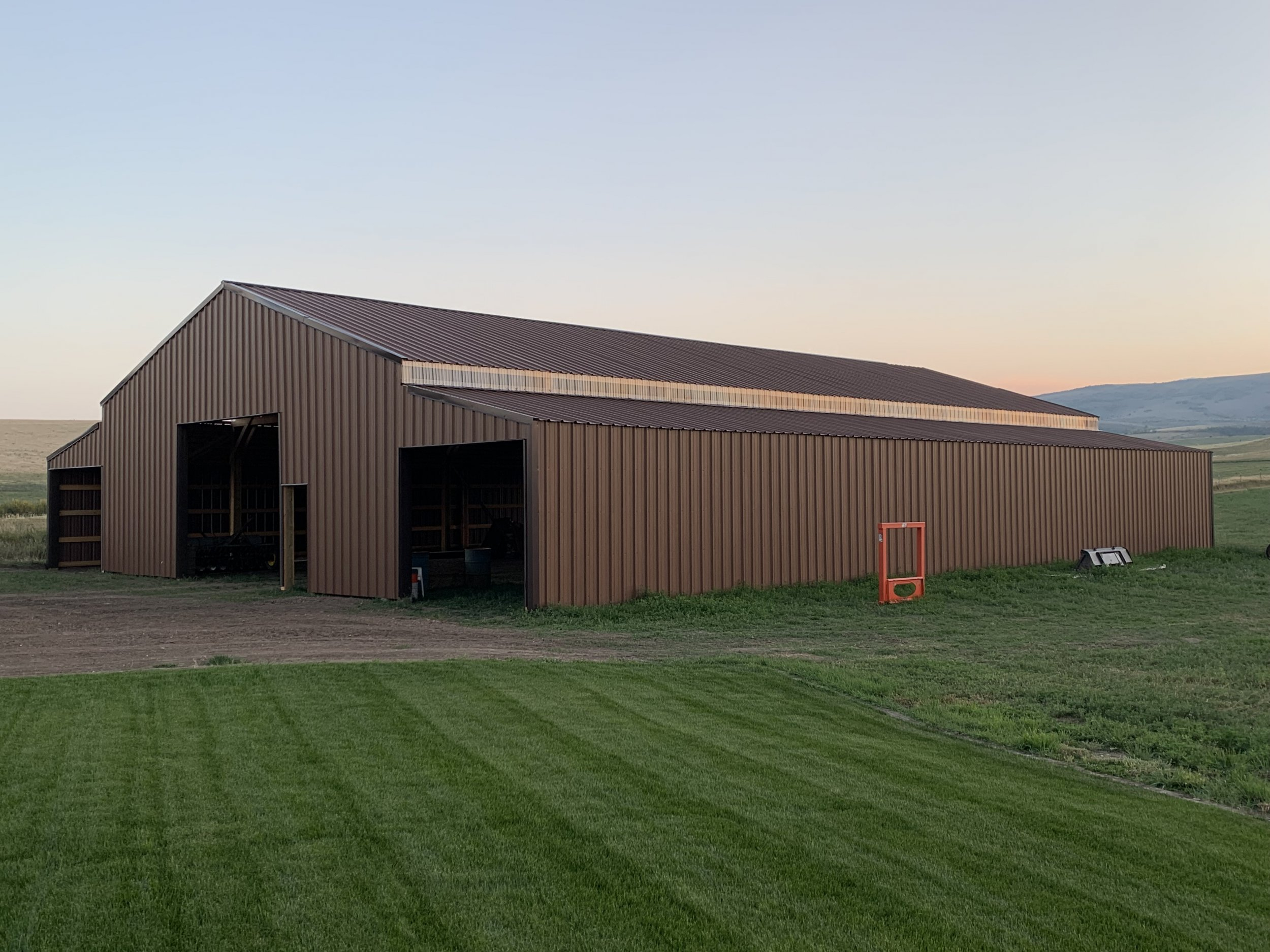

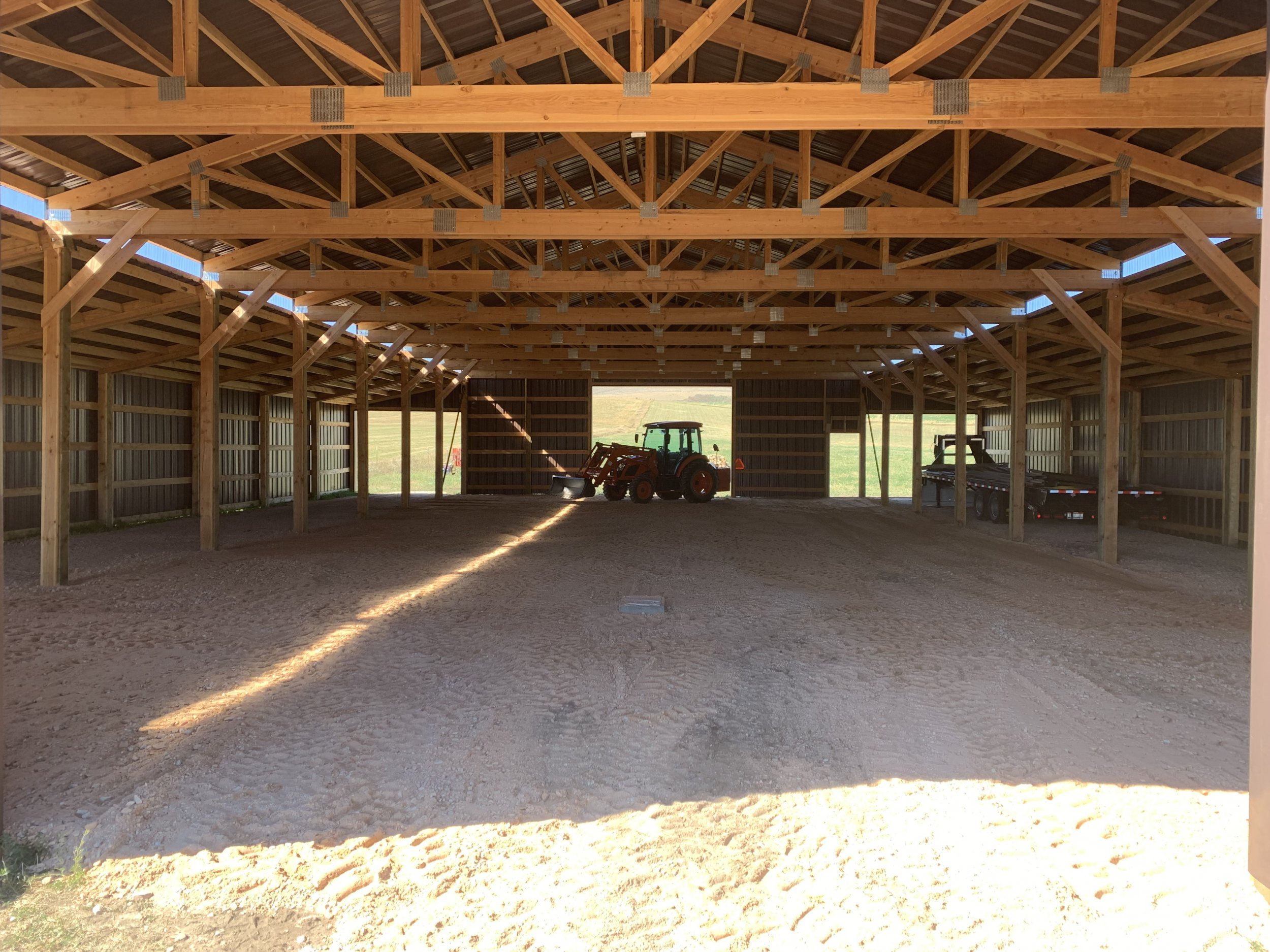

With all the metal on it's time for translucent panels. I love these, they let so much light in.
View attachment 735254View attachment 735255
When I built my MiL's, I used the clear polycarbonate 'skylight' panels on the roof, and holy cow did it ever light the place up. Been 15/16yrs now and still holding up with no yellowing or crazing.
/ The last Barn. (maybe) #65

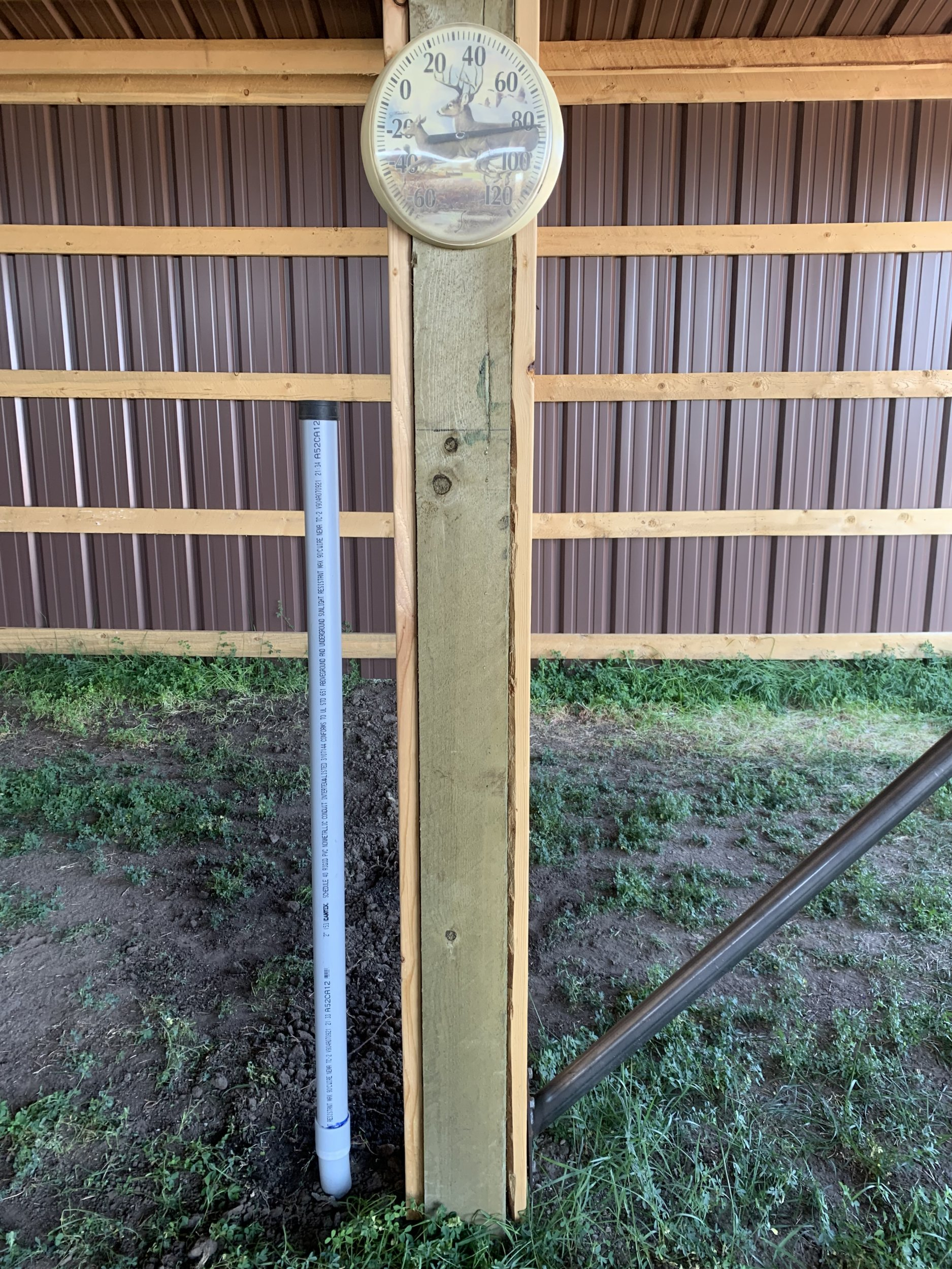

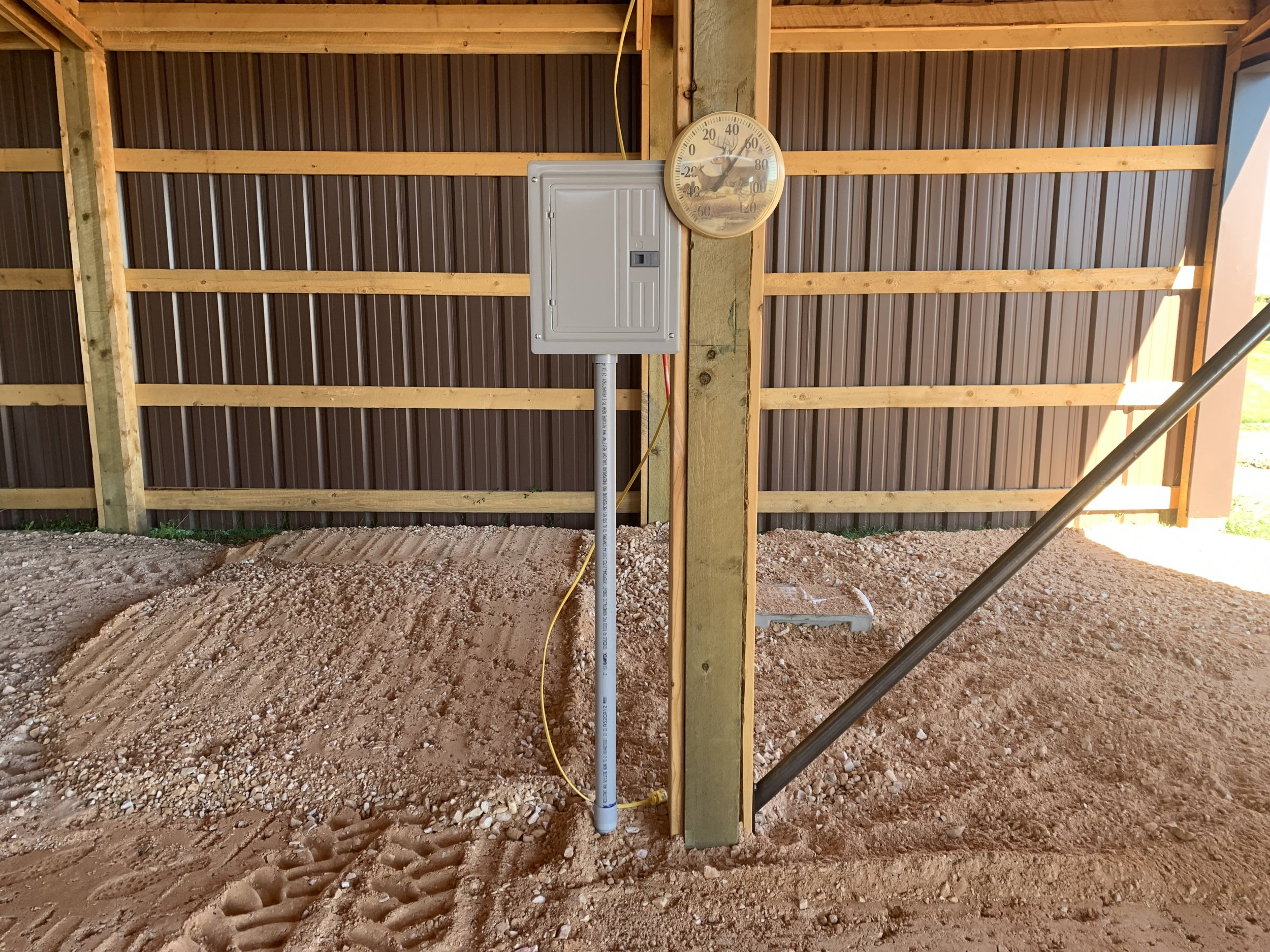

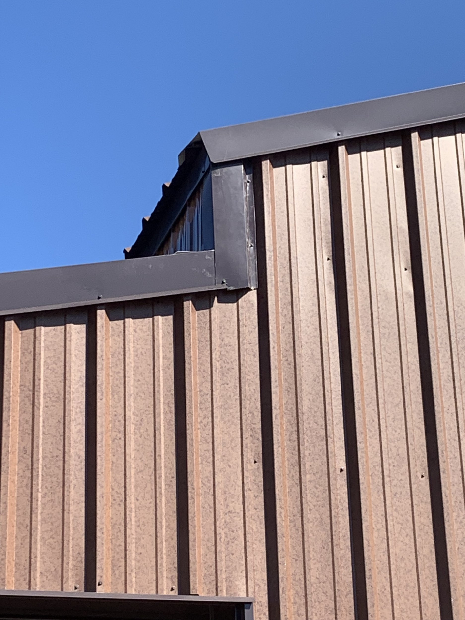

Well at this point the metal is done, translucent panels are done it is time for all the trim work and road base inside. I did put in some drains and power conduit before the road base.

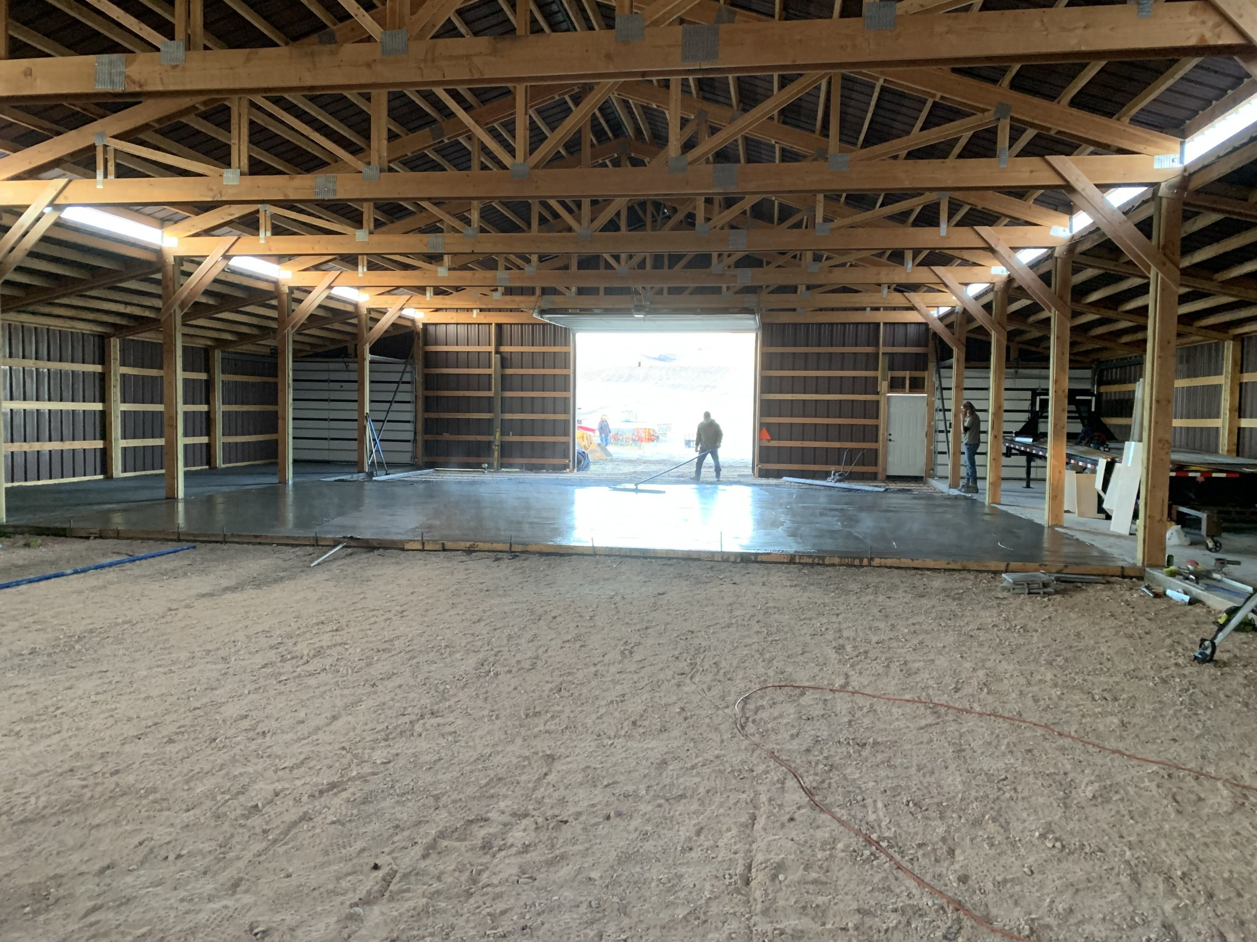

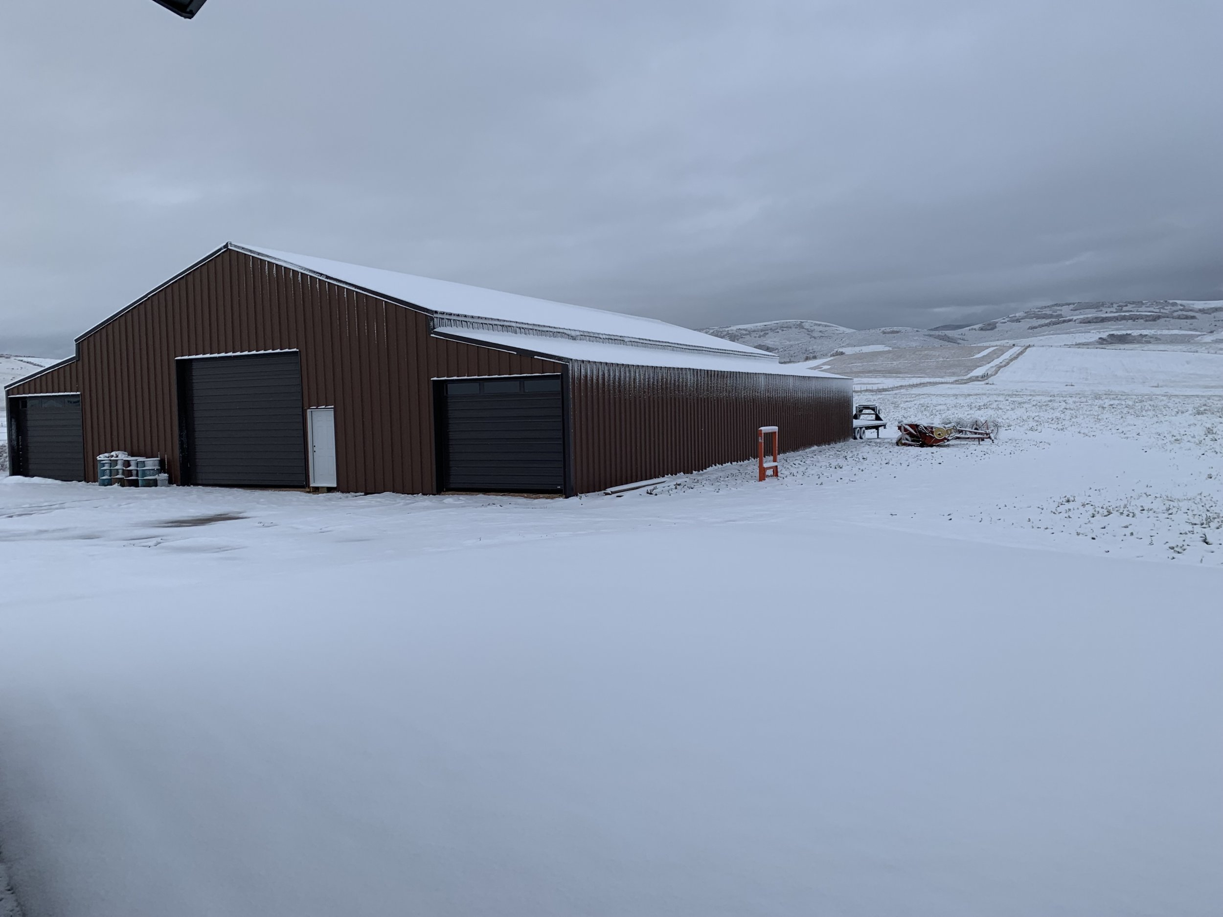

While getting the barn ready for concrete this happened and it really put me in a bind for time. It was routinely freezing at night now. This melted quickly but still I knew I had to hurry.

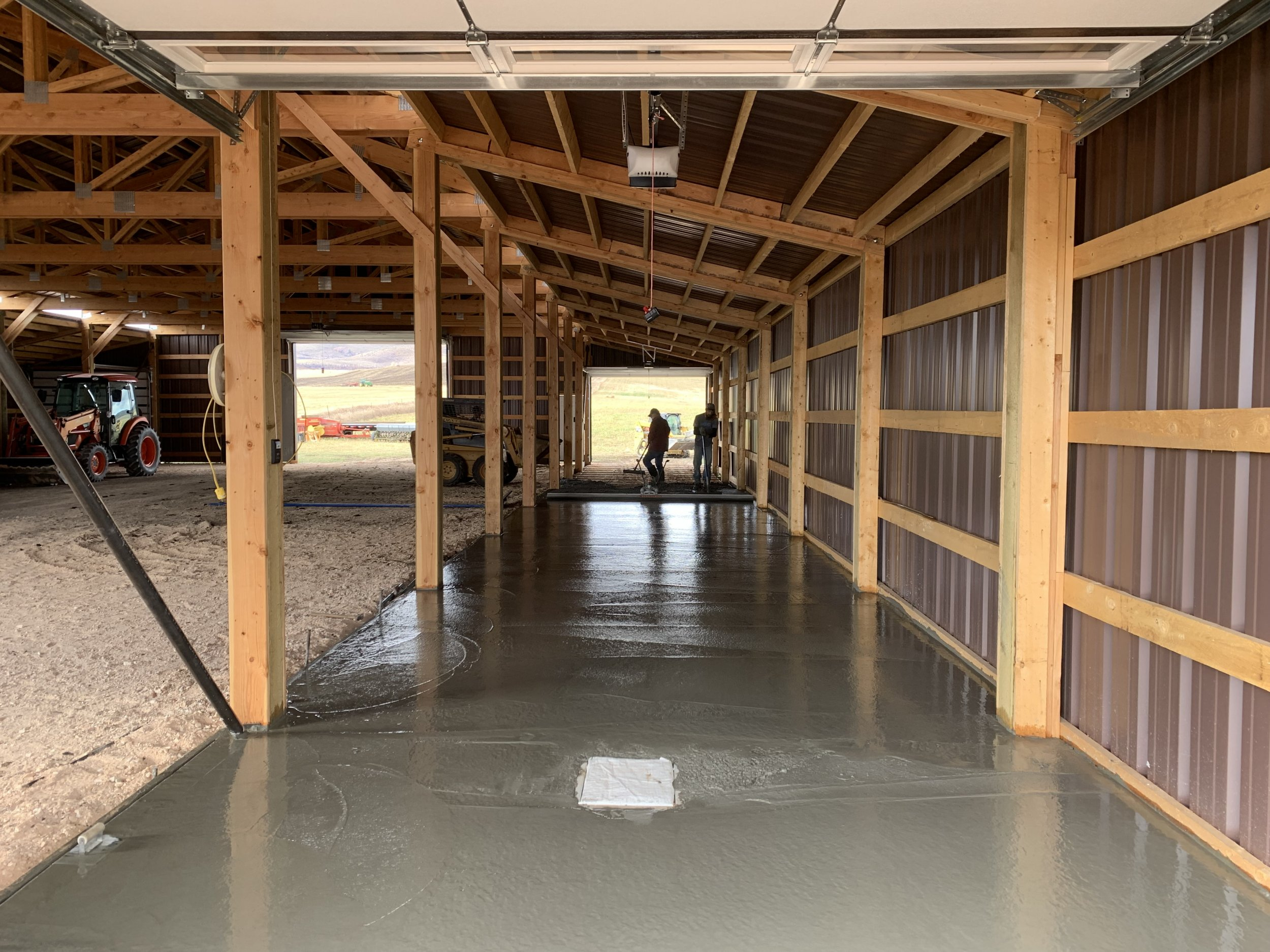

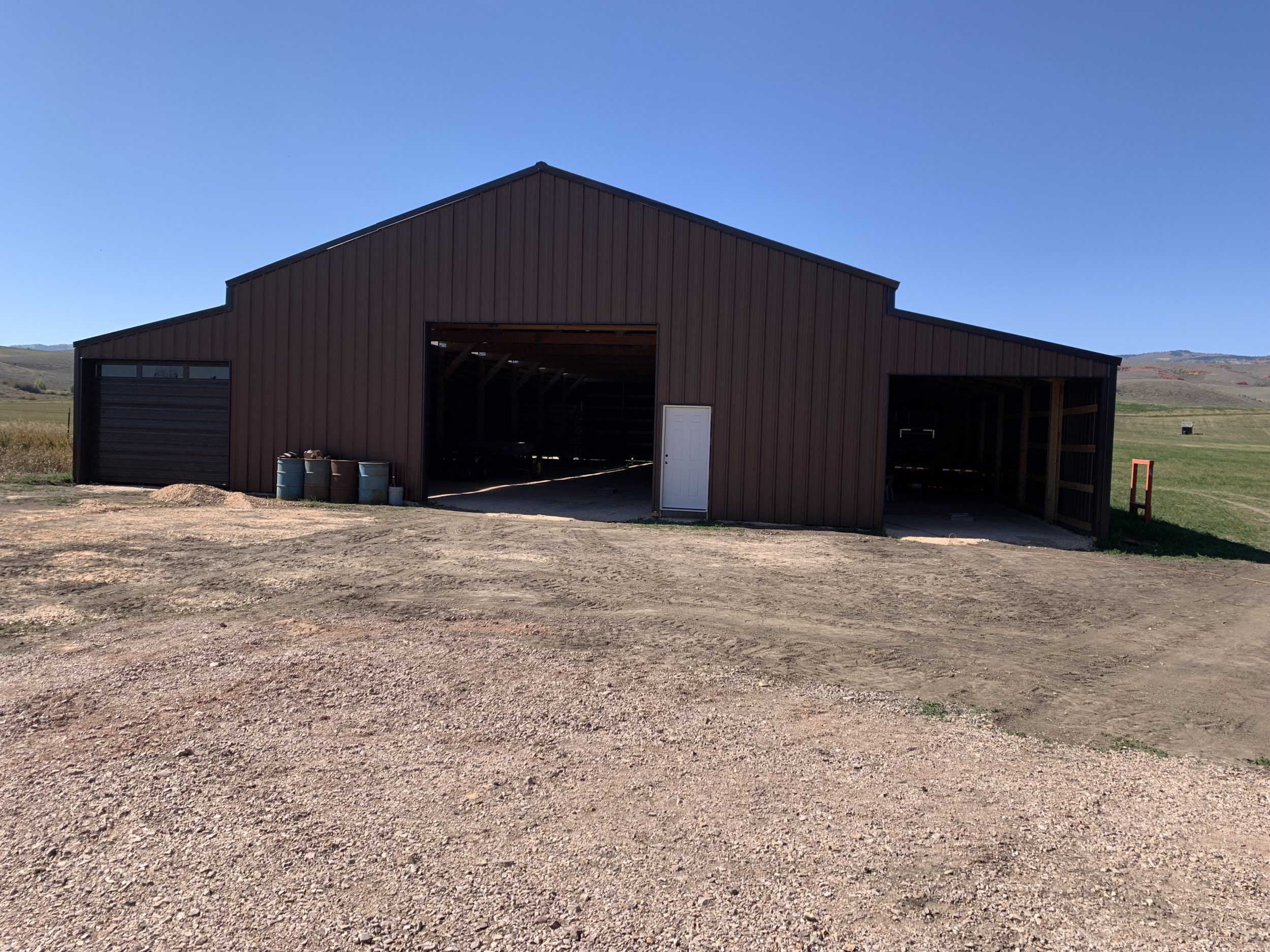

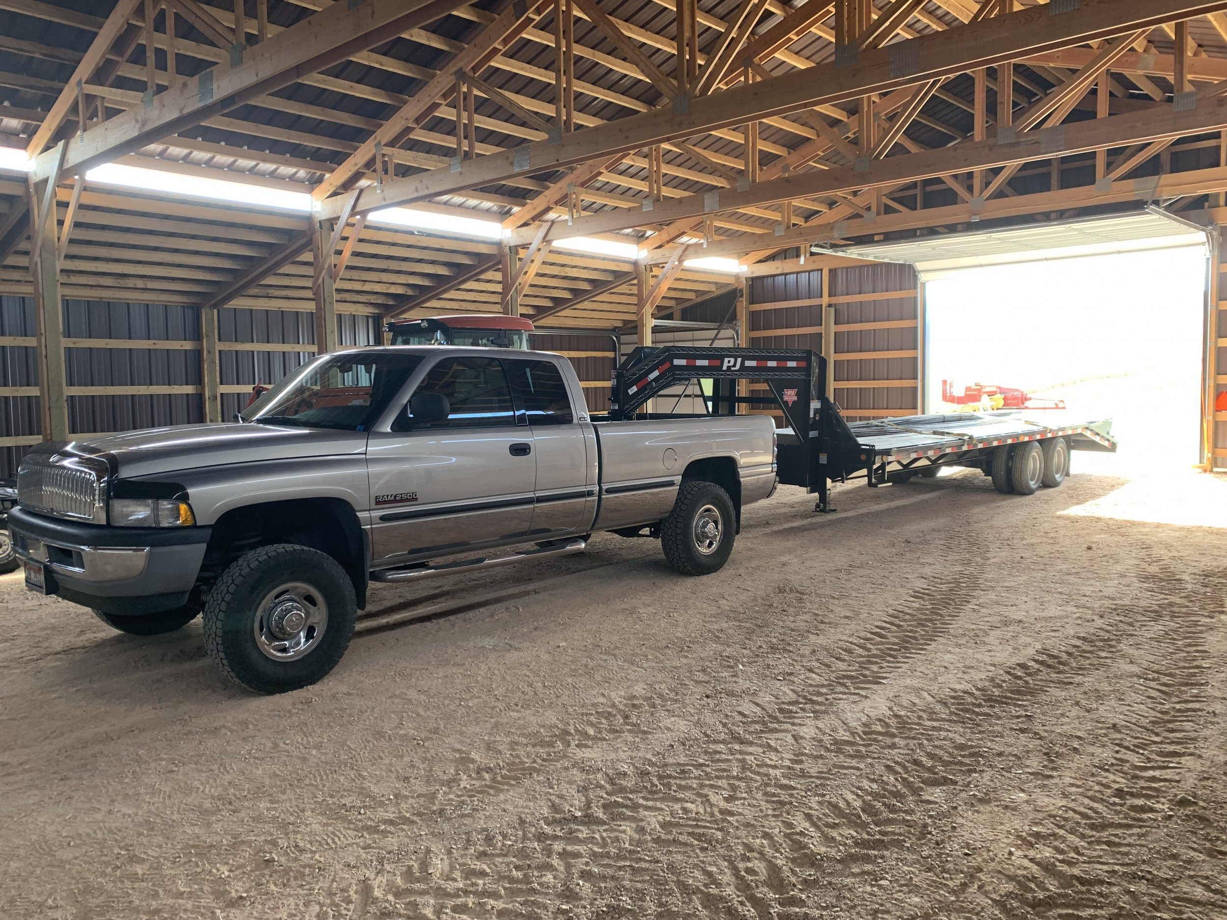

Some might wonder why I put the doors in before the concrete;
There are lots of critters and deer around here and I didn't want tracks in the concrete.
With that said it's rebar, concrete time. If I remember right it took 103 yards.

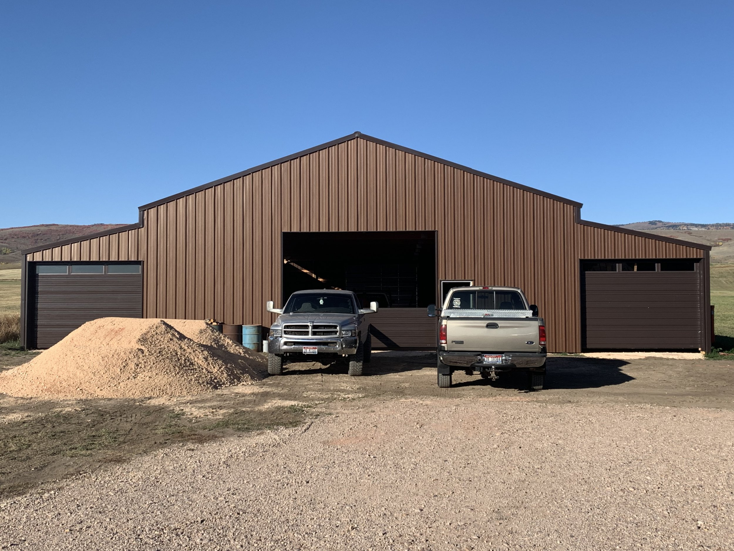

Rebar was pulled up while pouring, they had a guy dedicated to doing that. Most of the concrete was 4.5-5" thick, up in the front and middle of the barn it was 5.5-6" thick.
We could not chair the rebar because all of the concrete was brought in by skid steer. That was my own fault because the whole building was supposed to be taller. When the post holes were drilled a few of them were really deep ( I knew it) but I thought I had plenty of post to make up the difference, well I didn't. The middle section was supposed to have 14' doors so a cement truck would fit in and the awning doors were supposed to be 10'. Basically we were 9" short and it messed up the whole thing. Didn't realize it until the trusses were going up. It's no big deal other than not getting the cement truck in and now my snow machine trailer doesn't fit where I planned it to go. Easy fix though, I'll sell the trailer I have and buy a new one 6" shorter.
For a home job I'm still very happy with the whole thing and most people that come and see it don't know anything about the height issue. ;)
