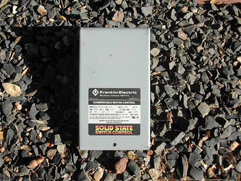

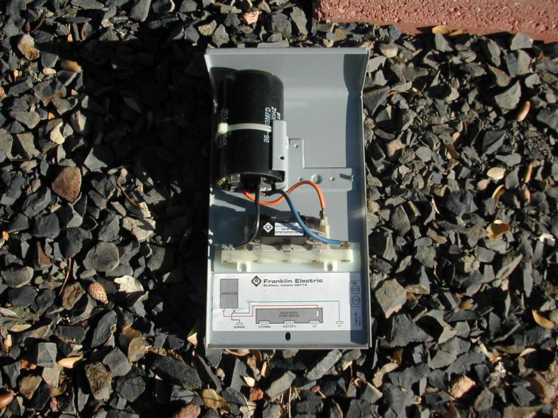

My well stopped sending any water ... I can't feel the pump running, and I was able to before.
I've checked and am getting 240VAC through the pressure switch to this starter. With the starter off, I did a continuity test of the two pump wires and got a little over 5 ohms. I didn't test the "start" wire to the pump because I don't know what to test for on that wire.
The pump may be shot. It's been down there since at least 1993. However it is only run for 45 minutes every 4th day so it wouldn't have the hours on it that most would of that age. It's great water but we only get 55 gallons/day. I pump to a cistern that supplies our house pressure with a jet pump.
I THINK there's water in the well. It's never failed to refill after pumping in over 25 years. The early pumps died because of sand and dynamite plastic residue eating the impellers, no problems with motors.
How do you test these starters? I was hoping to open it and see someplace where the smoke got out, but it appears just fine. I know I could just buy another since (compared to the pump and labor for being replaced at 320') the cost should be rather low. But IF I need to replace the pump, I'm opting for a Grundfos helical rotor style pump rather than the centrifugal impeller type, since it is an unlined well and could/would still get debris and the helical rotor type is supposed to handle sand and debris with no problem. So I'm reluctant to buy another starter just to see if this one is bad.
Suggestions PLEASE.

Hook up the box and take a voltage reading on the wires when it try's to start and is truing to run
Can you see in the well is there any evidence of the torque on the well pipe when it try's and starts?
These pumps are usually 2 phase with a relay to put the capacitor in the circuit to create the phase shift to start.

Thanks for the tips Tom. I'm not sure I can see if there's any torque without lifting the top of the well, which is pretty heavy with 320' of pipe full of water and a pump attached. I could make some short jumpers to test voltages when I try and start it but I'm not sure what I'd be looking for there, either.
The closest pump shop is about 25 miles away. Do they normally have a tester for these controllers? (I'll make phone calls AFTER I get advice/suggestons/knowledge from my friends here at TBN)
I have a tall engine A-frame that I could use with a winch to pull the pump. The piping is PVC in 10 ft sections. I'd consider putting one-piece poly back down.

any motor shop can check the pump it dosen't have to be a well pump gut

the only thing i have ever seen happen to a starter is the capacitor go bad: if you have an ohm meter, disconnect the starter and check across the cap: it should show a short an then as it charges up, go to high resistance: if not, its bad an won't "start" the motor...you can see the cap in one of the pics you posted...with it out like in the pic, FIRST, put a screwdriver across the terminals to discharge any voltage that may be there: if it sparks i would bet its good: but then put the ohmeter across. if you end up needing a pump, look on ebay, i got a brand new one for a lot less than i could get anywhere else.

I'll check the cap, tho I'm not holding my breath.

When I worked on pumps we made a jumper from an old box so you could plug it in and set the lid to the side. You can then check the pump wires with an amprobe and tell exactly what the pump is doing. If it is getting off the start winding or staying in. You can check the start amps and the run amps. That is a way to know exactly what your pump is doing. Low amps, no water. High amps stuck / dragging.

Using jumpers to have the controller set aside.... DUHHHHH. And I'd have never thought of it. I have an inductive ammeter for my Fluke.
Since I'm using a generator still for power, I notice it doesn't seem to be loading up at all. I normally pump 250 gallons every 4th day and it fully recovers in 4 more days. It's been two weeks since I last pumped so I gotta think there's water.
