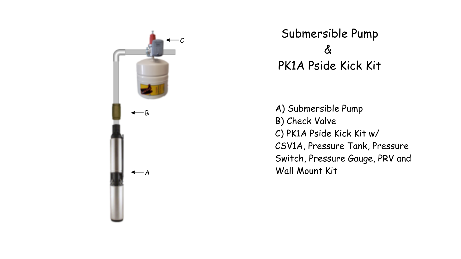

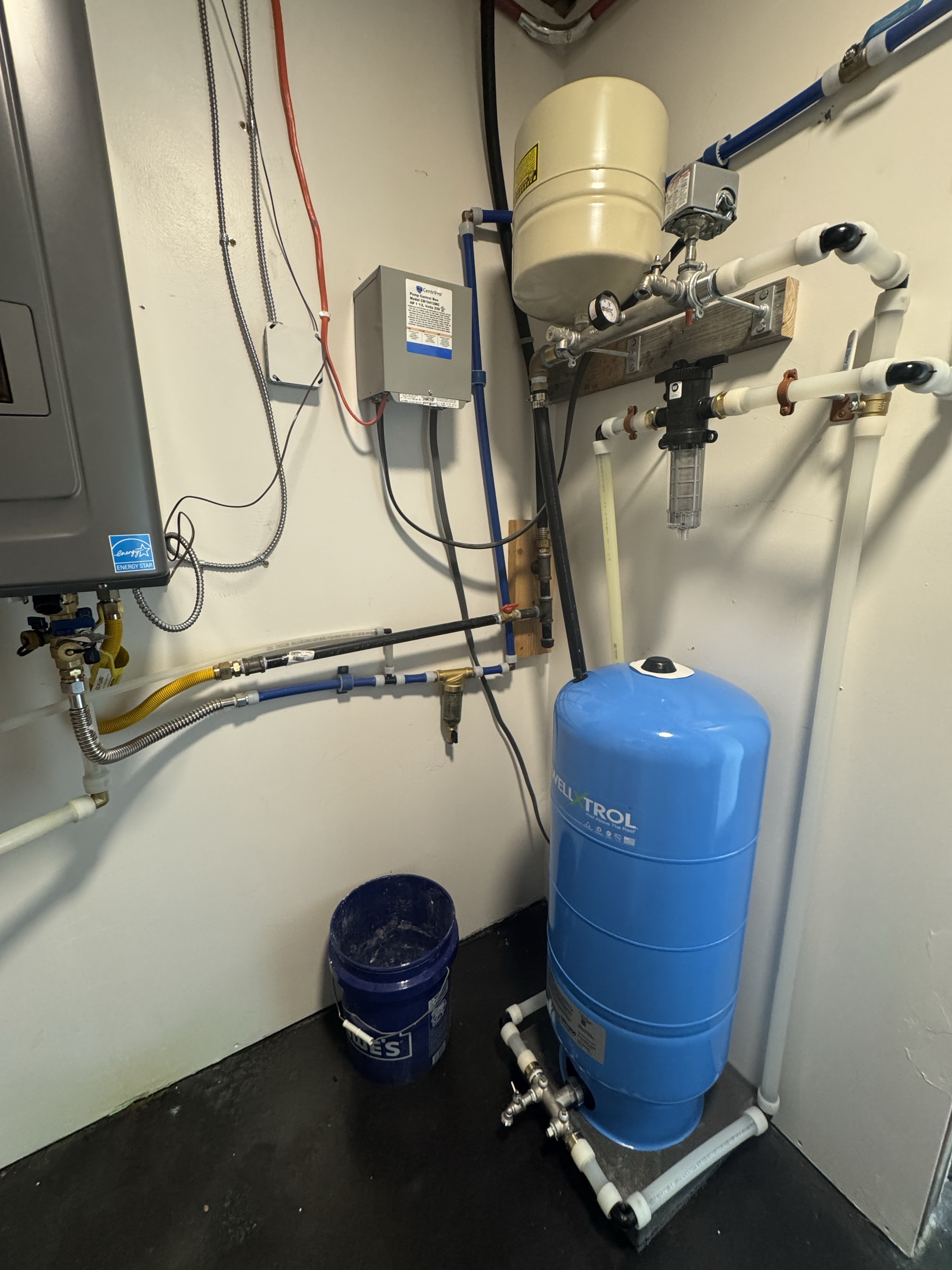

After reading two more pages of posts on the CSV, and deciding to go have a look at it, I'm ammending my prior comment. This actually looks like something from which I could benefit, as we have a relatively small expansion tank (layout was sort of "locked in" by available space) for our irrigation system demands.It's hard to argue with the simplicity and decades-long history of reliable operation from a plain old pressure switch and expansion tank, when properly sized and configured. There are endless theories on why CSV's and VFD's should be better, but I've honestly never felt any inclination to switch away from what just keeps working reliably two decades at a time, and is an easy quick repair when it eventually reaches end of life.
We have an hour of near-constant usage every morning, through which our well pump cycles several times 10 - 12 times. It has never been a problem, our last well pump lasted more than 20 years (maybe even 30 years?), and the present one is still doing fine at 15 years. But now we have teens taking long showers, which only adds to the cycling.
So while no dire emergency, the CSV does appear to be an easy install from which we could probably benefit. But what's not clear from the explanation on the web site or the PBS video, is how you control pressure in the ABS line dropped into the well casing. I'd guess there's probably a bypass in the pump itself, but given my line is probably 50 years old and has never seen over 60 PSI topside (=125 PSI at 150 ft depth), I'm not sure I want to subject it to whatever the bypass pressure is set at, or the possibility of a single point configuration. In a normal system, the primary pressure switch located at the bladder ensures the line never exceeds that pressure plus vertical rise.
