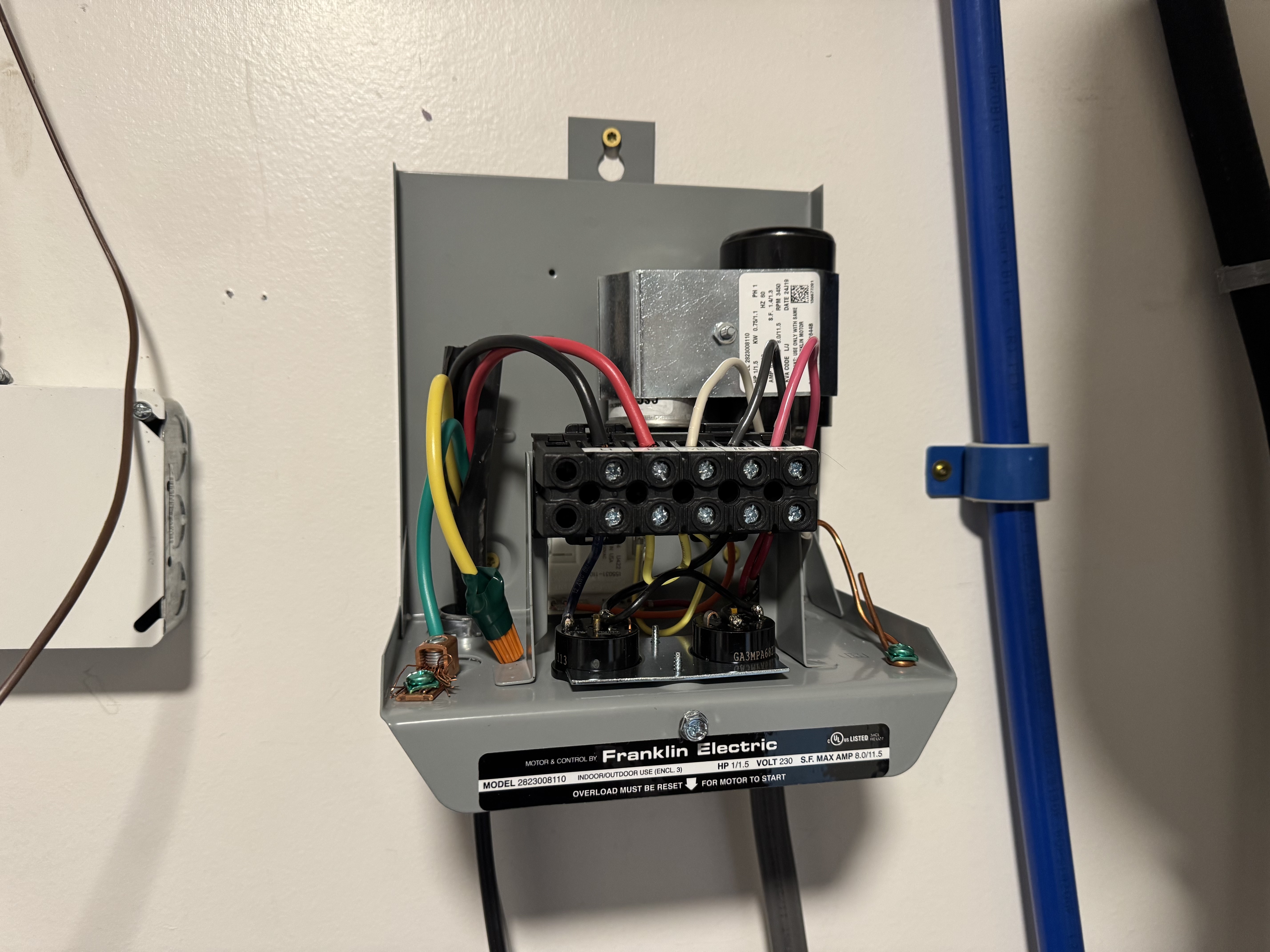

This is the third strike. I replaced the original box with one that had magnetic switches in it. That was $260. Then it happened again and I tried replacing the capacitor and the capacitor blew so I put a new franklin box in that was identical to the original. The current box which is 1.5 hp not 2 as I had incorrectly stated earlier. This is the new box. I still have not flipped the power back on since putting the replacement capacitor in.

The first click might have been the start winding (auxiliary winding), the motor would run with that winding out of the loop, but not long because it is now overloading the main winding. Eventually it will trip also.
Is the motor a 2 hp or 1.5? Capacitors and overloads are sized to the motor.
Interesting you have two overloads in the control box. There used to only be one on 1.5 hp pumps. I don't know when they made the change. I don't get out in the field much anymore.

So my wife just walked in and asked if I turned turned the pump off again. I went and checked it and just using a voltage tester pen, there was juice going to the pressure switch, then to the control box then out to the pump. That kind of scared me because I figured it meant the pump was the issue. I pushed the two buttons on the bottom of the control box. First one clicked then pushed the other and it started running. About ten seconds in, a click again. The pressure tank is fill but obviously something else is wrong. And I’m sure pushing the buttons will only work for another couple cycle’s before it doesn’t work any more. I have the original control box which is identical to the current one so I’m looking at it trying to understand how it works and the sequences involved.

If the relay (the other component) in the control box has failed, it will keep the start winding engaged and the overload will trip. Sounds like you have a spare.

I thought I had something to brag about. I sat down with my multimeter and tested the start capacitor that I replaced this morning. 111.8. So that tests good. Then I tested the start and run capaciters on the original control box from several months ago and it both capaciters test good. But the relay shows nothing between 2 and 5. It should be 4500-7000 ohms
I had a spare. It tested at 5140 I installed that in the current control box. Turned on the power and. Nothing. At all. And something clicked but I don’t know what it was. I took it all apart again and checked the components. They test out fine And when assembled, it doesnt do any thing. The pump does not come on. There is voltage to the L1 L2 but almost no voltage to the pump. Overload buttons, start overload tests less than .5. Main overload shows OL.
The inside of the box says that the overload button should show lesss than .5. Could it be down to just the main overload button now?

I think I fixed it. Came out to the kitchen, made myself a drink and sat down to watch more videos. R C Worst has an entire series about troubleshooting the control box and pump, specifically this brand of box so I watched the video that walks you thru how to test the components and when they got to the part about the overload button they mentioned having to push hard. I had pushed it a dozen times today, including when I would do it so we could flush toilets and even did it so my wife could take a shower. Then I read the comments and at least one person talked about how he had to really lean into the button to get a reset, so I went back in there and pushed it again and it reset. I flipped the breaker and it worked. I started counting and hot past 10 seconds, where the overload usually tripped but it didn’t this time. I measured voltage. 363 v to the pump. That falls in line with what I saw last time I replaced the pump control box.
So a new relay and in the process, the main OL button got stuck. I’m gonna order a spare relay. I already have 2 spare start capacitors and a run capacitor. I still have not resolved the underlying weakness that causes these things to pop. It sounds like lightning does crazy stuff is my answer but i’m gonna be looking at some remediation actions. Thank you everyone for the great suggestions and information. Much better than feeling like I am completely alone out here.
