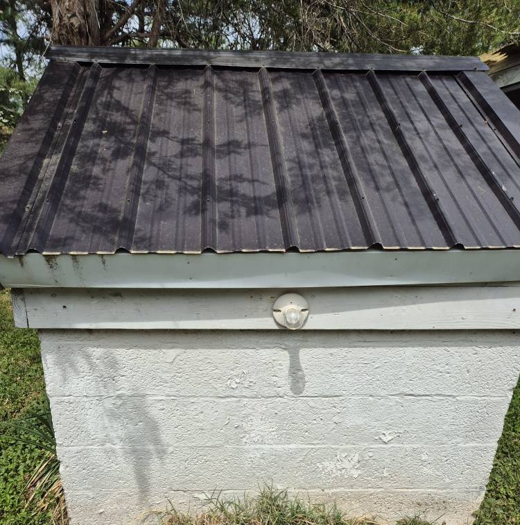

David, I see a pump house near your well as the best long term solution, with one or two proper large storage pump tanks, then segregate your external and internal water lines.
"About 80 feet from the wellhead there is a T and 150 foot line to a hydrant. I intend to put a T in that line and run 300 feet to barn, then t off that and cascade another thousand feet" This is where you could do the pump house with tanks and controls.
Yes this means digging up your water line, and adding an insulated structure to house tanks, switch and controls. That's why i suggest getting a local "pro" to advise to do it once and get it right.

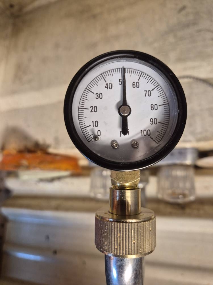

I don't think the CSV is bad. And replacing the Cyclestop valve would require pulling my pump, since it's hanging in line. I'm putting in the extra tank and I'll see if that helps. I'm ordering my tank now. I need a T to connect it, but obviously I don't need a second T kit with pressuer switche, etc. Should I just put in a stainless or brass T with drain vavle and a couple cut offf valves on each side , in case I need them later? Also , my current pressure valve is rated at 80 psi. should I replace that with 100 psi valve or just turn the sustem back down to about 60 psi once I get the other tank installed?
Can I sisimpy plumb the new tank inline after the the T kit and pressure switch that I already have, or does it need to go in front of the pressure switch?

Anytime the system pressure is below the setting of the CSV, the CSV is just wide open like a piece of pipe. If you open enough faucets to bring the system pressure down to 50 PSI when using a 60 PSI CSV setting, you are at 50 PSI because that is all the pump can do at that flow rate. Doesn't hurt the CSV. The CSV only functions when the flow rate being used is less than the pump can supply. When only one or a few faucets are open, the pressure increases to 60 PSI and the 60 PSI CSV would go to work reducing the pumps flow to match the amount being used and maintaining 60 PSI constant.

When you have the PK1A kit with the pressure switch attached close to the 4.5 gallon pressure tank, another pressure tank can simply be teed into the water line anywhere after the CSV kit. The extra tank can be a foot after the PK1A kit or all the way on the other side of the house. When using a larger tank with a CSV, you simply adjust the pressure switch to get a 1-2 minute run time. With a 26 gallon size tank and a CSV maintaining 65 PSI or so as yours seems to be doing, the pressure switch setting will be something close to 55/75.
