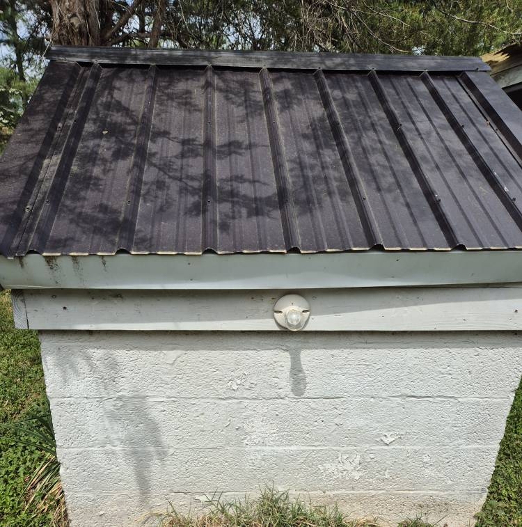

Many years ago I put a 120v light on outside of the well house. I wired it to relay secondary side so pump on, light on.
Running pressure at 50 works ok for us and with normal use: shower, clothes washer, etc. the light (pump) runs 15 seconds & cuts off.
It's really come in handy over the years if it stays on longer there's a leak or valve left on.

The light is a good idea. But the pump running for only 15 seconds is not a good thing. Pumps are made to run continuously 24/7/365. Short runs and multiple cycles on/off will greatly shorten pump life. Minimum run time should be 60 seconds, 120 seconds is better, and running continuously when water is being used is best.

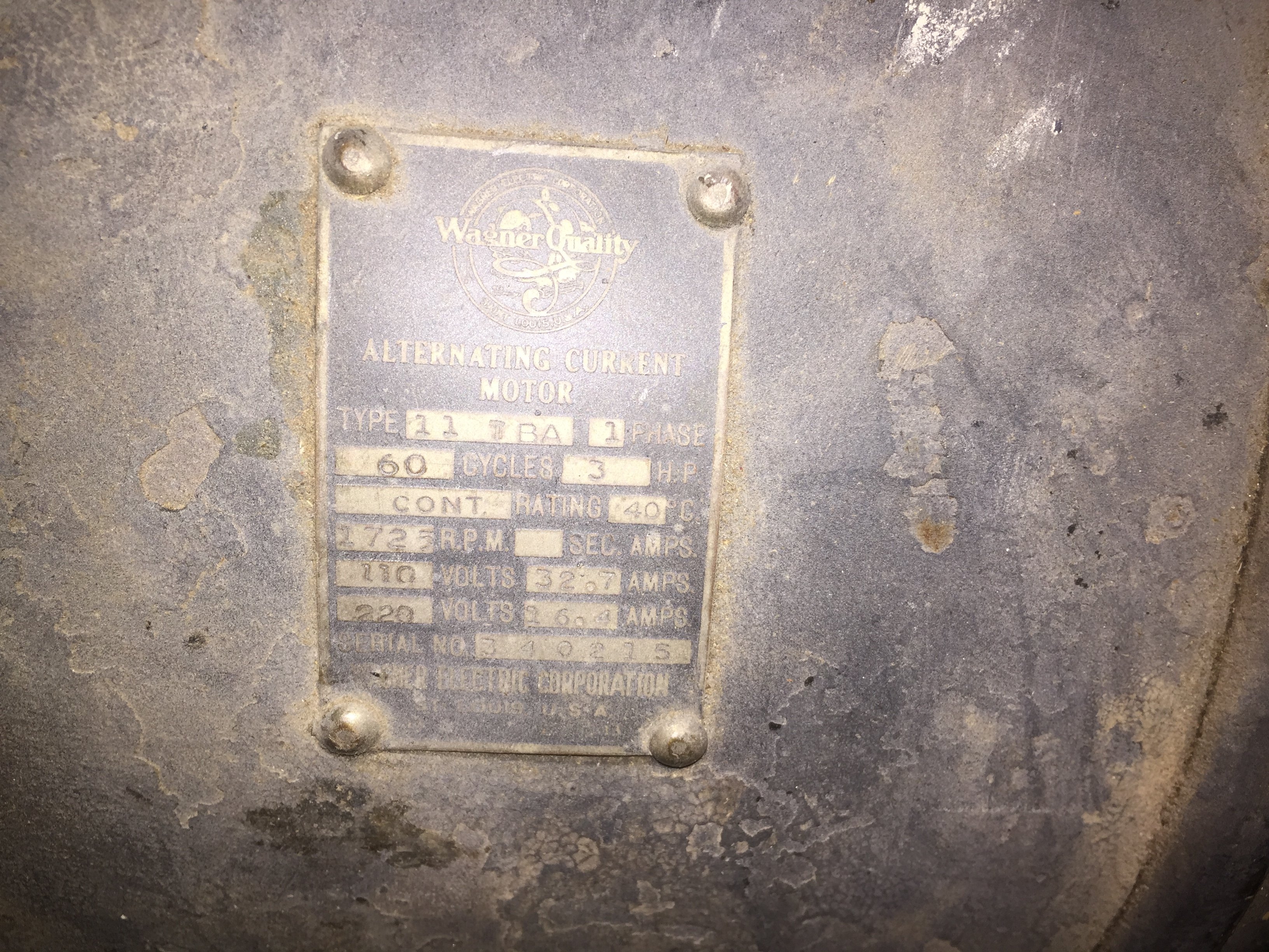

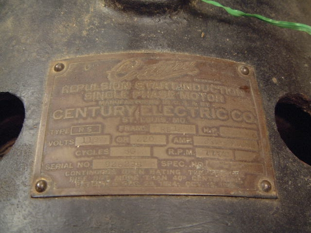

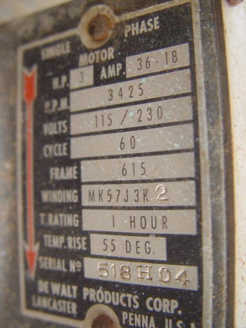

If you want to talk vintage American motors, you're talking to the right guyI Long before tractors were a hobby, I was pretty serious into collecting antique woodworking machinery. I had a lot of old motors from 1911 - 1948, and 2 - 5 hp in single phase, and all of them had some combination of maximum run time (e.g. 1 hour), duty cycle, or a "not to exceed temperature" rating for continuous use.
Since you like vintage American motors, here are three of those examples from my shop, a 3hp from 1948 (DeWalt), a 5 hp from 1911 (Century), and a 3 hp Wagner from probably 1920's or 30's (1934?). The temperature ratings put the onus of duty cycle management on the operator or system designer, as this will vary with application.

The only thing that failed in cap start motors would be the bearings and the mechanical start switch.
The thing that almost always fails on cap start motors, by maybe ten to one over any other component, is the starting capacitor. The 1948 motor shown above has been thru three start cap's in 20 years, but it's slinging an awful big and heavy circular blade, and has inrush current around 60 amps at 220V on start-up.
I also had several motors that were not cap start but were instead the typical single phase motor that used a start winding only, without the cap, and these also were kept running all day without overheating.
It's technically possible to start a single-phase induction motor on a start winding with no capacitor, by making the start winding out of a much lighter wire gauge, to give it more resistance than the run winding. This will cause a slight phase shift between the windings, but it would be horribly inefficient and also prone to burning up the start winding if the start relay ever failed to disengage. Bad design.
What you probably saw was actually an RI motor, which is what both of the older motors above are (note "Type RS" on Century label). These are expensive and less common, as they have a commutator like a DC or Universal motor which is switched in during the startup period, and then usually switched out once the motor is up to some fraction of synchronous speed. Despite their high cost and higher maintenance, they're preferred over cap start motors for applications with very high inertial loads, like bandsaws, because they have absolutely massive start-up torque. These would be the most common single-phase motor under 10 hp to lack a starting capacitor.
These motors would only get hot if they were stopped and started many times. But even they never got too hot, just hotter than old American made motors.
It really has nothing to do with where they're made, but how they're designed. Rockwell made more absolutely junk motors in America, than most other countries in the world have ever produced, whereas Toshiba (Japan) and WEG (Brazil) have made some of the world's best industrial motors. I've always been partial to the vintage motors from Century or Westinghouse, but that's as much for their styling and pinache, as anything else.

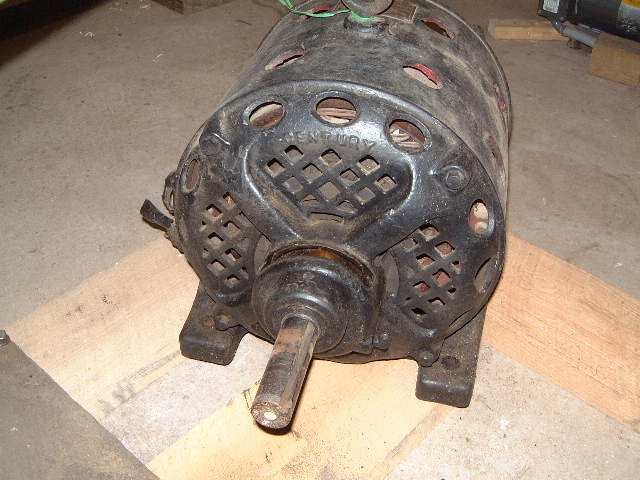

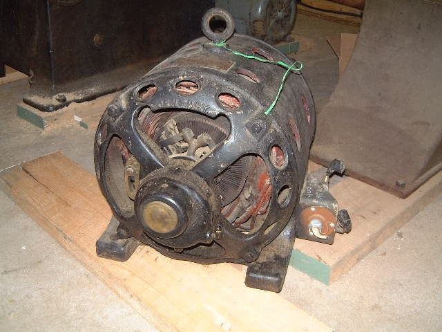

But since you like vintage American motors, here's one that might suit your fancy. I picked this up to run my prior table saw, which could swing a 22" diameter blade. The saw weighed 1800 lb. without accessories, something like 2500 lb. with accessories and motor, the motor alone weighed 400#.
