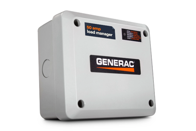

Generac makes load shed devices that don't need the extra low voltage wiring back to the generator. And they work with any generator not just Generacs. You can set the preference order for the loads. They work by sensing the drop from 60hz that indicates the generator is struggling.

The price difference on the Generac website for a Guardian 14kW unit and a 24kW unit is $1600. That differential will probably be eaten up by the requirement to install a sub panel with select circuits to be run or by the smart load management system using a 14kW unit vice running everything with the 24kW (example).
