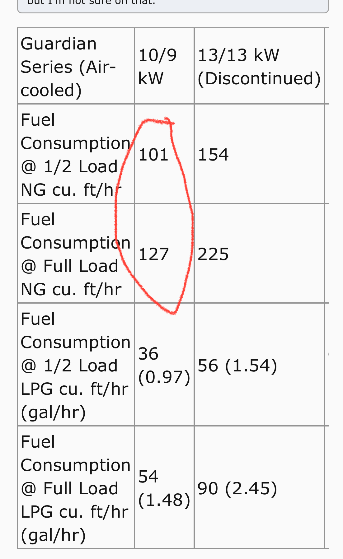

The Natural Gas meter is for a 1 inch line. Does anybody know how big of a generator I can run off of a 1 inch Natural Gas line? Is that a lot of Natural Gas, or will I be limited in what size generator I can run? We will also have a Natural Gas range for cooking, but there isn't any plan to have Natural Gas for laundry or the water heater. The HVAC is currently electric for heat, and we never use it since we heat with wood and electric heat is stupid expensive. When we replace the HVAC system, it might become Natural Gas for heat, but I'm not sure on that.
Guardian Series (Air-cooled)10/9 kW13/13 kW (Discontinued)14/14 kW16/16 kW (Discontinued)18/17 kW20/18 kW22/19.5 kW24/21 kW26/22.5 kW
Fuel Consumption @ 1/2 Load NG cu. ft/hr101154195182169204228 | 203203188
Fuel Consumption @ Full Load NG cu. ft/hr127225256245247301327 | 306306333
Fuel Consumption @ 1/2 Load LPG cu. ft/hr (gal/hr)36 (0.97)56 (1.54)65 (1.81)62 (1.70)62 (1.70)86 (2.37)92 (2.53)92 (2.53)75
Fuel Consumption @ Full Load LPG cu. ft/hr (gal/hr)54 (1.48)90 (2.45)112 (3.07)109 (2.99)110 (3.02)129.6 (3.56)142.1 (3.90)142 (3.90)132

One of those numbers can’t be right.

Nat gas will derate the output of the generator. The values are stated in the spec sheets. For instance, a 24kw generac provides 100 amps on propane but only 87.5 amps on nat gas. It also requires large enough pipe to supply 306,000 btu of energy.
Not sure if you’re responding to my post…. If you are, The two numbers I circled, where at least one of them must be wrong, are both labeled NG
