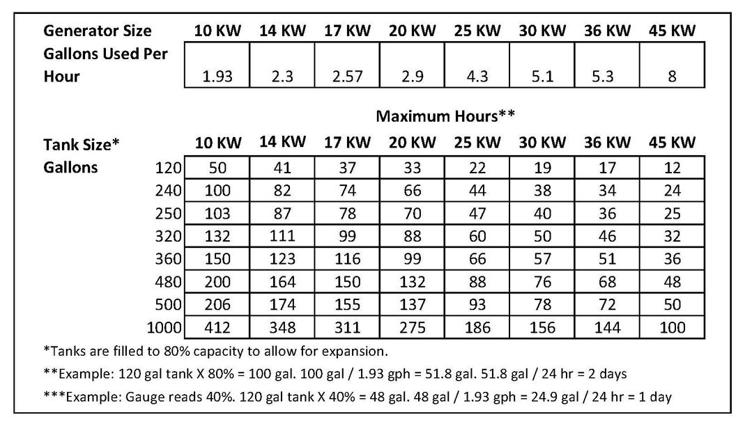

A site with some good information and a simple chart for fuel consumption of propane generators.
CES | Backup Generators | Combined Energy Services
So a full 250 gallon tank would be good for 3-4 days possibly 5 for many people, rationing the run hours would lengthen that considerably.
I suspect that table is fuel consumption for a generator running under full load. If you are only running at a small fraction, I think the consumption would be significantly less.
   / House generator questions...second thoughts on whole house system. #48
It most definitely would be less, I believe that table estimated 10KW for 103 hours on a full 250 gallon propane tank.
Even estimating consumption to be half of the 10 kw value you only have 200 hours on a 250 gallon tank.
Also when the situation is that you are in a widespread long term (10 day) outage you quite likely would not be able to obtain a refill.

So a 250 gallon propane tank with a 7500 watt at half load may make 300 hours
and a 10kw burning 2.2 gallons per hour at half load is only going 90 hours.
I expect that there isn't a lot of fuel consumption difference once you get much under half loads.
What surprises me is the high fuel consumption of the 10KW unit at half load.
weve had long (10 day) outages in our area before. most people on generators have 500 gal tanks, I have a 1000 gal tank myself. Our propane company has never had an issue filling tanks during power outages...but it may take a day or 2 to get to us. I have a wifi tank monitor to keep abreast of my propane levels. Also, i would cycle the auto standby unit if i knew it would be a long outage. it does not need to run 24/7
the funny thing i have found is the larger generators will generally use less fuel than the smaller units, because on a colder day, the small units may need to run at full output continually to keep up with demand, while the larger units can run at a lower percentage of total output. i see mine running at 25% rated and use less fuel than a 7.5kw running full out
