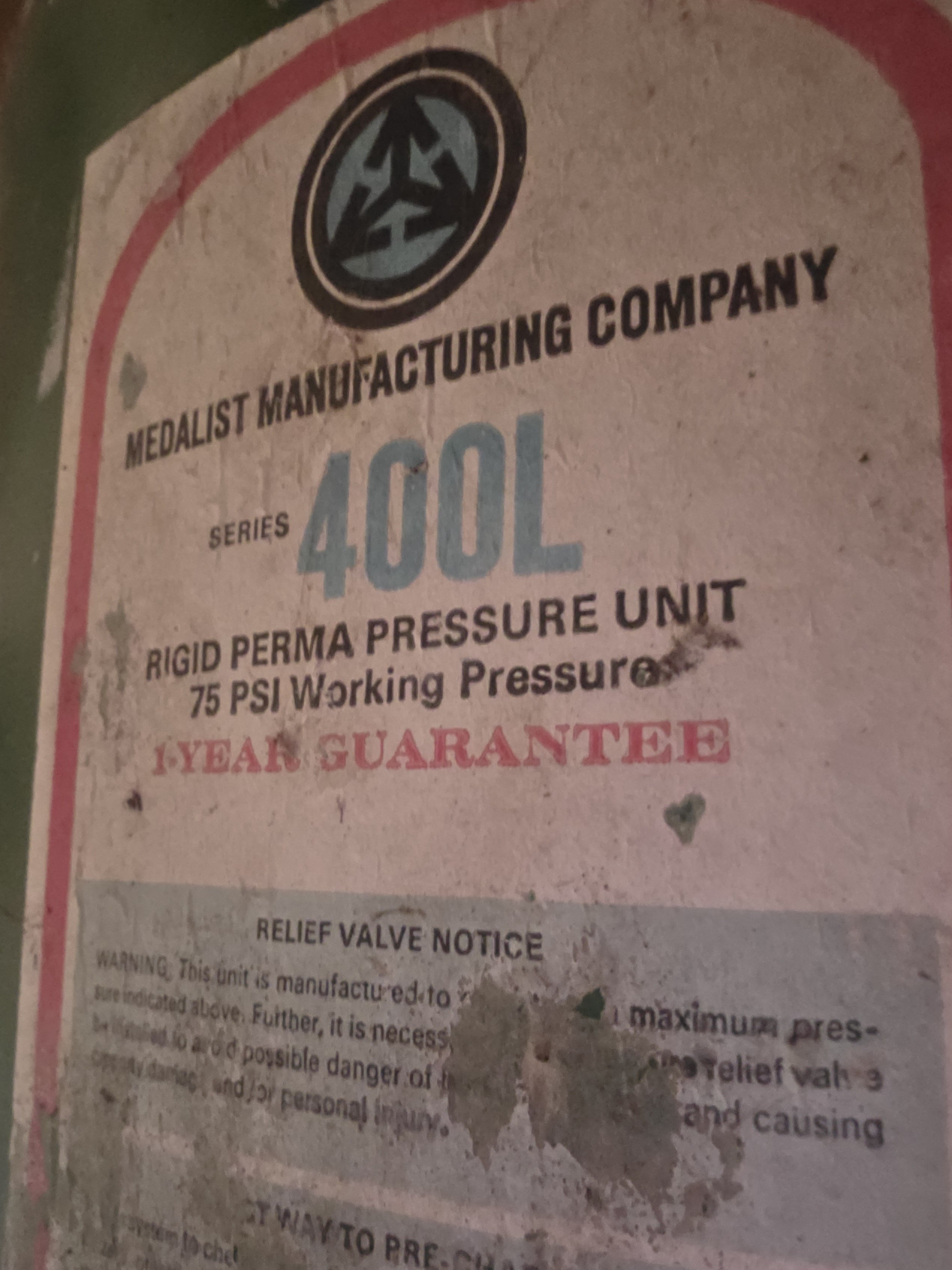

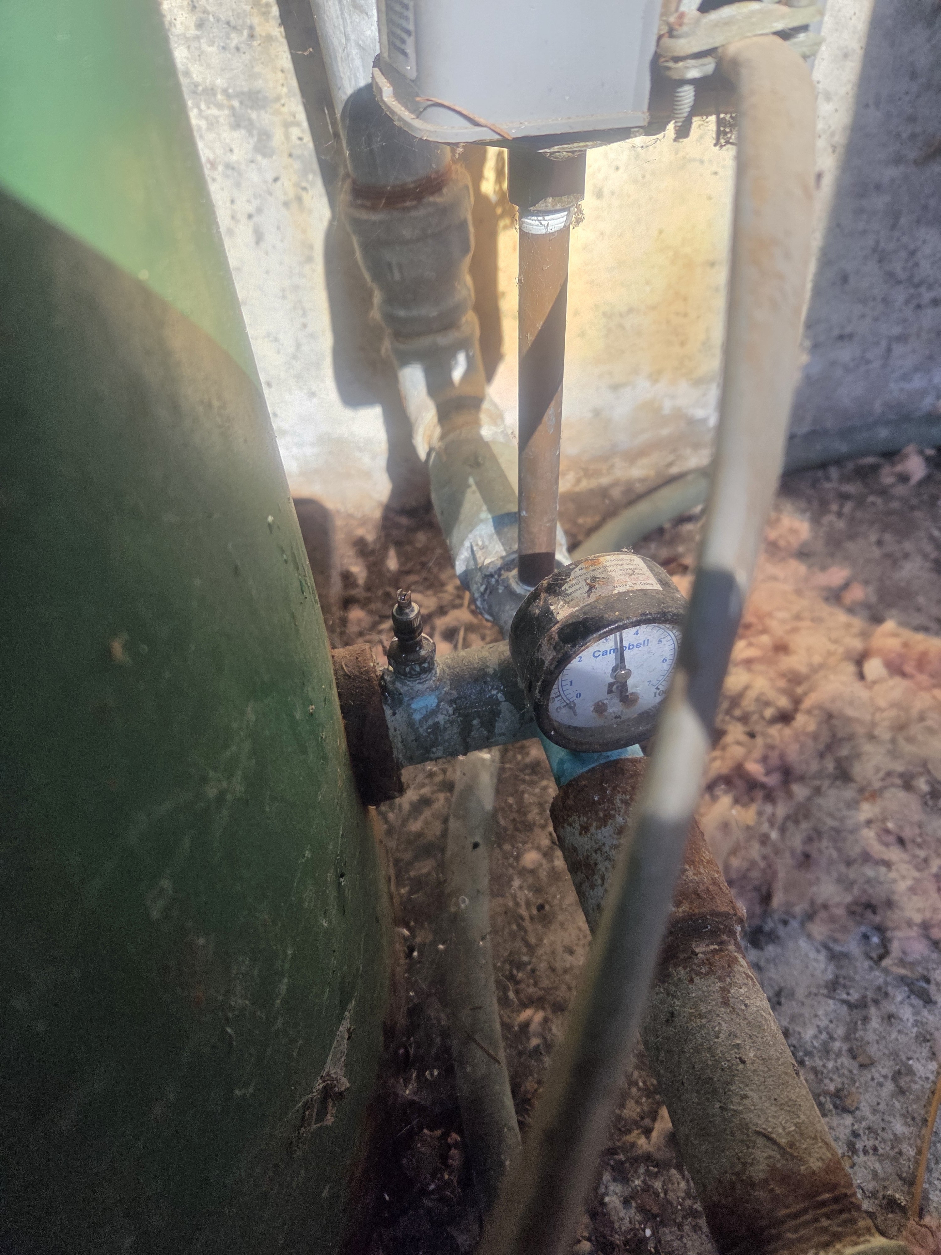

Bought an old house a few years back and the well has been cycling shorter and shorter as time goes by.
There is no Schrader valve at the top of the tank, just a welded on stub.
There is a Schrader valve located in the Tee where the tank is plumbed in parallel to the house supply.
I assumed this was for winterizing but maybe it's where to air up the tank?
The tank is a Medalist Manufacturing Co series 400L Rigid Perma Pressure Unit.
I have no paper work and can't find info on the web on a procedure to fill, if there is one since it's Perma-nently filled. :rolleyes:
I'll be redesigning the system and eliminating or replacing the tank as it's rusting and slightly weeping water, but I need to irrigate and the pump is cycling constantly.
As always, thanks!

Turn the pump off, and shut the valve from the pump to the tank.
Drain the tank of water.
Then pressure up the tank with air via the scraper valve until the pressure is about the kick in pressure. I prefer to have it about 2psi below the kick in pressure, but depending on your plumbing, you may get slightly better or worse performance a few psi above or below that.
Since your tank appears not to have a bladder, it will need air periodically, as the air dissolves in the water and is slowly lost. Periodically being every couple of weeks to months, depending on your system. With bladderless systems, there is normally something that bleeds air in, such as an air bleed on the intake side of the booster pump, if you have one, or if you have a submersible shallow well pump, a vacuum breaker that lets air back into the well pipe. Lots of threads on the subject here if you poke around a bit.

Yes, that Schrader can be used to put air in the tank. With a booster pump and no air charge system you will need to add air on a regular basis. Big tanks will slow the cycling but a Cycle Stop Valve will completely stop the cycling while irrigating. The CSV works with a small diaphragm tank that would not need periodic air charging.

Add air at that sniffter valve on the bottom, in your picture.
Air should be 2 psi below turn on psi.
Be careful over irrigating, you may run the well dry.

Thanks everyone! I drained the tank and charged it with the valve in the tee. Pressure spread was off, so I adjusted and now it's 40/60psi with much slower cycle times.
Too many projects to take on water system improvements now, but I see cycle stop and storage tank(s) in the future.
