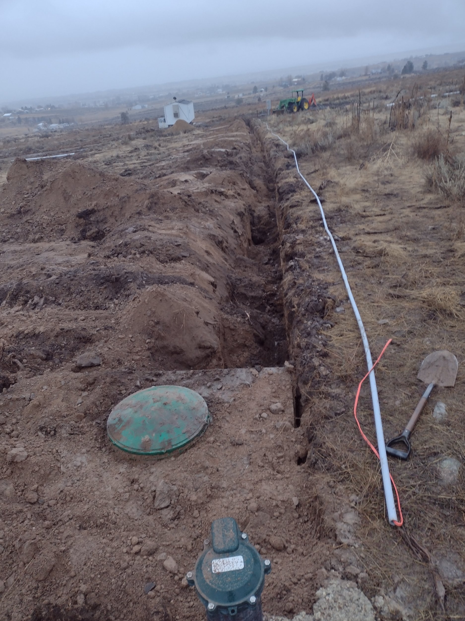

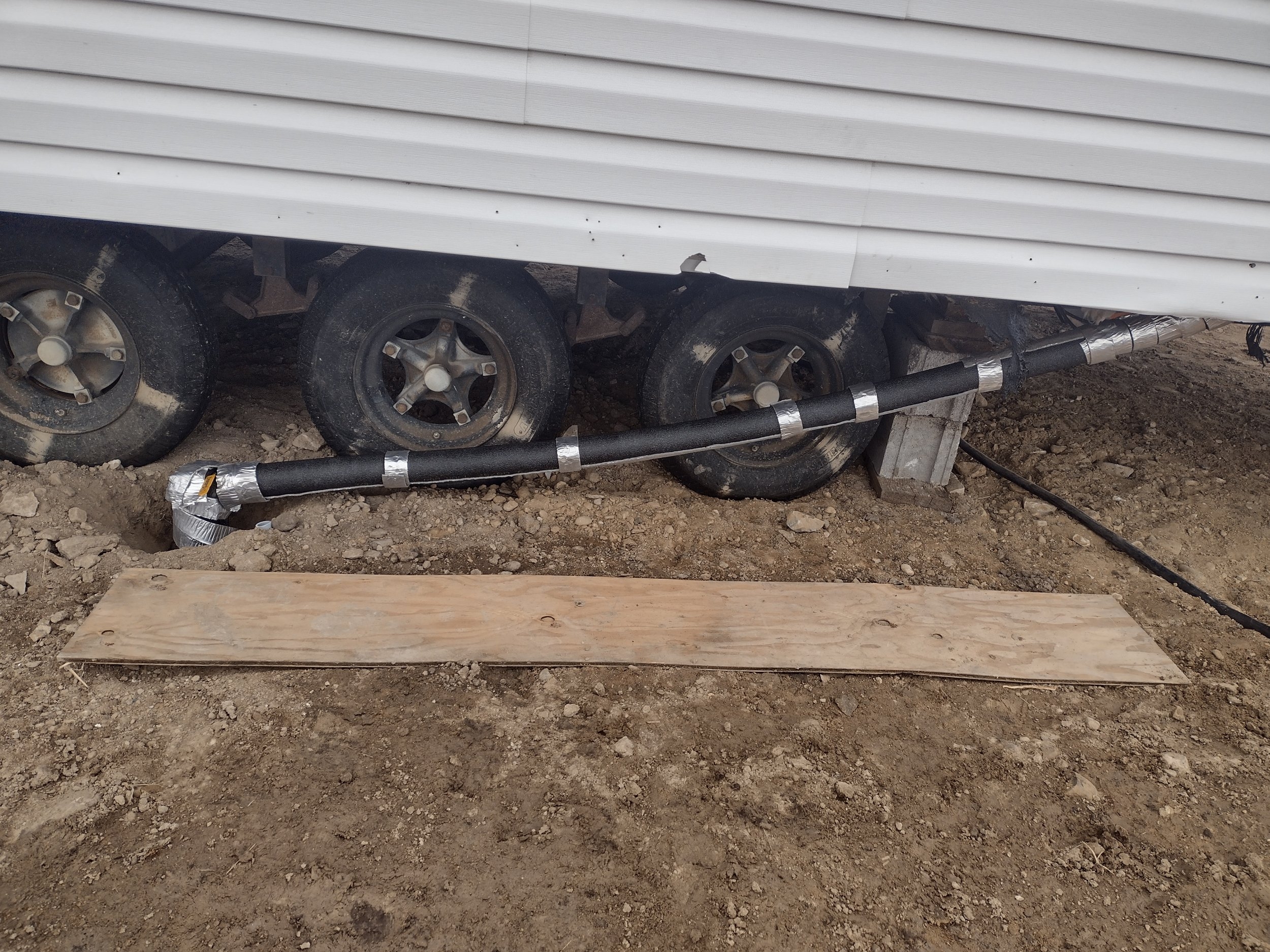

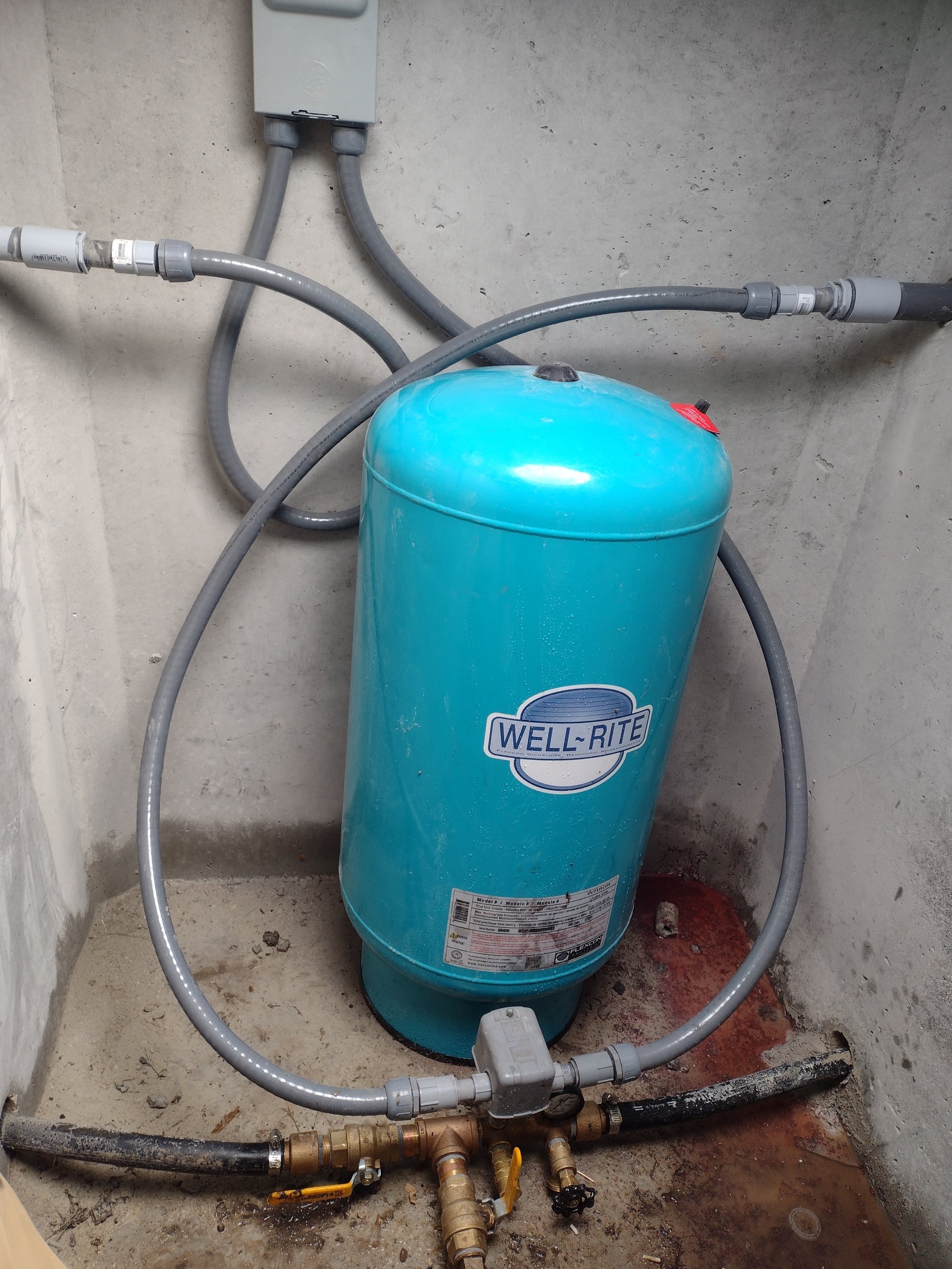

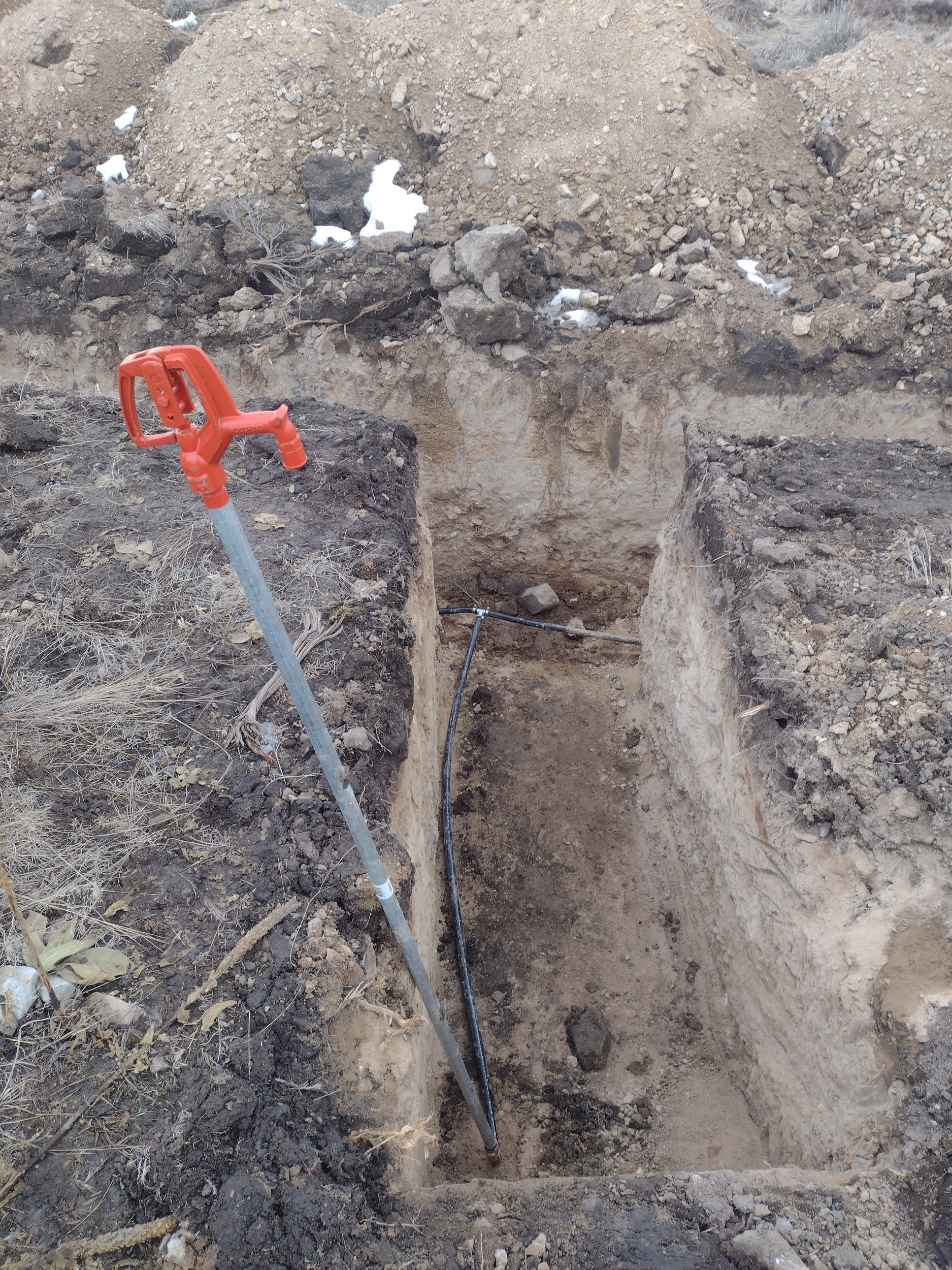

So here we are almost complete -just needs the last 2 foot of trench filled in. Works great and will transition nicely to the house. The well pit lid will be insulated

Make sure the holes are well plugged, there will be water in there.
   / New install pressure tank on temporary mobile home -need advice please #30

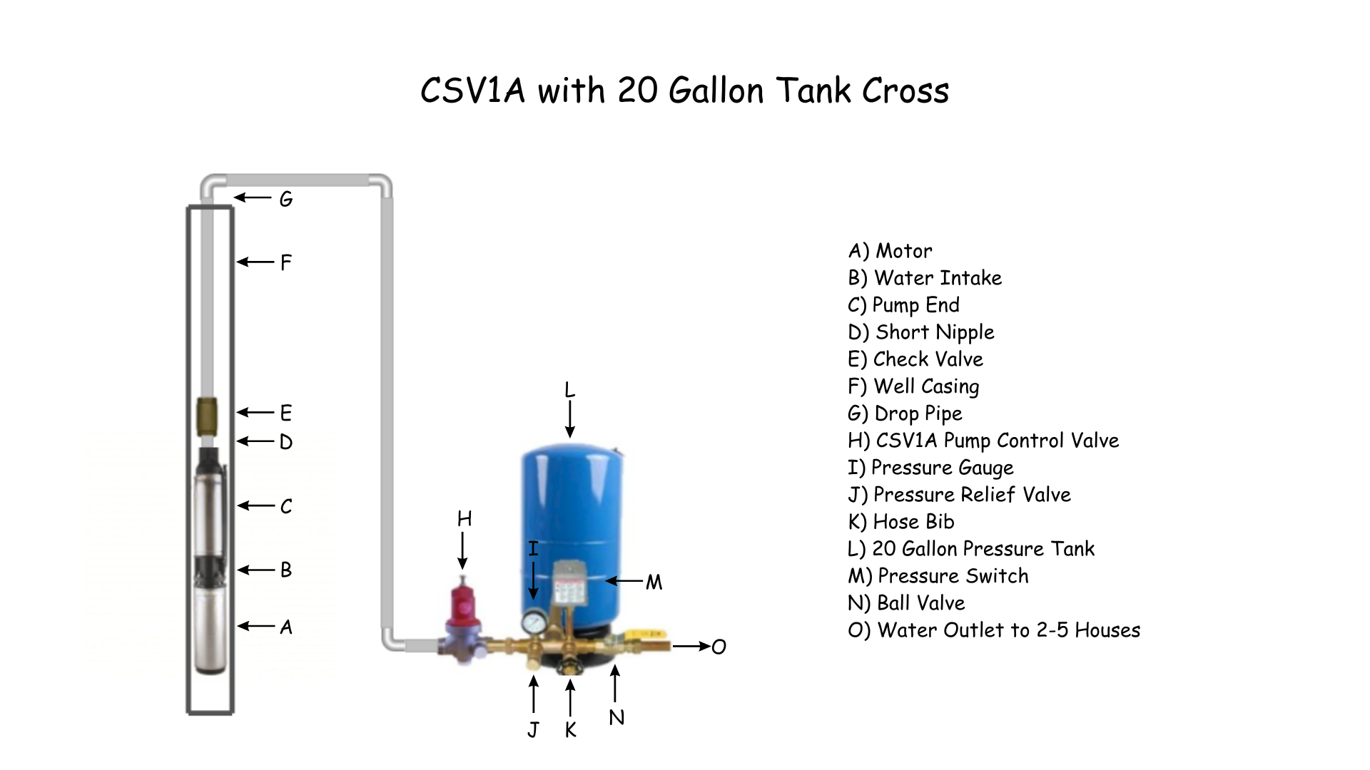

Looks great, except is it missing the Cycle Stop Valve. Still plenty of room on the inlet side of that tank to add a CSV1A when you decide you want good strong constant pressure and for the pump and tank to last longer. Just need to cut the poly pipe back about 4".
