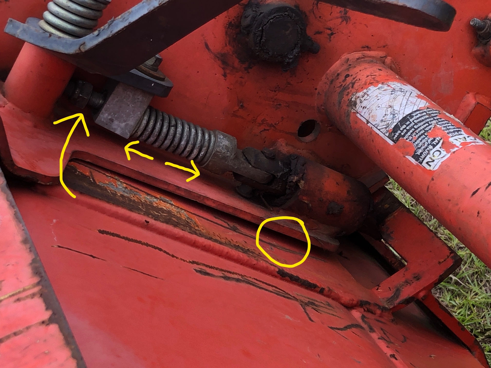

I was looking through some old pictures from 2004 and found one of the solution using flat washers.
It's not very high tech, but it work for years and never lost the bucket again.
   / SSQ Bucket falls off #82
If I remember right: 9 flat washers was the magic number to provide enough pressure.

Thank you Gene. I justed checked the bucket and think you are correct There isn't much spring tension and I can reach from one side of the tractor and lock and unlock the pins.
whenever i put a front implement on i lift it up and shake it front and back with the stick to help it settle in before i push down the levers. don't know if it helps or not i just have always done it. never had issues and so maybe it helps.
Yes, I do the same thing. The bucket wont shake loose unless bag dragging. Otherwise it stays on.

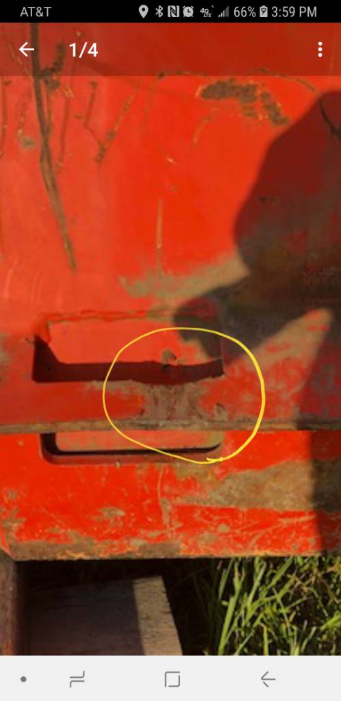

So a couple people responded that they did not see what I think is wear on the bucket.
My eyes are not what they used to be, however this still looks like a problem to me.
Maybe the main problem, maybe not, but looks like it needs to be addressed.
Am I just seeing things?View attachment 607527
Good eye. Thanks for catching this. Will pay extra attention to this area.
No I see it too. The sun angle and shadow make it hard to see.

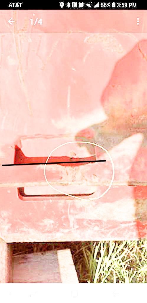

I lightened the picture to make the shadow stand out and added a straight line along the edge of the slot:
The worn spot shows in the dip on the shadow on the back of the bucket.
The way the slot is worn, the pin should be worn at the edges and not flat all the way across.
But I don't think the slight amount of wear would cause the bucket to come off.

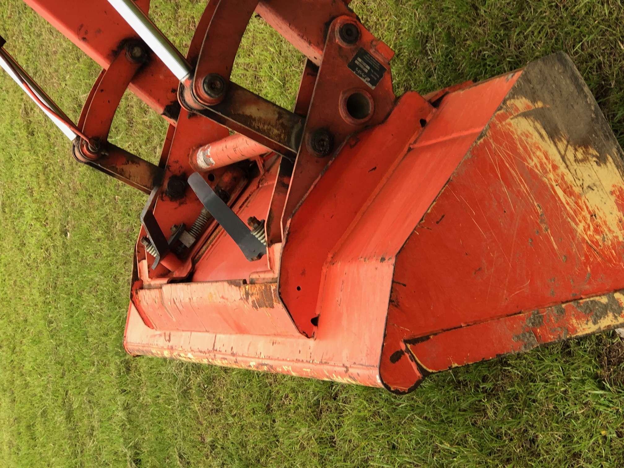

Update - Thought we had solved the issue.Gene had suggested washers and this sounded very promising. However it did not solve the issue and the bucket came off again. Here are some new photos. KB5.JPGInkedKB1_LI.jpgInkedKB6_LI.jpgInkedKB6_LI.jpg

First photo is the bucket as it is coming off. Second photo shows just how little the pin goes through the tab in this position. The pin generally goes through the tab more. The fourth..... ooops.
Photo below shows the grease line on the pin when the pin is seated correctly.
   / SSQ Bucket falls off #93
I think your problem is clearly illustrated in your second photo.
A flat plate welded to the bucket latch tab to eliminate vertical "slack" will fix the issue.

Looks like the tip of your QA pin is barely into the bucket.
Plate that section of the bucket up.

The gap shown between the back of the bucket and the ssqa plate is a problem that needs to be diagnosed and understood.
If this side has a gap, and the other side is tight, that suggests xfaxman is correct and the connecting tube is twisted.
If both sides show the same gap, that suggests the upper angled part of the ssqa is not fitting correctly into the angled part of the bucket. One or the other could be bent.
Or, you need to juggle the bucket on the ssqa before inserting the pins to make sure the back of the bucket and the ssqa plate are tight on both sides.
Maybe borrow a bucket or other ssqa attachment from a neighbor and see if the problem stays the same or goes away.

This problem is probably caused by the top bucket bracket and/or the top SSQA bracket being bent.

Yes, that does seem to be the problem or part of the problem. Didn't have issues with the bucket falling off originally though so maybe Xfaxman is on to something.
It is only this way when the bucket slides up after back dragging as shown in the photos above. When using the loader for moving dirt the pins are further into the bracket and I don't have any issues.
