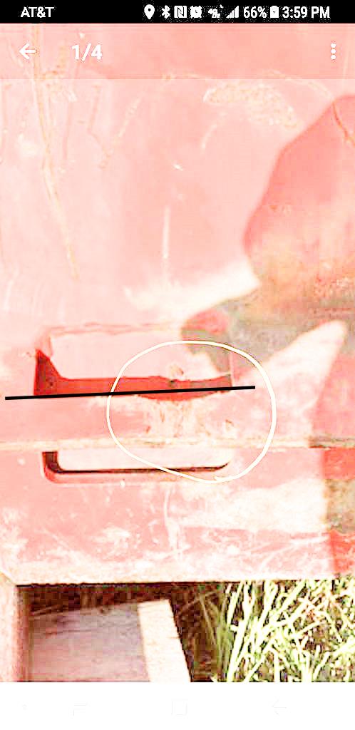

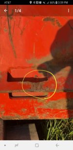

Looks like you have a couple issues going on that need to be addressed. In this pic the first thing you need to do is lift the bucket up and roll it back to were the buck weight is hanging on the upper lip and not the pins, then see if the pads BOTH seat against the back of the bucket or one or both have a gap. Like you have circled in this pic. IMG_1052.jpg
Then once both pads are seating flat, then you can focus on the lower flange gap we’re the pin notch is. You more than likely will need some new material added to fill the gap. After that is fitting tightly you can work on the locking pin engagement.

The gap shown between the back of the bucket and the ssqa plate is a problem that needs to be diagnosed and understood.
If this side has a gap, and the other side is tight, that suggests xfaxman is correct and the connecting tube is twisted.
If both sides show the same gap, that suggests the upper angled part of the ssqa is not fitting correctly into the angled part of the bucket. One or the other could be bent.
Or, you need to juggle the bucket on the ssqa before inserting the pins to make sure the back of the bucket and the ssqa plate are tight on both sides.
Maybe borrow a bucket or other ssqa attachment from a neighbor and see if the problem stays the same or goes away.
After as many accidental disconnects as described there is virtually not way the connecting timing rod can not be out of line, making one connecting plates not meet up to the connecting pin hole. It's been mentioned many times. Those plates have to be against each other with no space between them for the pin to fully seat.
You can weld all the plate you can imagine, but without proper alignment the problem will continue, because the pin is only partially engaged in the hole it belong in.

Here is the thing. The SSQA plates and the back of the bucket will touch and square up. I don't know for sure that the tube or another part is not bent but I do know that the plates lay flat on the bucket initially. The photo above is what it looked like as the bucket was slipping off.
The bucket initially did not have this problem. I don't know if I damaged it somehow, used too much grease or if it was just generally stuck in place as it wasn't removed much. Regardless, this will be the last post on this topic. Thanks to all who commented with great replies.
