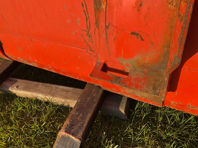

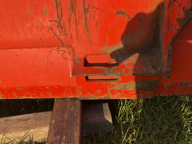

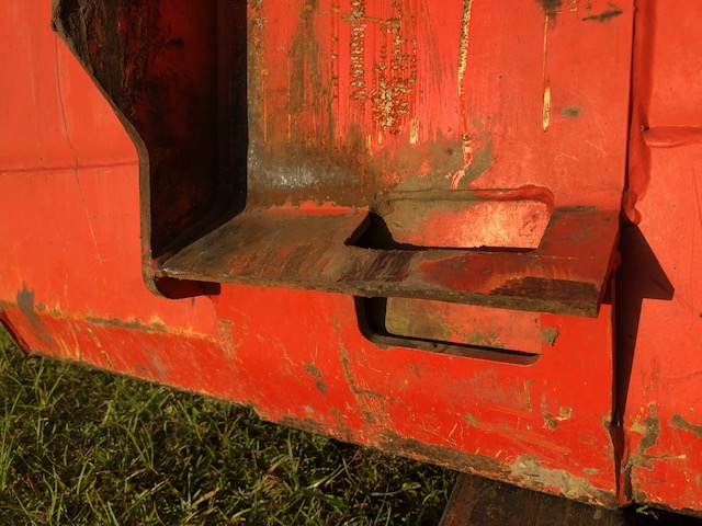

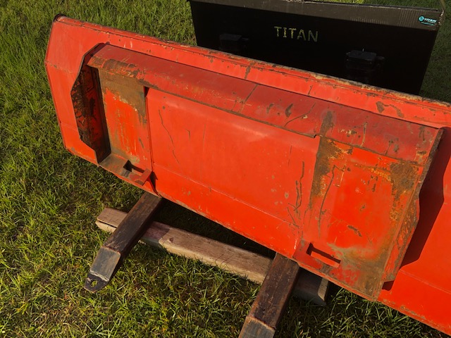

The SSQA bucket on my Kubota wont stay on when I put any back pressure on the bucket. The bucket doesn't appear to be bent or damaged. The loader arms don't look damaged.
I'm thinking that the metal slot the locking rod goes into is bent some OR the locking rod is sliding up under pressure and popping out of the slot. Anyone experience this issue. Any recommendations?
Here are a couple of photos of the bucket.

Does your pin go fully into the slot beyond the beveled end when the bucket is mounted? On my MX 5200 I have had the bucket pins not seat properly because there was a tiny bit of dirt some where that kept the loader frame from fully engaging the bucket. Your pictures do not show what lies underneath the top piece above the pin slot? Is your bucket or loader portion of SSQA warped in any way? It probably is something very simple that is keeping all of the pieces from seating properly..W.Jones

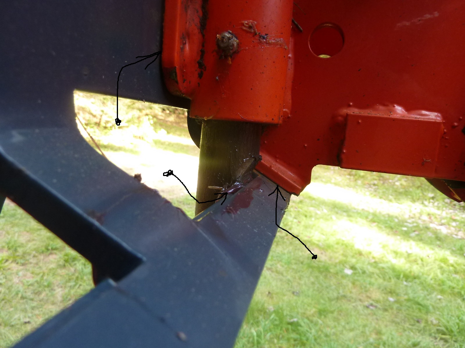

Show us a picture of the bucket mounted like this. There should be no gap where the 3 arrows are especially between the tapered part of the pin and the bucket catch and between the slanted part of the SSQA plate and the bucket catch. Grease shouldn't hurt unless it is full ot trash it picked up.

The slots where the QA pins seat look like there is some wear or something different about the rest of the slot. I am wondering if that area is starting to show taper wear and when you put down pressure on the bucket it is allowing the pins to wedge out.

Looks to me like that bucket is worn out where the SSQA wedge is sopossed to hold it.
Once you verify you SSQA pin, spring and lever operation, you are going to need to repair that bucket or your problem will persist.

If you zoom in on the first pic, it looks to me like the area where the wedge holds is rusted, slightly bent and worn down.
I could be wrong though....

Gordon's pic is an excellent example of a properly fitting bucket. His arrow to the right is pointing out a critical area. Hopefully the OP will follow Gordon's lead and post a similar pic.
