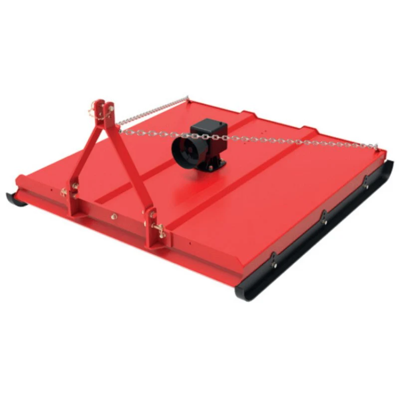

Many of the "slashers" used in AU have chains and no tail wheel.
Some instructions:
Bruce
   / 1st time at my new property & 1st time ever brush-hogging - some lessons learned #28
Some instructions:
Bruce
This mower has skid runners front to rear too, so it can ride on the ground without damage. The square deck increases tail-swing when mowing around things.
