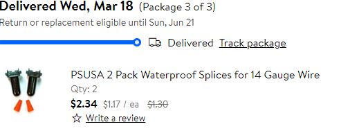

Thanks for all the info and suggestions. I ended up using these.
They have silcone inside that gooshes over the wire nuts.but I also wrapped it all with rubber tape.
