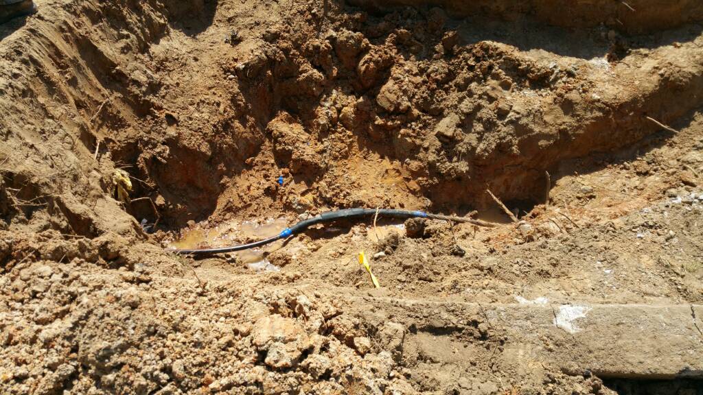

Here's another vote for splice kits done correctly. This is one phase,14.4KV to ground. We had these high voltage type splices in the ground for years and I believe that low voltage doesn't make the same exacting demands. On a side note, notice the old cable (early 1980's) on the right has the ground/neutral wrapped around on the outside! No one nowadays can explain why they did that back then.View attachment 644137
