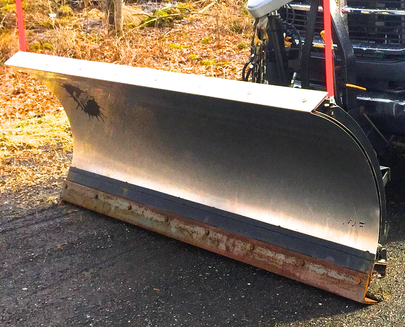

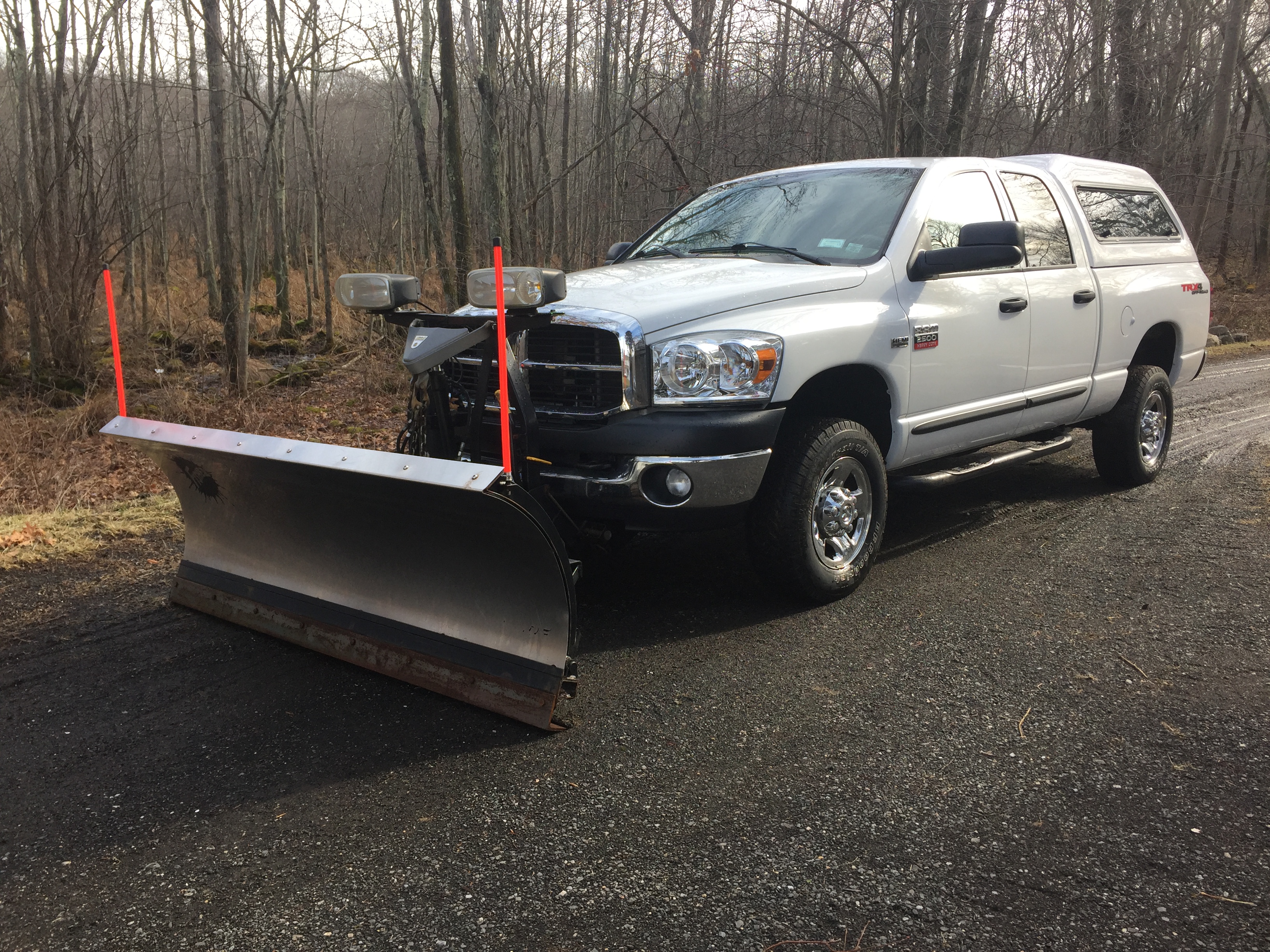

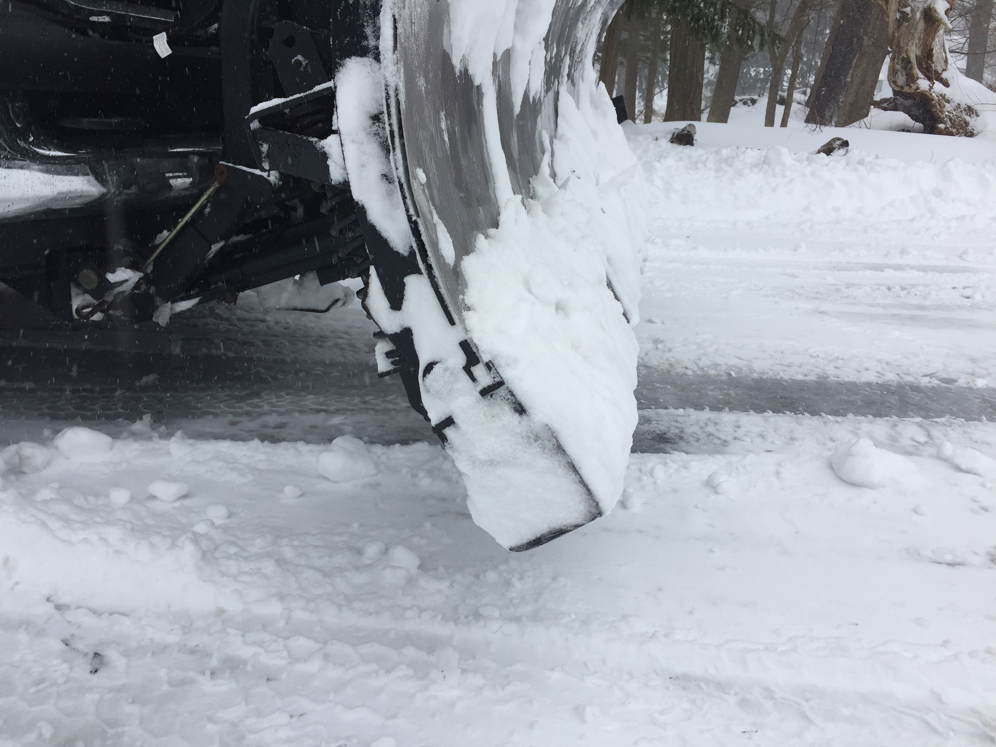

The gravel drive solution is simple. Replace your cutting edge with a heavy piece of angle. I did it on my new 90" Meyer Minute Mount with a 4x4x 3/8". You can grade anything smooth in the Fall and Spring. I also have an old 9' Meyer dirt drive plow from the 30's that works great on my "Monster M37".
View attachment 585270View attachment 585271View attachment 585272View attachment 585273
Have you tried it on a gravel driveway? Also does it leave much snow packed down?

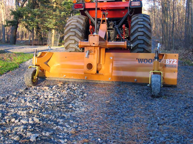

I like using my 6' landscape rake with gage wheels. It seams to clear best with the least damage to the driveway least rock redistribution. The driveway is about 500' of 3/4" crushed rock. Once the backhoe is off the tractor, rake on and set, I can make 3 passes and be going back inside for a fresh cup of coffee.

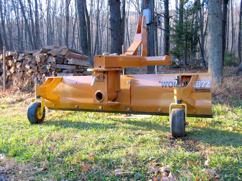

Rear blade with adjustable bush hog gauge wheels. Set the 3pt in float.
/ Snow plowing on soft ground #46
I always thought this setup would be the best for removing snow on soft ground. Pull the pin and let it float side to side as well as float up/down on the 3pt, with the gauge wheels keeping the blade out of the gravel. IMG_1446.JPG IMG_1447.JPG

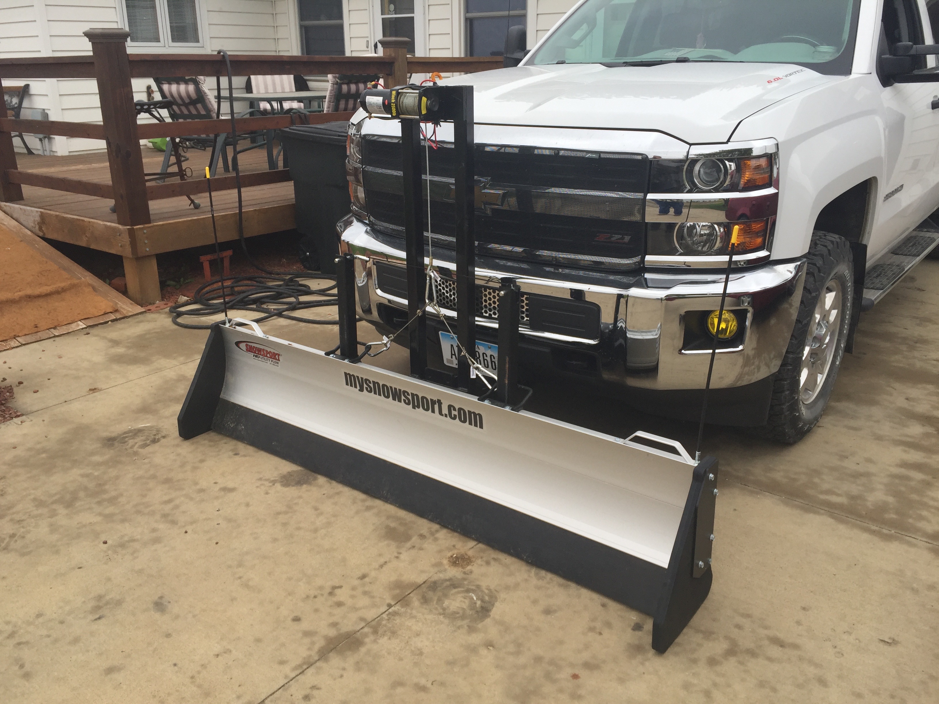

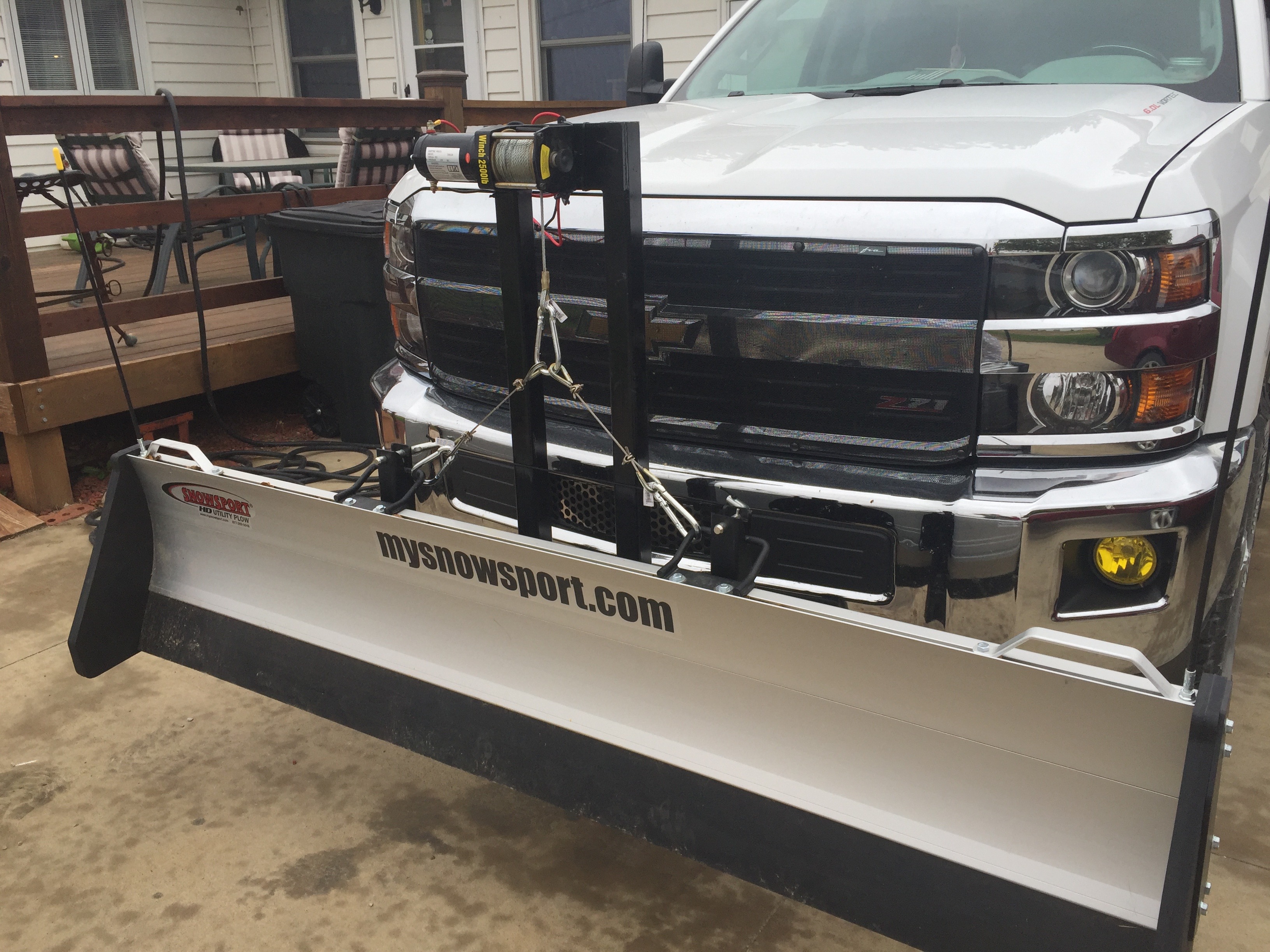

While it is not some sort of commercial grade plow, I have had excellent results with my SnowSport HD snow plow. Very cost effective and has done a great job. Simplicity can sometimes be a good thing. I never worry about taking out the gravel on 900' drive and I can push right on up into the yard around the out buildings and never worry about scalping the grass. To look at it, it may seem "cheesy", but it works very well. I had a local welding shop build me a winch frame for it and use a $60 winch I got off of Amazon to lift and lower the blade. All that is required on my pickup is a Curt 2" front receiver hitch.
SnowSport HD Utility Plow | Truck Plows & Snow Blade
This vid shows it working
SNOWSPORT(R) Utility Plows - YouTube
This vid shows how it contours to the landscape
SNOWSPORT(R) HD Utility Plow Testing - YouTube
Here it is on my 2015 Chevy 2500.....

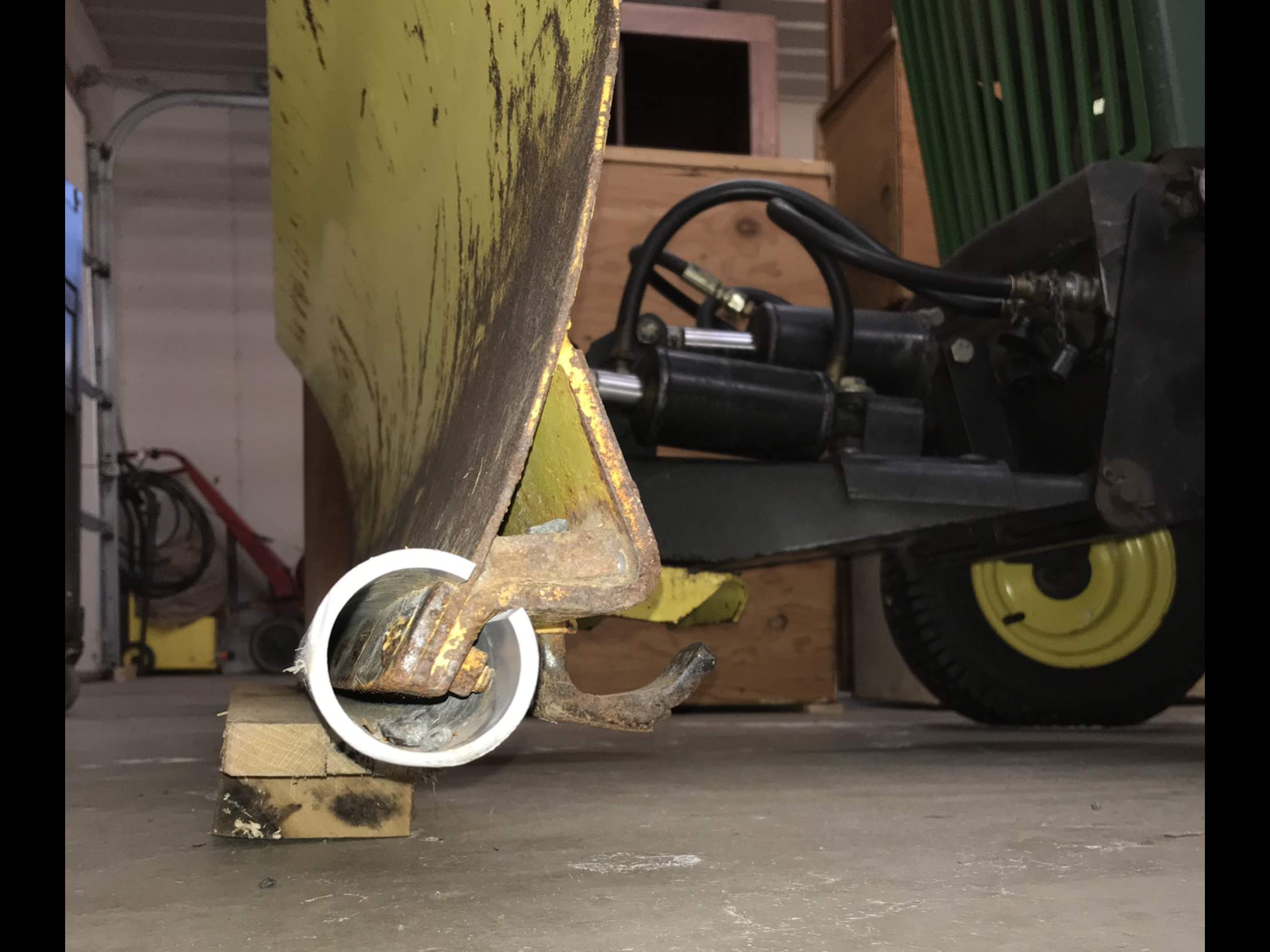

My plow has skid shoes like the edge tamer only even wider and they still dig in when the ground is soft. The pipe worked reasonably well for me.
Ken

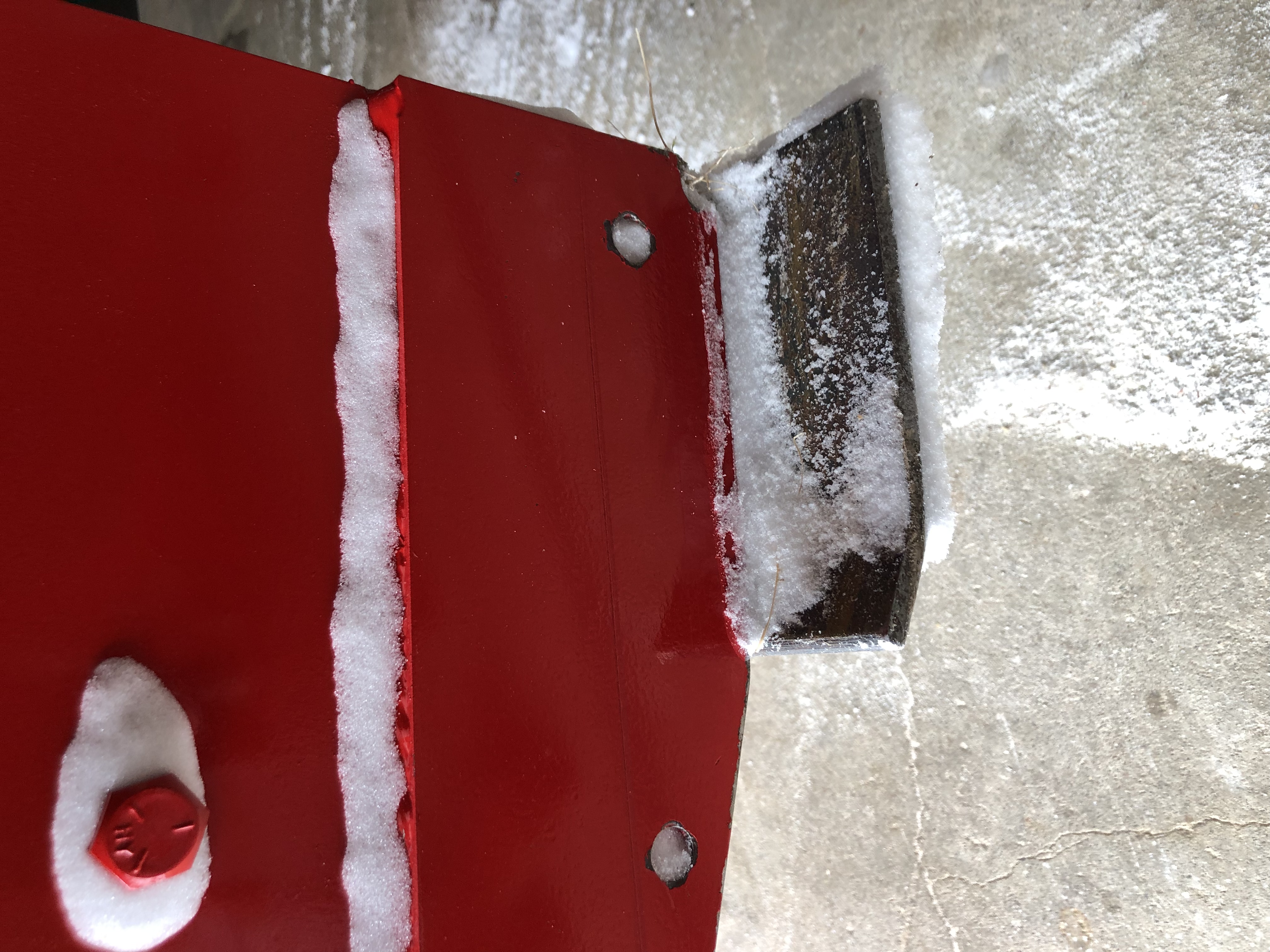

Heres some pics of my solution, and it works perfectly. (6 foot front mounted blower)
I had the local steel supplier take a piece of 5/16 by 6 flat stock which was 74” long.
I had him put a 30* bend 1 1/2” from the front edge. It looks like a ski, 6” front to back, but 74” wide.
This was attached under the regular wear strip under the blower. I used (4) 7/16 plow bolts. I drilled these extra holes so the skid was demountable without having to remove the original wear strip bolts.
I had a hard time countersinking these holes for the plow bolts, but got it done.
The steel and the bend was around $40, and I had several hours in drilling, countersinking and mounting.
I had a tough time countersinking those bolts, but it really works. I can go on rain soaked, unfrozen grass during the first few snowfalls, and it doesnt EVER dig in. It also does not ride up except on the hardest of blown in drifts. In which case, I use down pressure and if I need to adjust course, I just have to stop, lift, correct the course, lower and down pressure, then proceed again. But I only had to use that procedure once in 2 years
I had planned to remove it after I built up a base of frozen snow, but it penetrates well enough that i havnt removed it in 2 years.
