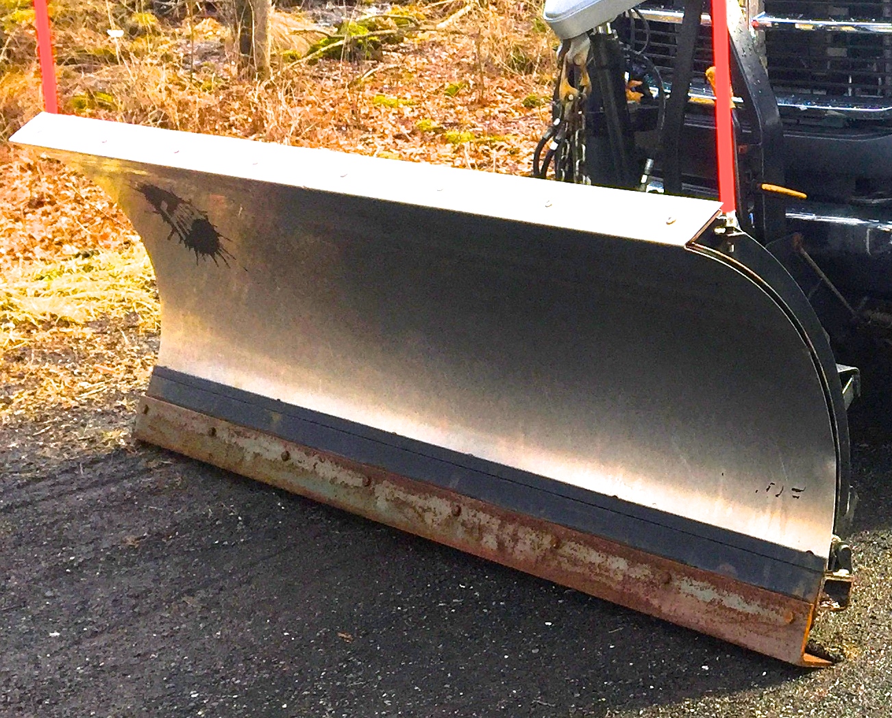

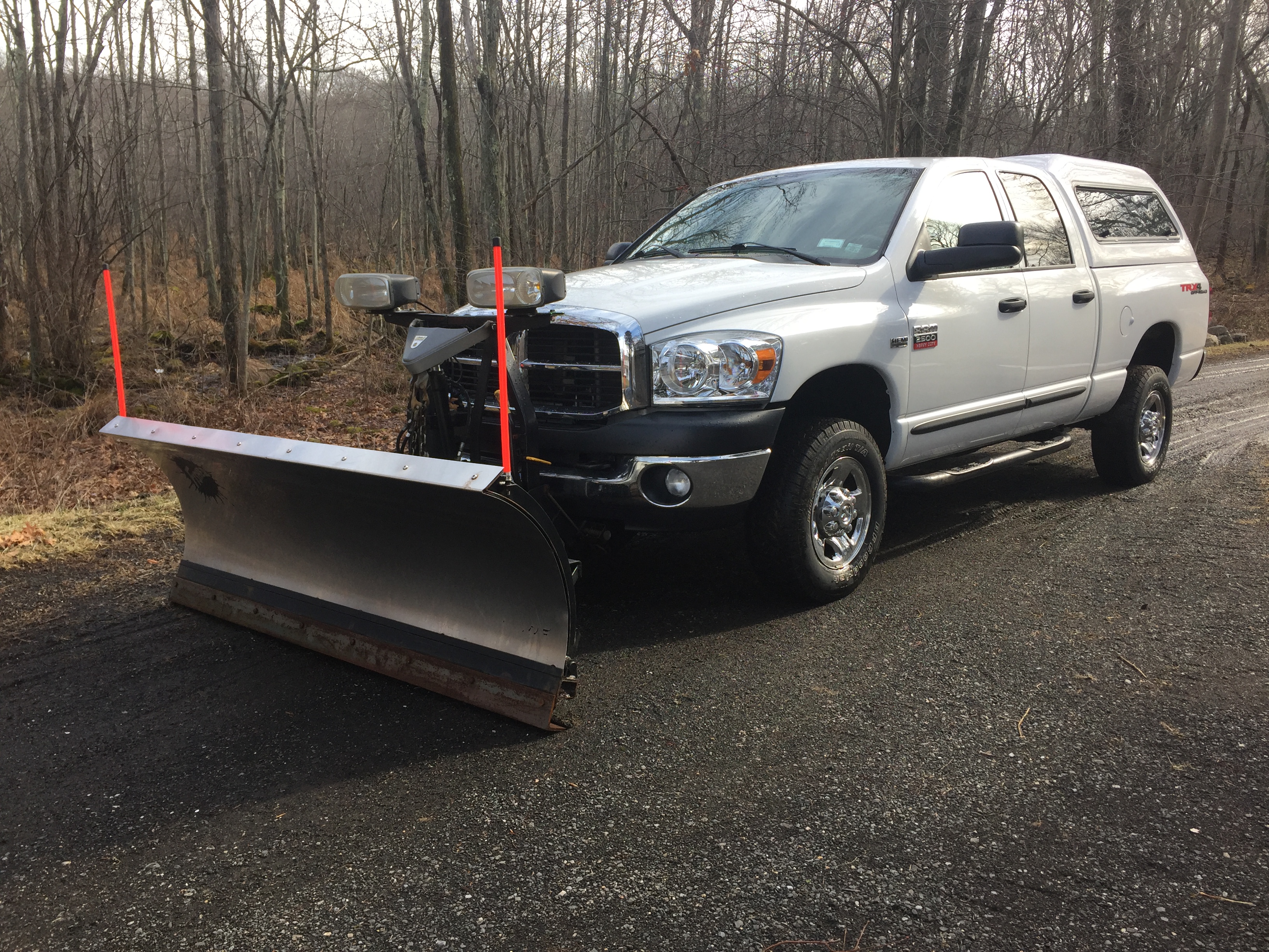

The gravel drive solution is simple. Replace your cutting edge with a heavy piece of angle. I did it on my new 90" Meyer Minute Mount with a 4x4x 3/8". You can grade anything smooth in the Fall and Spring. I also have an old 9' Meyer dirt drive plow from the 30's that works great on my "Monster M37".
/ Snow plowing on soft ground #27
This is brilliant. I am going to do it on the 8ft for the tractor and the 7'2" on the truck.

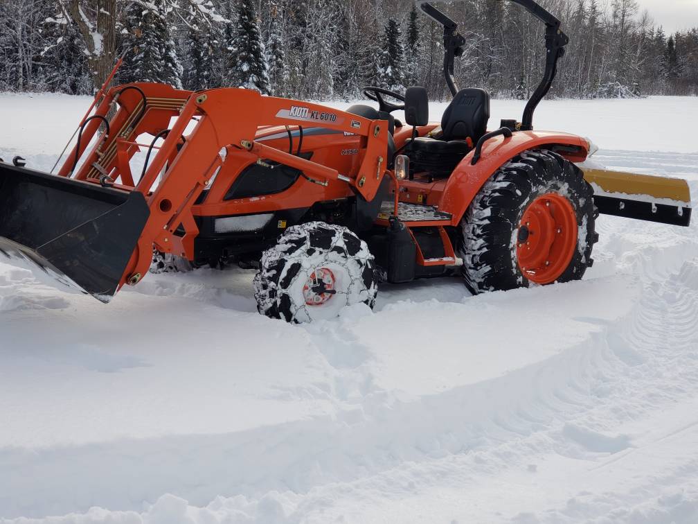

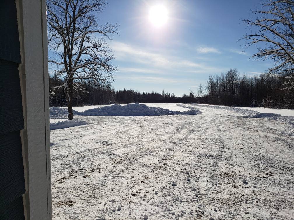

I also have a B2650, and use a rear blower and the bucket. Most years we just freeze and it’s not an issue. This year is cycling a lot between frozen and thawed. My driveway is paved but the adjoining areas are not. I just keep the blower or bucket off the ground enough to move snow but not dig in. I drive in low range and slow, using extra caution. That way the plowed areas are bare in a few days and you are ready for clearing snow when it freezes.

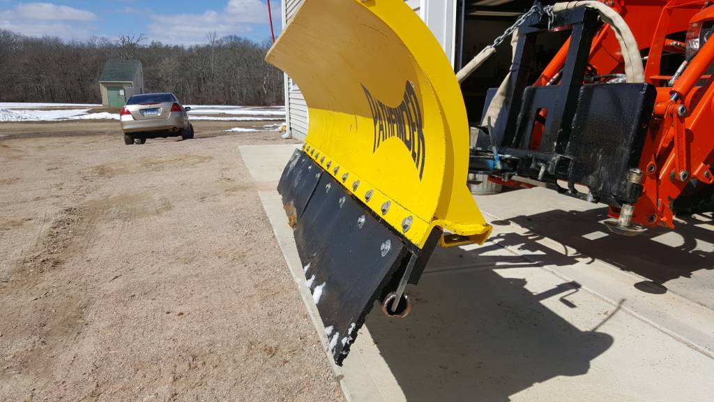

I used ABS pipe for many years, but usually went through two sections a season since they didn't tolerate the gravel well (split). Two seasons ago I slotted a section of schedule 40 iron pipe with my plasma cutter and fit that over the cutting edge of my back blade. AWESOME! It has stayed on well by itself, so no need to tack it with the welder. I suppose I could have used cutting wheels, but the plasma cutter was paid for and made for warm cutting on a cold day :)
