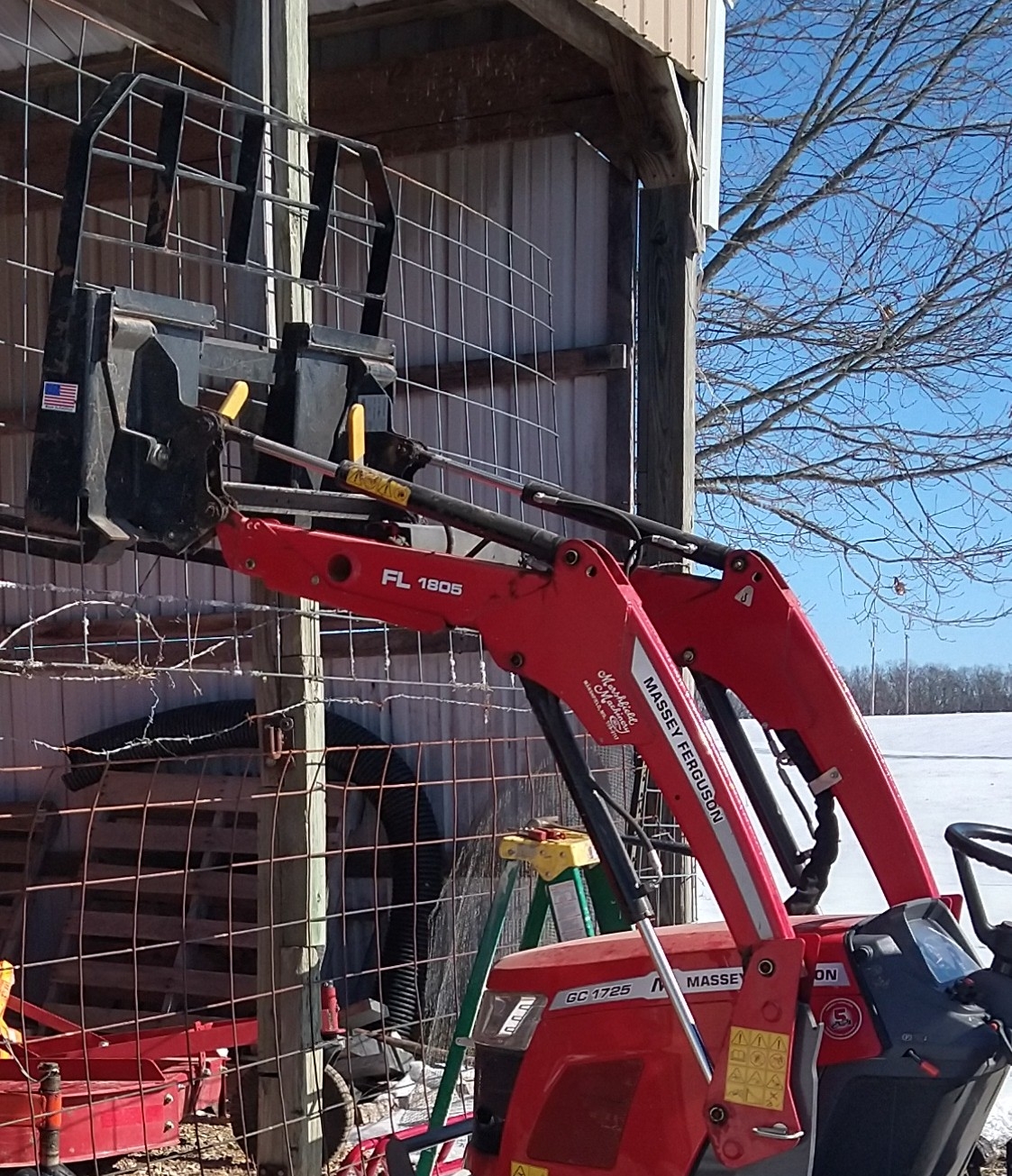

Ihave a 2010 dk45 and i swap continuously between grapple, forks, bucket,plow or snowblower.
Takes a couple of minutes to swap device. The hydraulics pop together easily enough, unless the device has set out in the sun and the fluids have expanded. That can get a bit messy.
I also own a device to help press the hydraulic hoses together . Its like a large vice grip device.
