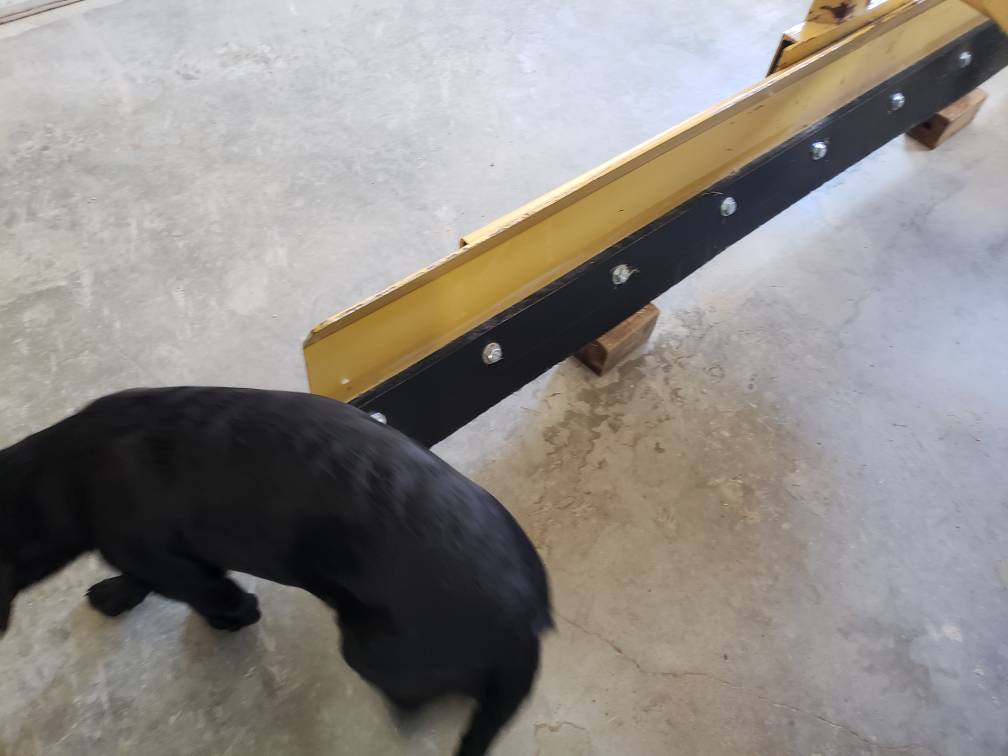

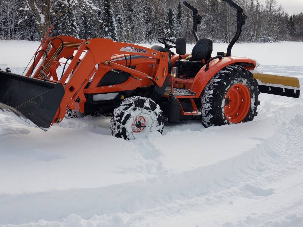

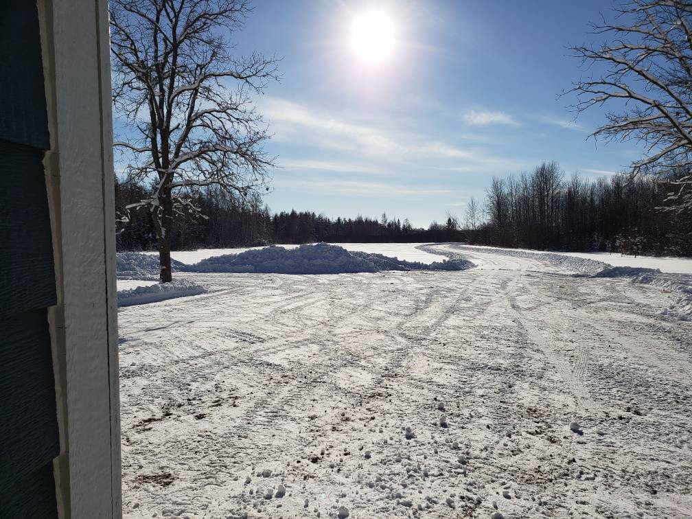

I removed the metal edge and bolted on a 1×6 piece of polyurethane... 1500 feet of gravel driveway.. it skips over the rocks and does not cut in.
I wanted a front mount blade, but the back blade was all I could afford right now. I gets the job done. 20181229_115737.jpeg20181229_115903.jpeg20181228_104353.jpeg
