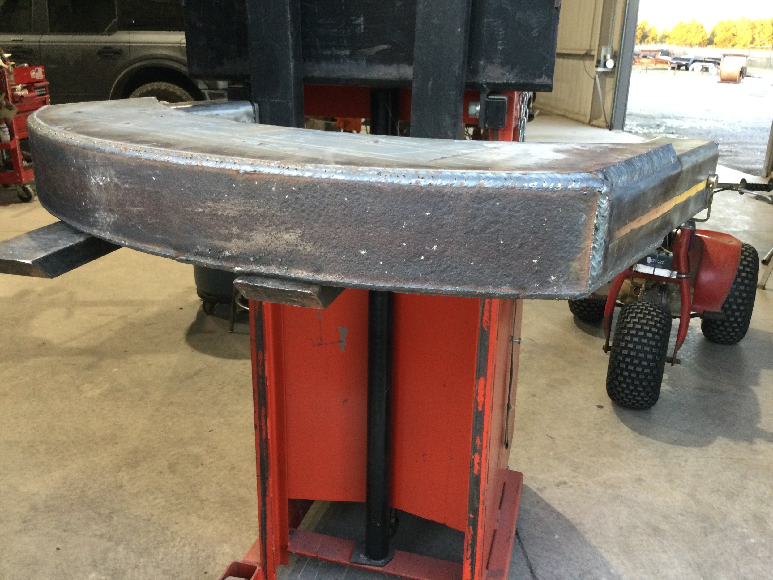

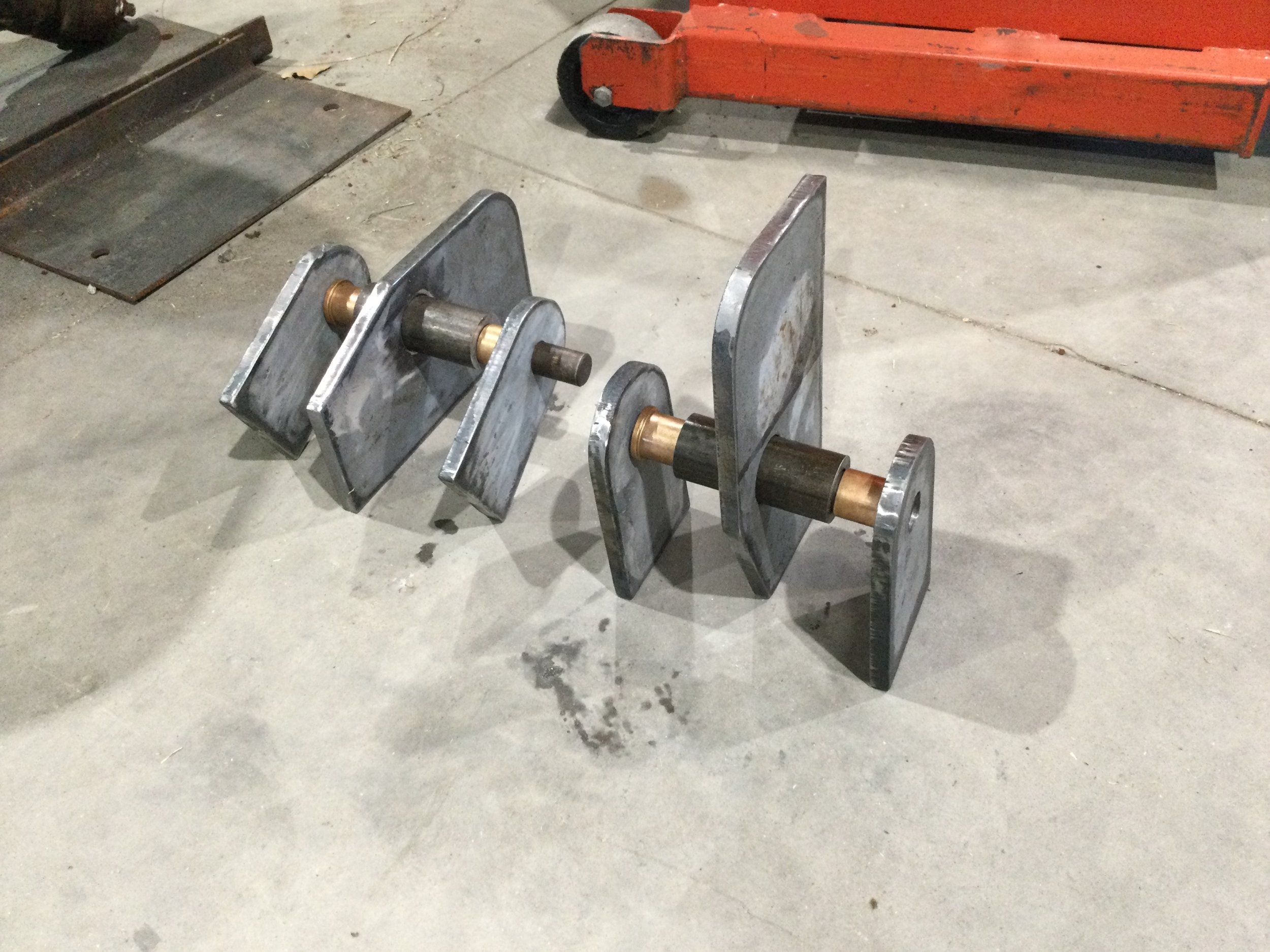

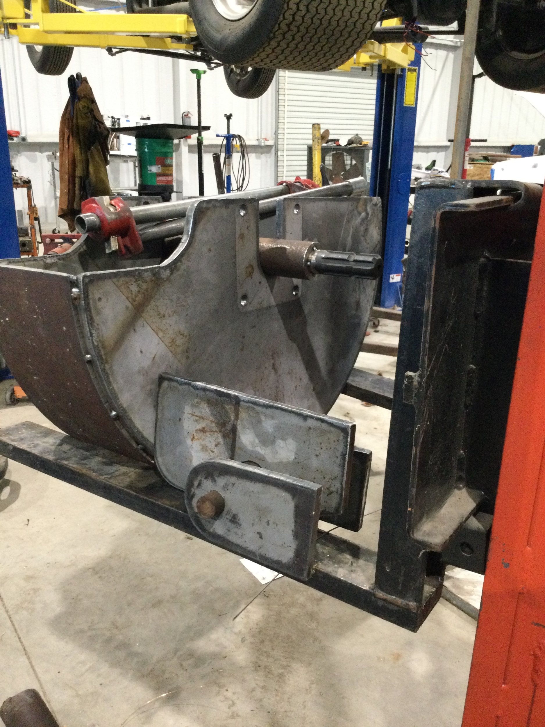

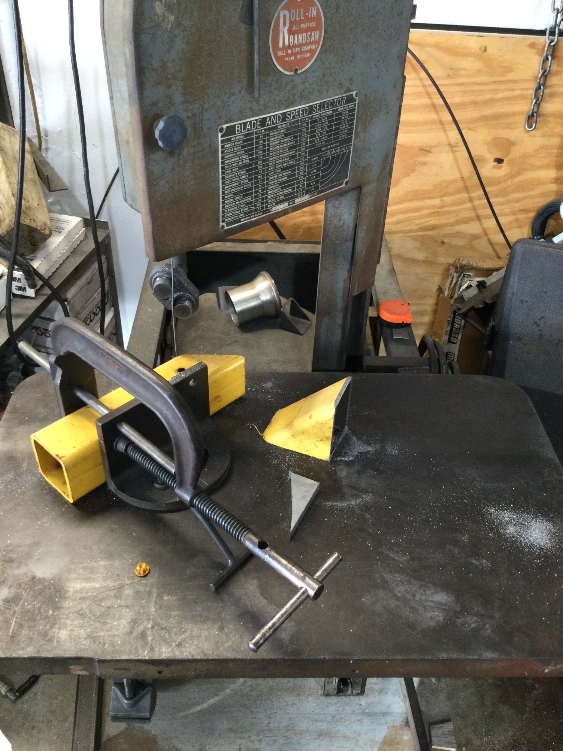

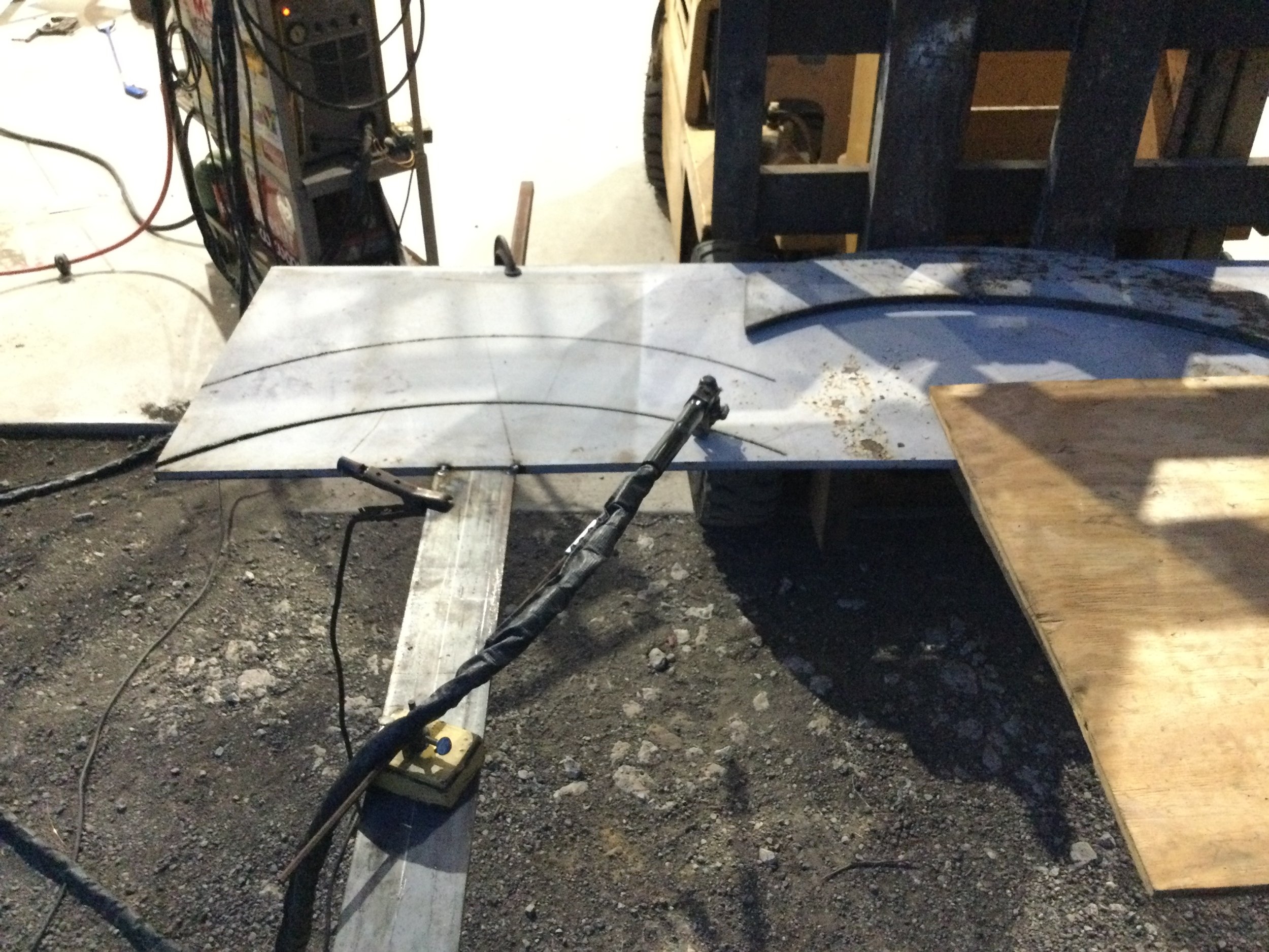

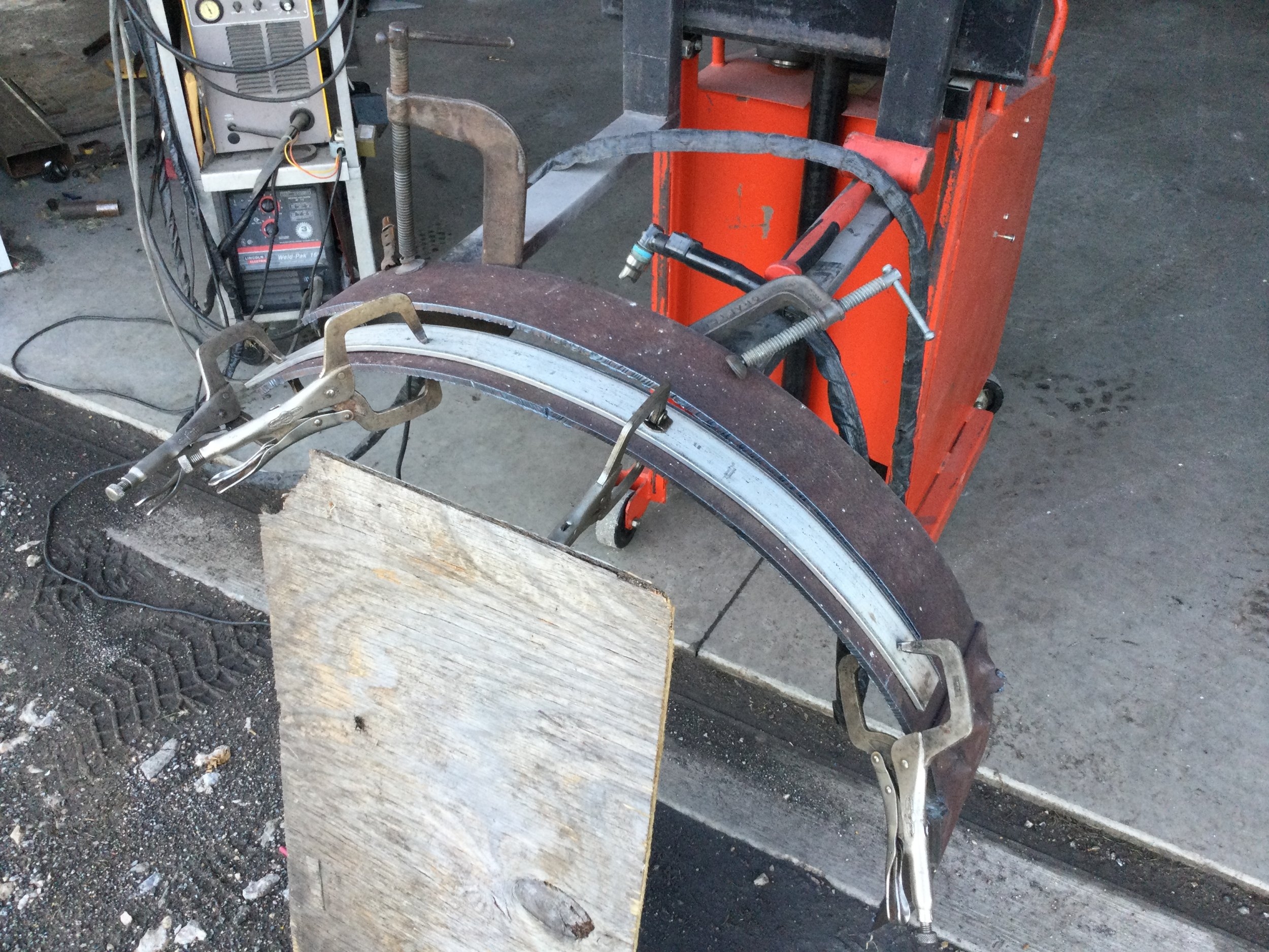

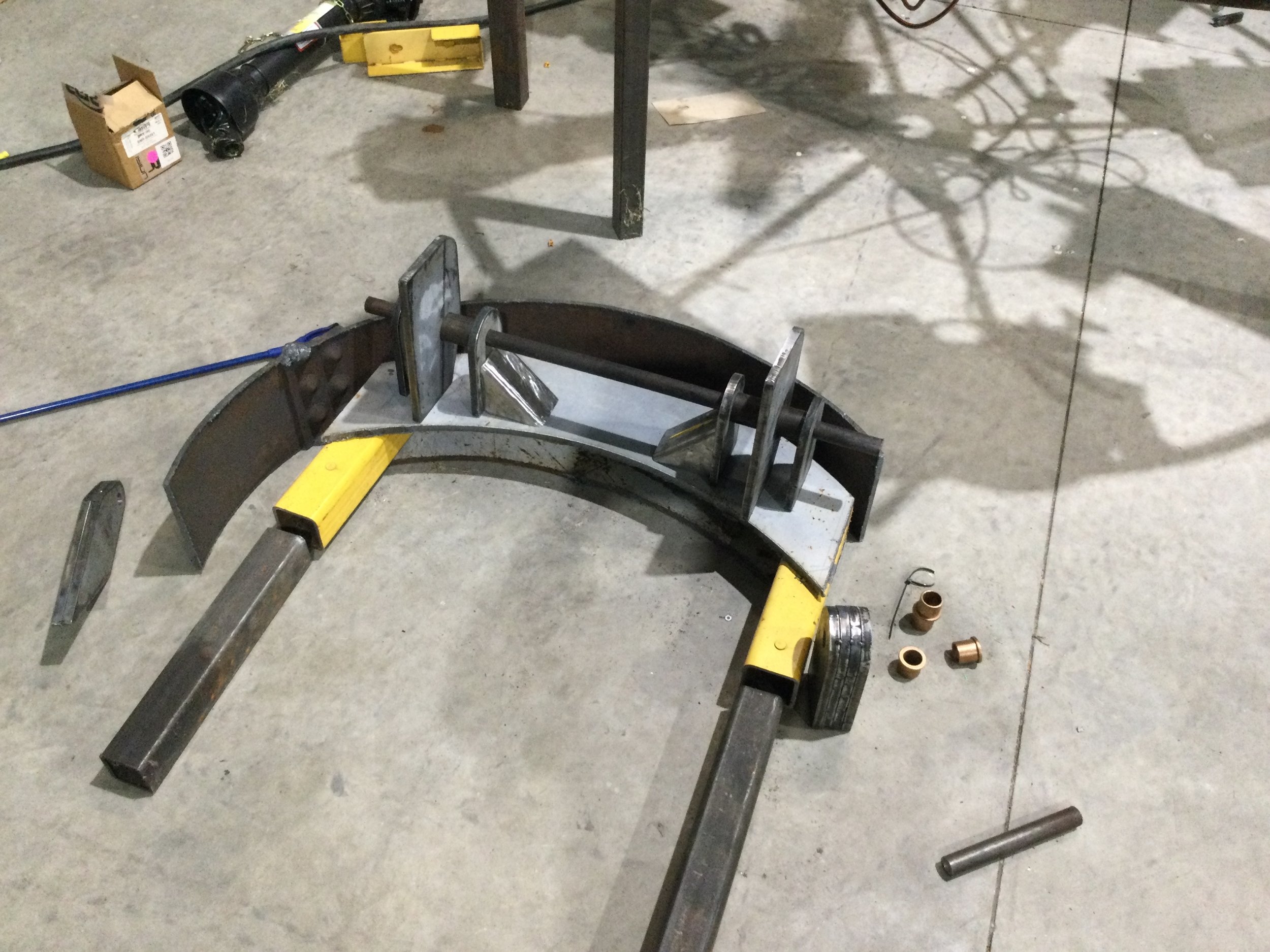

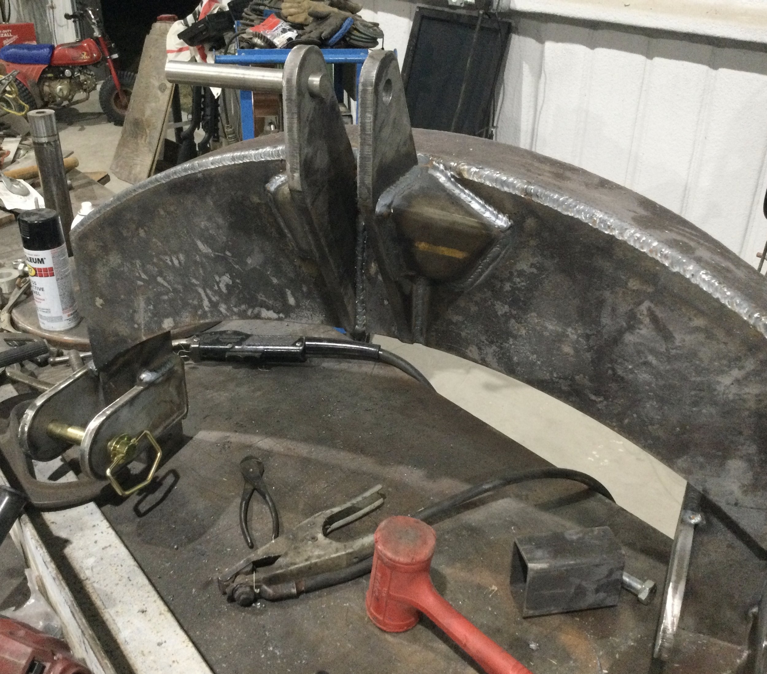

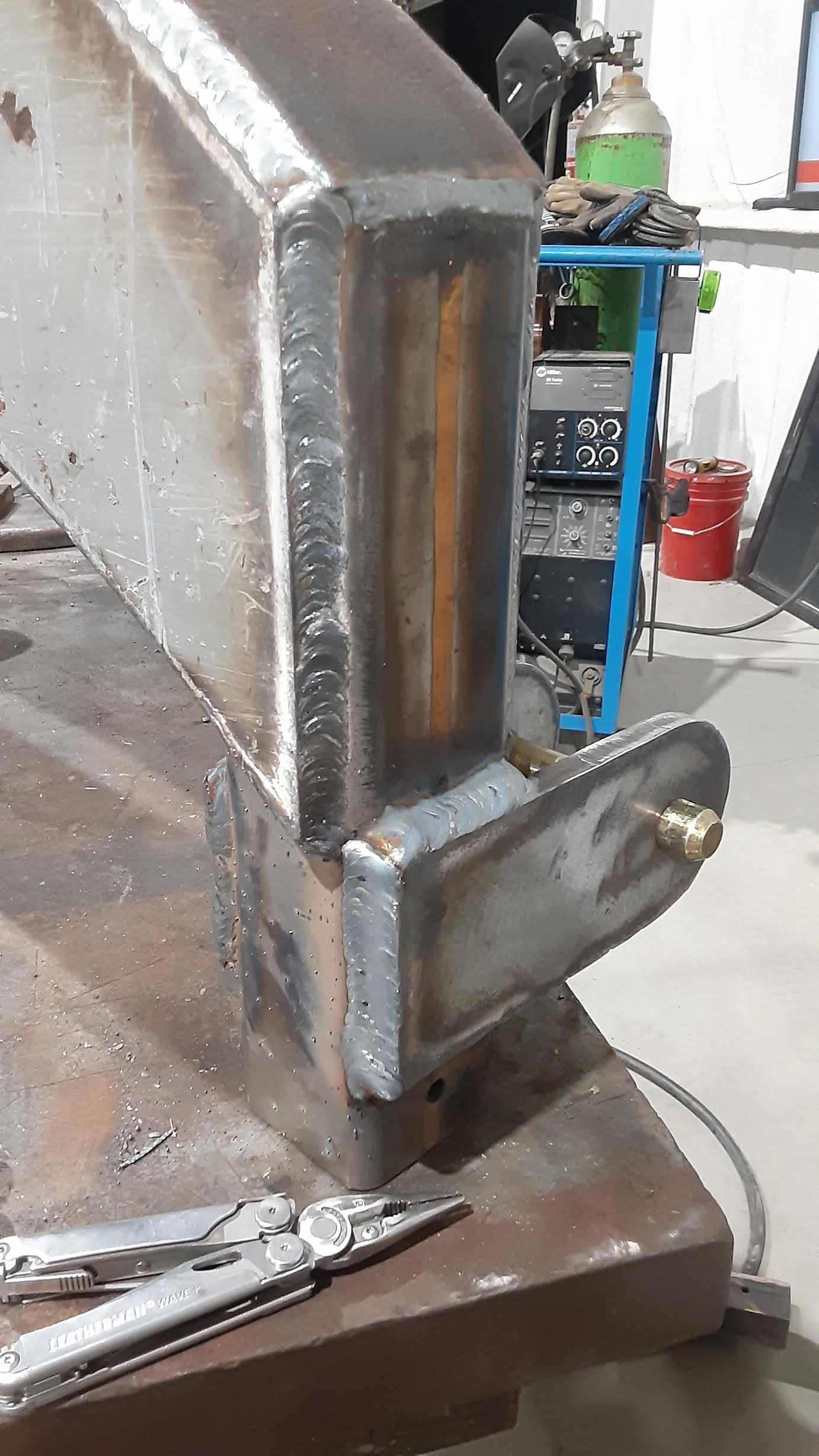

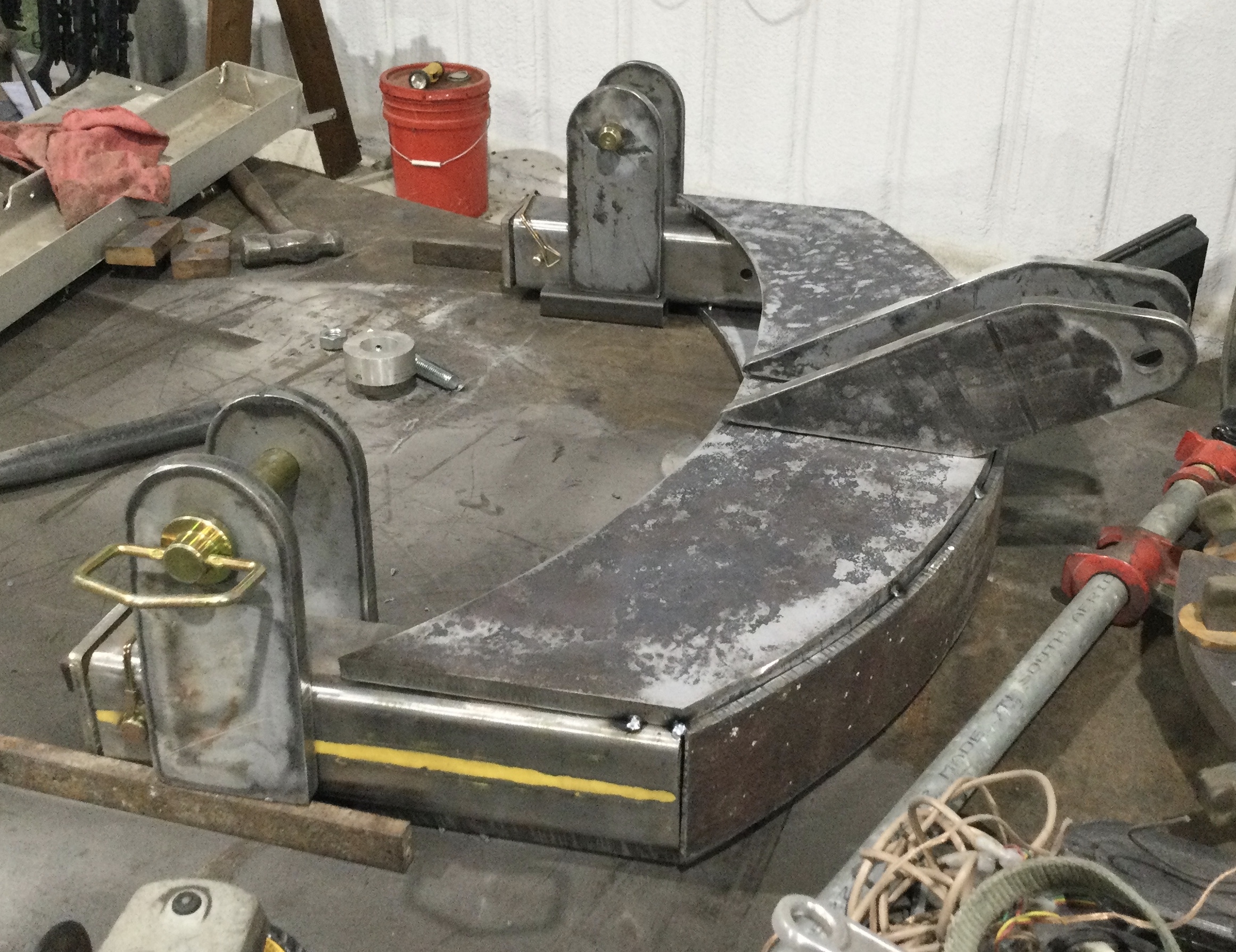

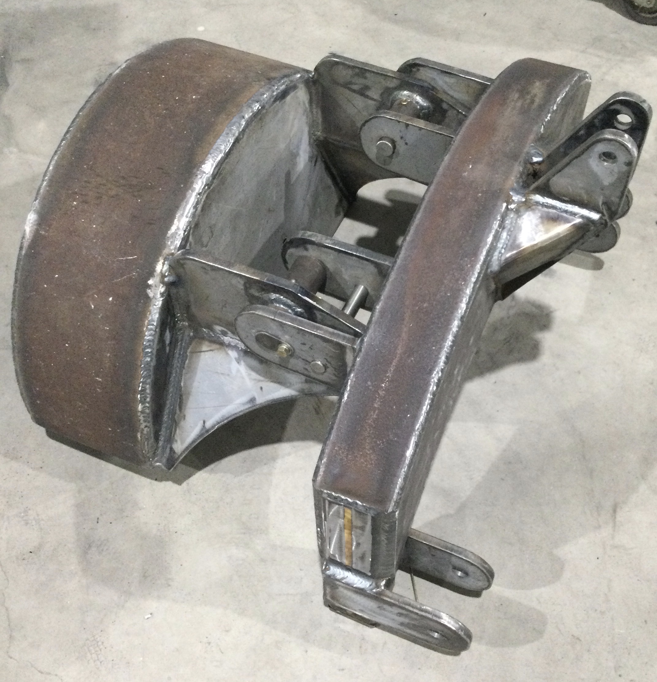

Whats the plan with this hinge, do you want to tilt the cutter head a bit to provide controlled depth of cut, without using the tractor gears ?
No I am going to use this with our HST tractor. The idea is the hinge allows the cutter to swing away (actually hold position) if the tractor moves and the cutters can’t cut that fast, then the operator stops advancement and lets the chipping head cut until it’s back vertical.
The hinges and the clutched PTO shaft are basically “fuses”.
They are not going to move as much as in that photo above, just a few degrees will be inches at the stump, should keep the u-joints happy.
The 3/4” pin locks them so it doesn’t flop to the ground when you want to store it.
I hope for you that it works the way you envision. A chainsaw has depth gauges, preventing the chisels from biting too much and stalling the engine. I dont have experience with stump cutters, but i would rather have a slip clutch in the PTO shaft as driveline protection, and have the cutter assembly as rigid as possible. Also, your link arm stabilisers would need to be very tight or it will rock left to right whenever you engage a stump.
But i am keen on following this project and see how it pans out on the test run, i have only watched stump cutters from a distance so i might be wrong off course 😀
   / PTO powered stump grinder build #46
Many small grinders are designed with the forgiving swing away feature. There are several 3pt makes and skidsteer ones too. I like how the OP is adding heft to his as that should help with it hopping while cutting...good job and keep us up to date. (y)
That one looks like a toy compared to what the OP is fabricating

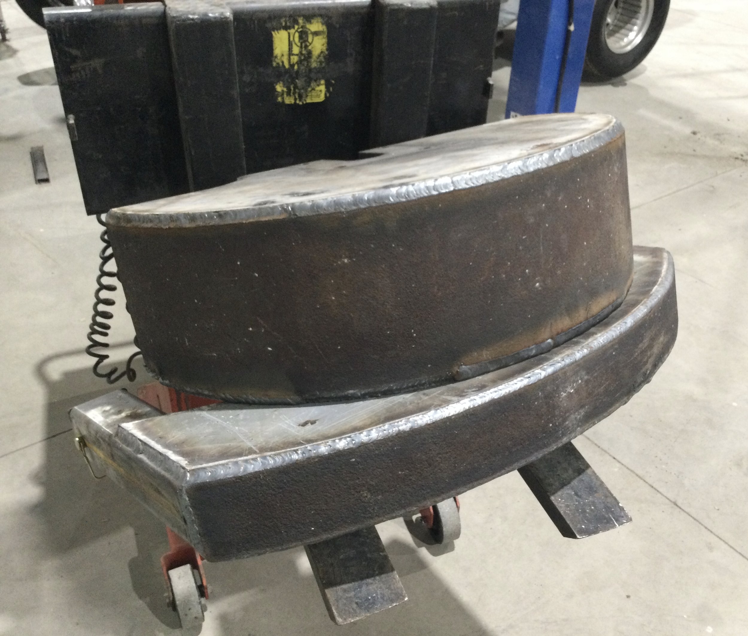

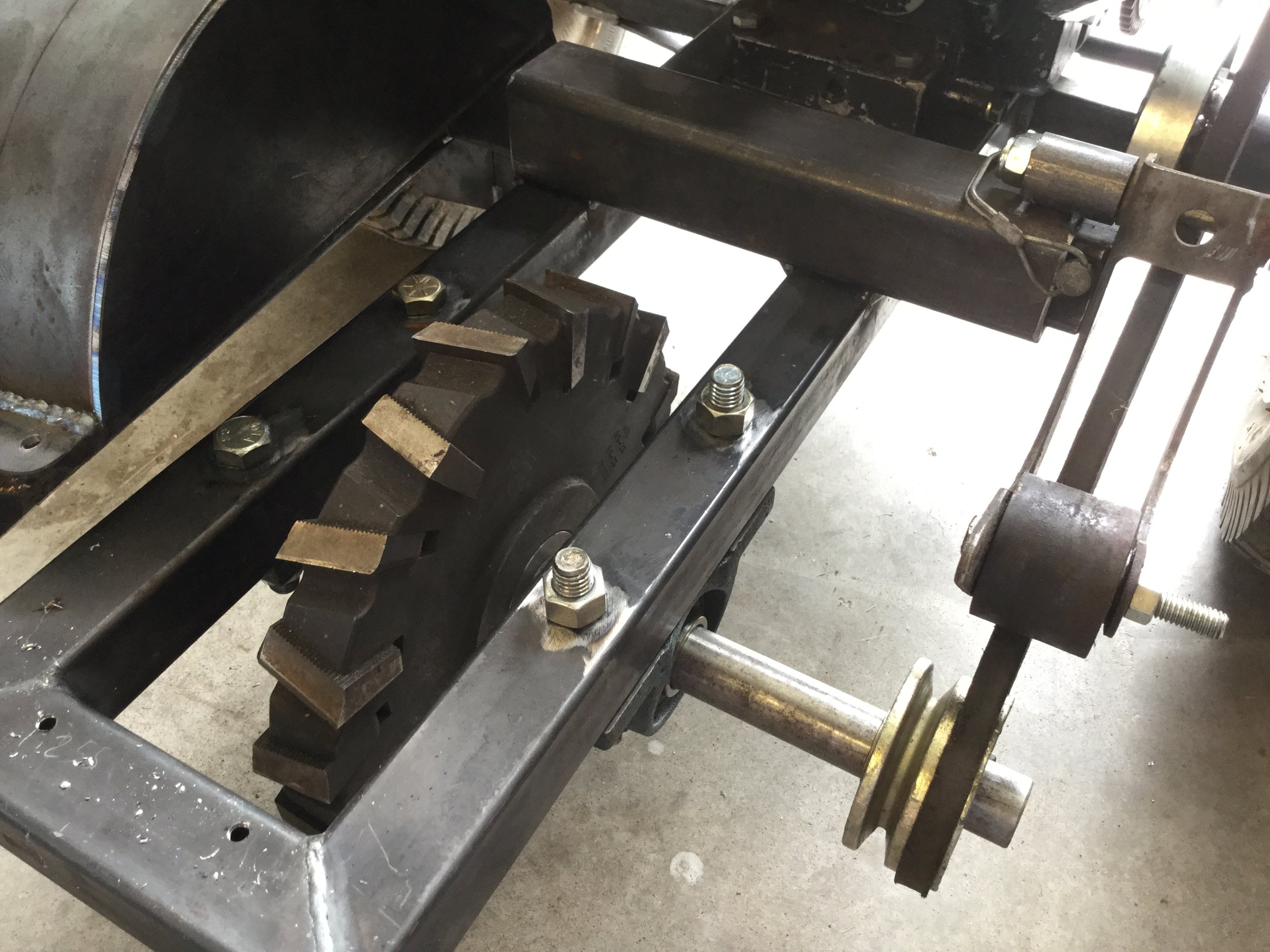

Exact same concept though. There are a number of outifts that make them based on the same concept, not an original idea just the execution and I‘ll admit I wouldn’t build them like this, if I were selling them but I was using as much scrap as I could.
I didn’t get too fancy with setting the tooth angle, just a slight inside rake, squaring the face with the centerline.
Set the angles with some aluminum cut to the proper angle and a “shim” for depth of cut.
Then finished welding it out (photos - the 2 spots I missed).
Luckily I took so long on this project @pmsmechanic , had me go get a balancing machine from the farm and bring it home. It did catch two welds I missed though.

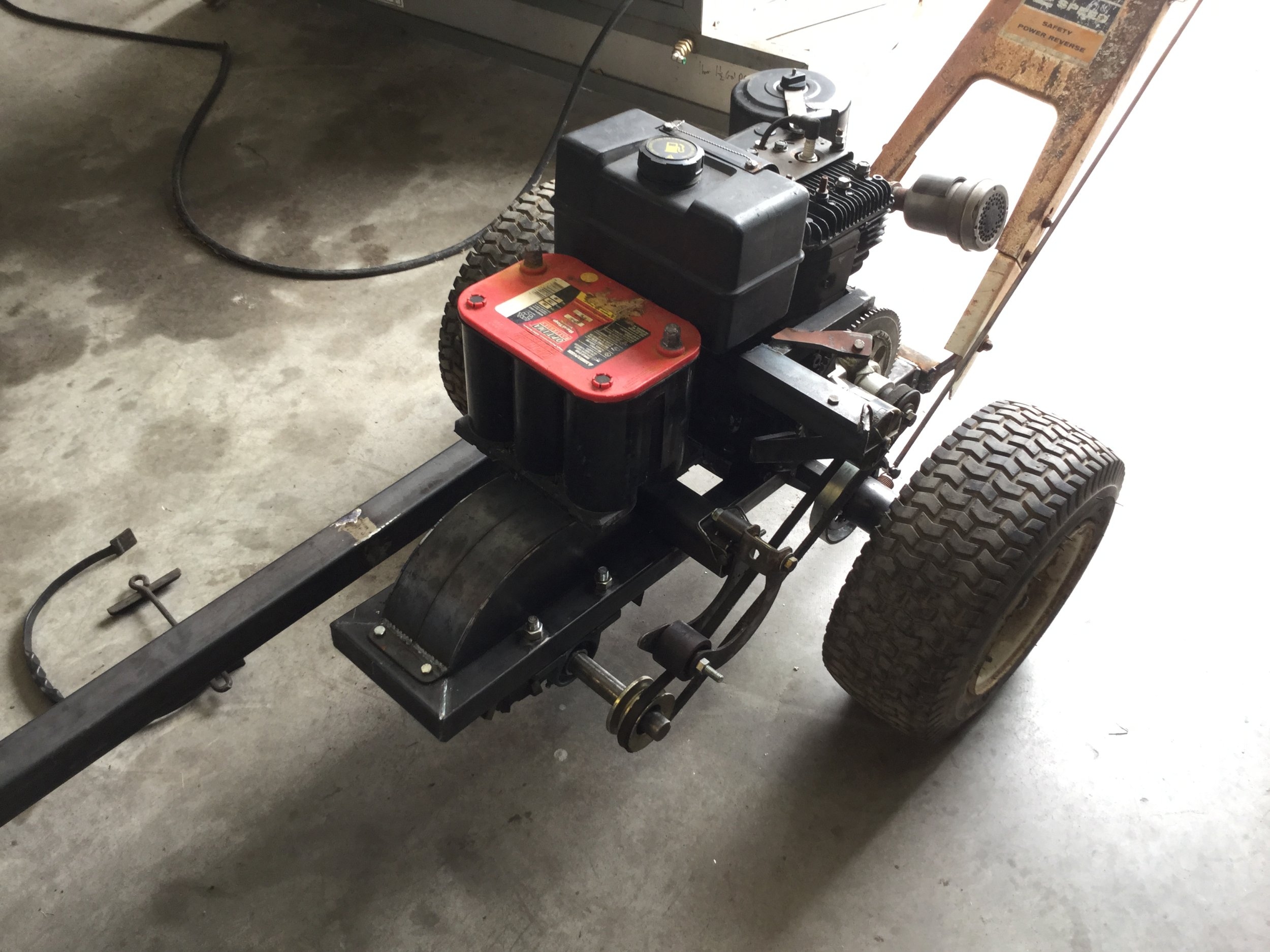

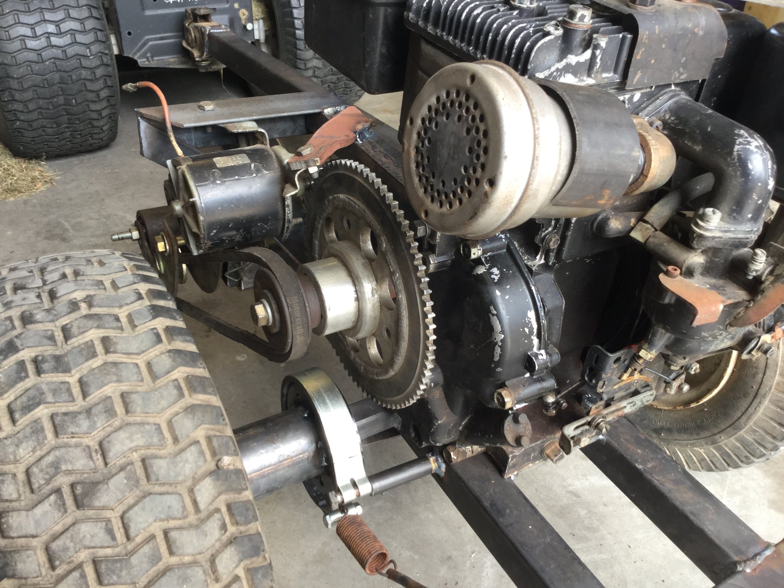

I wasn’t either, the first one I built, years ago now, was another scrap build that was a side to side swinging one but manual. It works but is a lot of work or I am too old.
I built it when I was given this cutting head.
Used an old brigs 8hp engine that I threw and electric starter on, the go kart brake on the axle is so you can throw a lever on the tiller handle bars, locking that wheel, making it easy to swing the arch.
Battery up front for weight over the cutting head.
I will say this, that one takes up more floor space in a barn than this one will, if that’s important.

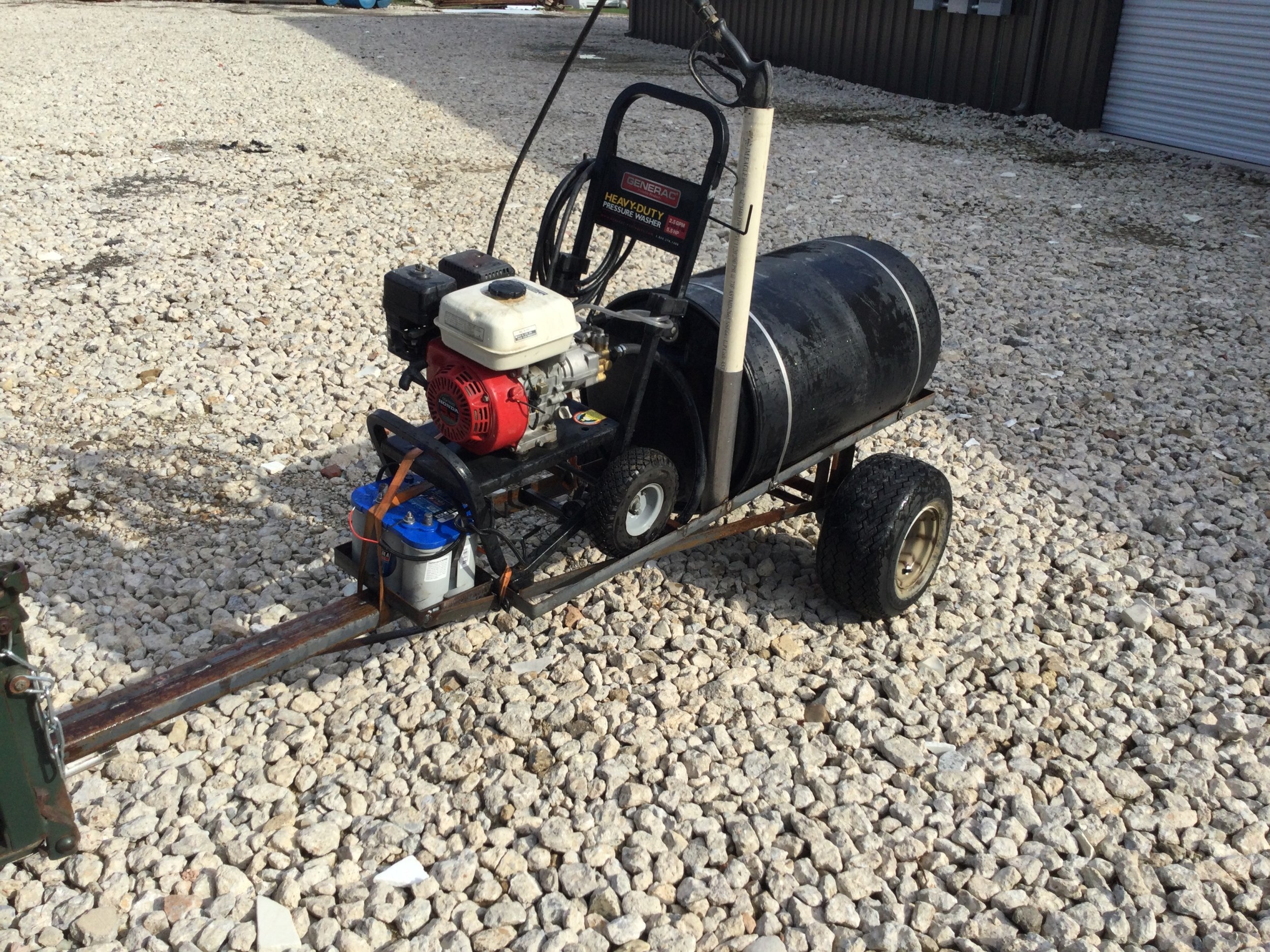

I wouldn’t be too worried about dirt but our place has lots of rocks and gravel. So I threw This trailer together so I can blow them away from the stumps, so I can get them below grade.
It’s work too but I imagine the teeth last much longer just hitting wood.
View attachment 839032View attachment 839019
I’d trade for one of these though. :)
In reality, quality tungsten carbide teeth will deal with rocks pretty well.

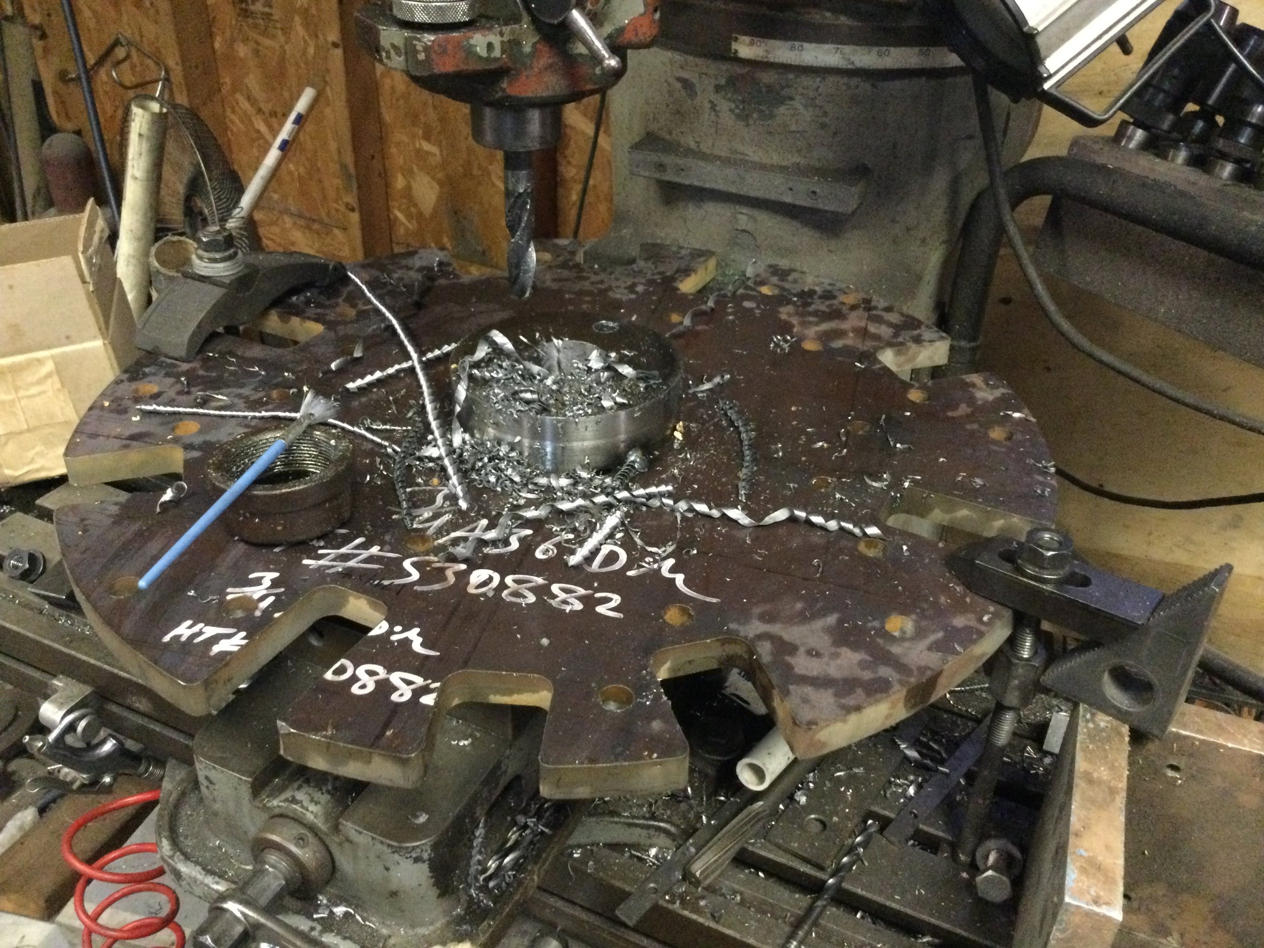

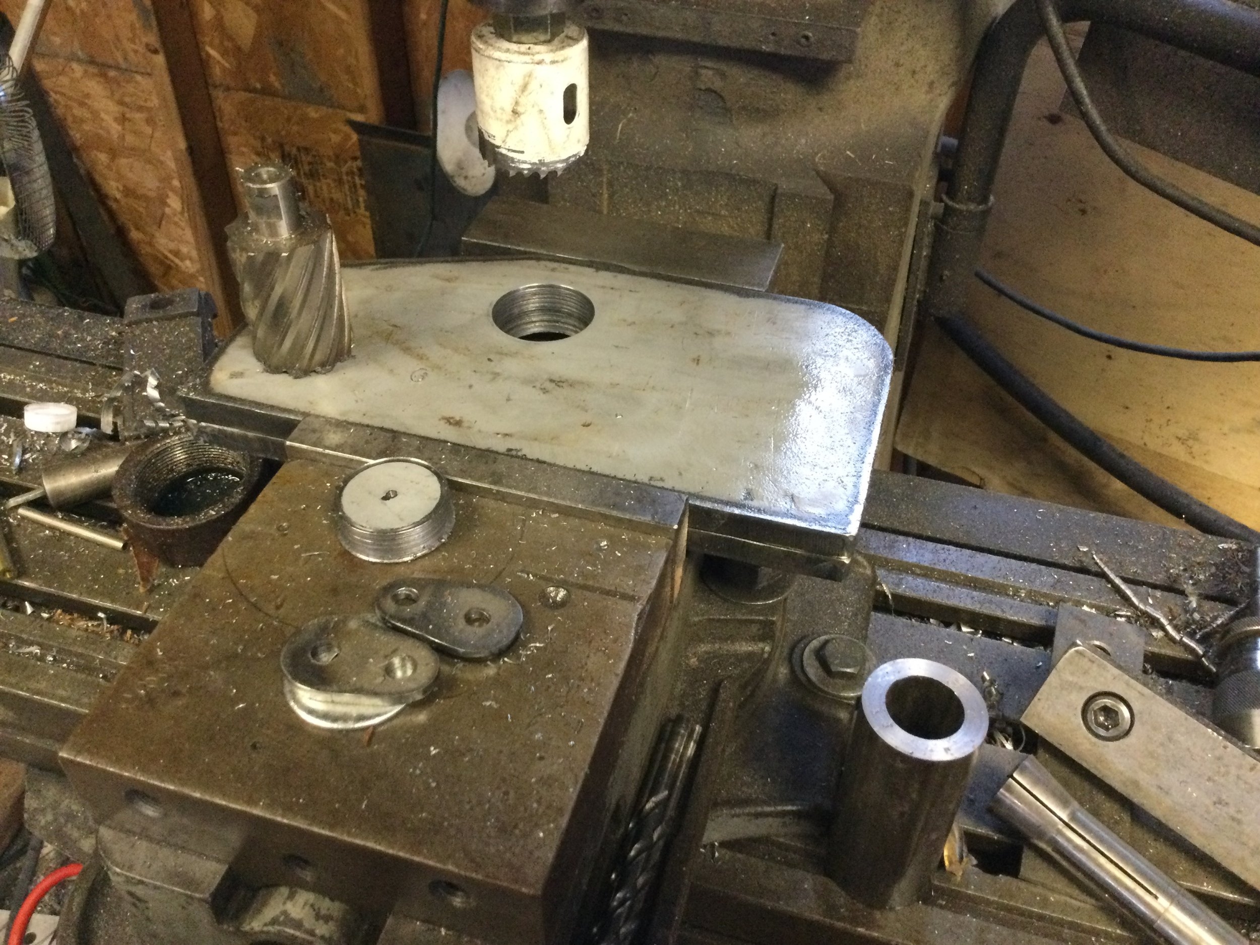

One of the drawbacks of not drawing out plans is you have to measure things at the end and machine to fit.
I started out running PVC through all of the components and measured from there.
Then machined the shaft for the hub.
Froze it so it pressed on a bit easier.
The weld photo must be on my phone but I used the same rotary table and then faced the hub off to ensure it’s perfectly square. It was fine but it looks nice faced...
Then put it together again to measure for the rear bearing.
One more trip back to the lathe and...it’s time for a drink.
I see the carbide cutters that your using, and believe that the large radius on the corners will prolong cutter life and hopefully prevent the carbide from fracturing !
I am curious as to price on the cutters, knowing that carbide is not cheap !Looking forward to your test run !

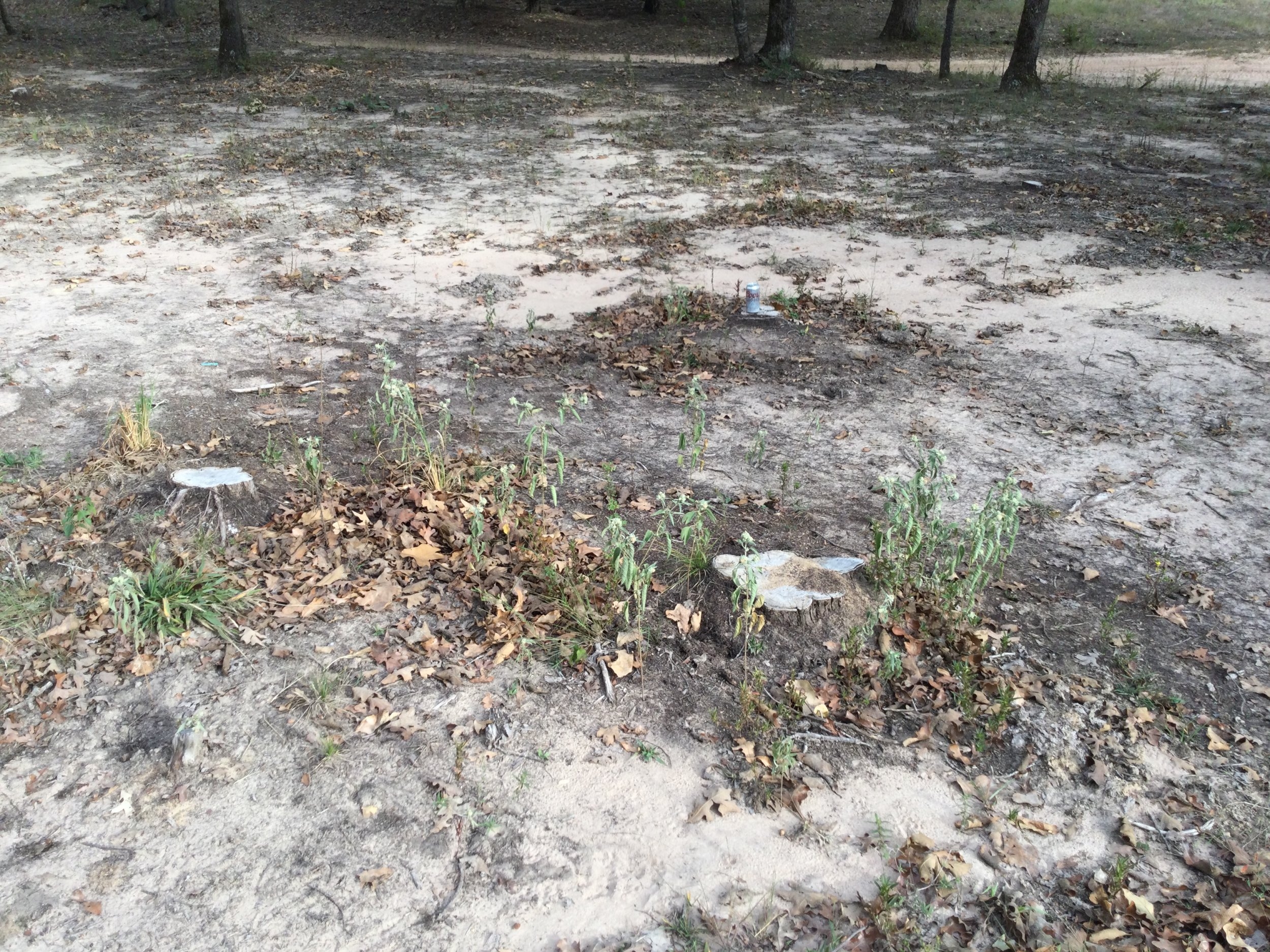

It was dark by the time I put out hay and attached it to the tractor but I had to try it out anyway.
This was #1, before.
And after.
And less than ideal weather this morning so a decent video will be after Christmas. For now this is all I have.
This is how the fire pit turned out, radiates a lot of heat.
#59

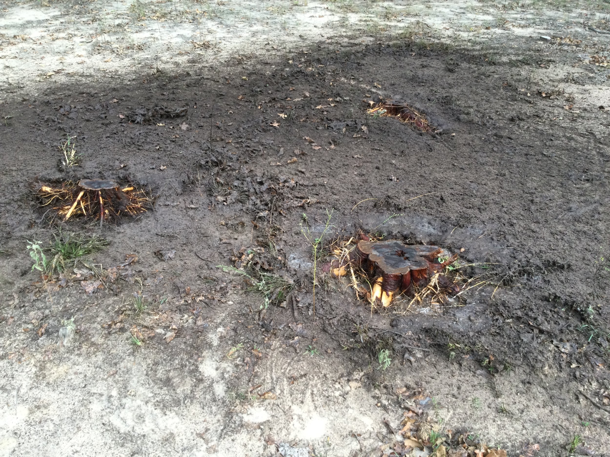

Looks like this one is going to be a winner. Used it for 3 days on shy of 250 stumps (mostly smaller cedar trees) but did hit a few big oak and elm stumps.
This over 2' one was the largest.
and 8" below grade.
The teeth held up well, so far.
in action.
   / PTO powered stump grinder build #60
Congratulations on a fantastic build, that rigs not even breaking out a sweat :).
