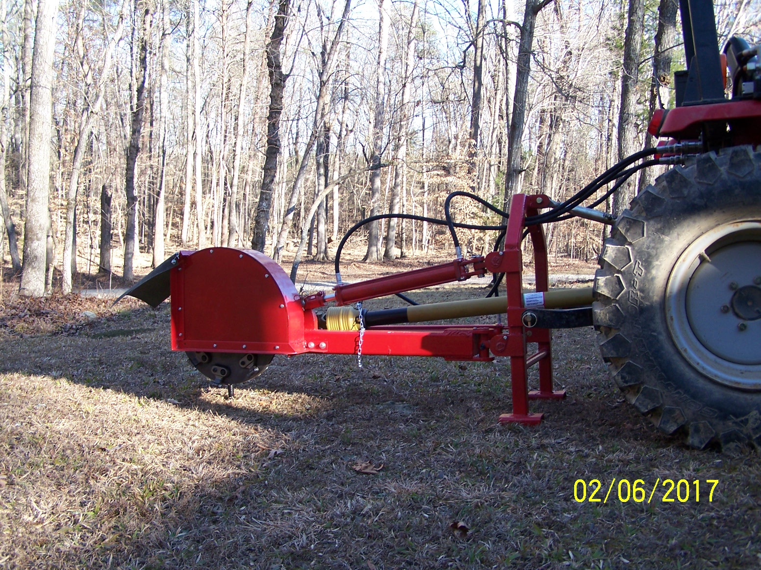

Your stump grinder looks real good, I built one about 3 years ago went by a youtube video by Billy Taylor, will try to post a photo of it but it might work. 02.jpg04.JPG

That looks Great! how does it work?

It works real well, I'm using a Massey Ferguson 1428V compact tractor 28HP, had to plumb remotes in the rear to use it, on pine goes thru like butter oak its ruff on it but it was dri oak, ground up about 3 large oak's and several pines have not used it in a while, good luck on your grinder.

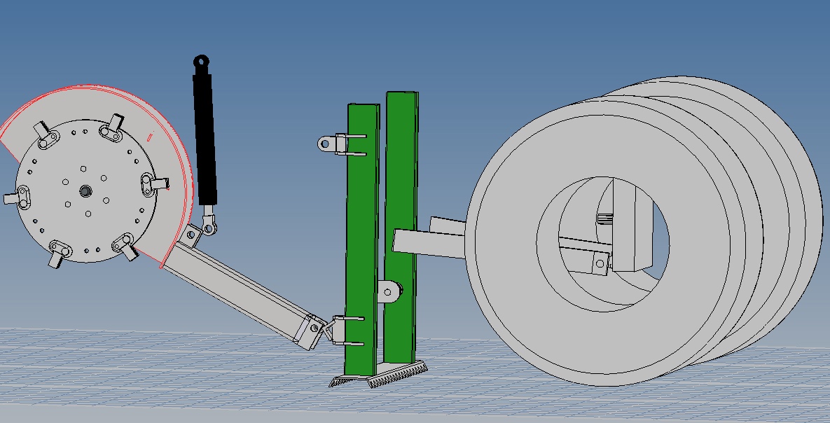

I remembered I have a full 4x8 sheet of 5/16 sitting out back in the steel pile, needs a bit of cleaning as it's been sitting outside for a few years, I dragged it up to the shop this evening. Now I just need to start drawing up the parts in CAD and order some greenteeth, a pto shaft, and the cylinders (once I figure out my dimensions).

It'll pretty much look like yours for the most part lol, not a whole lot of ways to make these.
I think I have all the metal I need, just wish had a piece of 1 or 1.125 plate for the flywheel but I'll make do with 2 peices of .625 faced off and put together.

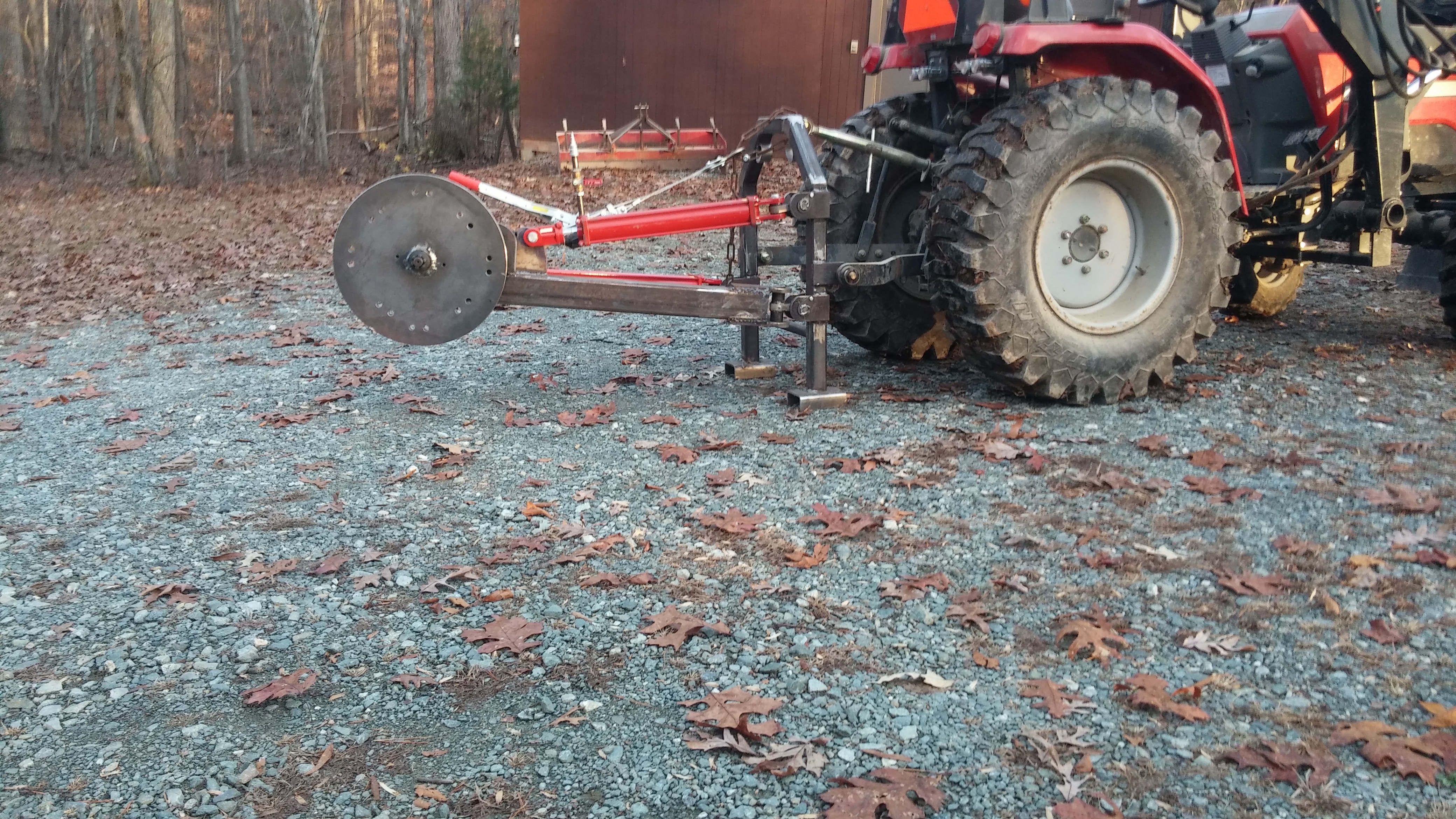

Added a couple of gussets today, added a kick stand.
Got it put back together, and gave it a couple of test runs. I think I need to put an orifice in the cylinders.
August 1, 2020 - YouTube
/ Stump grinder build #78
I would recommend one way adjustable needle valves for both sides of the swing cylinder. This allows you to tune the speed of both the extend and retract to be the same or have it slow in only 1 direction if your only cutting on 1 side of the wheel so you can increase production. The height cylinder could probably get by with a fixed orifice.

I’ve actually been using it as is. I drove my little 4310 45 minutes each way to my mothers house last weekend and ground roughly 30 stumps. (Hurricane Dorian carnage) took me most of the day and left me with a sore neck, but it will make a huge difference when it comes to mowing the grass.
I still need to make a hinged shroud to catch the debris, it throws chips incredibly far.
I picked up some clips to mount the hydraulic hoses to tidy them up. But haven’t mounted them yet.
My wheel cuts in both directions. So I won’t need to have it go faster in one direction. (Since I’m cheap I’ll likely just suffer through feathering the controls)
