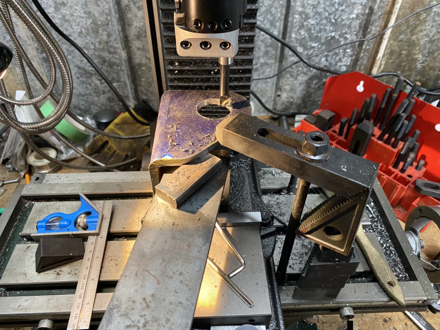

Managed to salvage the main pivot bracket that I messed up. I ended welding the off cut to the top of the Bracket which allowed me to move the pivot point down to the centre of the bracket.
Made another sketchy setup on the mill to notch a piece of heavy angle iron for the cross tube. Don't judge my welds
I won't, but I am a welding inspector, in the business the last 37 years. :D

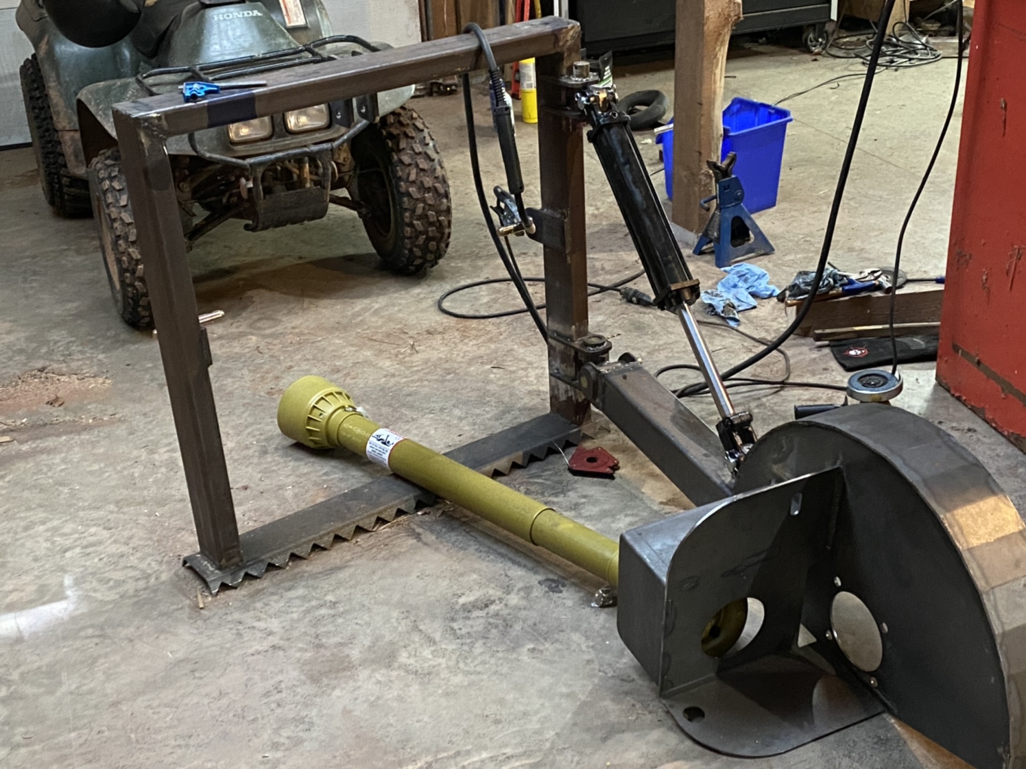

Got a little more done today
I also picked up a new toy :)
/ Stump grinder build #43
Looking good, how much travel are you figuring you'll have?
#44
I think the travel will be close to 30” side to side, and about 10” below grade.
I’m hoping to get the horizontal cylinder mounted today, so I’ll have a better indication of swing and make sure nothing binds.

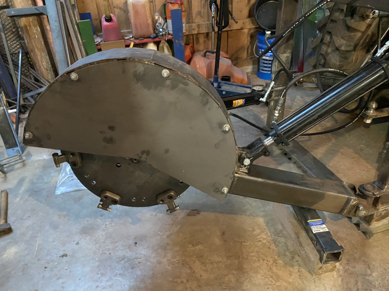

Made the brackets and attached the horizontal cylinder today. It’s starting to look like something.
I’m considering lowering the 3pt hitch pins to get a little more ground clearance for transport. (Of course I welded those solid)
And horizontal swing is closer to 24”
Which is more than I’ll need for my trees so I guess I can live with that.
/ Stump grinder build #46
I would agree about lowering the 3pt lower pun mounts.
Transport height is good, but my theory is that by lowering the lower pin mounting points to where the 3py arms are about or below level they will be less apt to lift under load.
24" is pretty good for the swing, the Woods is only 20" and the most I've seen is 28". Less swing also puts less stress on the driveline.

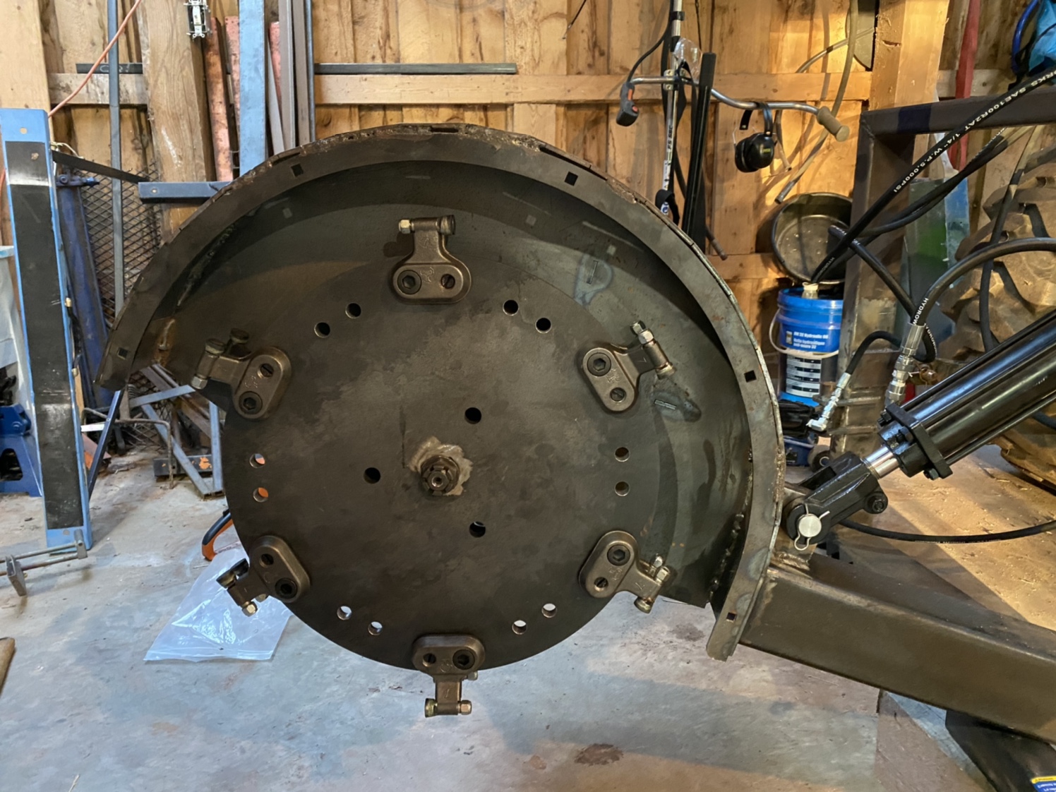

Me too! I just spent 200$ on hydraulic hoses and fittings and still forgot 4 fittings.
Last night I tore apart a brand new gear box to flip the bevel geaR to the opposite side of the shaft so it would spin the cutting wheel in the right direction.
(Pro tip, make sure you know from which direction you are looking the gear box when you spec CW or CCW rotation. )
Does anyone know if a breather is required on the gear boxes?
Mine came with two plugs, no breather.
/ Stump grinder build #49
All the gearboxes I have are vented, based on how much heat it will generate I'd suggest making it vented.
A couple of mine just have a hole in the fill plug, due to the dusty dirty nature of a stump grinder I'd get something like sintered bronze to keep the gunk out.
#50
Since I’m mounting this 90 degrees to how it would be used on a rotary mower would it require a different amount of oil?
Also it didn’t come with an owners manual and I’ve had no luck searching the numbers that are stamped on it.
Any recommendations on how to check the proper amount and type of oil.
If it where installed on a rotary mower both filler plugs would be on top of the gearbox. In that configuration you could fill it until the oil came out of the lower hole.
The way I’ll be mounting it, it looks like that might work if that’s enough oil.

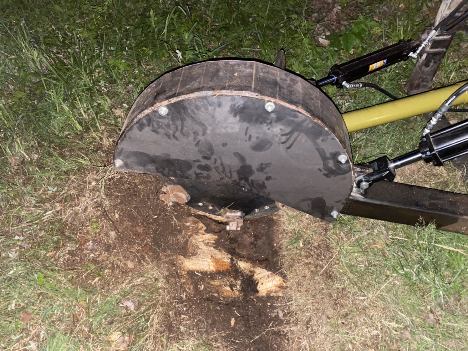

I gave it a quick test tonight. :)
It was too late and too many mosquitoes to get anyone to volunteer to take any video unfortunately.
It runs well at 540 PTO rpm. It has a small rough spot coming up to speed.
And yes, I think an orifice is in order. It’s totally doable, but as you say, it’ll get tedious quickly feathering the lever.
/ Stump grinder build #58
That's great! Really good build. Looks like it did a great job on that stump. :thumbsup:
