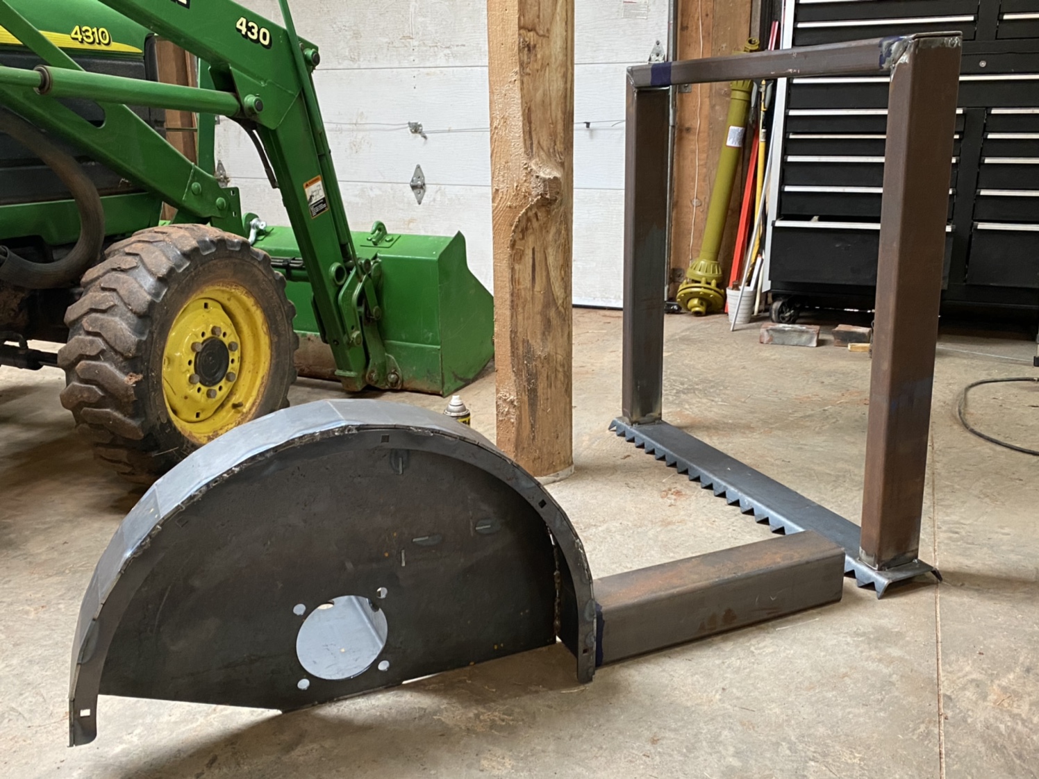

Yes the whole assembly is 3/16.
The 4x4 is 1/4” and the main frame is 2x4-3/16
It’s pretty heavy

Well heavy is good for these!
I noticed the frame in the background, see you went with a full width foot.
I have been thinking about making mine with individual feet since my area is pretty uneven and could see the full width not getting a good bite.
/ Stump grinder build
#24
I went full width for a few reasons.
1. I was scared it wouldn’t be rigid enough without it.
2. I was mostly just copying Woods design.
3. The though had never occurred to me. Lol
All valid reasons lol.
I was planning on making a crossmember about 4-6in higher and leaving the "feet" with a pad similar pattern to what you have for yours just smaller.
Or make small spikes to help anchor it down so it doesnt throw my light tractor around too much.
I might be overthinking it a bit though, I have seen another design with feet rather then the full width, can't remember who make it though.
I think your thread will help re-motivate me to get working on mine again hopefully!

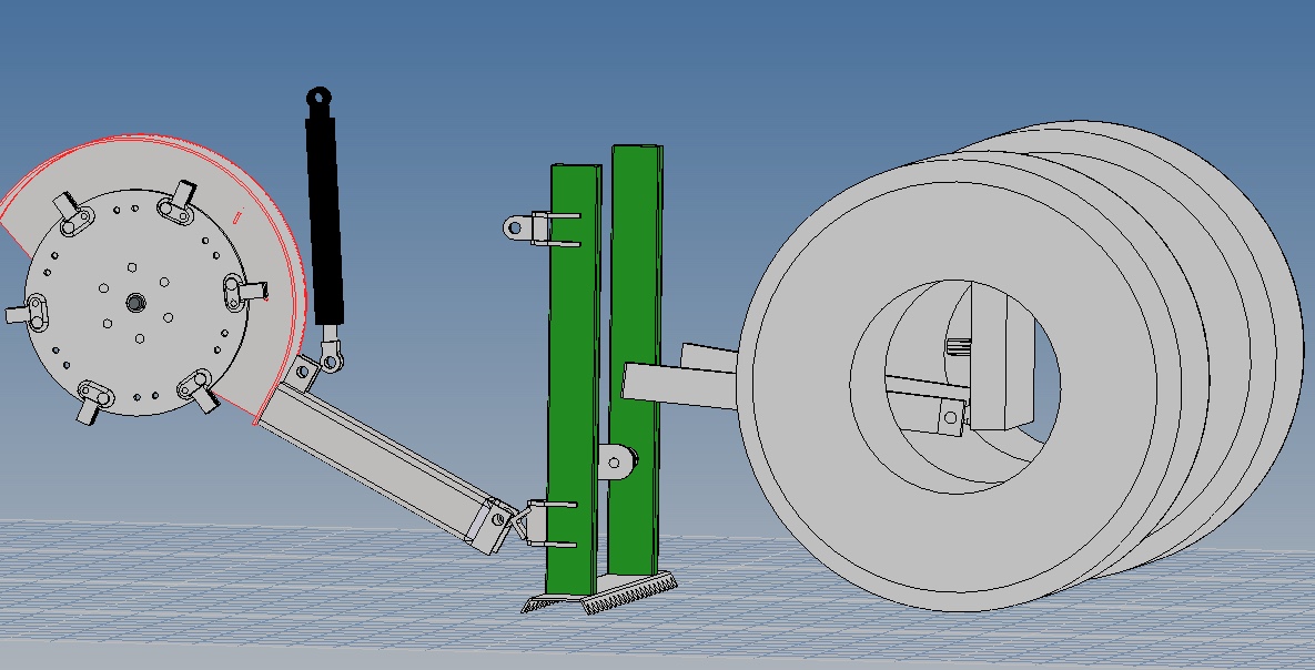

That piece is an off cut of the 4x4 used for the main beam.
It was at the last minute that I found out I could piggy back on one of the work orders. So I only had 1 evening to model the parts I needed. So I stuck with the parts I hadn’t bought materials for already.
I’ve only been with this company since January so I’m trying to keep my l nuisance level to a minimum.
Here’s a hasty model of what’s going on.
It’s what I do all day, and it’s the last thing I want to do when I punch out. so don’t judge it on its crudeness.
Ah got ya, i would definitely invest in some standard size annular cutters, perfect for what you're doing and way less of a pain then using the boring head!
Trust me, if you saw my cad work you'd probably laugh. I'm still stuck in the 2d world for the plasma right now.

Looking at that crappy model just made me realize I screwed that bracket up. That 1 1/4 hole needs to be centred on the height or it’ll sit weird.
