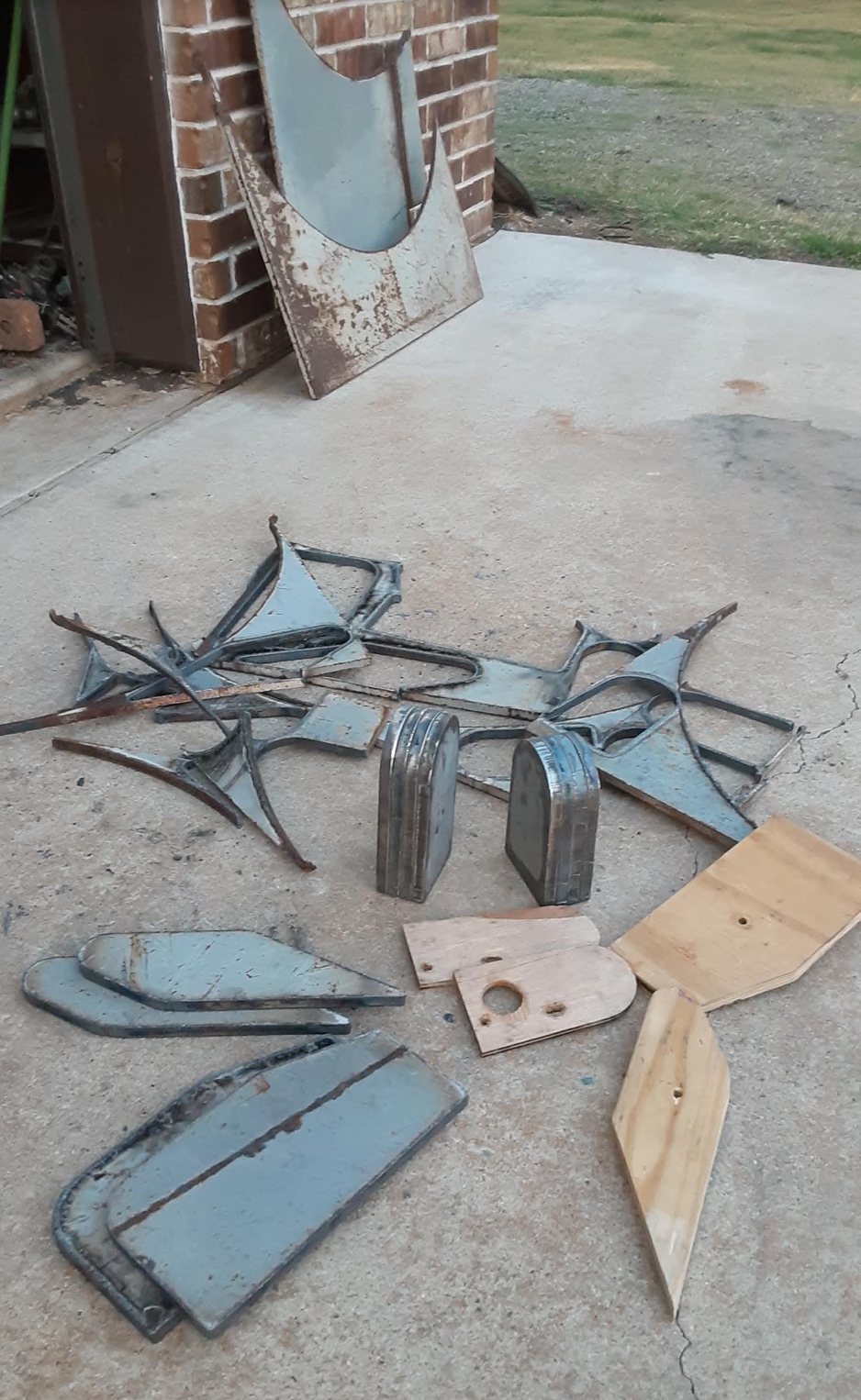

I have been gathering up stuff for awhile and finally got started. The shield is the steam dome off a boiler, my Father cut up in the ‘80’s, (think I’m going to build a firepit with the rest of it) some drop 1/2” plate from a roller project, the clutched drive shaft came from vevor $100 and 34 carbide tipped teeth.
So far I have a dozen of the brackets cut out making the best use out of the plate I could, using my pantograph machine with oxy/act torch.
Tack welded them together for hole drilling, as a group.

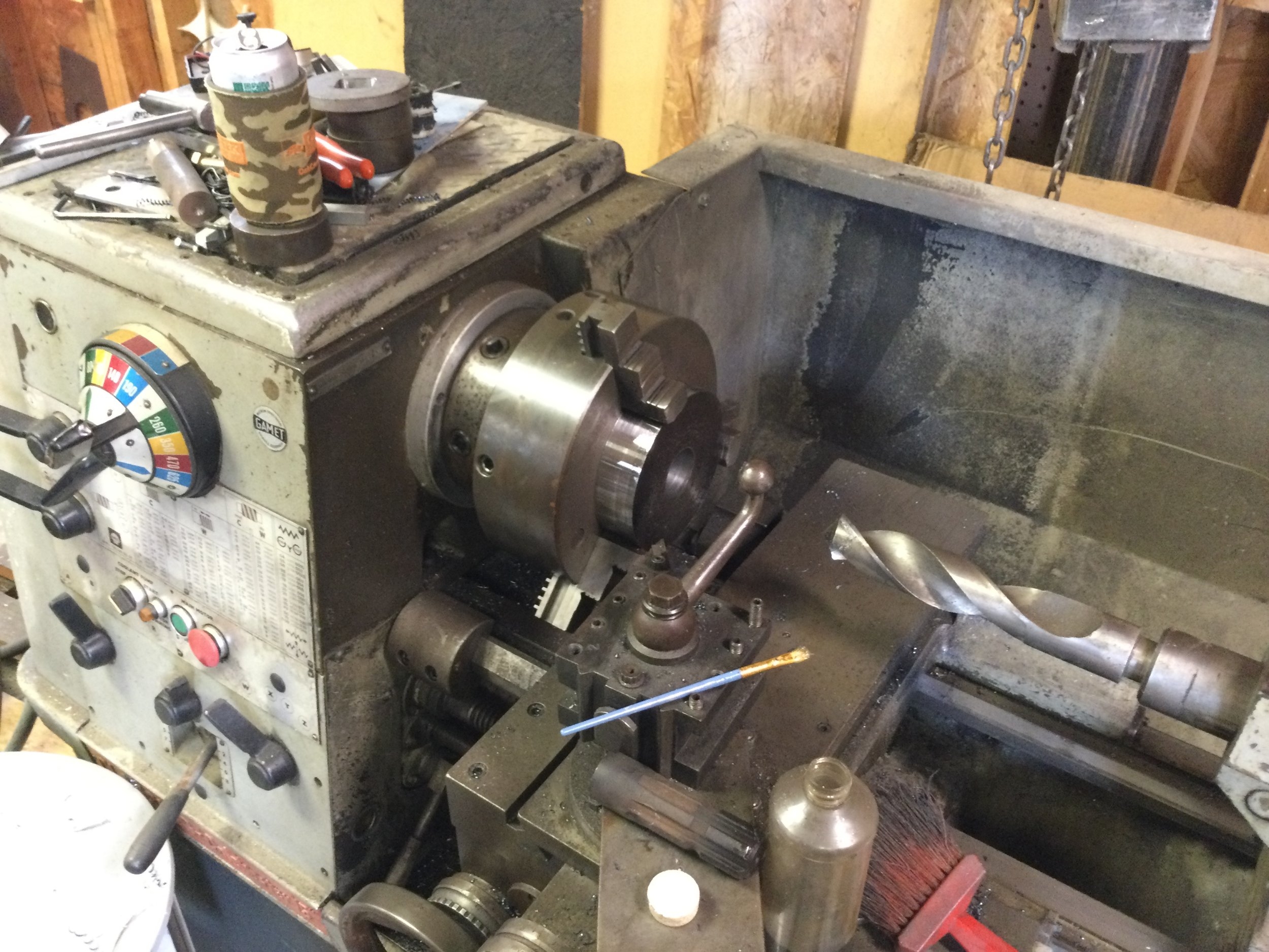

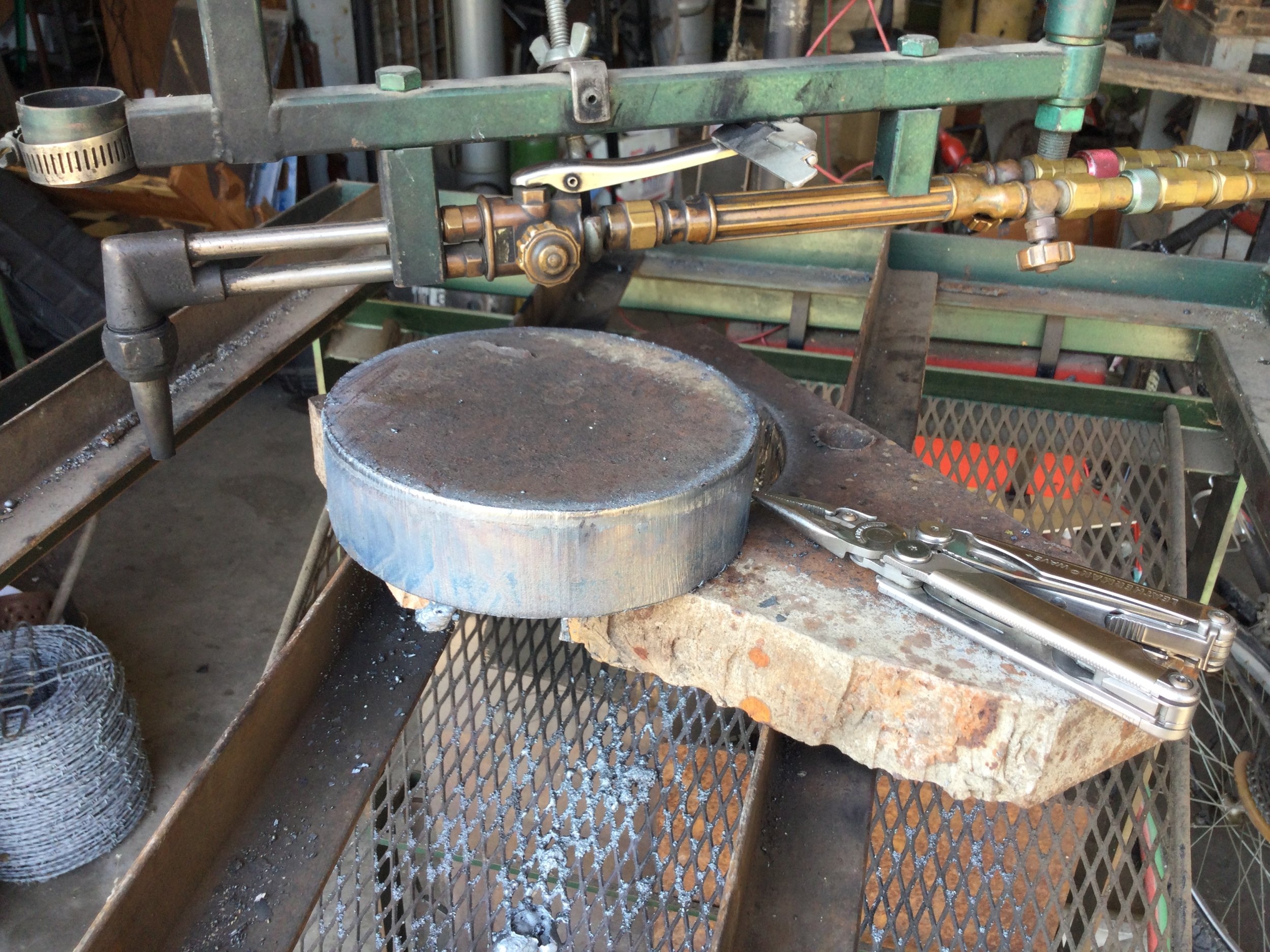

I cut the hub for the grinding wheel, it’s amazing what one can do with a regular hand torch, if it can be guided steady.
1 1/2” plate.
I turned it “perfect” but it’s nice starting with something less jagged than my hands give me. Went ahead and drilled it out close to “finish” size while I had it in there.
Then I bored out the main shaft for the 1-3/8 splined shaft and pressed it in, so it’s ready to weld.

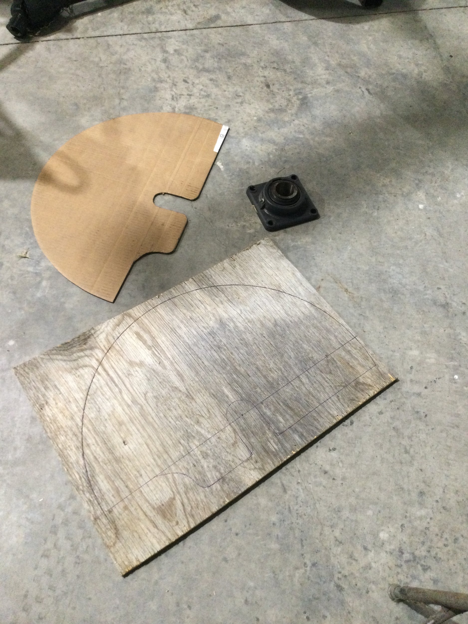

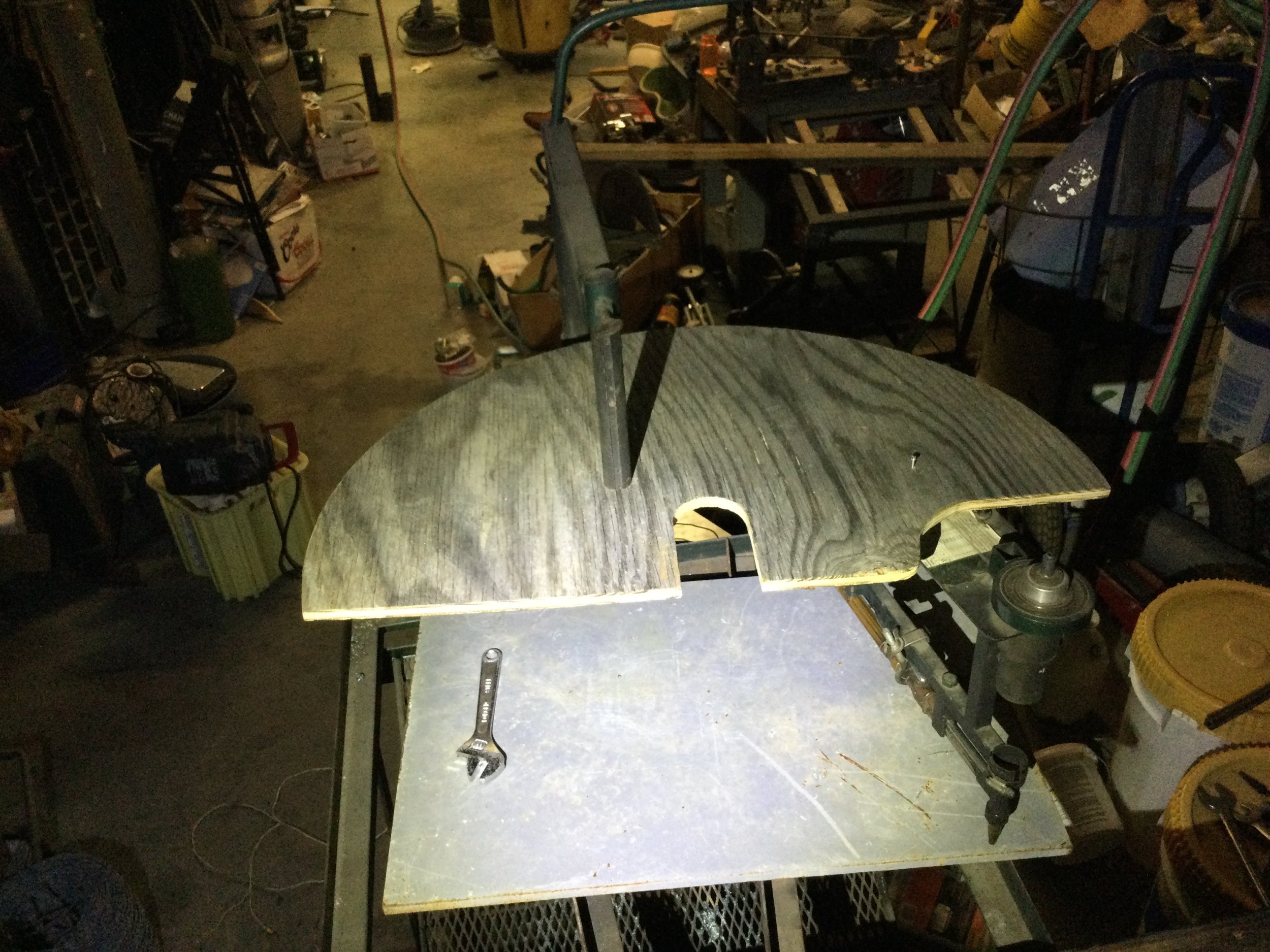

I also mocked up the main front/back plates and layed it out in the right scale for the pantograph (-on OD’S and + on ID’S) on my soon to be plywood template.

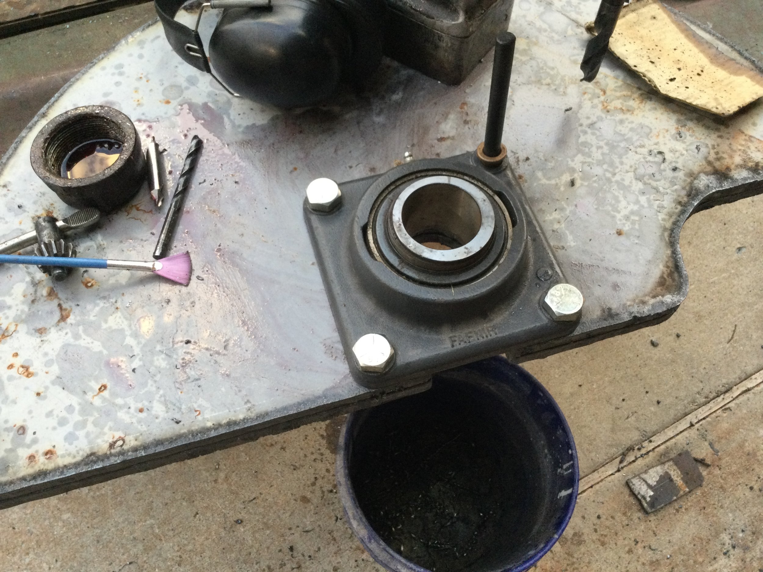

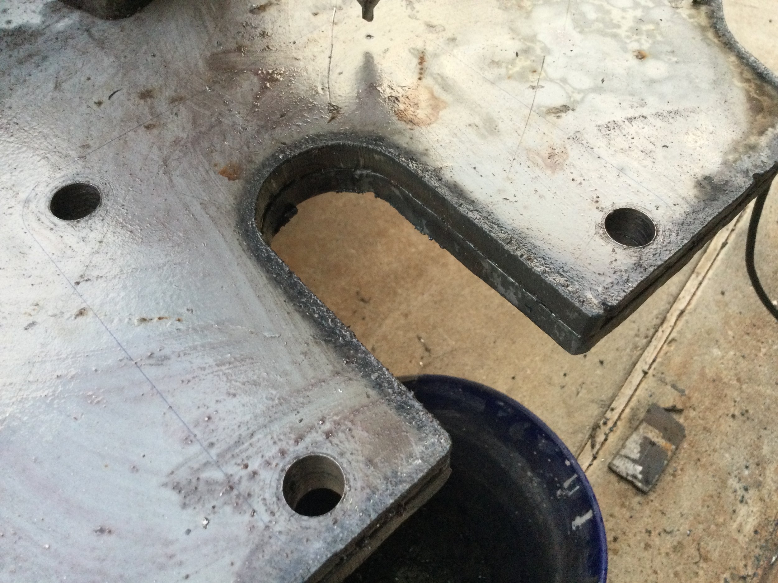

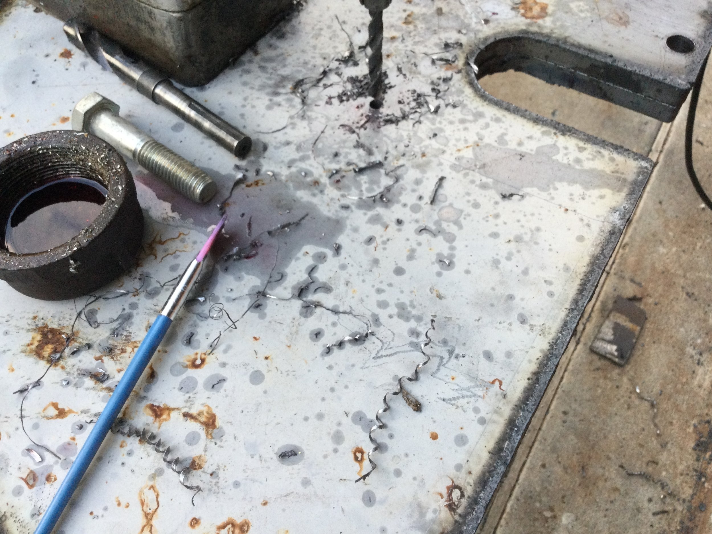

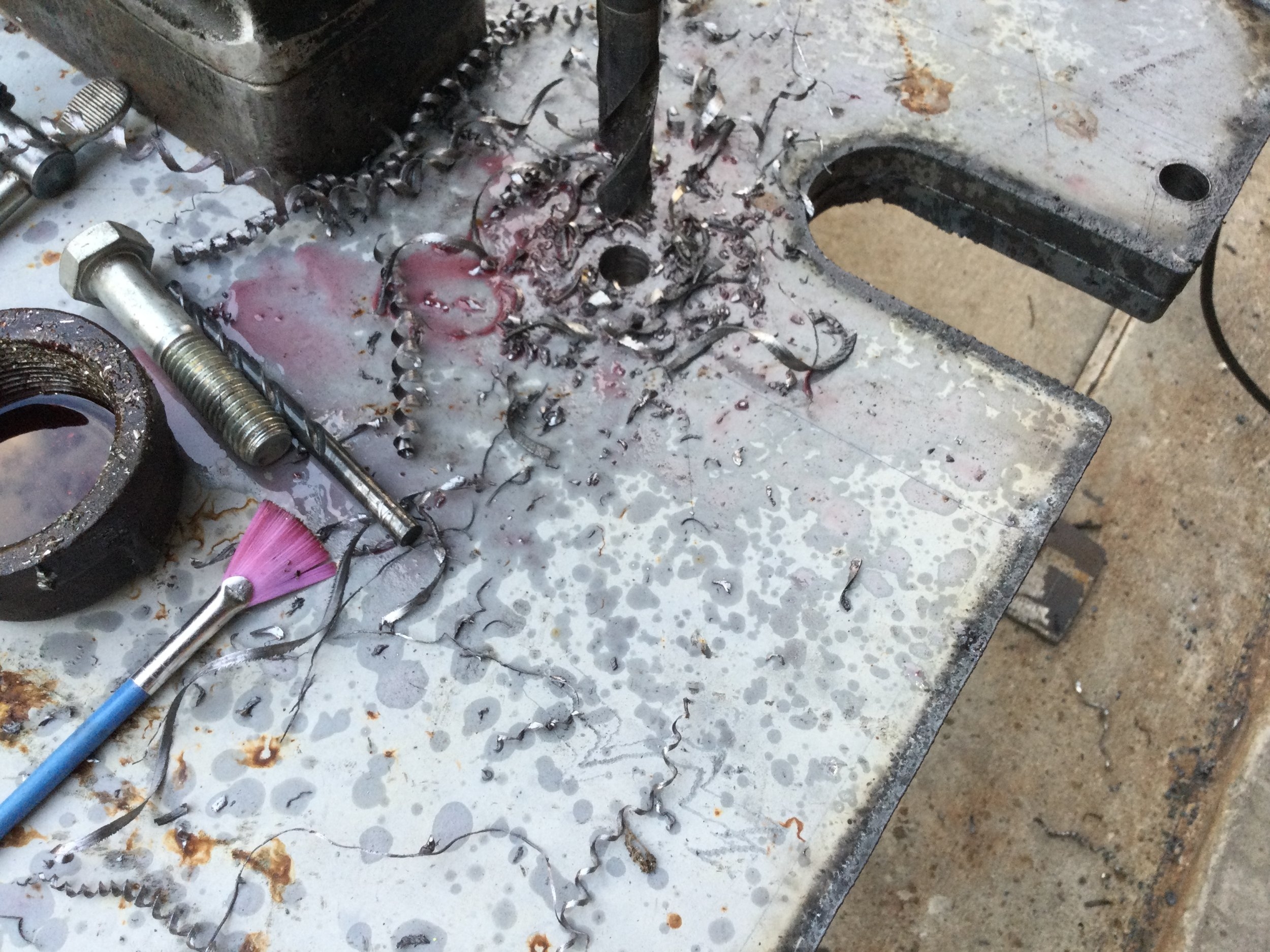

I drilled the front and back plates for the pillow blocks, starting with a center punch to locate the holes.
Then center drill at the punch location.
Next drill the pilot hole.
Then finish drill.
Reset pillow block with shank of 5/8 bolt and repeat, like the first photo, showing the last hole, being center punched.
Ready for the cap plate now.
Started on drilling the other brackets too.

The 1st photo in the OP shows the piece of rolled steel used in this project and the part it was cut from. As well as the 5th photo in post #8.
The clutching drive shaft was one of the few “brand new“ parts of the project. Also, in the 1st photo of the OP.

I managed to make a little headway, have my non perpendicular blade mounts all ready to go.
Cut a couple of 3 x 1/4 box tube sections that will have telescoping feet for storage.

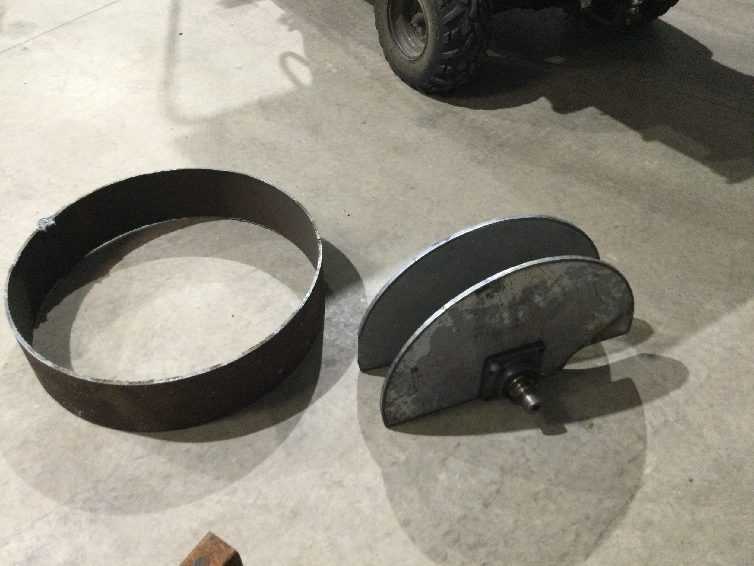

The remaining section of boiler plate was too far off of the main frame arch for me to have hopes of getting this steel in place, so I work it a bit in the press to get it right, before hand.
I only cut one side plate but it was an almost perfect use of the drop piece of steel.
One more piece and the 3 point end is ready to prep and weld.
