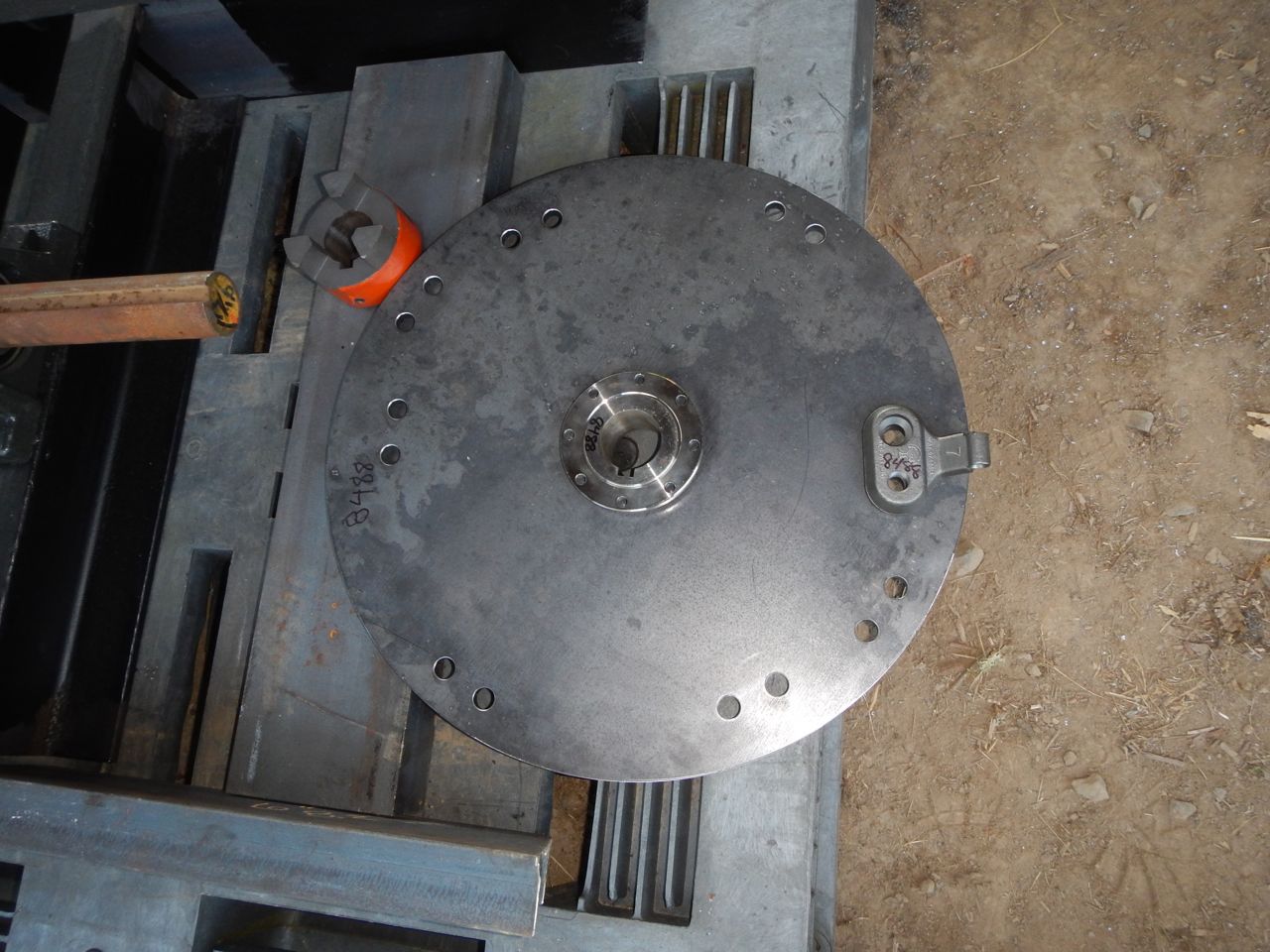

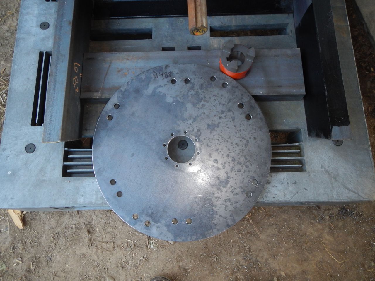

Nope, no safety plan in place other than jump out of the way... It is spinning sideways to me, not that that means anything but I have examined ways of failure and it does not appear it will hit the tractor (well, it would take a lot).
Oh, got my wheel from the machine shop.

What steel did you use for cutter wheel? Looks nice.
/ Stump Grinder Build
#35
Just regular soft. I was on the phone with the teeth manufacturer thinking this wheel needed to be 1" thick and blah blah blah. He said "Nope, normal steel, 1/2" is overkill for 35HP"
Again, we will see. I am stealing from other designs so who the heck knows.

As I understand it, it you should be pretty close. Some people don't do it at all. I had the guys at the machine shop run it and it was pretty true (they laser cut it and then honed it).

It looks like cold roll... Maybe 1045? Doesn't look like hot roll structural steel.
