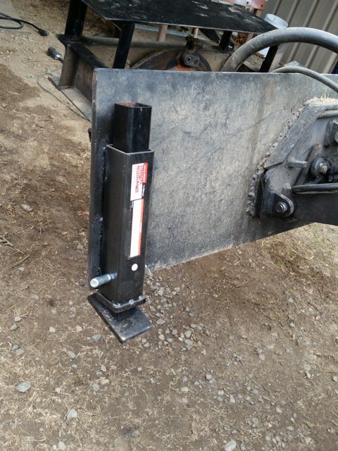

The final item was an aha moment. The attachment sits funny on the ground when you are trying to pick it up. I could honestly spend 2 or 3 minutes trying to grab the darn thing, getting off the tractor, moving it around. The neighbor suggested I build a cart. and that was the direction I was headed in, when I was looking at my trailer and realized I could probably rig up something attached to the grinder itself.
So a couple of HF hitch sleeves, a bit of 2" square and a couple of feet made of scrap and a few holes.
Pictures display standing and what happens when attached to the tractor.
