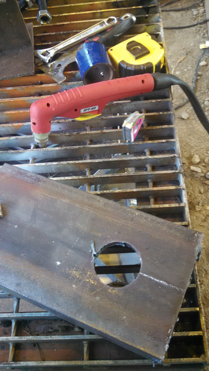

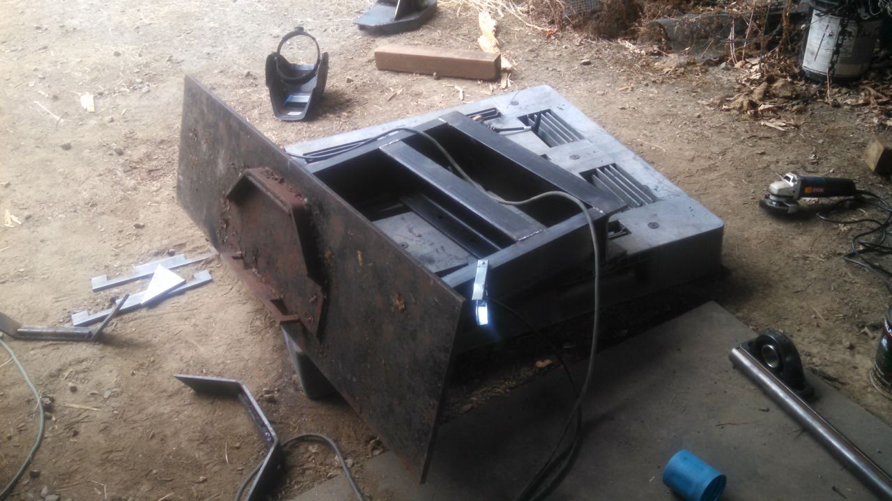

Just some pix of the weekend welding. Going slow so I don't make a mistake. Added some gussets to the mounting plate for rigidity but did not get pix of those. Today motor mount and trying to get it all to fit together.
Oh, cut a hole with my plasma cutter. 1st one. Not so bad...
