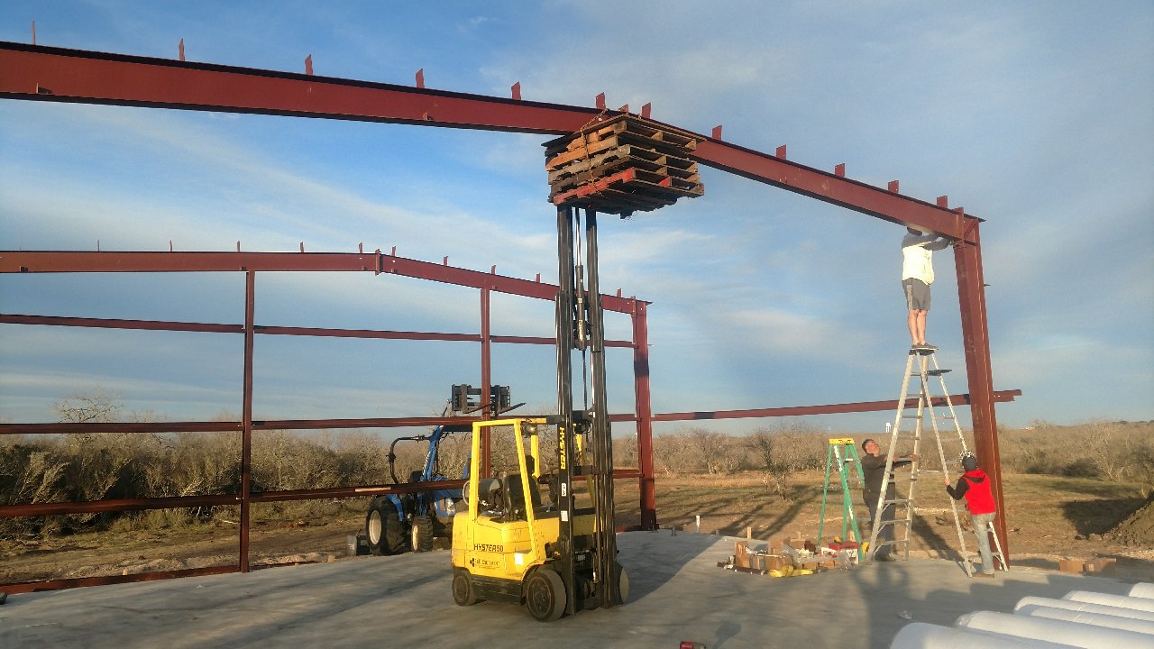

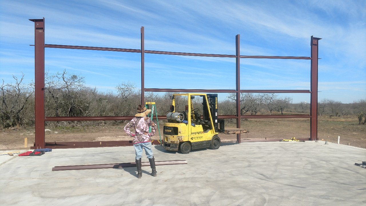

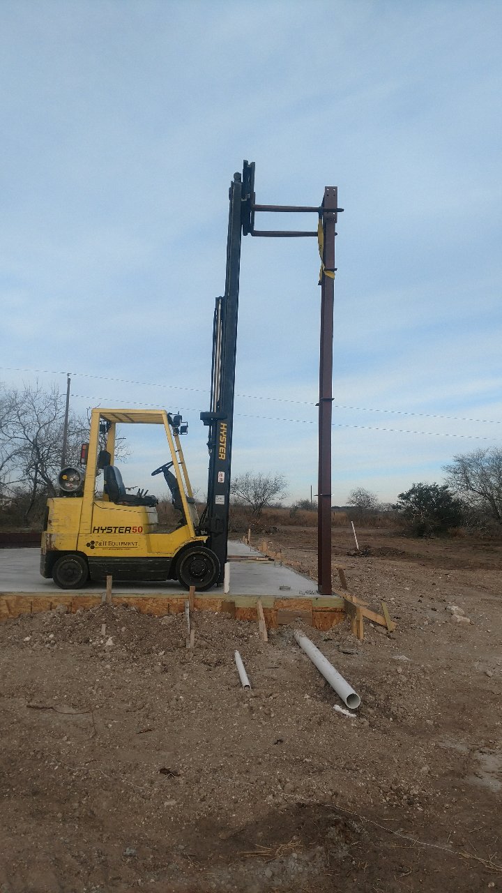

Finished up the sidewall and got 1/2 way through the N/NW end wall today. I had not drilled the end wall panels so after finishing the side wall around 1:45, it took until 5 before I could start the end wall so we got that 1/2 done in 1.5 hours. After having a day, I think we've got a pretty good system down now so we should be able to finish up the walls tomorrow and start the roof no later than Friday. The morning fog and dew also prevented us from getting started before almost 11 this morning. There's supposed to be some cool front coming through tonight (high of 74 tomorrow vs. 91 today), while it will bring some wind, I'm hoping it'll also bring drier air so we can get started earlier in the morning. I hate losing 3 - 4 hours waiting on dew/fog to burn off.
Yesterday, my wife and I were wiped out and hit the sack at 7:30, sleeping straight through to 6:30 this morning. We're feeling much less exhausted today though we still feel as though we've been beaten with a bag of oranges. :)

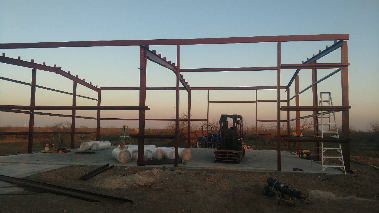

Yesterday, it was only blowing 5 to 7, today is forecast as 7 to 11 and it's already windier than yesterday. Tomorrow, winds are supposed to turn from NW to NE and crank back into double digits. All we can do is move with the wind so it's blowing the sheets onto the building. The bigger problem is keeping the insulation in place at the bottom. Double sided tape is helping but, it'll come off that sometimes.
It's an adventure. At least when it's done, I can say I did it myself and be proud of the effort I know went into it.
I'm actually looking forward to getting to the roof where I can lay the sheets flat.

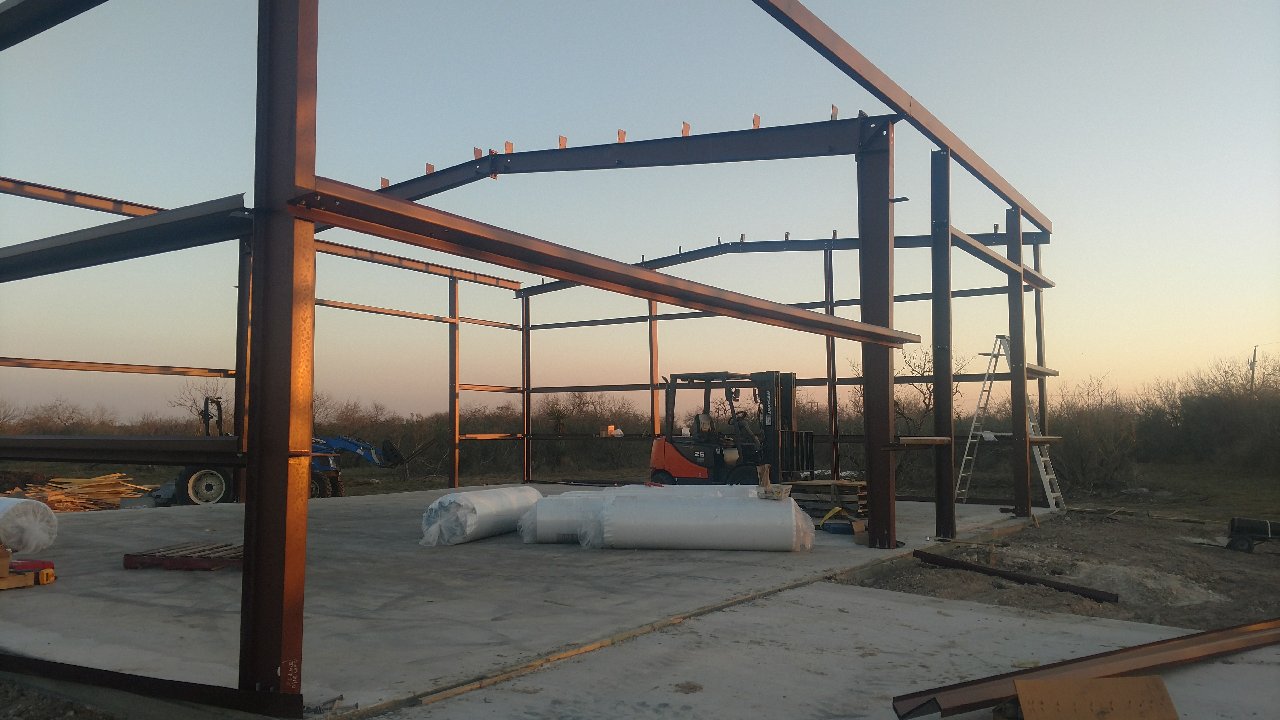

In my humble opinion, your insulation job is being done (at least in that one pic) better than many people that do it as a profession, erecting steel buildings

Thanks! I didn't realize I was doing anything special with it, I'm just following the instructions.
I'd like to say, for any of you that are contemplating this, other than the concrete, this is not a difficult process. It's physically demanding doing the siding but, if you're the least bit handy, can read a level and have some construction experience, you can build one of these kits. I have a lot of experience working with metal but, that's as a fabricator/welder, not with metal buildings. All of my building construction has been traditional stick frame stuff and I was a little intimidated by this project going into it. Once I got started though, it all made sense, I was able to work off the plans alone and not read the instruction manual until I hit the insulation and siding. I've done about 60% of this by myself, I had about 6 hours of help with the frame and my wife is cutting insulation and helping me position it and the panels but, I'm doing the installation alone once it's in place. Had I not lost 4 days to weather and equipment problems, I think I could have done this in 10 days with what is essentially 1.5 people. I'm really impressed with how well designed and thought out the plans and kit are and how this has all gone together. So, if you're considering doing a metal building kit but not sure if you should hire out the erection, I'd say give it a go yourself first, I think you'll be surprised at how easy it is.
