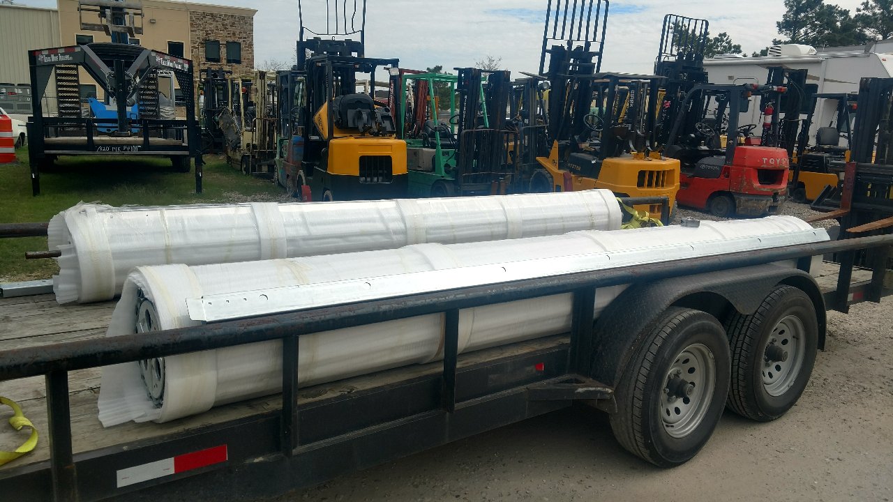

I am insulating it, the rolls are 6' wide. It's almost always windy here, especially since we're at the top of a hill. Usually, I like it but, right now I'm cussing it. Some of the framing members were a lite iffy in the wind, we had some days last week that were blowing 15 to 20 sustained. I'm.hiping to at least get enough of a break to do the side on the side of the prevailing wind and that doing that will give me enough of a wind break to get the rest done. Problem is, this time of year, the prevailing wind is either E/SE or N/NW...
