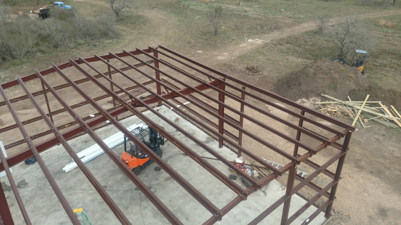

I am thinking about tacking a similar project. How many days do you think it took for the assembly and skin?
/ My shop build
#104
I'd say about 60 to 70 man hours. I could do it in less time now that I know what's expected. The roof and trim took an additional 40 man hours or so.

Correct me if I'm wrong, that doesn't include site preparation and concrete. Just assembly hours?
Absolutely. It took me 2 months to build the pad and get the slab done. The foundation isore than 1/2 the job.

Not picking on you my friend, just clarifying.
If this thread is followed to conclusion a prospective builder will also learn that when the building is standing there skinned it's just a shed. There will be many hours of finish work done inside wiring, plumbing, etc.

I figure it'll take me close to a year to get it fully completed. I've still got septic tanks to install (one for black and one for gray), irrigation off the gray water tank, bathroom and office build out, mezzanine construction in part of the shop, wiring, lights, vehicle lift, A/C (hopefully before summer), about 600 - 1,000 yards of caliche to dig and spread for the shop yard, asphalt to do up front so I can drive the forklift out to load/unload trucks, gates to install, fencing to build and on and on. Somewhere in there, I've got to find time to build my wife a 350 sq/ft addition on the little building we're living in so she can have a proper kitchen, laundry room and closet. Seems only fair though, since she told me to build the shop before a permanent house, she's a good wife!
The wife and I installed 3 of my high bay LED lights to get enough light so I can work. It's barely enough just in the welding area, I have 3 more to install but will be adding an additional 12 for a total of 18, the space needs a LOT of light. These are pretty cheap Chinese LED fixtures though ($50/ea) so I want to give this 6 a couple of months before I commit on another 12 of them in case there are quality issues. The light is a little cooler than I'd like but, at least 1/2 my time in the shop is under a welding hood so, it doesn't really matter that much, as long as it's bright.

Nice project, and finish work. Can't see any defects from here, and once you've graded and asphalted, etc. the building perimeter only you will know what isn't perfect. Considering the wind factor and other site specific issues everything turned out well.Who was/is the 'safety dog'; some sort of inspector?
Good on renting a man lift. I didn't like seeing the man on the top of the 10 rung folding ladder, even with the 2 helpers holding it. I know contractors who've worked for me who have died from falls, and one never wants to see that type of thing happen.
One thought on going bigger than the initial building. You could expand by setting columns on concrete sono-tube based piers, or the type that are pyramid shaped preformed post bases, then construct your addition, walls, roof etc., later adding a slab inside over a compacted stone base. In the meantime you would have extra space to use, and could pour your floor as it became affordable; or never if you could use the stone base for certain things like I did with my boat, ATVs, lawnmowers, ladders, etc.
