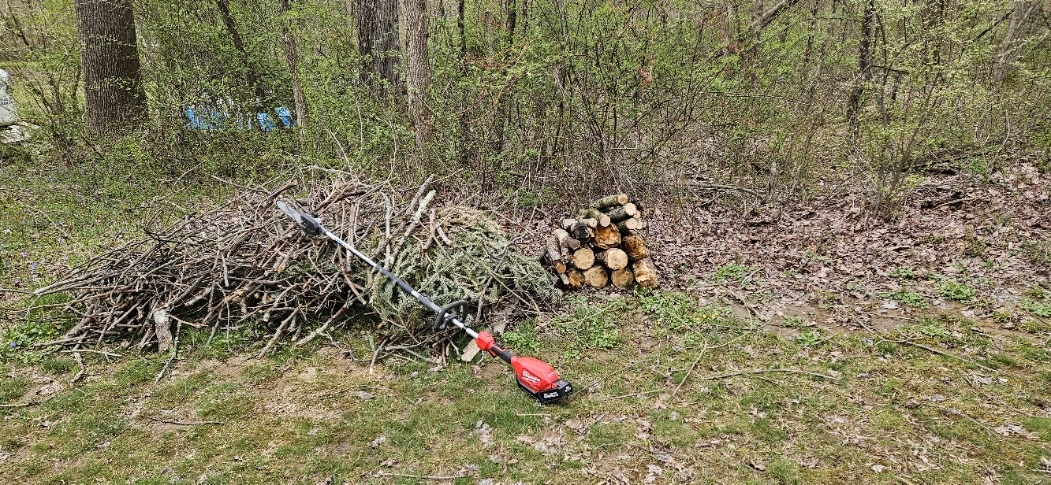

I have the Milwaukee pole saw and absolutely love it and I have used mine far more than normal homeowner use over the last 3 years that I have owned it, I don't ever plan on going back to a gas powered pole saw, but with that being said I think there is a fine line where gas powered just simply out performs battery and while I also have a Milwaukee battery powered chain saw with a 16" bar and really like it for limbing and other small projects it in no way could replace my gas powered chainsaws, so IMO the 10" bar on the polesaw can compete with gas powered polesaws but when you get into cutting large hardwood trees and logs gas powered is still king. I am curious as to why other manufacturers have gone to 24, 48, and even 60 volt batteries yet Milwaukee is still getting it done with the 18 volt Fuel system .

The Milwaukee quick lock pole saw and weed eater has worked well for me so far.
I have gone through a few chains I use it so much. Great on mid size saplings, autumn olive and trimming low hanging branches.
