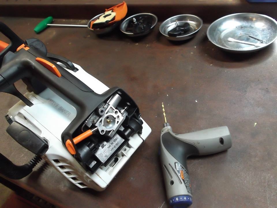

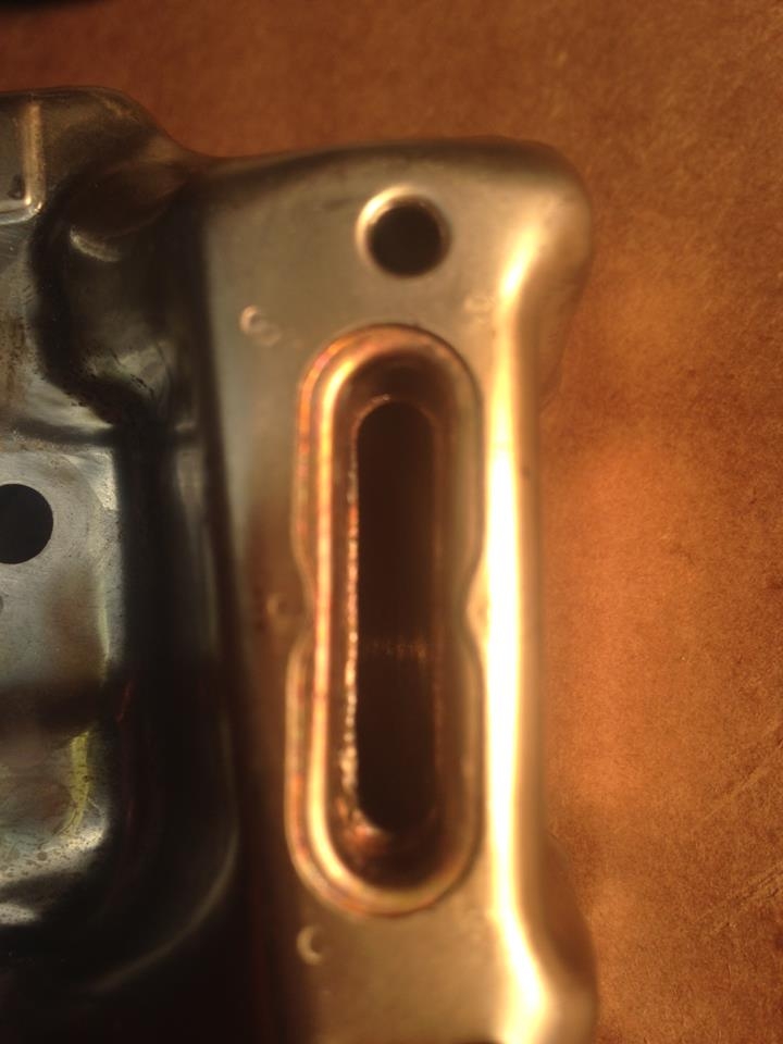

No clue what they were running for chain if the stock ones. 150 is doggy stock with little bitty hole in muffler. Mine had muffler mod and carb fixed to get full tune.
Timing advance helps too.
2511 needs all of the stuff too. Least muffler mod for sure.

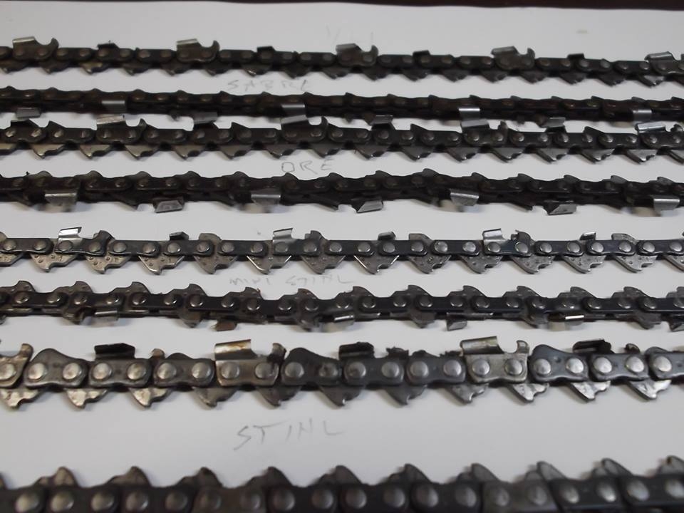

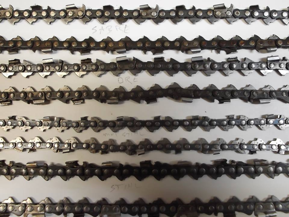

I loved the micro 1/4" cutters on 150.
So if the 2511 isnt running same chain that could be difference there too. 2511 come with 3/8LP
But lot of guys over here swap them to the micro or regular 1/4" for the smoother trim cuts.
Like said in beginning. I wanted 2511 but this 150 came from a climber on trade why I ended up with it.
   / Stihl or Echo top handle saw? #45
Can see the tiny micro 1/4" cutter chain in there compared to full size 1/4. Thats what 150 comes with micro.
