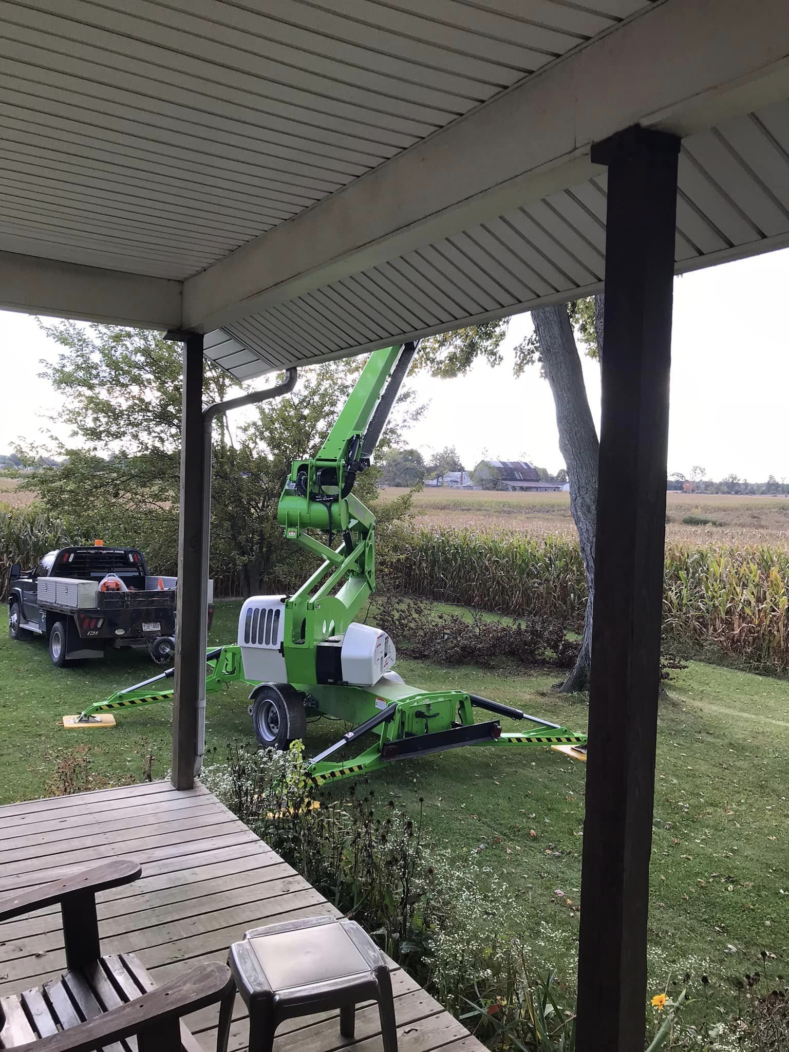

Guy I used had stihl 201 and efco 3600 TH back up with him.
He has this so dont have to climb near as much.

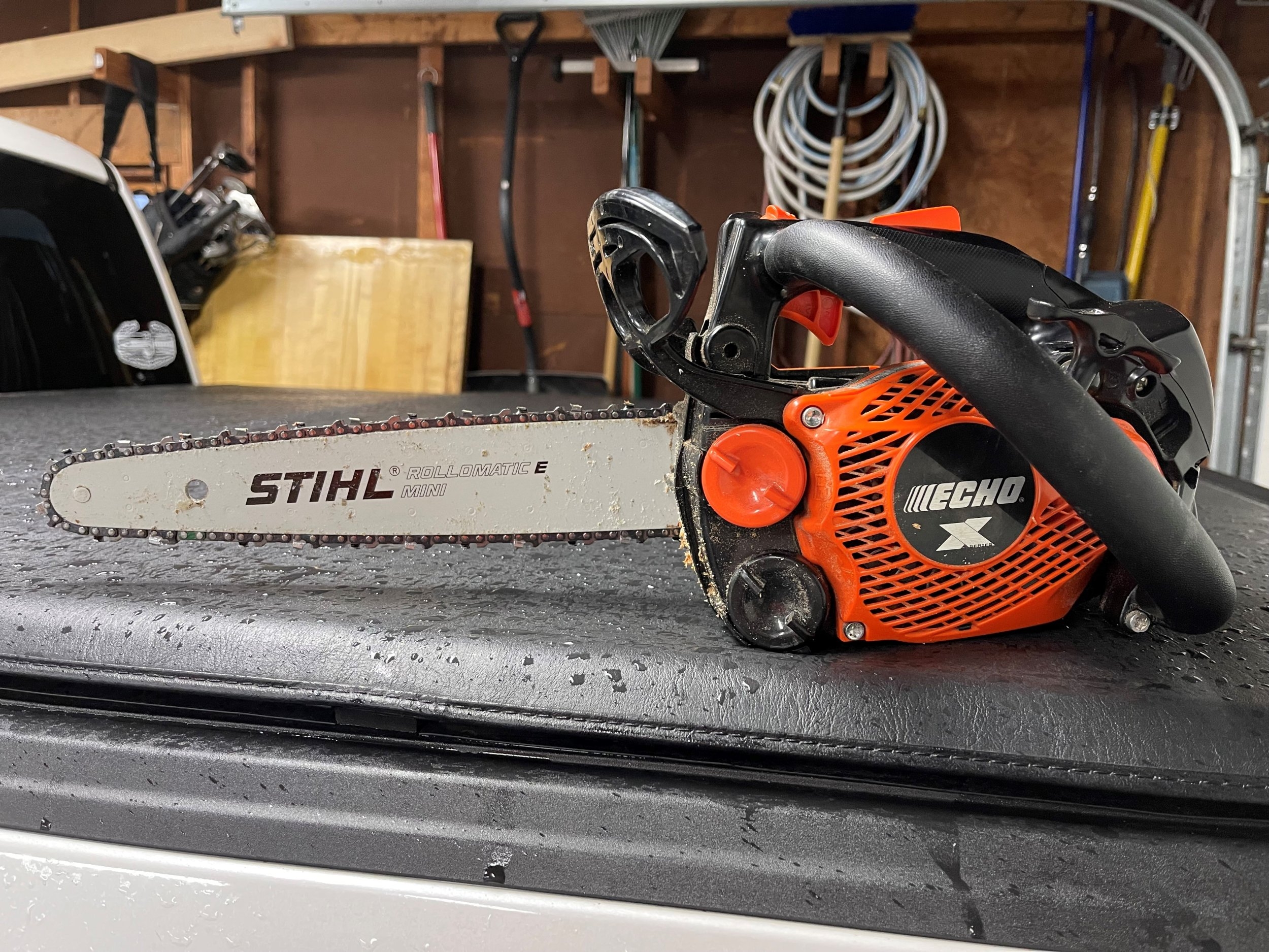

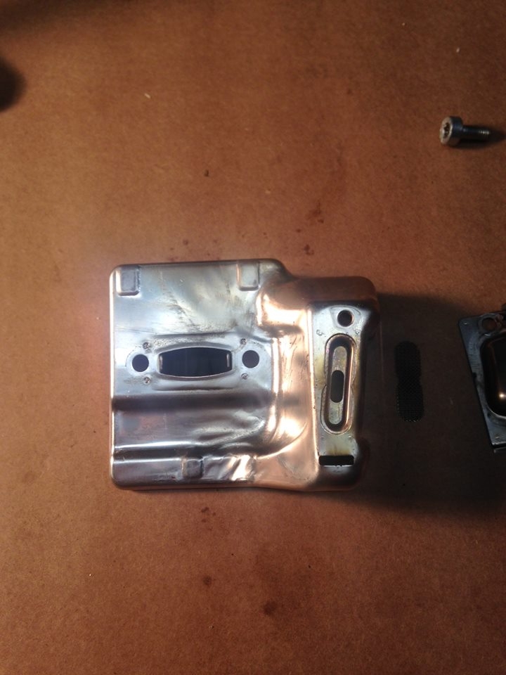

No clue what they were running for chain if the stock ones. 150 is doggy stock with little bitty hole in muffler. Mine had muffler mod and carb fixed to get full tune.
Timing advance helps too.
2511 needs all of the stuff too. Least muffler mod for sure.
I loved the micro 1/4" cutters on 150.
So if the 2511 isnt running same chain that could be difference there too. 2511 come with 3/8LP
But lot of guys over here swap them to the micro or regular 1/4" for the smoother trim cuts.
Like said in beginning. I wanted 2511 but this 150 came from a climber on trade why I ended up with it.

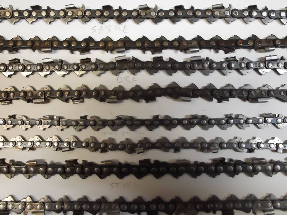

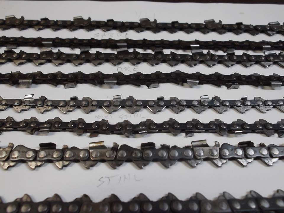

Can see the tiny micro 1/4" cutter chain in there compared to full size 1/4. Thats what 150 comes with micro.

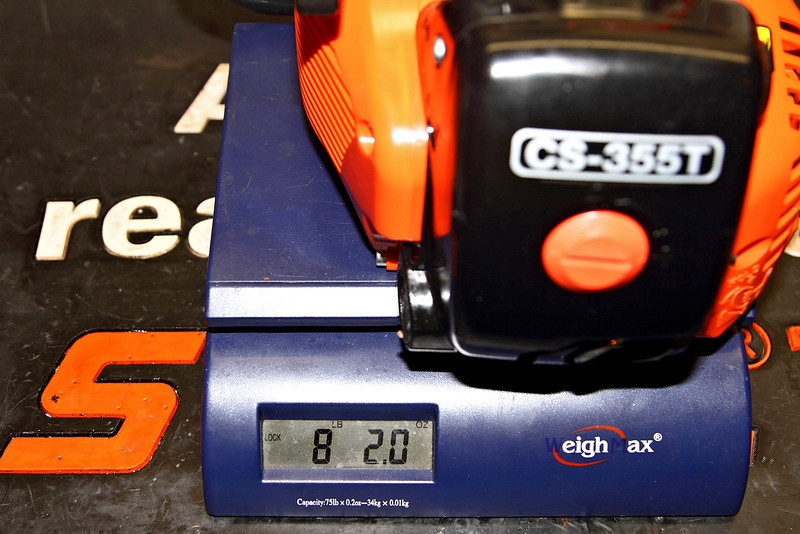

Got the ECHO CS-355T from HD for $350. Been a Hella of a great little saw. Haven't tried the limb pinch jerk out maneuver yet.
I have gotten bars pinched. I remover the bar from the powerhead. Get another saw and cut my way free. Sometimes a hand saw.
Doesn't happen often, maybe dozen times in my lifetime so far.
