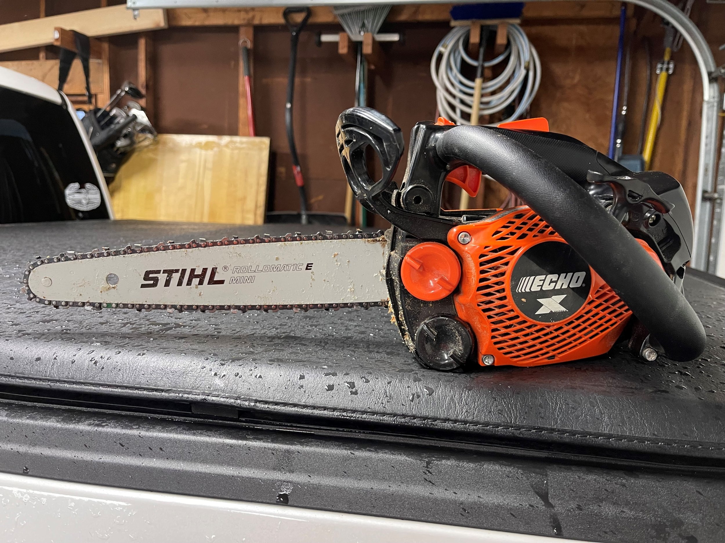

Im a big fan of Stihl saws but the Echo 2511T is an awesome little saw. With a couple mods it rips and its super light, I grab this more than my bigger 261 now.
That has the I30 starter system just like mine does. I actually prefer the Echo bars myself over the Stihl or Oregon. The Echo bars are much more blocky and they all have greaseable roller noses too.
The 3/8” bar and chain that came on this saw was way too much for it. This is a very common mod that lets this thing rip. It’s a 1/4” picco bar and chain setup. Night and day difference in performance.

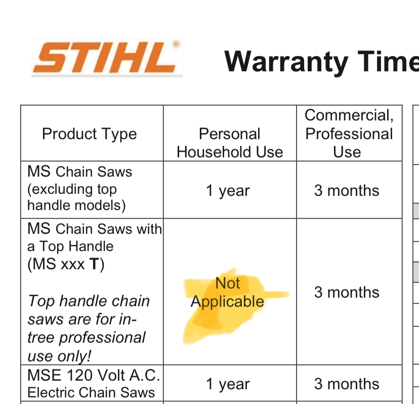

I don't think Stihl wants to sell Top handle saws to homeowners. Not just because they price them so high but they specifically offer NO warranty for homeowner use. The higher prices though go a good way to discourage homeowner use but the lack of a warranty would make most back away.
Laughing at that. That isnt the reason their high. I am a homeowner. Stihl just being stihl on prices. :ROFLMAO:
Read about their record profits since 2020, but yet they layoff workers.
200T 150T I owned.
IMO they just afraid of lawsuits by the stupid out there. Heck some of the dealers wont sell a guy yellow label chain. 🤦‍♂️:ROFLMAO:
