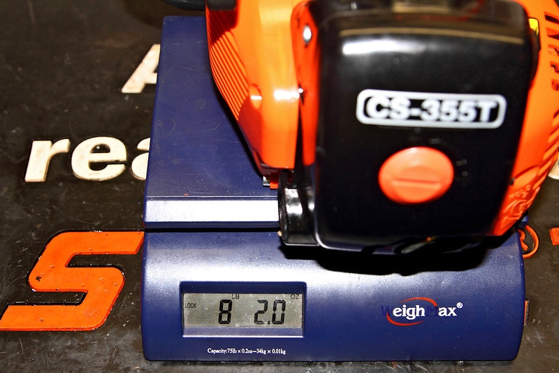

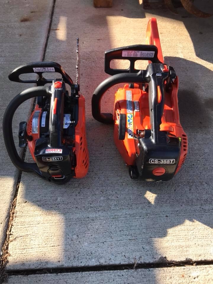

Have ran the 355 and own the 2511. I would choose the 2511 any and every day over the 355.
Seemed like a toy when I picked it up???
/ Stihl or Echo top handle saw? #65
Yup, it's considerably lighter than pretty much every other saw out there and makes limbing an absolute breeze. It will out cut a 355T in 10" wood all day long. To me, a top handle saw should be light weight, easily maneuverable, and fast cutting through anything 10-12" and under. That's what this saw does and it does it better than most. The 2511 is Echo's pro series and the 355/271 are a homeowner series...
/ Stihl or Echo top handle saw? #66
Didn't even know about the 2511, how can it be 10cc less and be considered a PRO saw?
2.5 pounds lighter than the 355. Nice if up in the bucket all day long limbing.

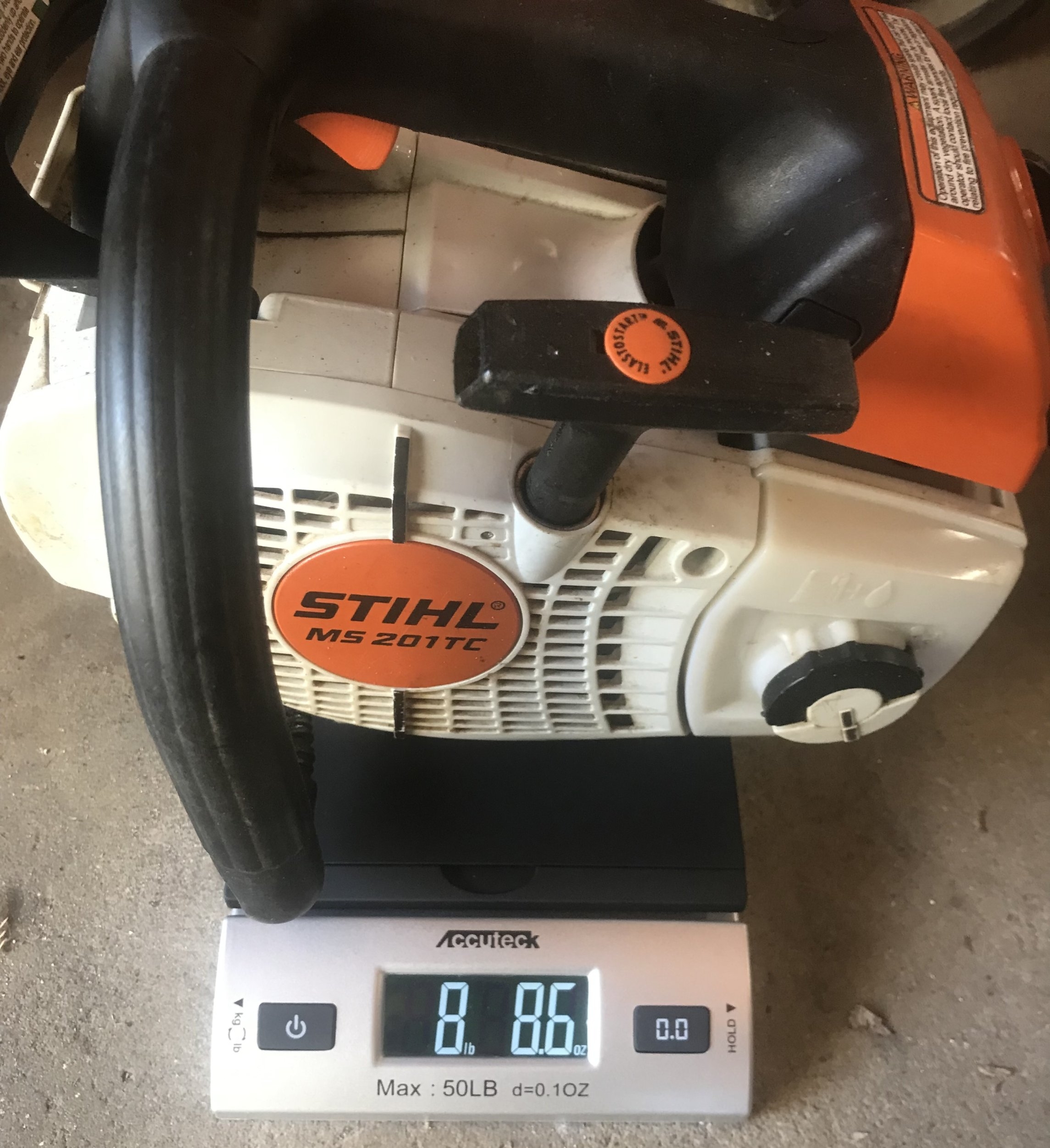

How does the 2511 stack up against the Stihl equal?
My neighbor did just buy in fall 2022 the high-end Stihl MS201 M-tronic top handle saw. I think it was around $700 plus.
With a 6-month warranty which I thought was ridiculous. It's a Stihl! No, it wasn't, it was $700 plus!
The CC's dont determine pro or not, its about power to weight ratio where pro saws normally shine. Plus build quality and performance. The Stihl 194 is the closest in comparison to the Echo but to me felt clunky and much heavier than the 2511 and from guys Ive talked to that have run both they are comparable in power output. I generally do not like Echo stuff but that 2511T is one awesome little saw.
#68
Good to know. It was sitting at the dealer and when I picked it up I almost laughed at how small & light it was.

Found a very clean new-looking Stihl 201TC for $400. Seller says “like new”.
Echo is $500 + tax

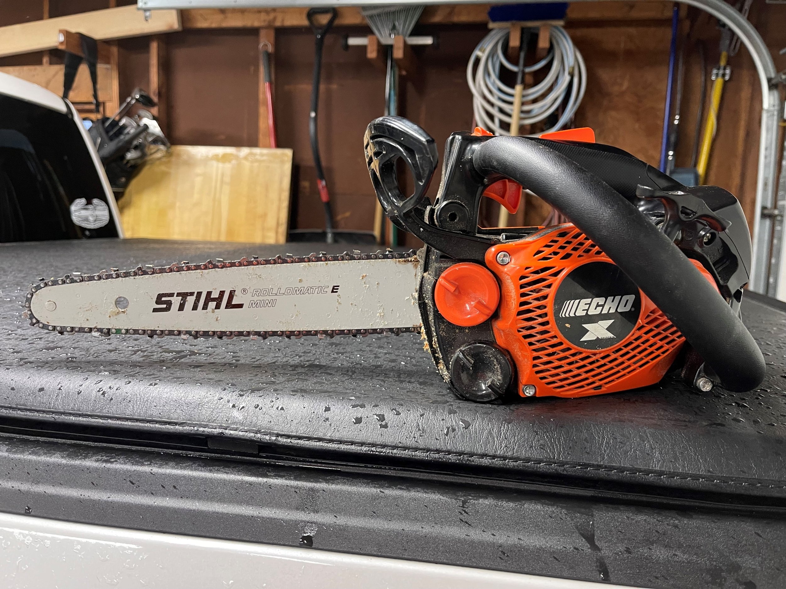

Seller unresponsive on the Stihl. :(
Might be back on the Echo. Dealer wants more $ for bar and tiny tooth chain
All the smaller saws will come with the 'tiny tooth' lo-profile chain and bar. The PICCO chain is matched to the output power of the saw and I suggest getting a second loop so when the installed one gets dull (a dull chain of any pitch will show buildup on the heel of the tooth when dull), change it out and sharpen the dull loop (if you know how to correctly sharpen it, that is). I always keep at least one sharp loop handy at all times.
Tiny tooth or 'full sized' tooth don't really matter except concerning what a saw can pull efficiently and what it cannot.
Being the 'expert' on stuff, I suggest you purchase a chain grinder and learn how to use it. Vevor has a clone to the Oregon (Tecomec) grinder on Amazon for just over 100 bucks. Buy one and learn how to grind chains. Oregon has a couple excellent vid's on how to use a grinder, how to set it and what to do.
I'm sure you can assimilate that.
