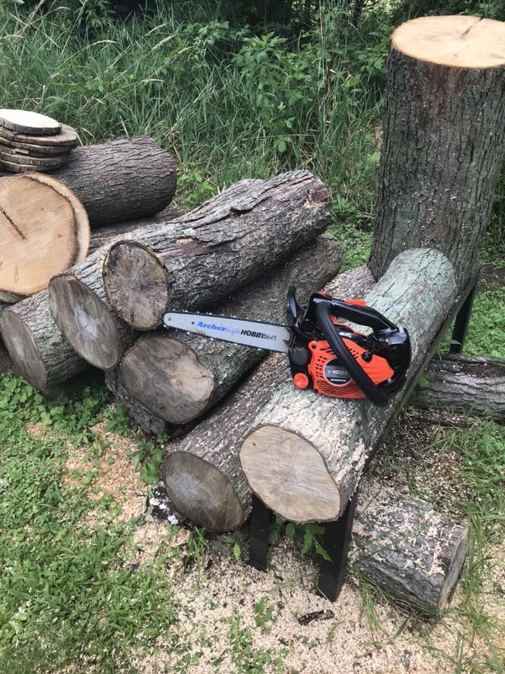

I use 40-1 Red Armor in all my 2 cycle equipment. I'll have to check my oiler output. It seems to have a little left when I run out of gas. Since I bought the saw, we keep having storms and downed trees, I'm not sure if that is good or bad Karma.
Have you had yours in the cut yet?

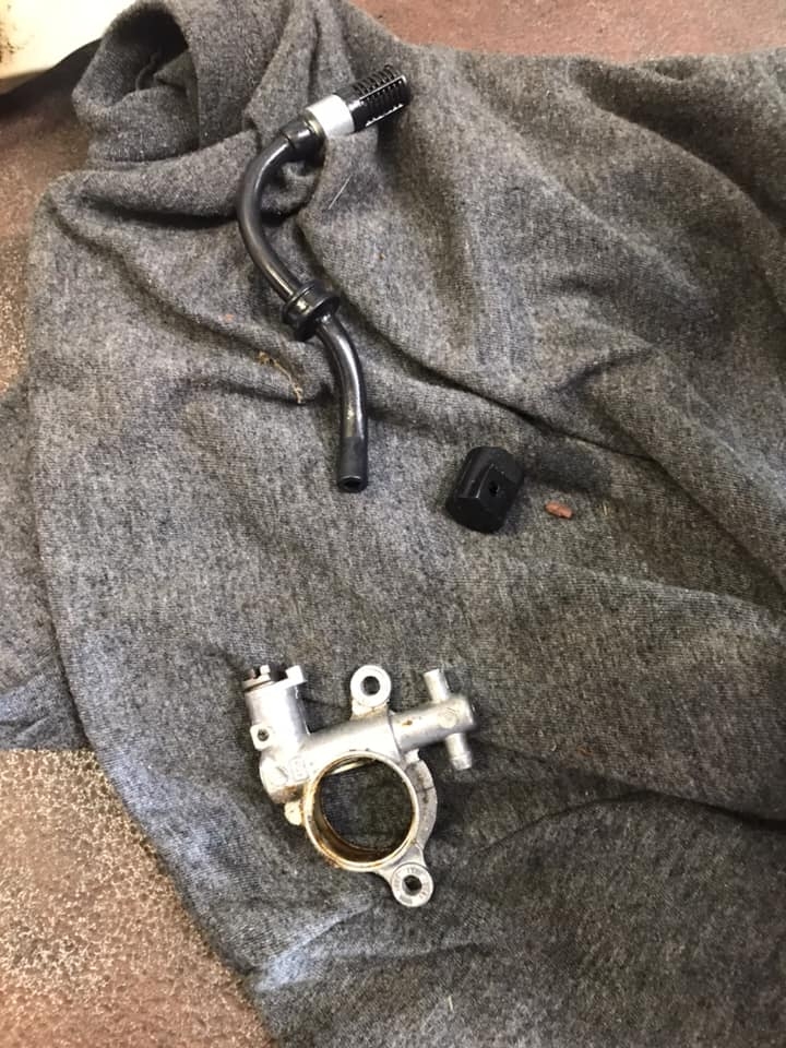

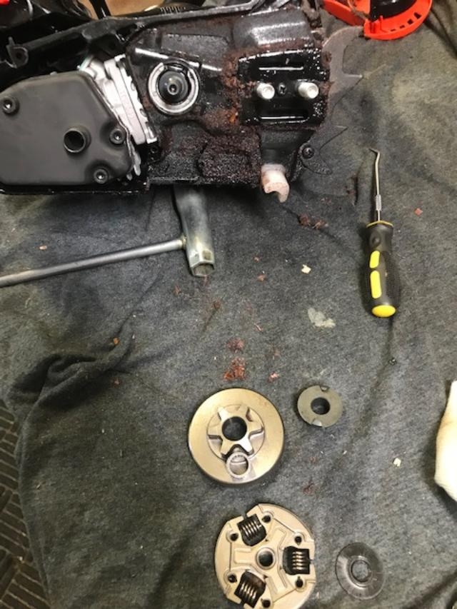

I cut up a small tree with it. The oiler was so excessive it was leaving puddles on my boots. The saw started second pull and ran very well.
I’m betting the oiler is buggered at this point. I don’t think the adjuster screw should have 1/4” of vertical movement when pressed with a screwdriver.
Looks like a pump is $9 from Farmertec and easy to replace.

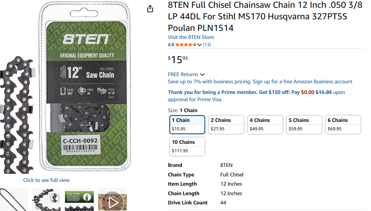

I bought this - thinking it was a chisel chain (from the listing pic) It is not.
Still - pretty cheap, and okay for my trail work (stumps in the dirt)
Shoulda bought this

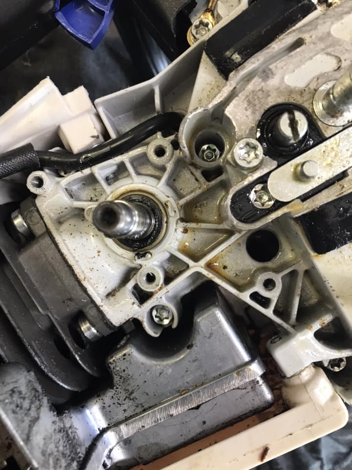

Pulled the oil pump, found the issue, it may be resolved. If not, cheap and easy fix. Will address tomorrow.
She runs like a raped ape though.

The JonCutter was using about 1 tank of oil to half a tank of fuel. The pin that is supposed to secure the adjustment screw, and not allow more than 1/4 turn of adjustment approximately, was barely present, allowing the screw to turn and also be pushed up out of location by the spring.
Not the end of the world, but the oil use was excessive. I'll have it fixed tomorrow.
