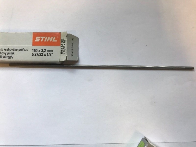

Should see the file I use on my mini micro 1/4" fruit tree chain.
Again even smaller file.

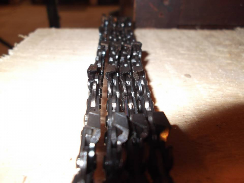

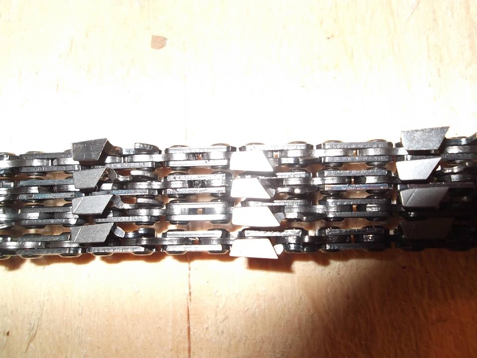

Just so you know. Early 325 way way back by Oregon used a 5/32 file too. Was oregon LG33 full chisel.
I started using a 3/16 file for the newer bigger cutter 325 uses today.
Adding that hook for softwoods it did cut faster.
I even tried it on a firewood cutter. He told me I dont know what you did to it but keep doing it.
But that LG33 cutter is bigger then the little NANO cutter.
I used to do chain build offs on my old website years back. So I got to try alot of different things like that. Even square filed 3/8LP and 325 in full chisel
Some stock 325 chains from back then. All used 3/16 except for LG325 stock 5/32

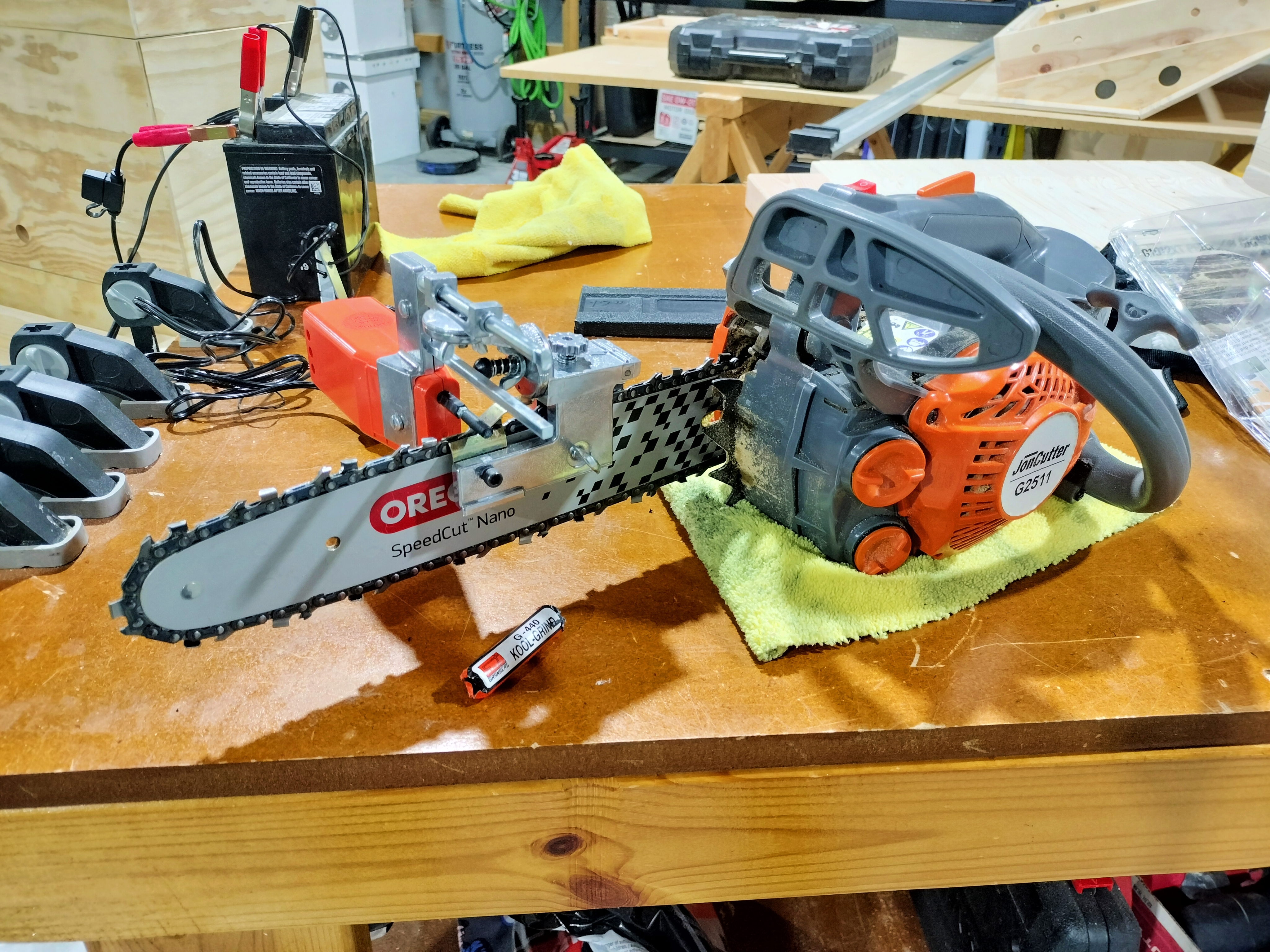

I ended up buying the Granberg Precision Grinder this week for all of my saws.
   / I just bought an Echo 2511t clone for $99. What was I thinking? #445
This little bar clamp on one? https://www.granberg.com/product/g1012xt-precision-grinder-12v/
I tried one many years ago. Didnt like the sharpening deals they use.
Never as good as my hand filed ones.
Went back to hand filing for best and these type of grinders for bulk chains.
Customers chains is what made me get the round grinder in back stihl usd.
Square one was because I hand squared filed for fun. The grinder made that so much easier.
I later sold the silvey square one to a friend.
   / I just bought an Echo 2511t clone for $99. What was I thinking? #446
   / I just bought an Echo 2511t clone for $99. What was I thinking? #447
Nope I got the Dremel style one, after watching numerous tests of different sharpeners. Project Farm did a great test. I'm sure it will be sufficient.
One test did test the file style Granberg to the dremel style, and there was basically no difference. With the Dremel being slightly better.
In any case, it will be better than my hand filing skills and I can adjust the rakers easily with the Granberg
