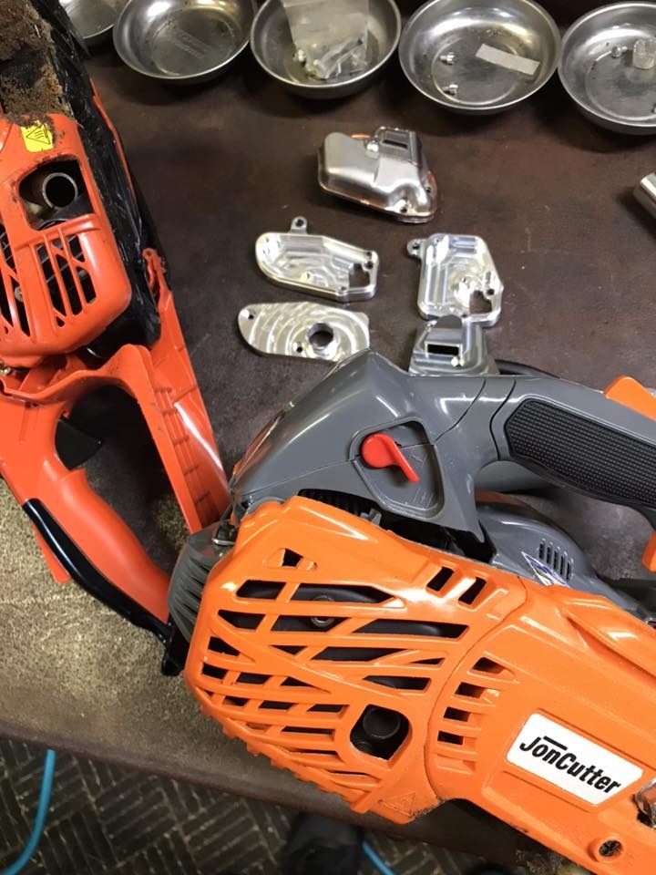

Got my exhaust cover modified today

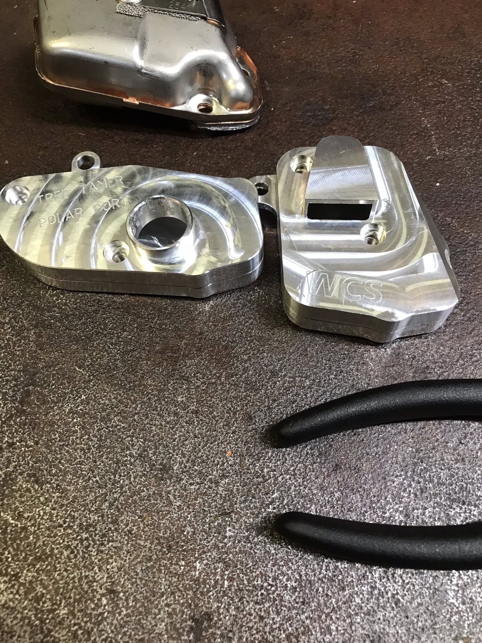

Gangs all in hand now. To test on oem and clone 2511’s.
PSS V2 cnc muffler has 33% bigger exhaust outlet.

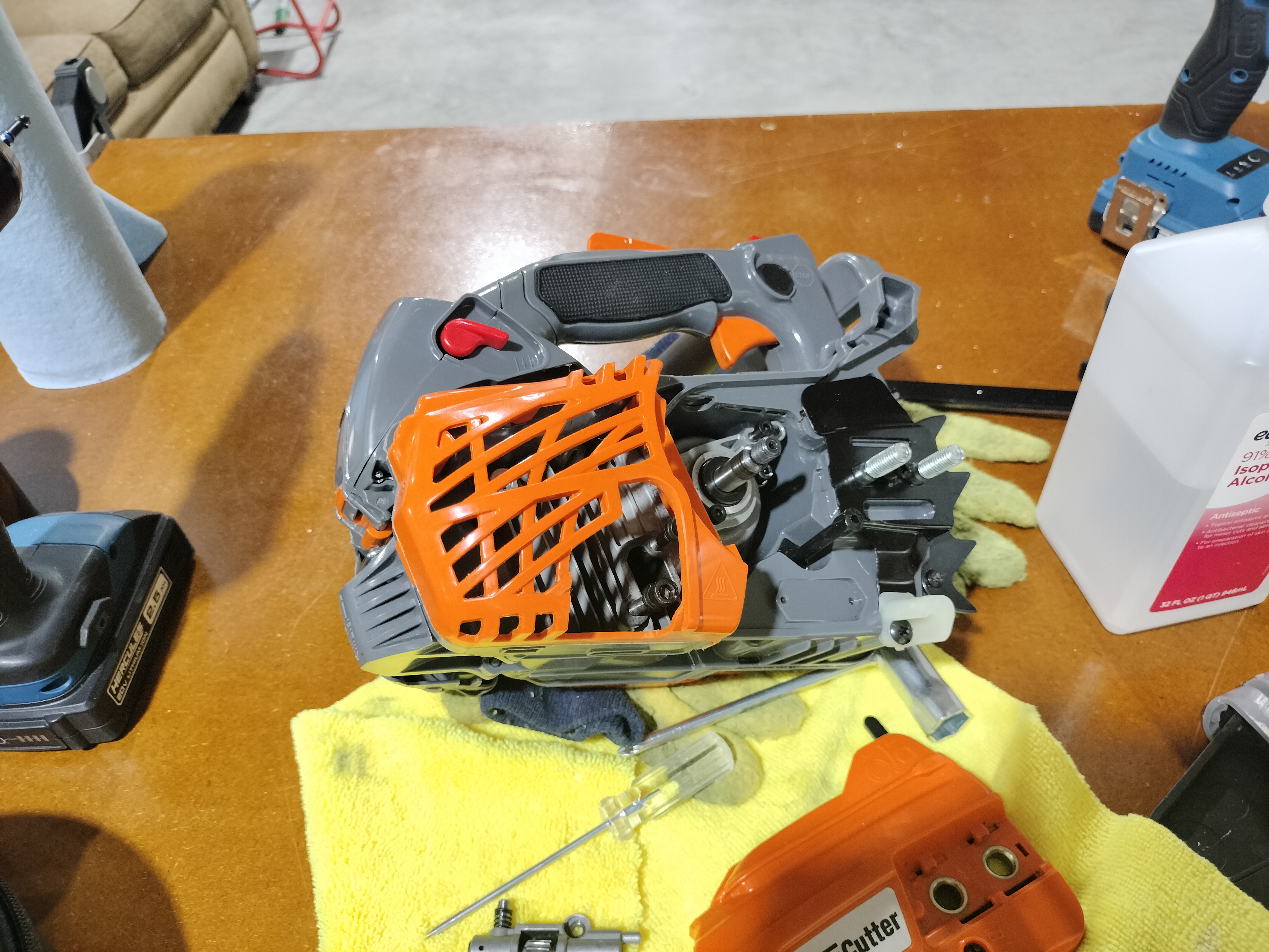

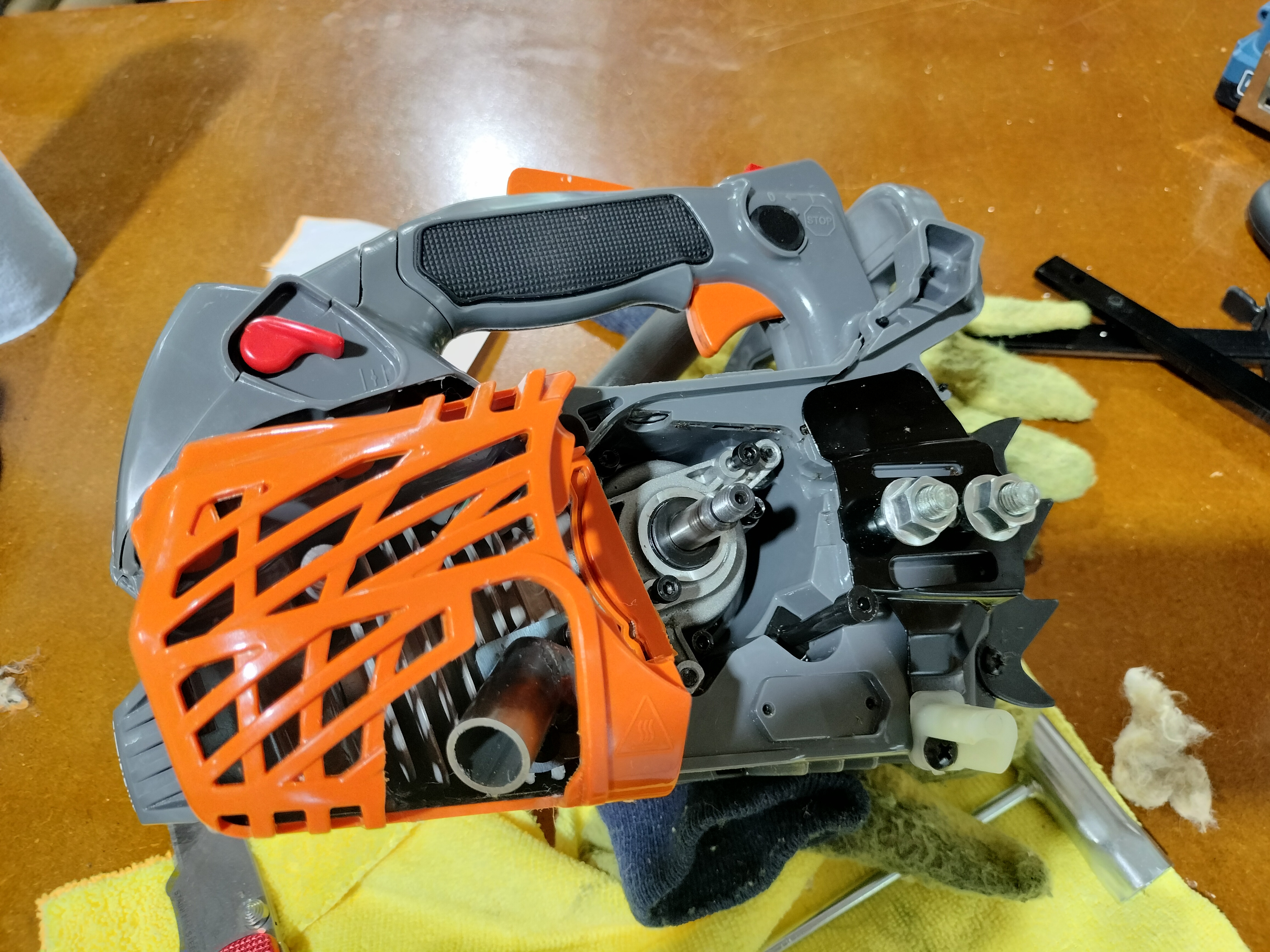

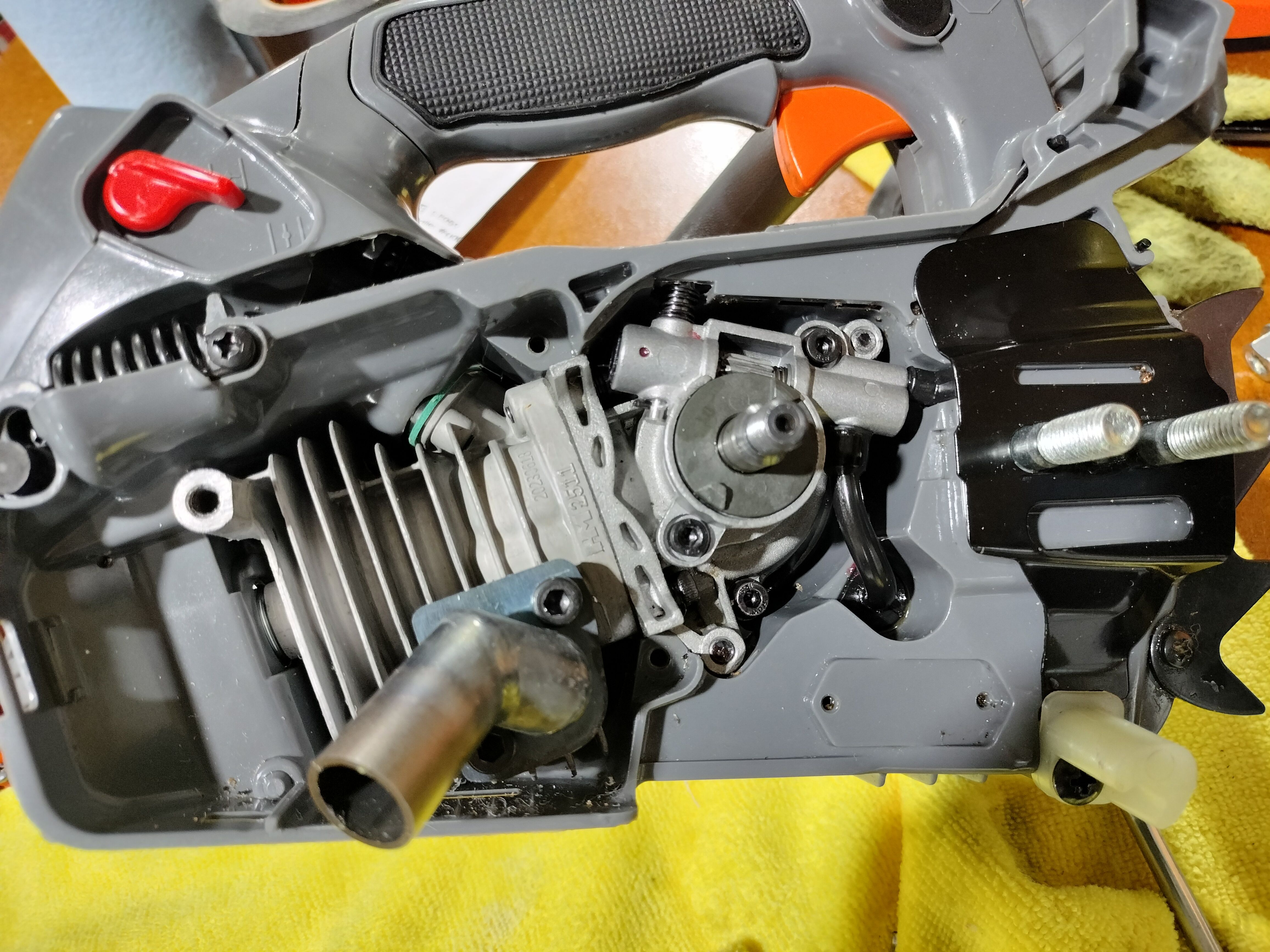

Got the new oil pump installed and the saw reassembled.
Seems a bit snappier than with the OEM can.
I have the oiler set as low as she will go, and there is no way it will starve the bar for oil 😅

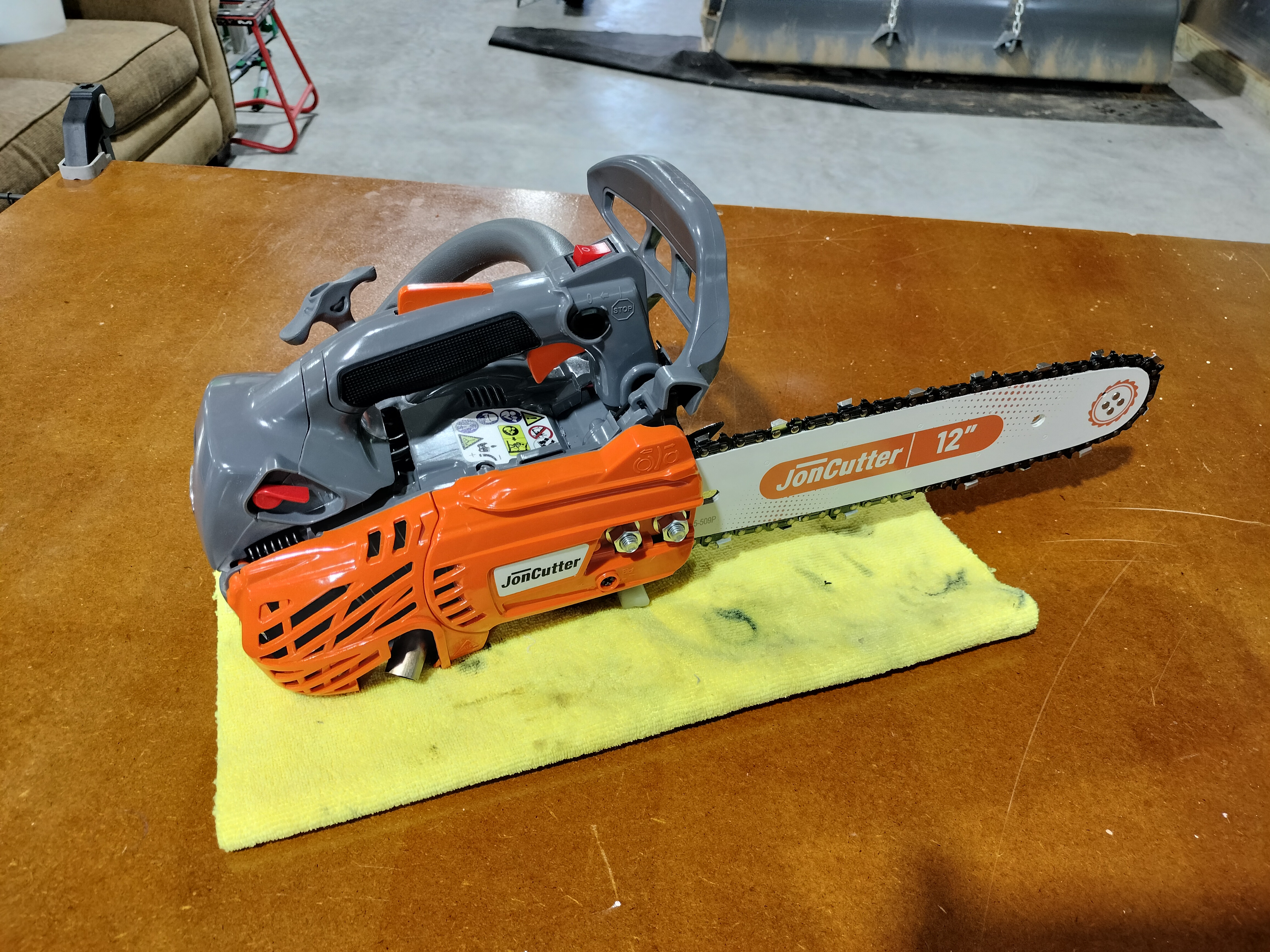

Went out and cut down, cut up, three smaller trees.
Snappy little motor. The 3/8LP is a bit grabby, I may address that later.
Runs great, starts super easy, oil reservoir lasts as long as a tank of fuel, not any longer... That is set to minimum
