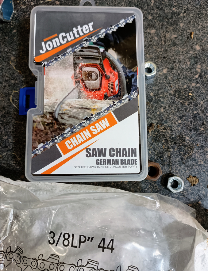

This is what came with my Joncutter
   / I just bought an Echo 2511t clone for $99. What was I thinking? #258
The Joncutter G2511 I bought from Az came with that same box and says the same thing on the plastic bag. The technical data in the owner's manual does not list the number of drive links. The bar is printed HYA-45-509P.
   / I just bought an Echo 2511t clone for $99. What was I thinking? #259
Couldn't stand it anymore. Went and pulled chain off and counted drive links. 44, bar stamped 45. Now what? Maybe I should send chains with 45 back and get 44. This very confusing with bar stamped with a 45 on it but knew my 12" pole saw uses a 44. Maybe some of you saw guys can wade in here and give expert advise.
