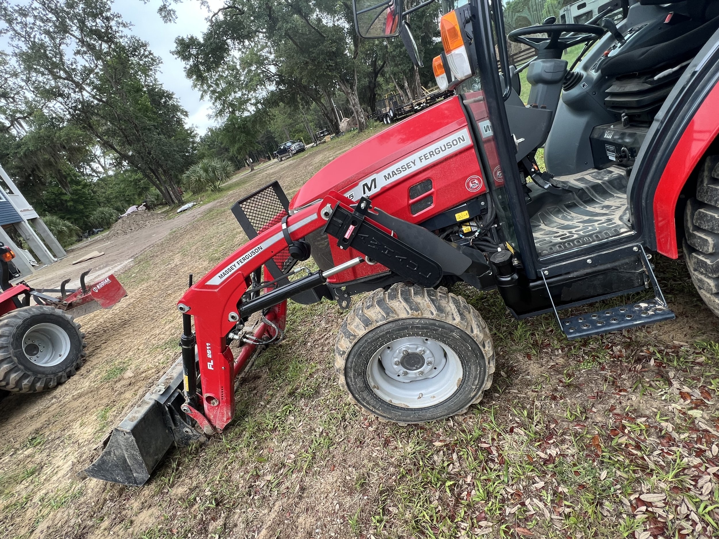

I think you are pretty lucky this happened in the way that it did. Had the bucket been fully loaded and up high and only one side gave way, the bucket and load could have come down on the tractor or the operator. That said, it looks like crappy engineering or poor metal caused the failure. A competent welder can fix this so that it never happens again.
/ MF 1835M loader support collapsed on tractor #83
Plates over welded up cracks and tears, weld more bracing. The one that says it can't be done needs to stay out of the way of the one that's doing it
I did not say it could not be done, rather it SHOULD not be done. Then again, I am only a structural engineer who believes in doing it right and not covering up bad work with band aids. Not saying there is not a place for practical experience just that it needs to be tempered with science and engineering.

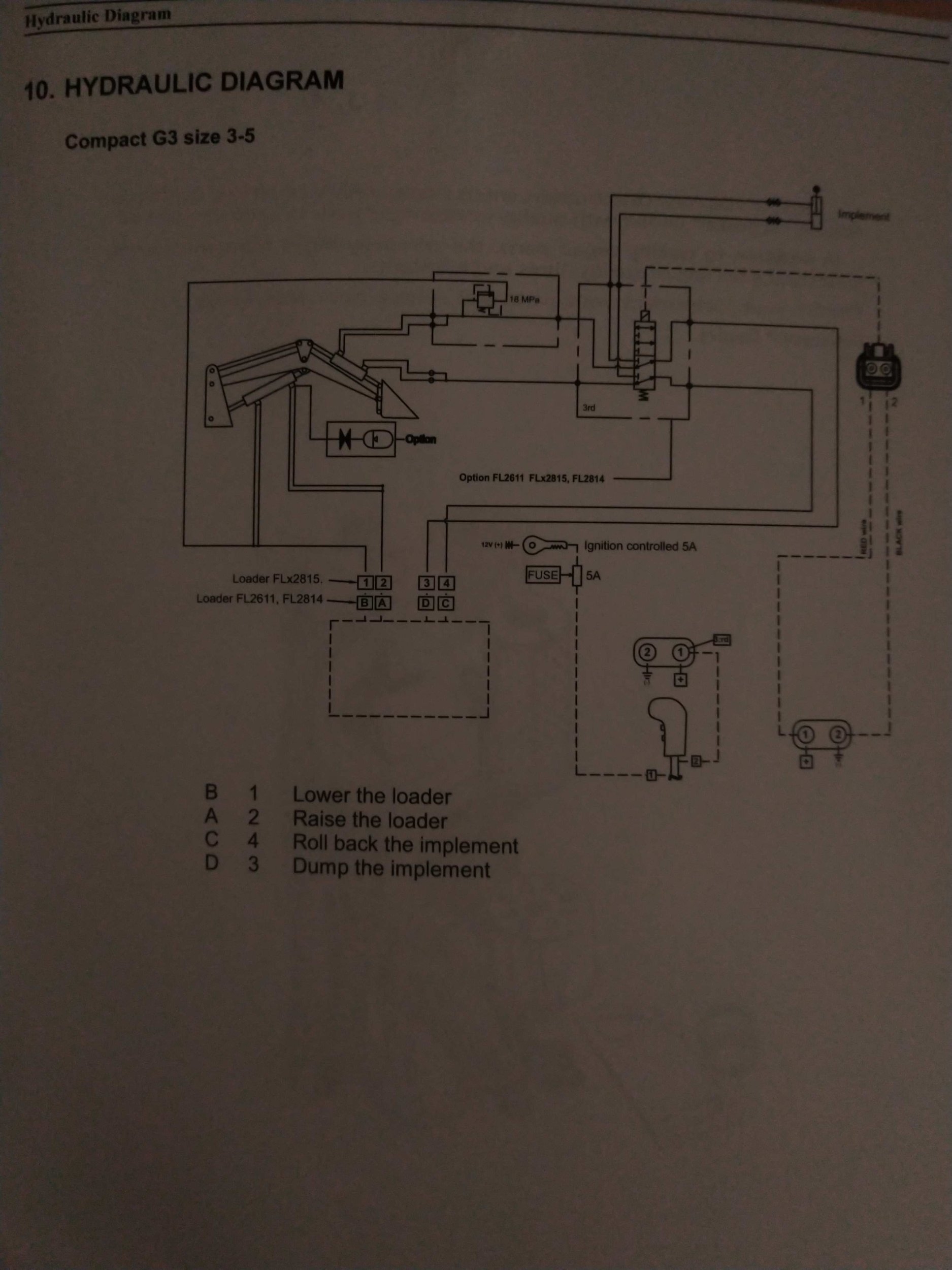

Interesting. Do you happen to have a diagram how this works? I always thought when the spool is centered it closes all other ports off so no way for the relief to work.
The loader relief valve is built into the loader valve. When the spools are centered, it is what protects the loader lines and cylinders from overpressure. It is set to a higher relief pressure than the main hydraulic system (2610psi vs 2346psi), that way it never comes into play unless the load is significantly increased on the cylinders after the spools have been returned to neutral position.
I'm going based on my own loader specs here (FLx2815), so other systems may vary. I can copy and attach the hydraulic circuit diagram if you like, but you could probably find a better one by just Googling it.
I hate to tell you that is not correct. Once the spool is centered it is the same as if the hoses were capped. No way for the relief to do anything for the loader hoses and cylinders. In an open center valve that utilizes the power beyond feature then any valve after the loader valve would be protected by the loader relief. Often times the loader valve is first valve in series and would be plumbed straight from the pump. The tractor relief is after the loader and can be set lower to release before the loader valve.
You could set the second valve to 100 psi and the loader would still produce the pressure that it’s relief is set at.

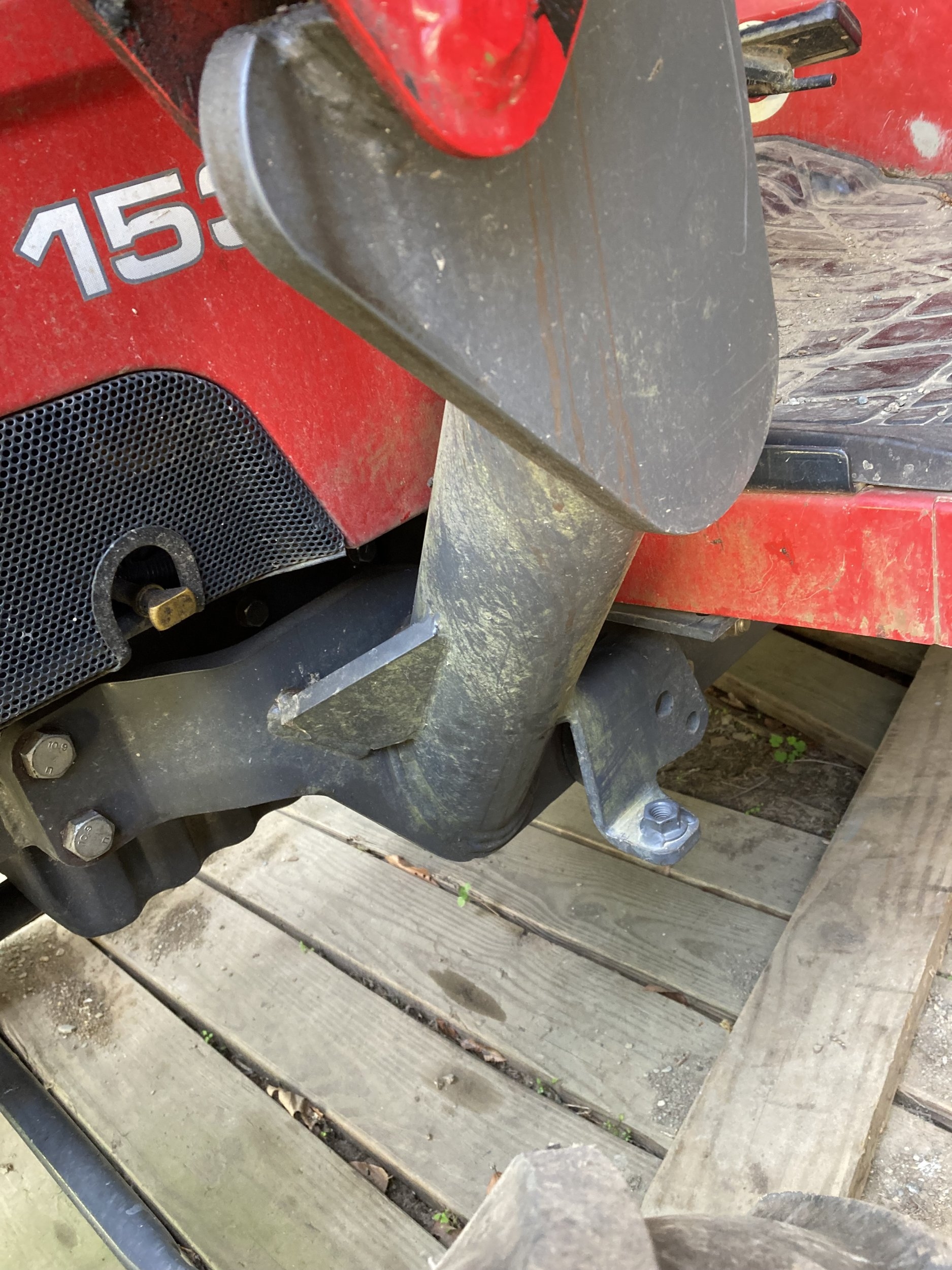

That’s a couple really bad breaks. I have MF1533 with a 120 FEL and my mounts look a lot more structural stronger than yours. The only problem I’ve had is broken and loose bolts that attach the loader mount to the tractor frame. I’m definitely going to add looking for cracks to my maintenance list.

First off, he should have been inspecting regularly and caught it when it started cracking.

Looks like bad design, with not enough support for the load. If you repair it, I would weld a plate behind
it to increase support.
/ MF 1835M loader support collapsed on tractor #94
Was moving dirt today when all of the sudden my loader started going down all by itself. This was crazy looking. You can see in the photos that the loader sub frame View attachment 802798 gave way on both sides. It appears to be either bad welds or cheap metal. Either way, it’s nuts that it would do this with only 140 hours on it.

No. My post is completely correct in how my hydraulic system works (and that's the one we're talking about here since the OP has the same system), and it's how most--if not all--modern open-center hydraulic systems work.
Lets sort two things out:
1. Main relief valve is located immediately after the main hydraulic pump, in the transmission-mounted hydraulic block. Not after the loader valve.
2. Power-Beyond (PB) port in the loader valve has nothing to do with what we're talking about here. Forget about it.
Ok, so the loader valve spools, once in the neutral position, have separated the hydraulics into two circuits:
1. The main system hydraulics, which are still running and cycling fluid at almost zero pressure since this is an open-center system.
2. The loader circuits, where all ports are closed and the hydraulic pressure is relative to whatever weight is on the cylinders.
The loader circuits pushing back against the spools, are also tapped to a pressure relief valve, mounted on the loader block. If the pressure in any cylinder circuit exceeds 2610psi, the loader relief valve opens and sends that fluid down the Return line, back to the hydraulic sump or tank.
Honestly that's as straightforward as I can make it. If you still don't understand how the system works, Google it or go to Youtube since a picture or video is going to be way more helpful to you.

Unless the loader valve in that tractor in particular has work port relief valves, which I doubt it has, then there is absolutely 0 protection from the loader main relief valve with spools centered, just like K5 said.

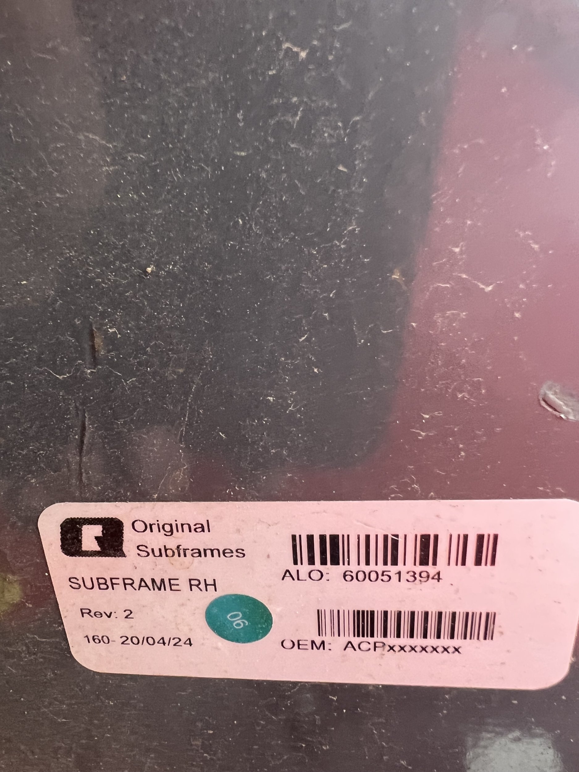

Do you know the rated capacity of you FEL? It might be that the FEL mounts on the tractor are not rated for that specific model FEL. My FEL is rated for 1000 lbs and hopefully the mount rating matches also.

Maybe I'm misunderstanding the hydraulic diagram, but is that not a 2610psi pressure relief valve in the top middle? If I'm wrong, then I do apologize for the misinformation.

The valve banks have reliefs built in often for each circuit so one function doesn’t overload another. Most noticeable in a backhoe. Perhaps some budget machines don’t employ a system like that.

Looks to have been cracked for a little bit too.. then finally gave way while you were working.
Agree. Looks like the corner wasn't welded at all and the crack probably started there.
